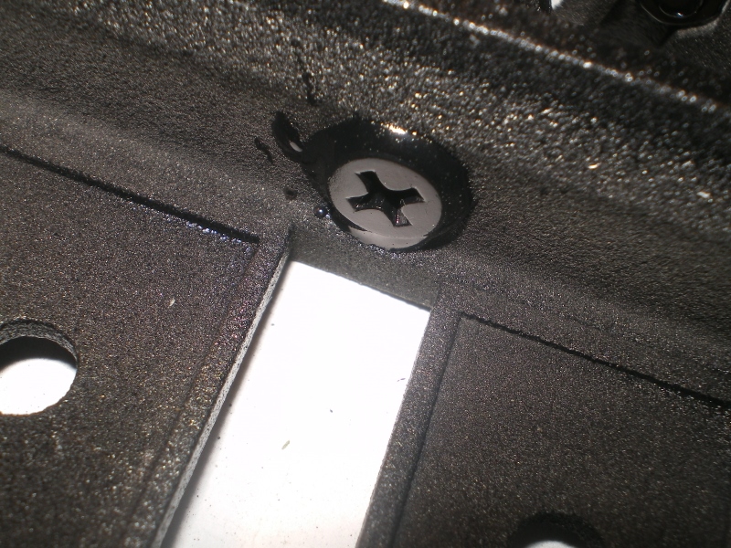

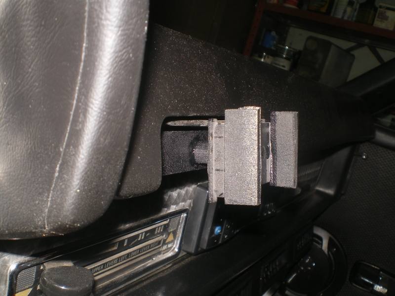

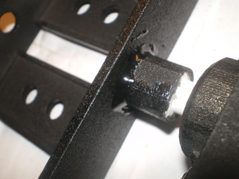

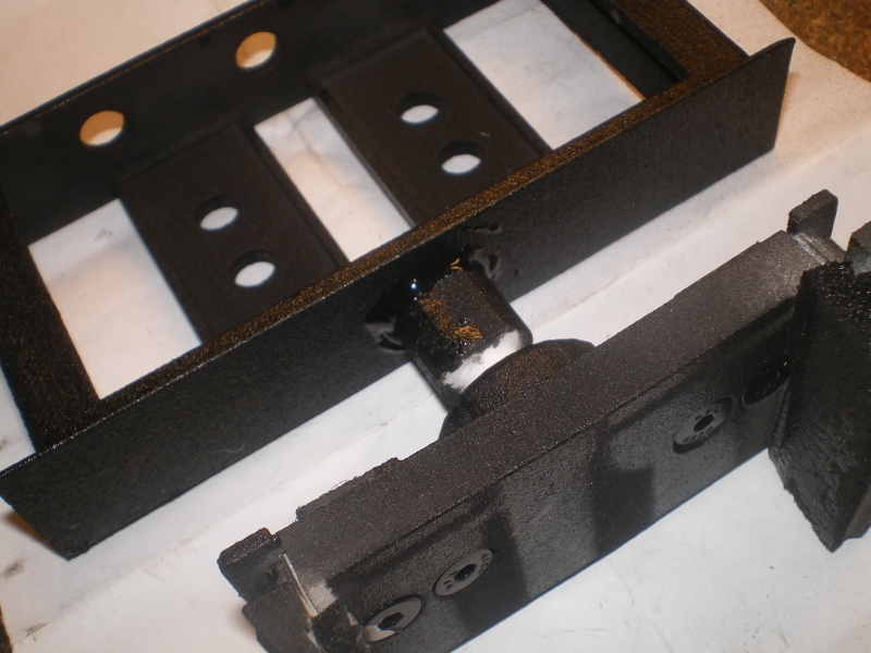

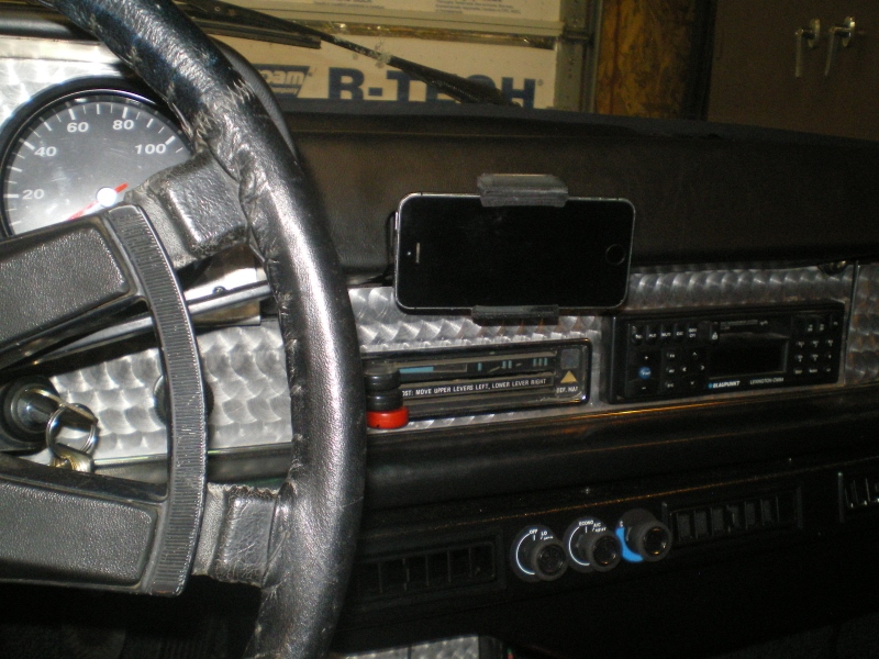

OK, what am I missing? The grip range is too large for my Iphone which is ~58mm. Do I need my phone in some case to fit? 2nd, it's floppy and I dont want to over tighten that little bolt. Not sure wh it has mch threads eith. Seems like the long one would be a tapered screw like a sheet rock screw. (IMG:style_emoticons/default/confused24.gif) Is it just me???????

The phone support was designed for minimum 60mm so you are a bit under. One of the clamps is free and the other has to be ajusted and tightened.
You can put your phone in a case, this would be the easiest way to fix the issue.
The clamps have a rake and if your phone is very thin, you can glue a 3 to 5mm rubber or foam on the surface that will receive the back of your phone. THis will push the phone towards the clamps.
You can shorten the main part about 1mm each side with a file and gain 2mm clamp travel
If the ball join with main frame assembly is floppy you better disassemble and put some glue on the surface before re assembling. This is not intended to be disassembled in the future.

As also said to 76-914, on final assembly you can glue the ball joint to the main frame to secure the screwed assembly. This reduces stress on the plastic thread that is in the ball joint and prevents from wobeling. I suggest you don"t paint the surfaces that will receive the glue.

Pretty much what I planned on doing. I'll use a strip of foam pipe insulation to correct the dimensional problem. Then I'll replace the machine screw w/ another style and JB Weld the square post to the body. I'll post my results if I have results. (IMG:style_emoticons/default/dry.gif)

Made those two mods and luv it (IMG:style_emoticons/default/wub.gif) Also hit it with some duplicolor vinyl spray paint.
If you look closely you can see the head 0f the #8 1" sheetrock screw and the bead of JB Weld around the stem base. Solid as a rock now. Also added a thin strip of foam on one side. The texture of the material blends well with the OEM look.

Looking good. For small phone I suggest you put two rubber bands.
