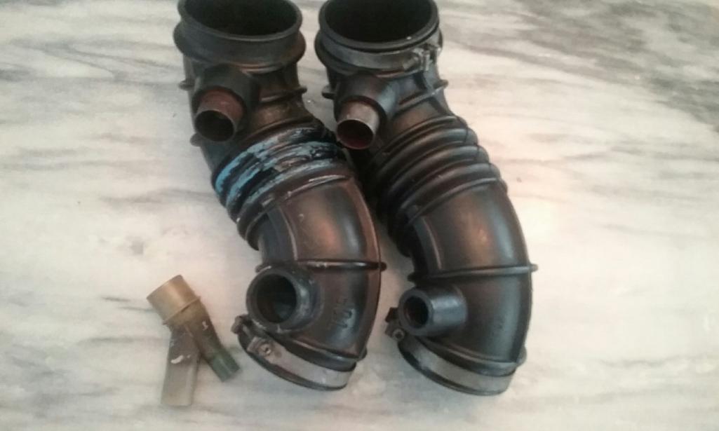

QUOTE(75914-L20C @ Oct 30 2015, 08:27 PM) *
Is it possible the picture on the bottom has the right metal tube fitting in place and despite the different part numbers, they really are the same? Looks like that picture may be perfectly looking down the barrel of the metal fitting...
Paul
No. This is not an optical illusion. I can confirm there are two different elbows. They differ in the diameter of that port. The large port version is from '75 & '76. The small port version is '74. I used a large-port version on my '74, but had to get a fitting manufactured to step down the diameter so that my vent line would fit.

I placed a WTB elbow hose for my 75 1.8. A member sent me one, and it's the one on the right. My old elbow is on the left.
The part number with the T suffix, is for a 74 which he sent me. Without the T is for a 75.
As you can see the "Y" fitting has to fit in the large hole. The "T" hose hole isn't big enough.
Bill

QUOTE(orthobiz @ Nov 1 2015, 09:28 AM) *
Paul
No, there is no fitting in place, it is just the bare elbow.

QUOTE(Mueller @ Oct 30 2015, 04:21 PM) *
Someone in another thread mentioned there is a difference between the part for MY74 and MY75?
If so, you'd want to make sure it fits both year models.
74 and 75 are different. One of the plug in pipes is a different size. The mold should be msde for the larger size and a reducer insert used for the snaller size.
Bruce
Exactly my plan.
