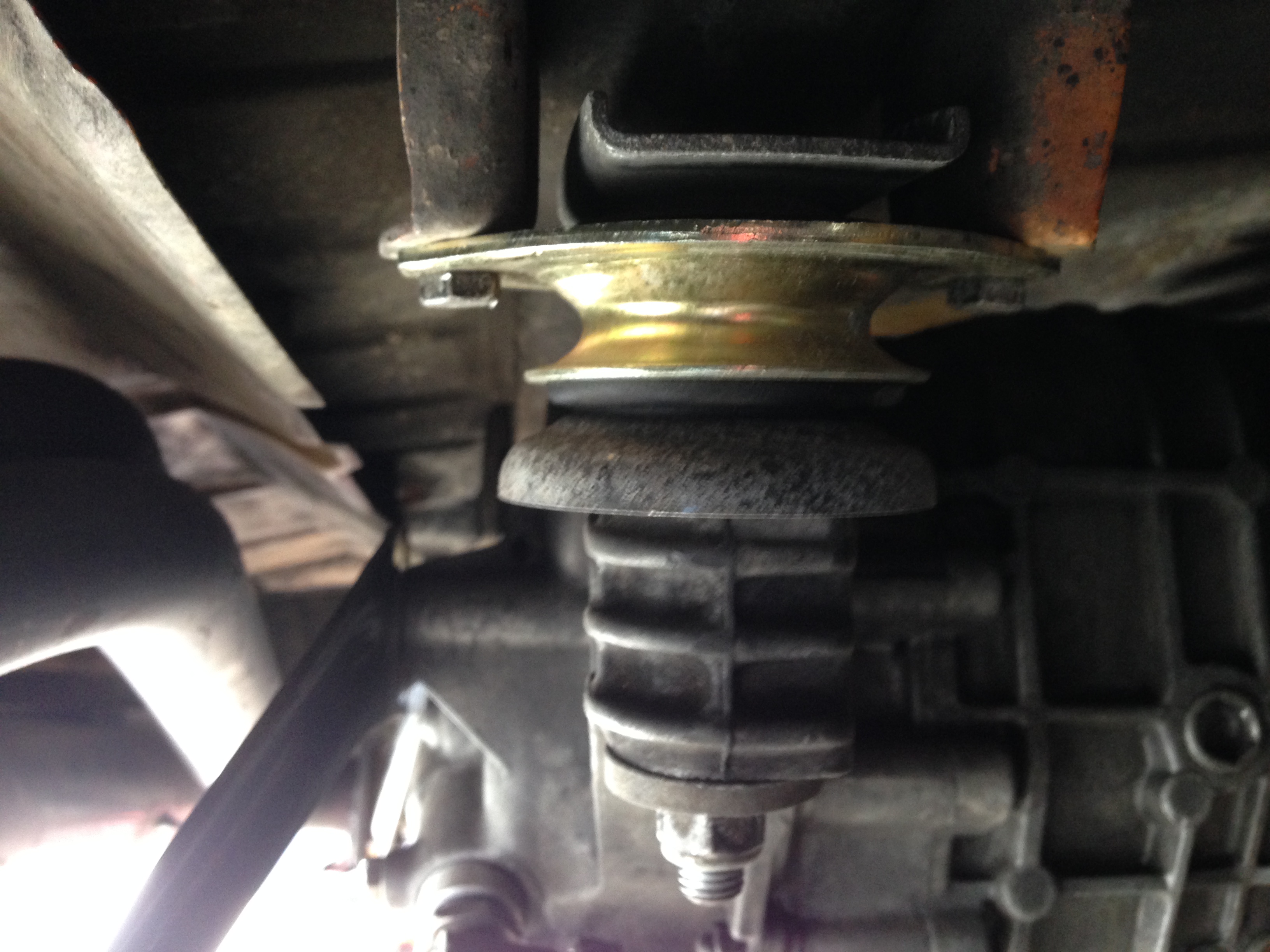

If you use the original hardware you won't need any spacers!
That includes the top bracket and the big cup washer underneath ...
(IMG:http://www.914world.com/bbs2/uploads/post-179-1254895391.jpg)
