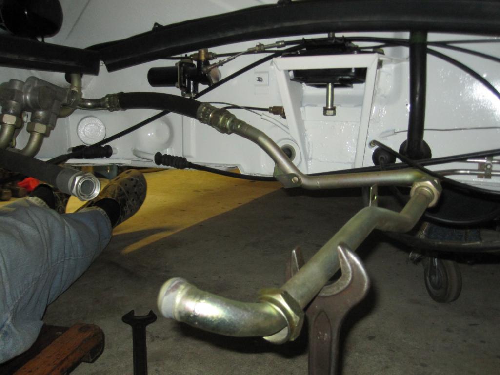

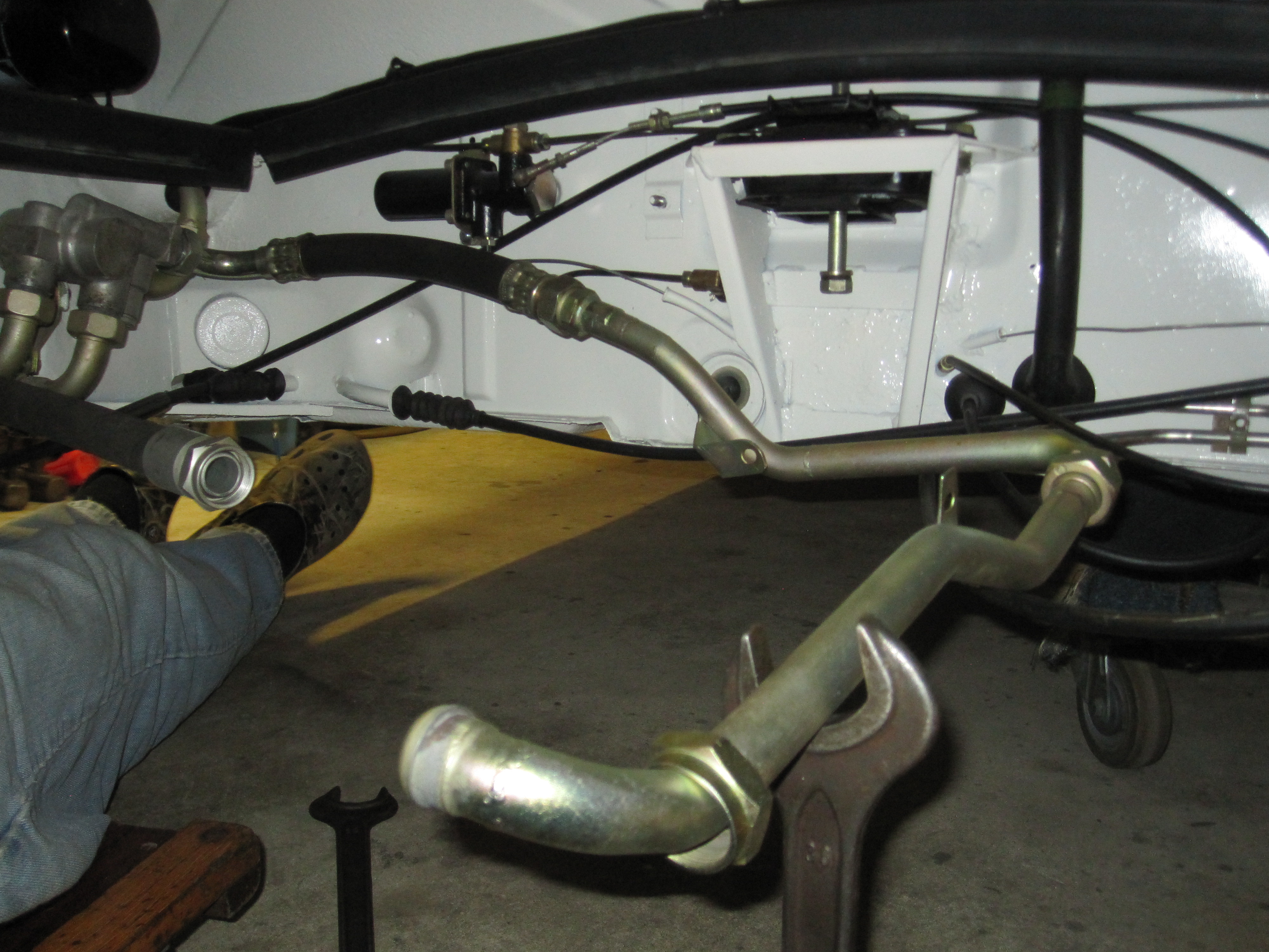

Working a bit on oil line solutions.. In light of recent discoveries that factory style scavenge line does not work with the naroscape or PMS engine mounts I decided to come up with a solution for others. I chose Russell pro line classic AN hose as it has a blue tracer much like the original.. I may actually get these made in proper 30mm setups for those that want one.. I used orange fire sleeve which I may take off as I will use Adel clamps to hold the hose away from the headers. Pictured is project in progress.. Its not done but spit balling at this point.
Ben I used a hangar from the chassis down to one of the rigid tubes at the bottom of the thermo. It clamps onto the tube to allow some adjustability.
Additioal support and location is provided to the thermo by replacing the hose
from the tank to the scavenge line with a solid rigid tube.
Engine vibration and movement is absorbed by a hose that extends from the
thermo toward a fabricated scavenge line that extends around the front of the
engine.
Picture attached.

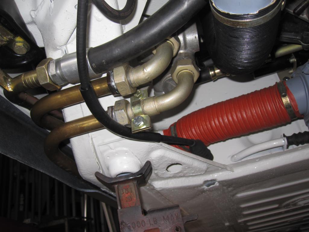

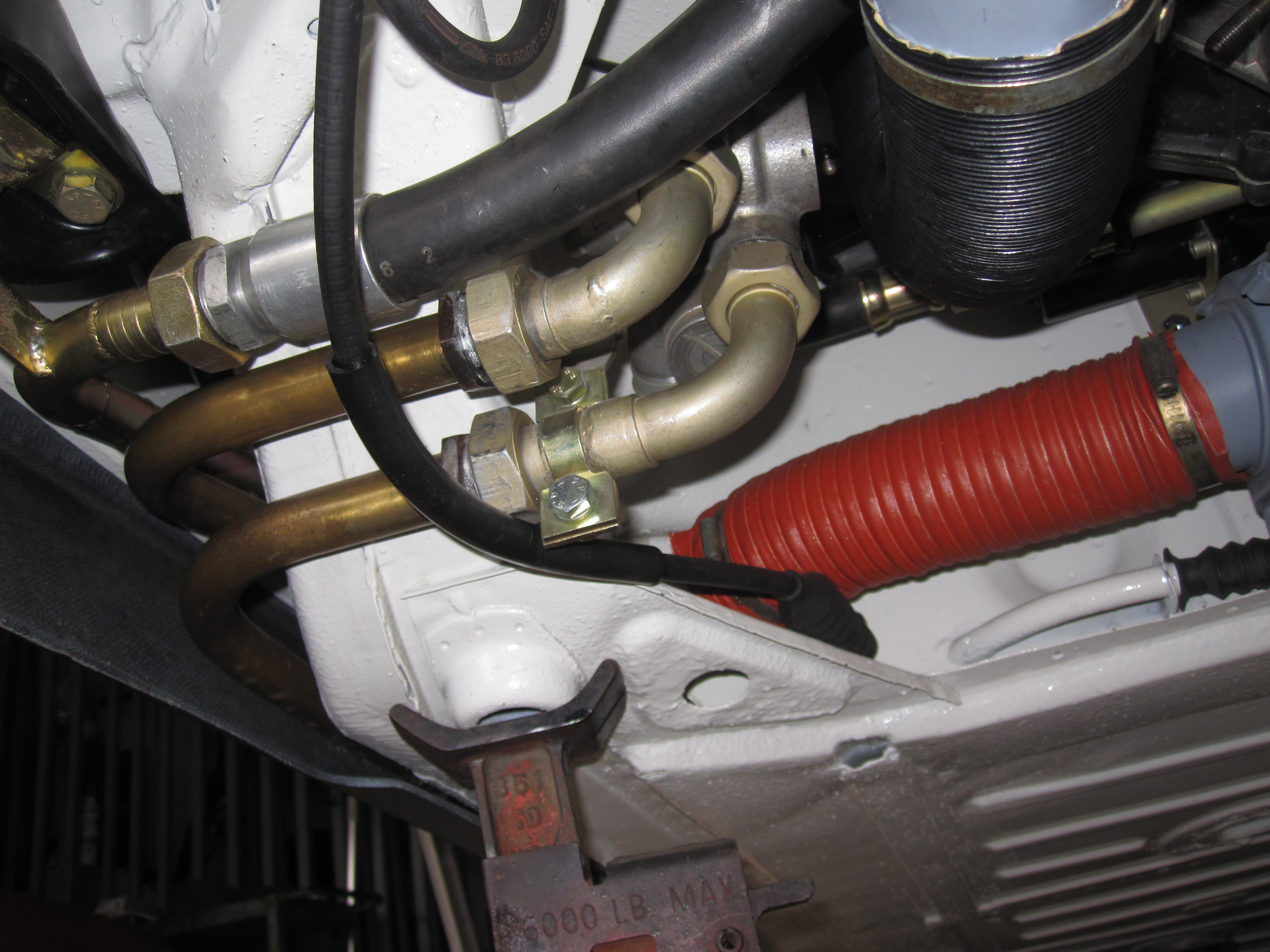

Picture showing support from chassis to lower rigid tube.
I can't believe it's been a year plus since I devised this.
