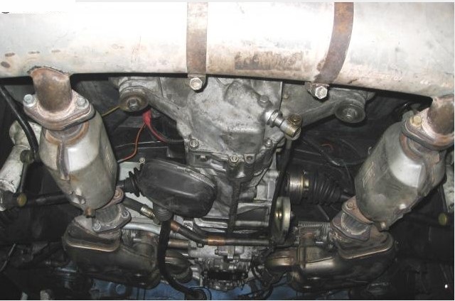

Only pic I have is from PO, kinda small.
He did the 993 HE's because it was a 1975 914 and needed Cats and pass smog I guess?
I would have kept them, but found a set of stock 914-6 HE's I bought some 10+ years earlier. My 2.7 doesn't need pipes larger than stock 914-6.

QUOTE(Root_Werks @ Dec 21 2022, 11:47 AM) *
Love to see some more pics if you ever get it on a lift. I have a 3.2 in it. I need to do some research to see what is needed.

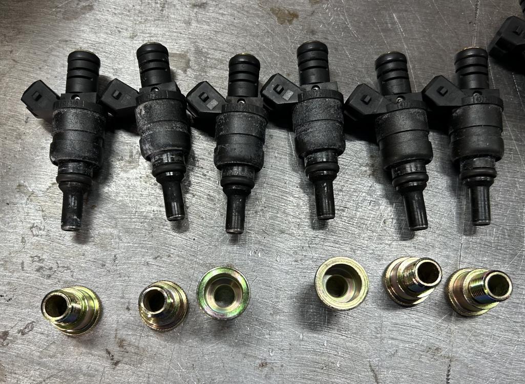

Injector bungs came in. Attached Image

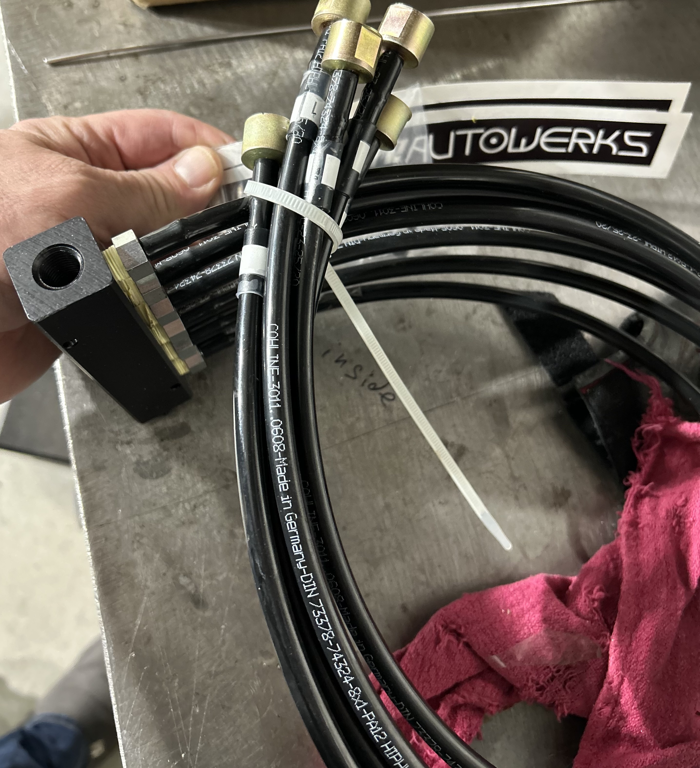

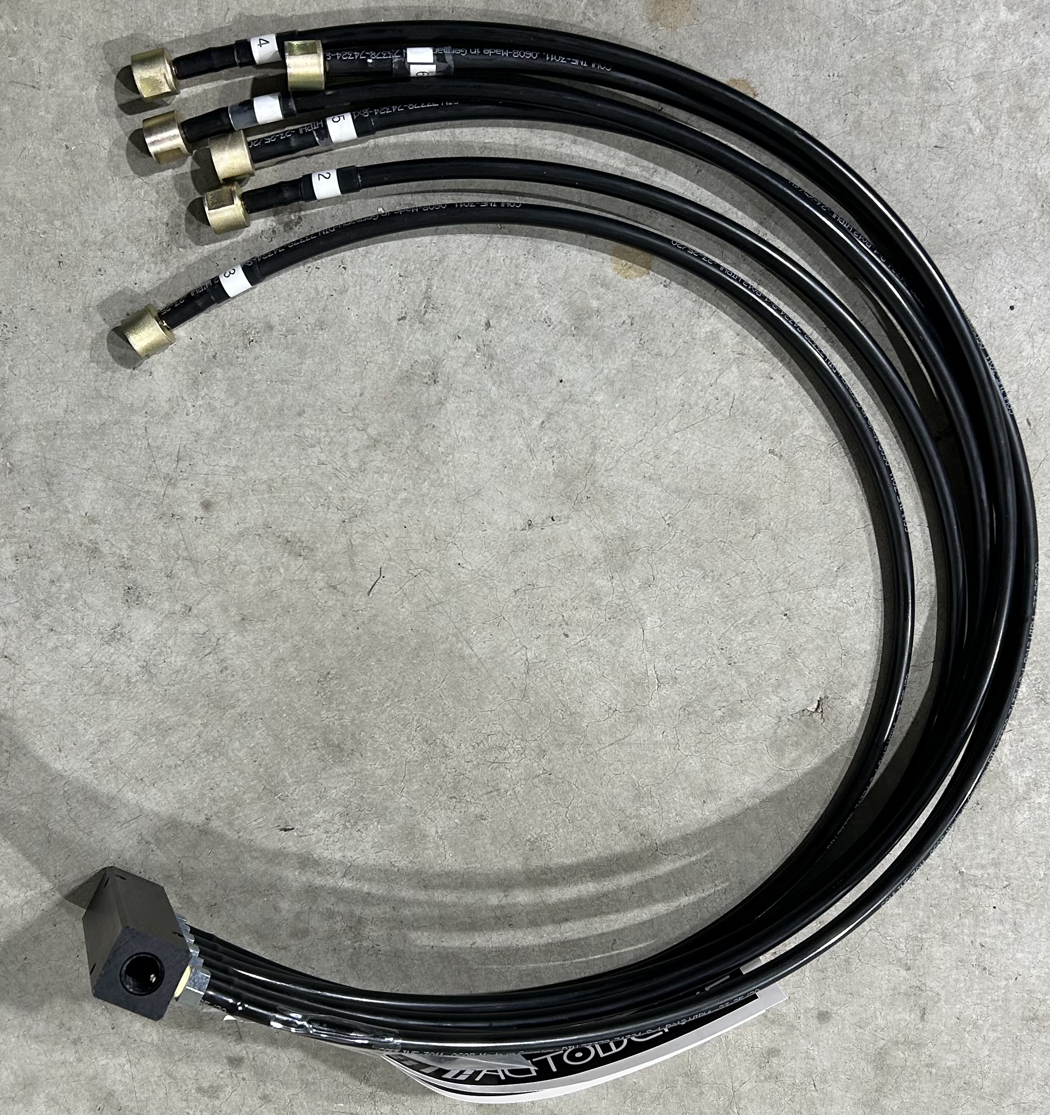

QUOTE(mb911 @ Dec 20 2022, 08:21 PM) *
I’ve fallen behind on this thread but don’t see the background on these when I go back to old pages. I clearly missed something.
FI rail with CIS style fuel distribution lines? (IMG:style_emoticons/default/idea.gif)
mb911
post Dec 24 2022, 01:41 PM
Post #1234
Posts: 7,794
Joined: 2-January 09
From: Burlington wi
Member No.: 9,892
QUOTE(Superhawk996 @ Dec 24 2022, 11:18 AM) *
Here is a bit of background but no not cis this is multi point EFI using the carbs as throttle bodies. http://forums.pelicanparts.com/porsche-911...14-mfi-efi.html
mb911

QUOTE(mb911 @ Dec 24 2022, 02:41 PM) *
Very interesting. Makes me glad I didn’t weld up the CIS ports on my 2.4l heads.
I’ll be watching with envy!

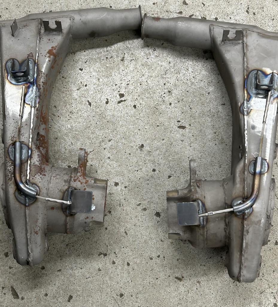

QUOTE(mb911 @ Dec 17 2022, 04:13 PM) *
Tangerine conversion kits for the e brakes.
Hey Ben, were there any specific measurements you used in laying out/welding these components on? I have the same kit and need to install, so any insights are greatly appreciated !!
Thanks!
mb911
post Dec 26 2022, 08:43 AM
Post #1238
Posts: 7,794
From: Burlington wi
Member No.: 9,892
QUOTE(bahnzai @ Dec 26 2022, 05:54 AM) *
Thanks!
Danny,
Chris provided instructions in the kit. I will look probably still have them. Shoot me a text and I will send you them.
