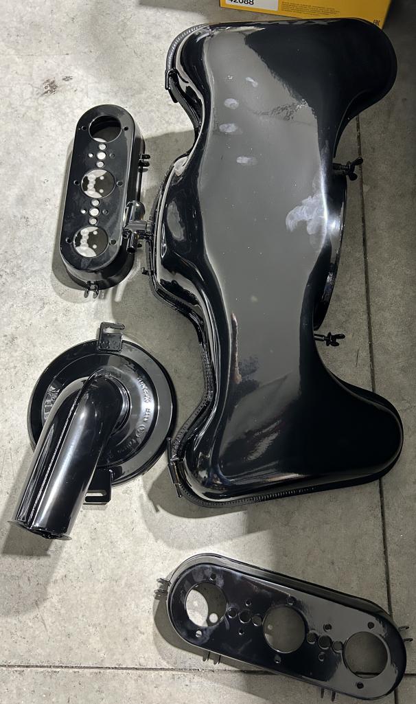

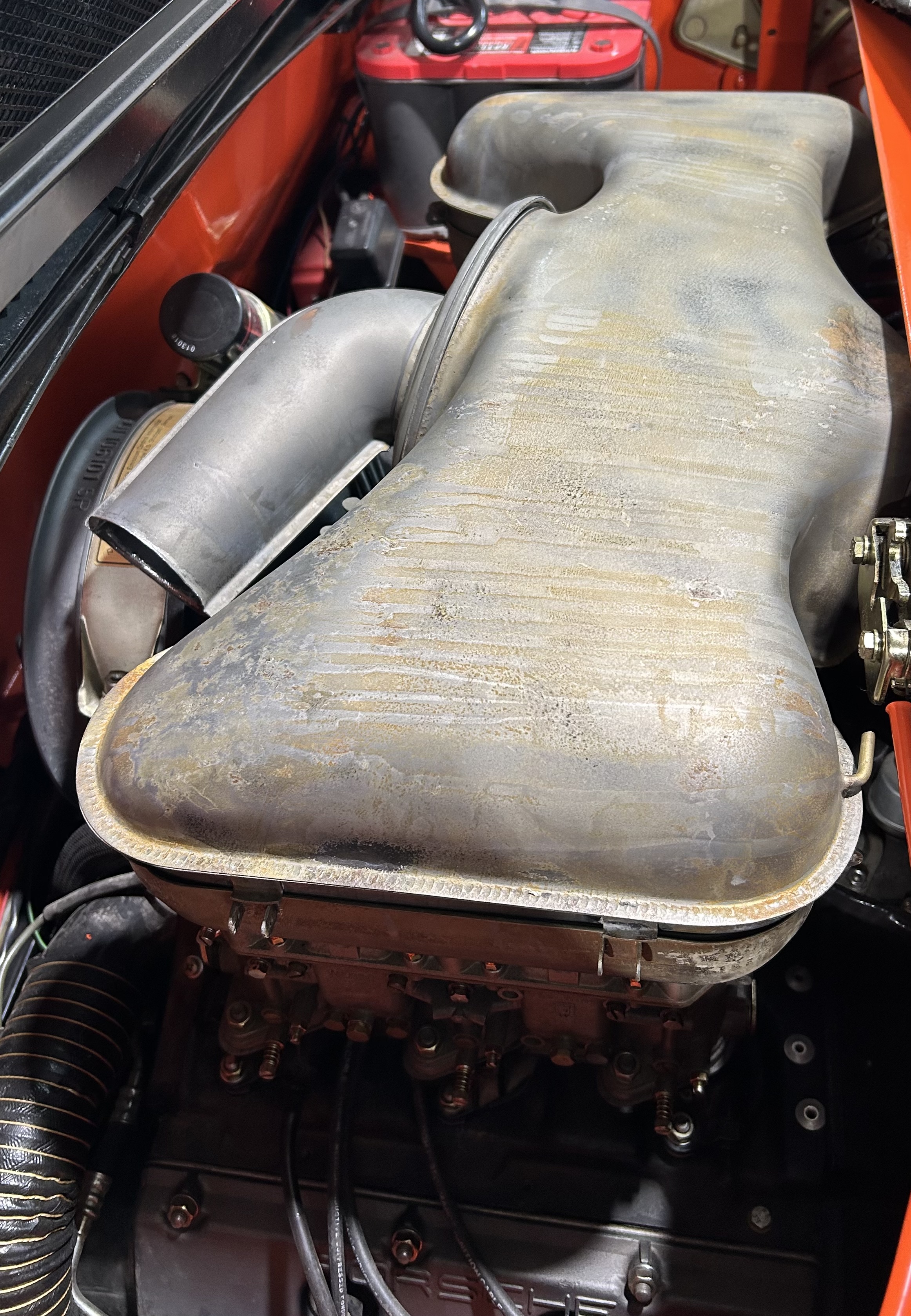

Today I got to spend 4 hours on my stuff today. Really happy about that. Anyway I finally was able to get the stock steel 911 air filter on my car. Some of you may know how much I hate k&n air filters and this allows me to go back to something a little nicer and something that filters nicely

In addition to the greatly improved filtration, the stock air cleaner housing really cuts down noise. A win-win. (IMG:style_emoticons/default/beerchug.gif)

QUOTE(Cairo94507 @ Dec 30 2022, 06:07 AM) *
That does make me happy as well

QUOTE(Cairo94507 @ Dec 31 2022, 02:07 AM) *
(IMG:style_emoticons/default/agree.gif) thats why I ditched my K&N's,think it was the late Bruce Anderson mentioned the stock air cleaner is very efficient.

QUOTE(porschetub @ Dec 31 2022, 10:39 AM) *
Attached Image.
Someone mentioned they were restricting but I don’t buy it. Just like Porsche exhaust of that period was very well engineered so was the intake

Back from powder paint. Yea I went gloss. My car is a tribute but not hardline tribute

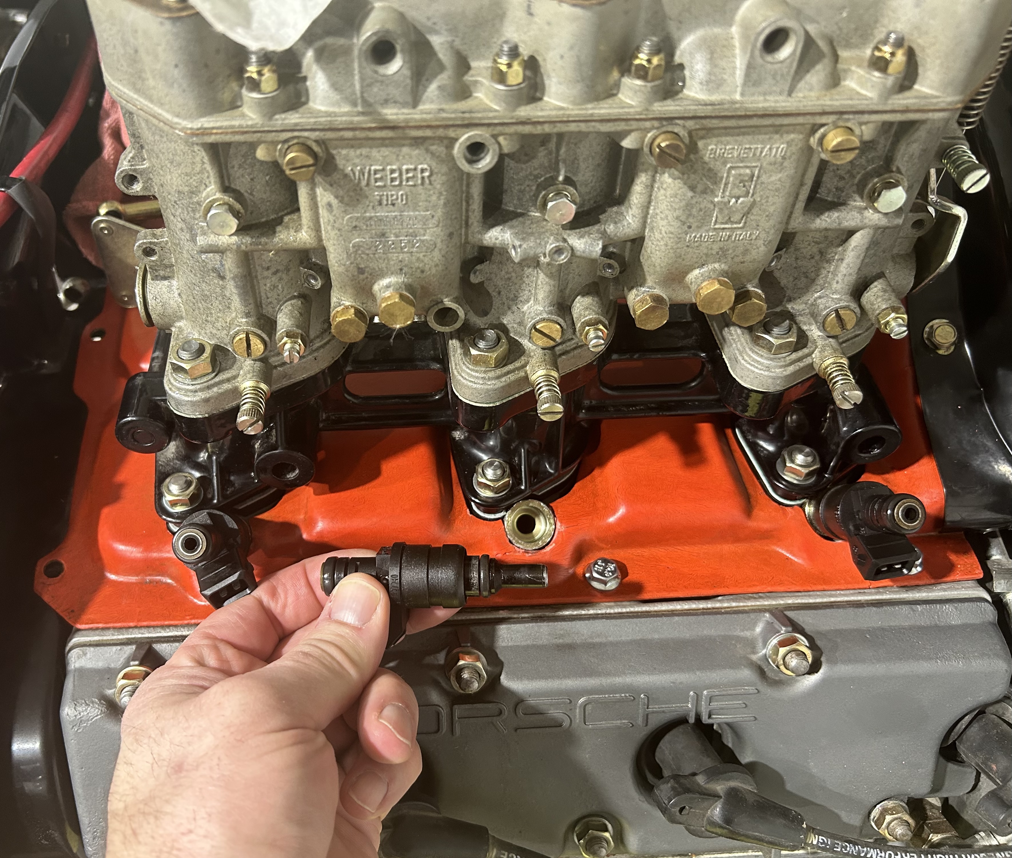

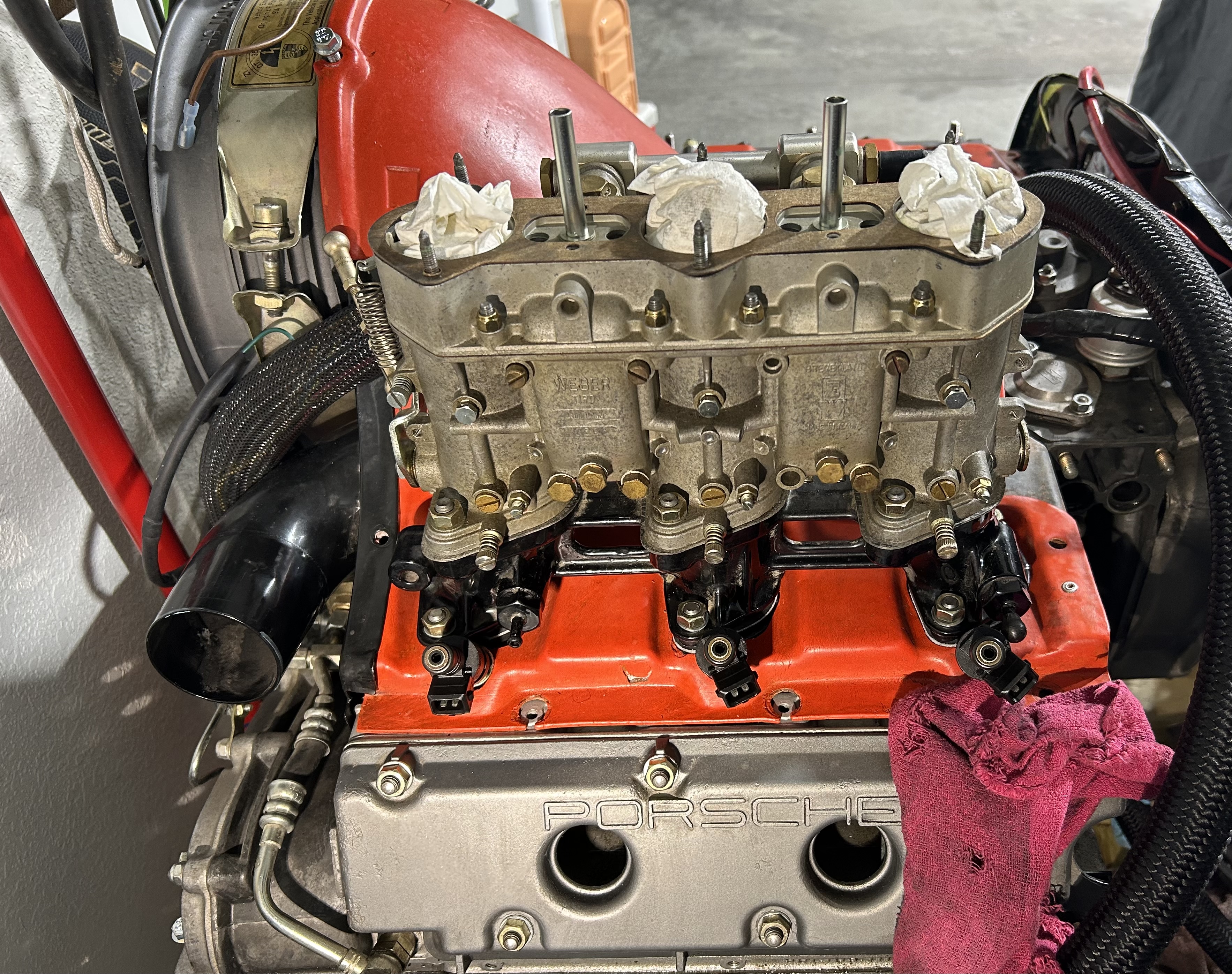

So EFI has started. Pictures as of tonight

QUOTE(nditiz1 @ Jan 11 2023, 06:52 PM) *
Which efi are you going with?
So if you look close you can see the injectors in the MFI ports. I will be using mega squirt per @jpnovak he is helping with this
mb911

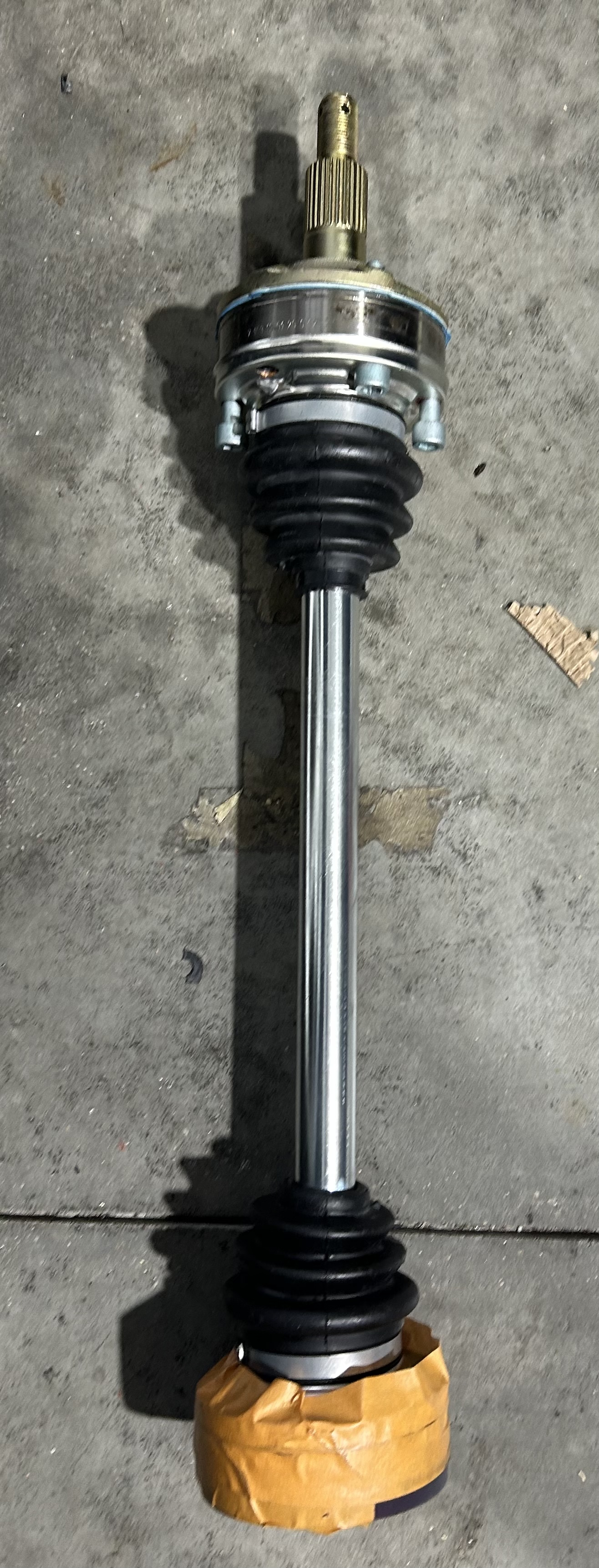

New 108 CVs and full floating axles from PMB. These should not break

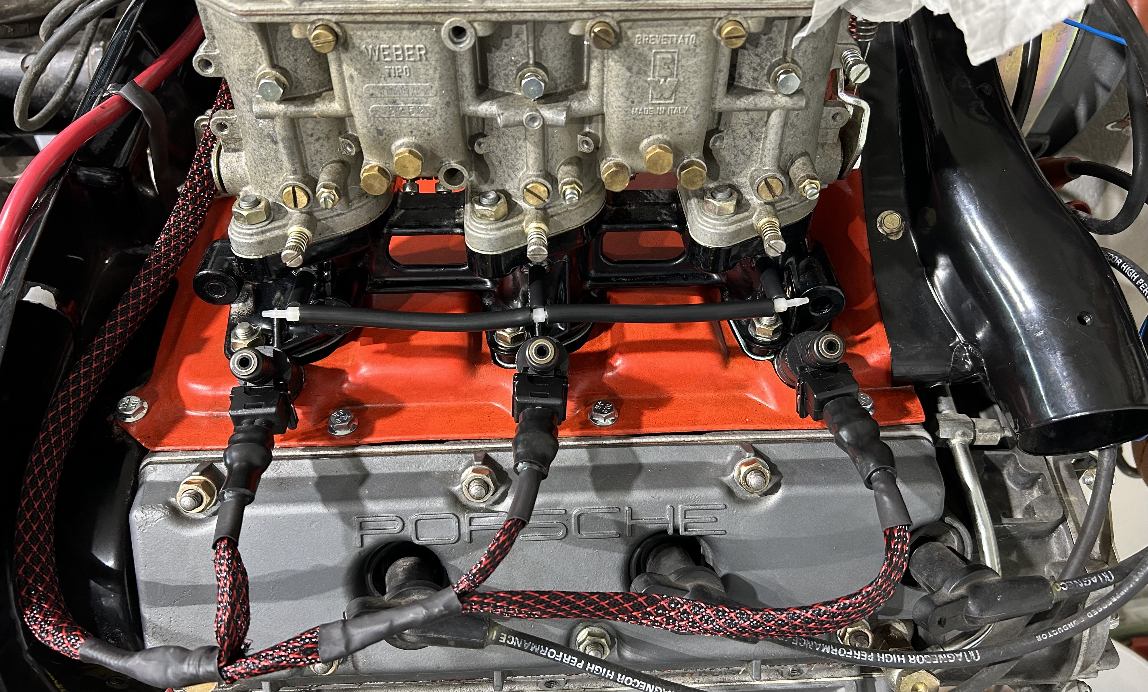

And more progress on the EFI

Went a different route on vacuum tubes. Drill .100 hole and used 3/32 brass sleeved inside 1/8 brass and used loctite 638 cylindrical bonding and pushed them in the holes and for good measure so epoxy on the outside. Then connect the 1/8 vacuum tubing only to realize that I need to run individual lines to a manifold to ensure no reversion. I did also start on the injector harness as well.Attached Image

Those are sure some nice axles Ben. (IMG:style_emoticons/default/beerchug.gif)

QUOTE(Cairo94507 @ Jan 16 2023, 02:58 PM) *
@eric shea is to thank for them
