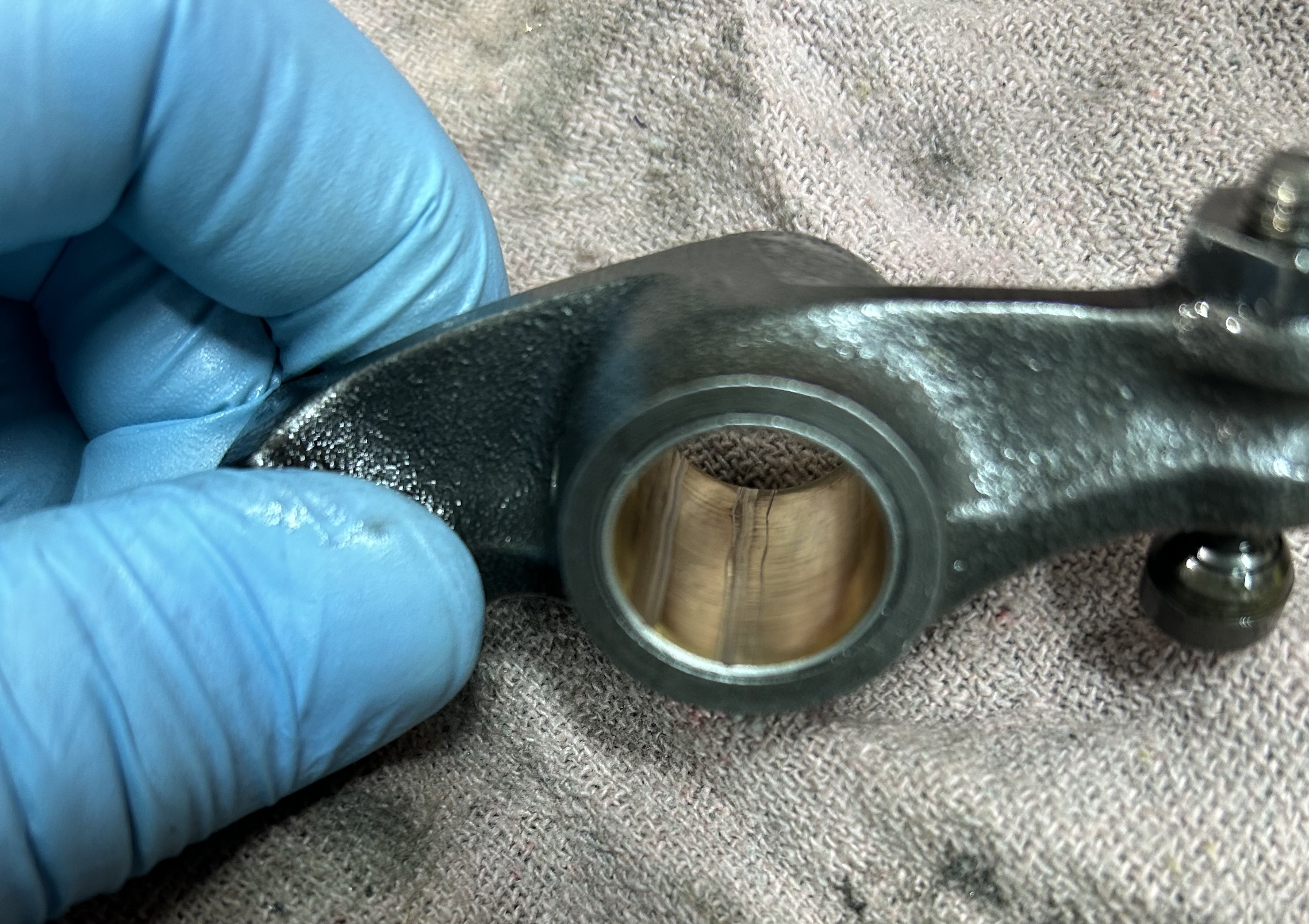

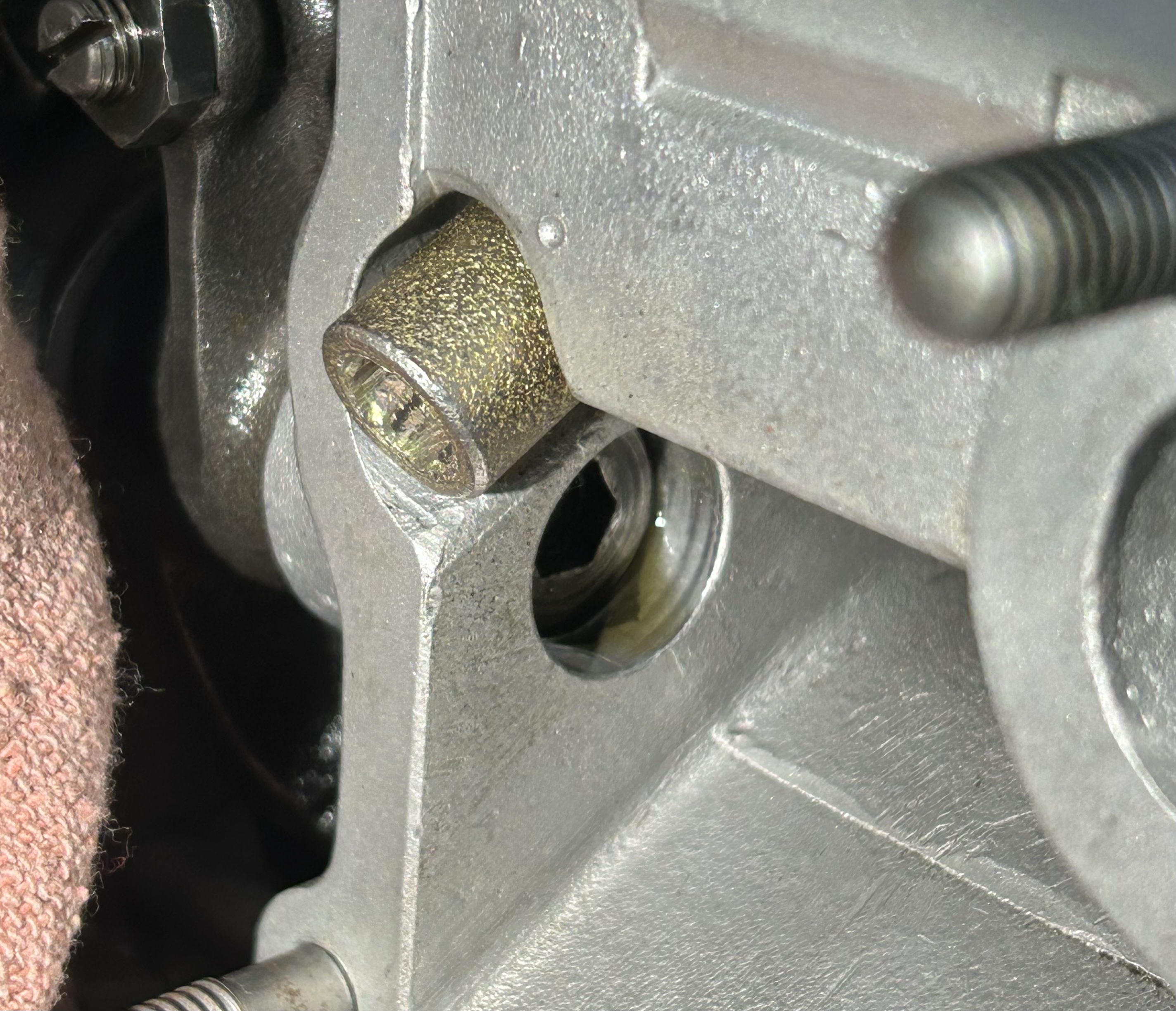

Well there is my oil leak. UghAttached Image Attached Image

Oh that does not look good. Glad you have identified the issue and should have no leaks once it is back together. (IMG:style_emoticons/default/beerchug.gif)

QUOTE(Cairo94507 @ Jan 19 2023, 03:40 PM) *
I think it may have just been a small mistake by me. Super disappointed but it’s a 10 dollar bushing

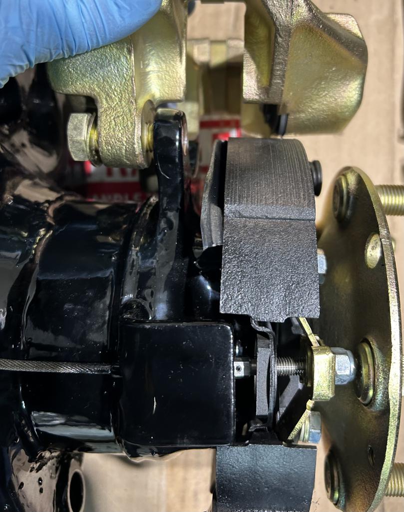

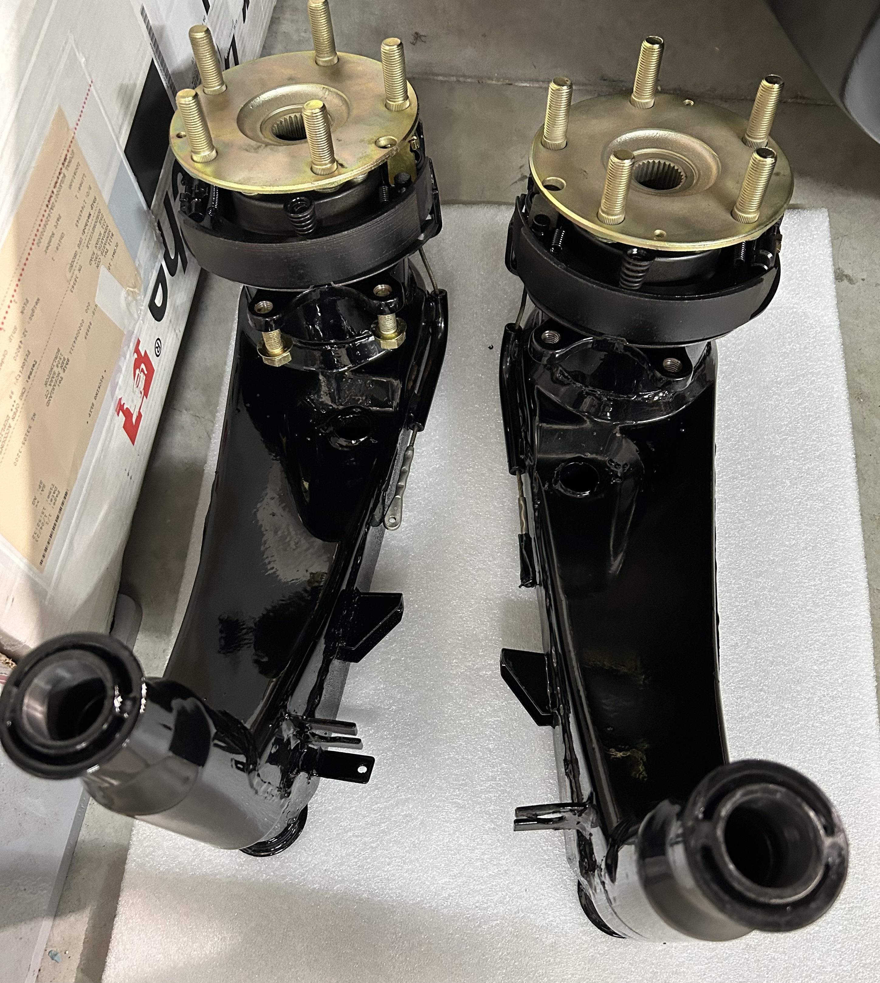

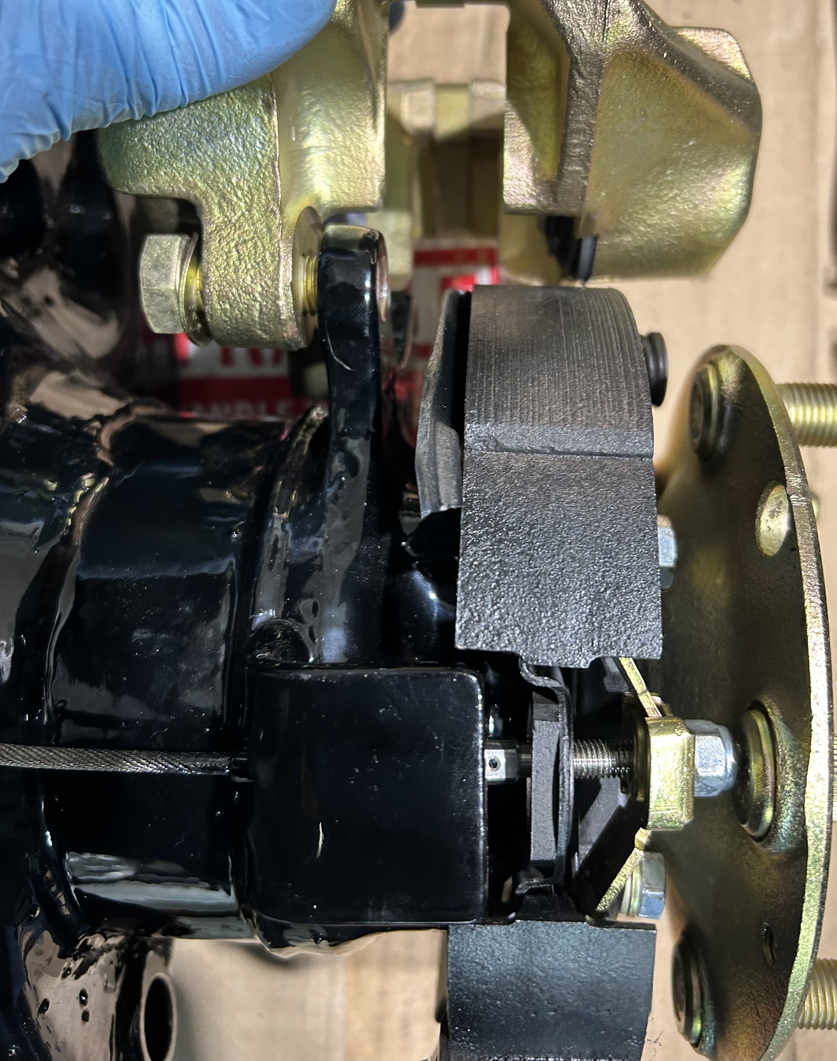

911 parking brake setup is worked out now. Wow that was a PIA.Attached Image

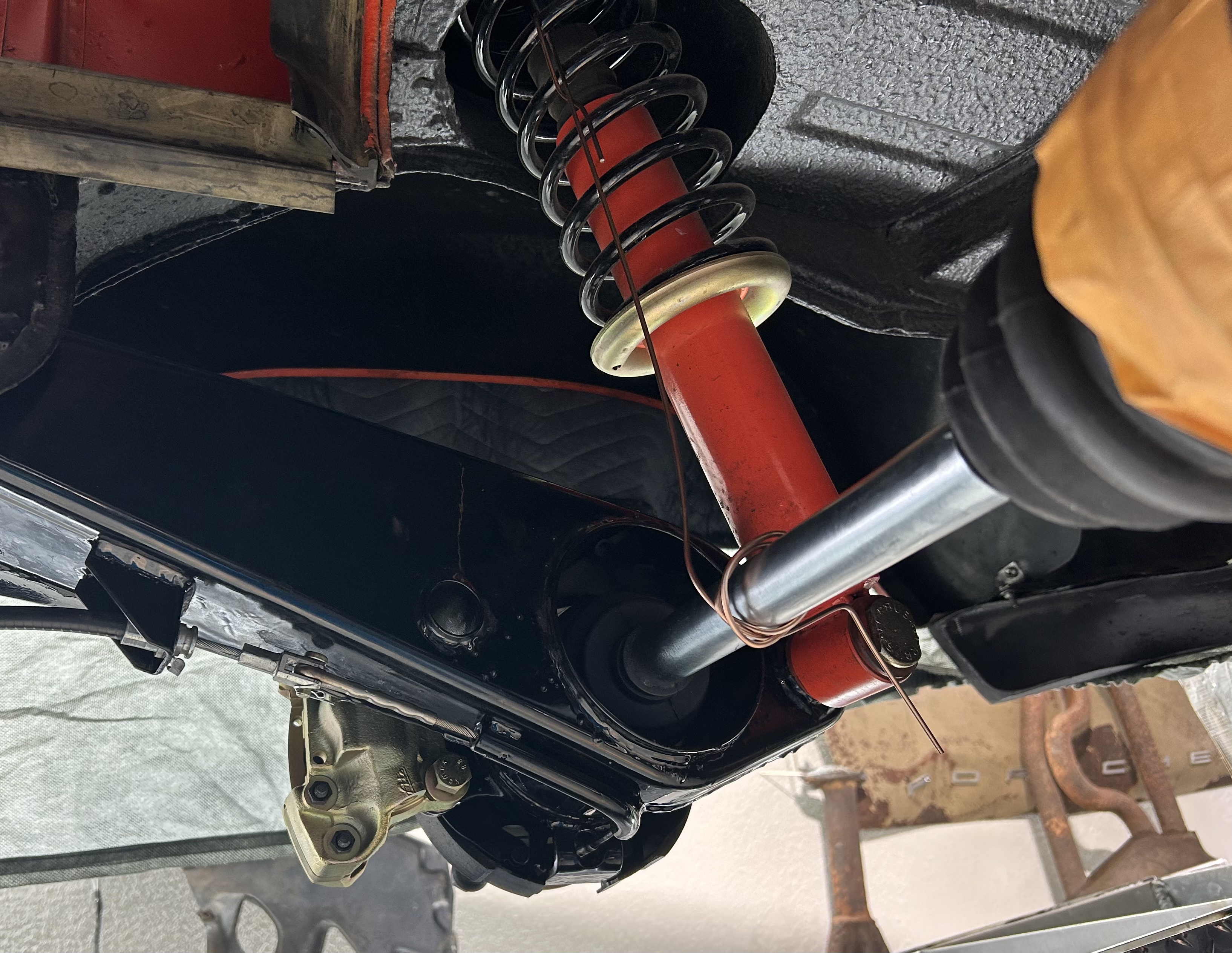

Installed and almost done.Attached Image

Does the Anchor block for the Shoes , Need to go past the centerline of the Shoes ?
mb911
post Jan 22 2023, 05:01 PM
Post #1276
Posts: 7,794
Joined: 2-January 09
From: Burlington wi
Member No.: 9,892
QUOTE(sixnotfour @ Jan 22 2023, 12:05 PM) *
According to the instructions from tangerine no but going to add a section on as I agree with your assessment. I did see though that many just tack a bolt on the hat and that’s it. Not sure how much needs to be in there. I feel like I need to add a bit and TIG weld an extension.

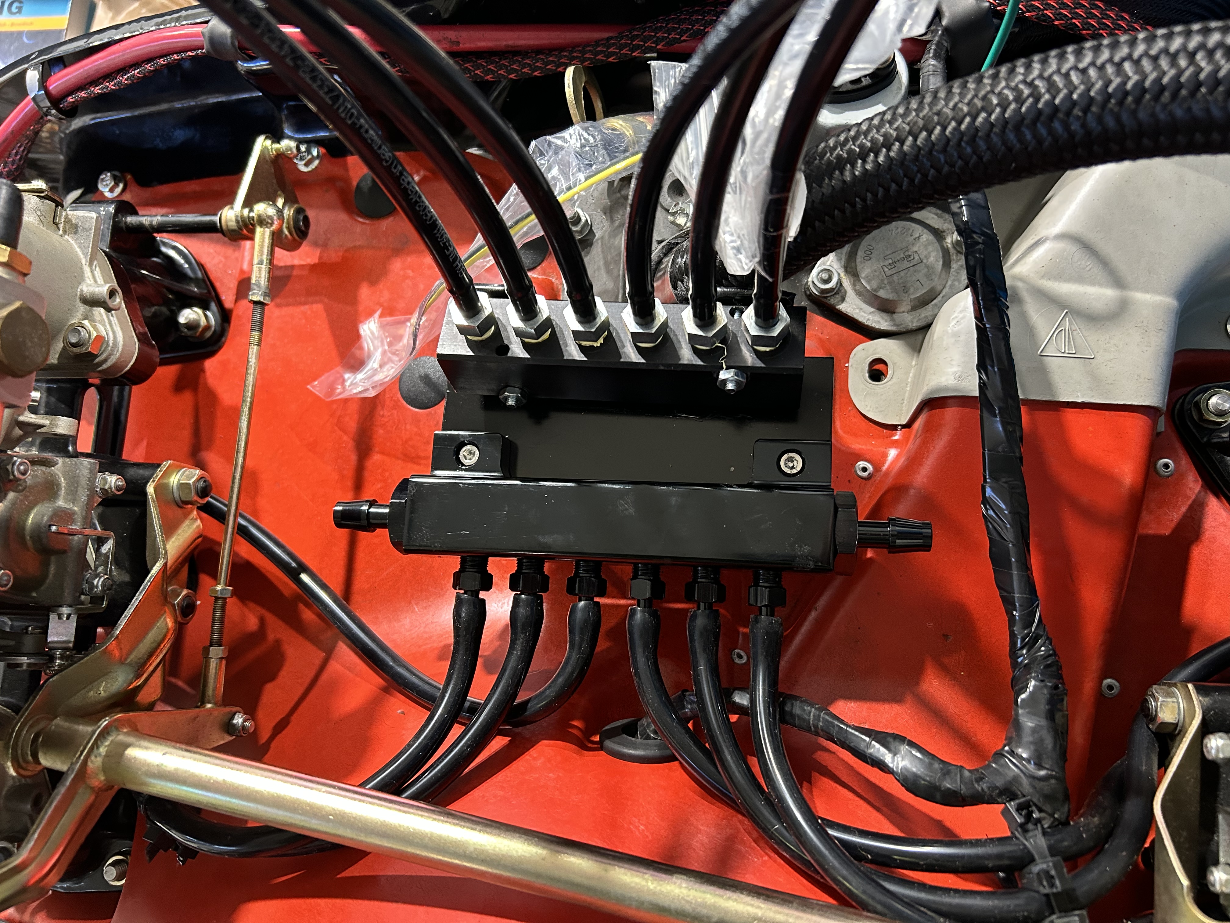

Equal length vacuum setup for the itbs/carb setup. Attached Image

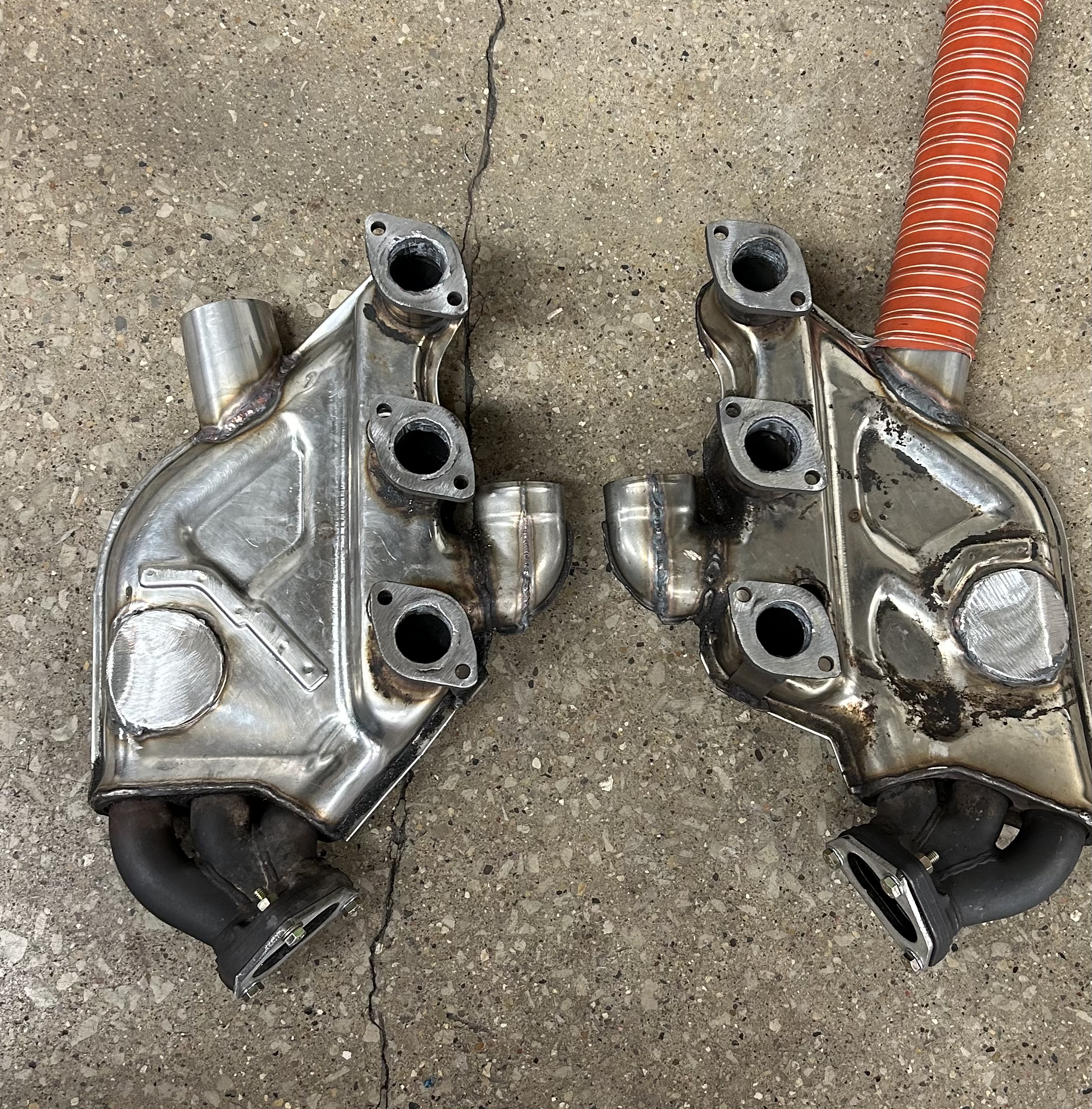

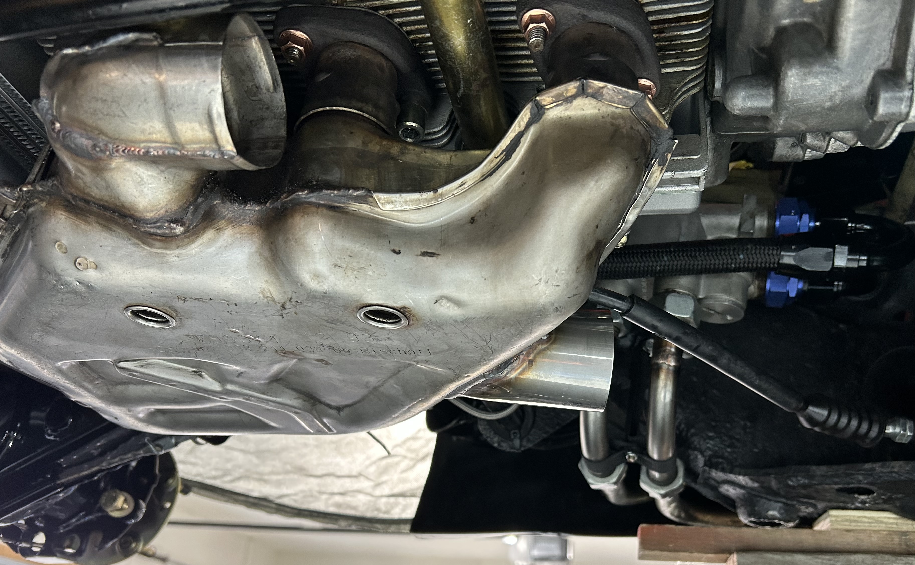

New heat exchangers with 1.5” sleevesAttached Image

Here they are mounted. Ordered the elbows and flow through mufflers as well to keep things quiet. Attached Image
