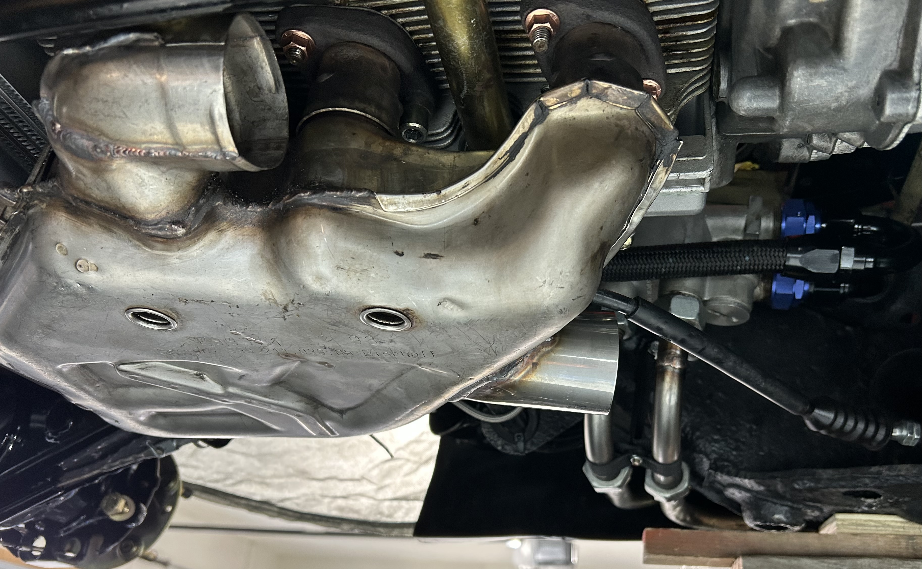

QUOTE(Cairo94507 @ Feb 21 2023, 08:48 AM) *
Interesting. Looking forward to the finished results. (IMG:style_emoticons/default/beerchug.gif)
After what we will call the hostile take over of my former stainless line up this a great option. I wanted to add some additional muffling and this allows for it.

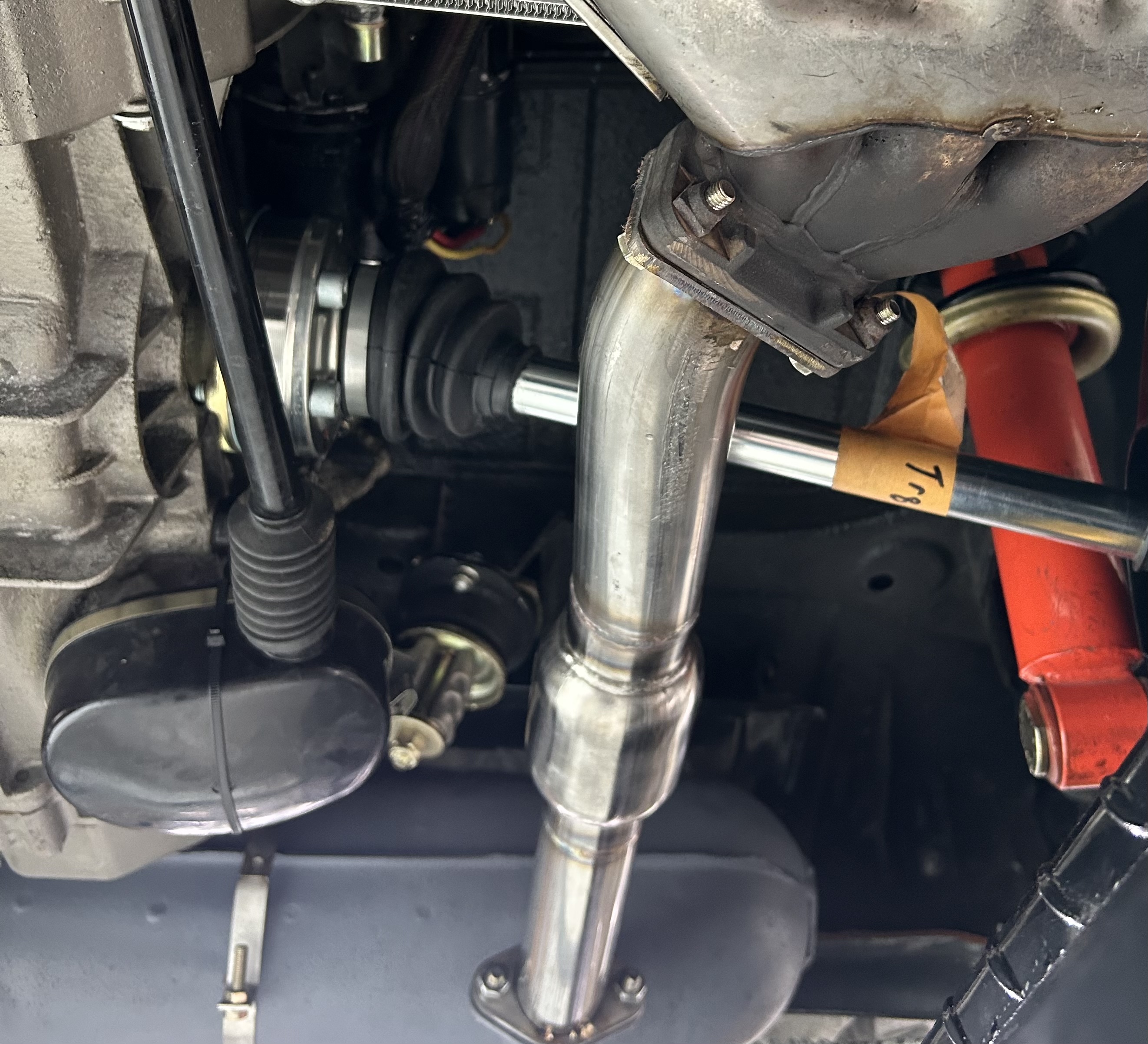

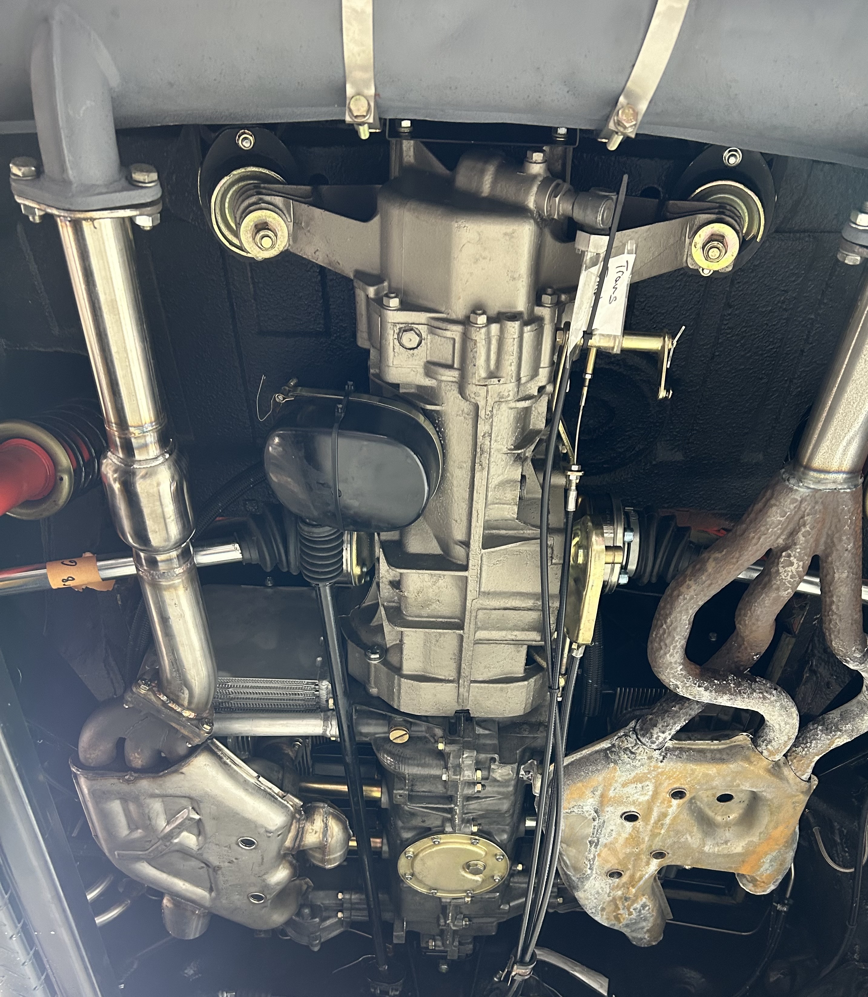

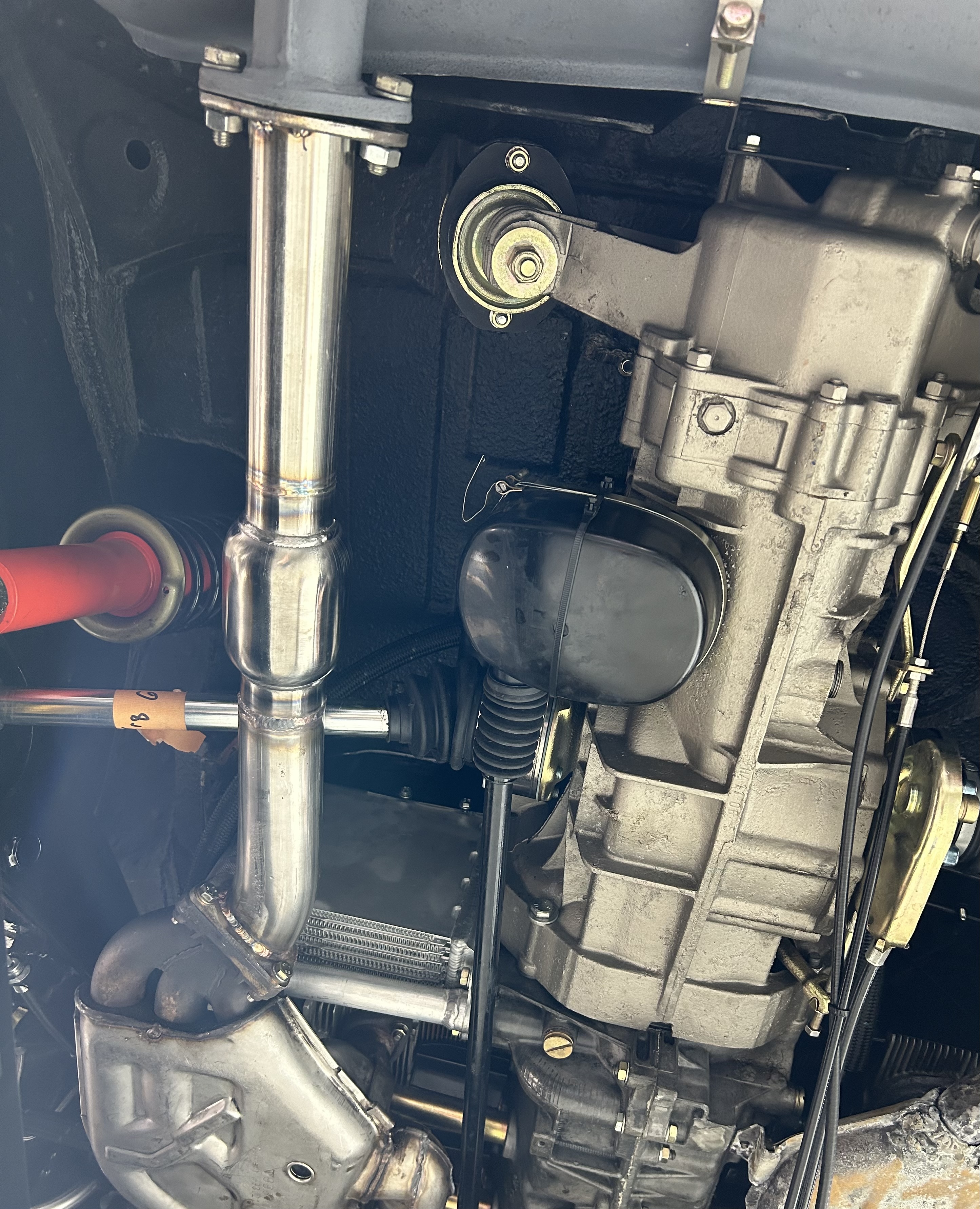

QUOTE(mepstein @ Feb 21 2023, 04:43 PM) *
I’m setting aside a pair for when Ben is ready to set up production. (IMG:style_emoticons/default/beerchug.gif)
For sure. I would be happy to. It’s not super easy and the biggest problem is that someone else did the flange swap on the passenger side heat exchanger and for some reason it is not level. The driver side is perfectly straight and level
ClayPerrine
post Feb 22 2023, 07:01 AM
Post #1288
Posts: 16,567
Joined: 11-September 03
From: Hurst, TX.
Member No.: 1,143
I have a set of 993 heat exchangers. I am going to mod them the same way you did. Thanks for the idea.
But I am sure my welds won't be as nice as yours!
mb911
post Feb 22 2023, 08:00 AM
Post #1289
Posts: 7,794
Joined: 2-January 09
From: Burlington wi
Member No.: 9,892
QUOTE(ClayPerrine @ Feb 22 2023, 05:01 AM) *
So the interesting thing about these heat exchangers are that they are double walled so they weld like shit as there was some oil in between the sistered up shells. Be mindful of that. Also as I said I inherited someone else’s butcher job so unfortunately I have to live with the wrong angle on the one side. Stay tuned for the finished product though.

QUOTE(mb911 @ Feb 22 2023, 08:00 AM) *
I would like to offer a kit for folks
Thanks for the info. I will have them ultrasonically cleaned to remove the oil before I do any welding.

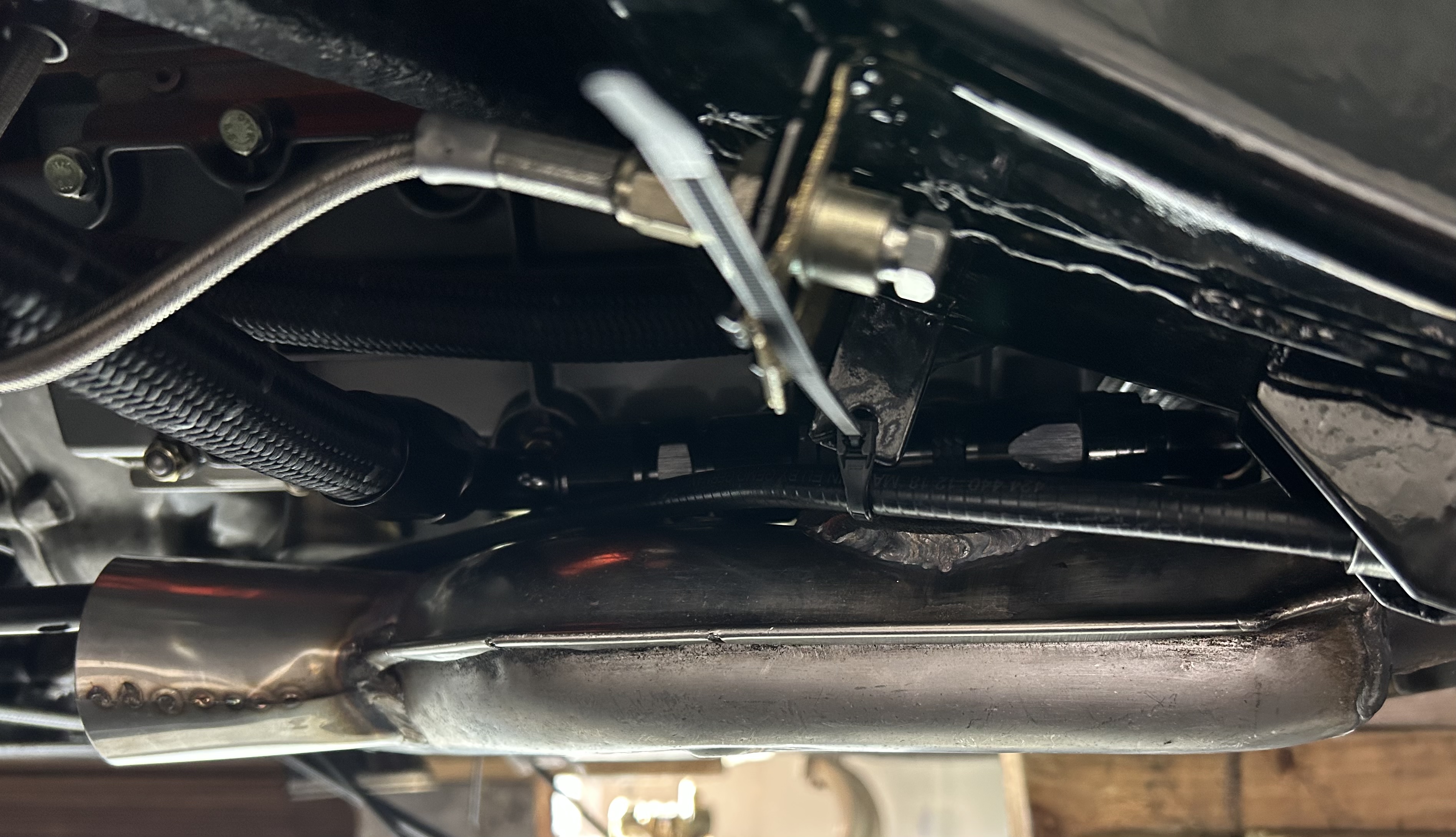

Made some progress

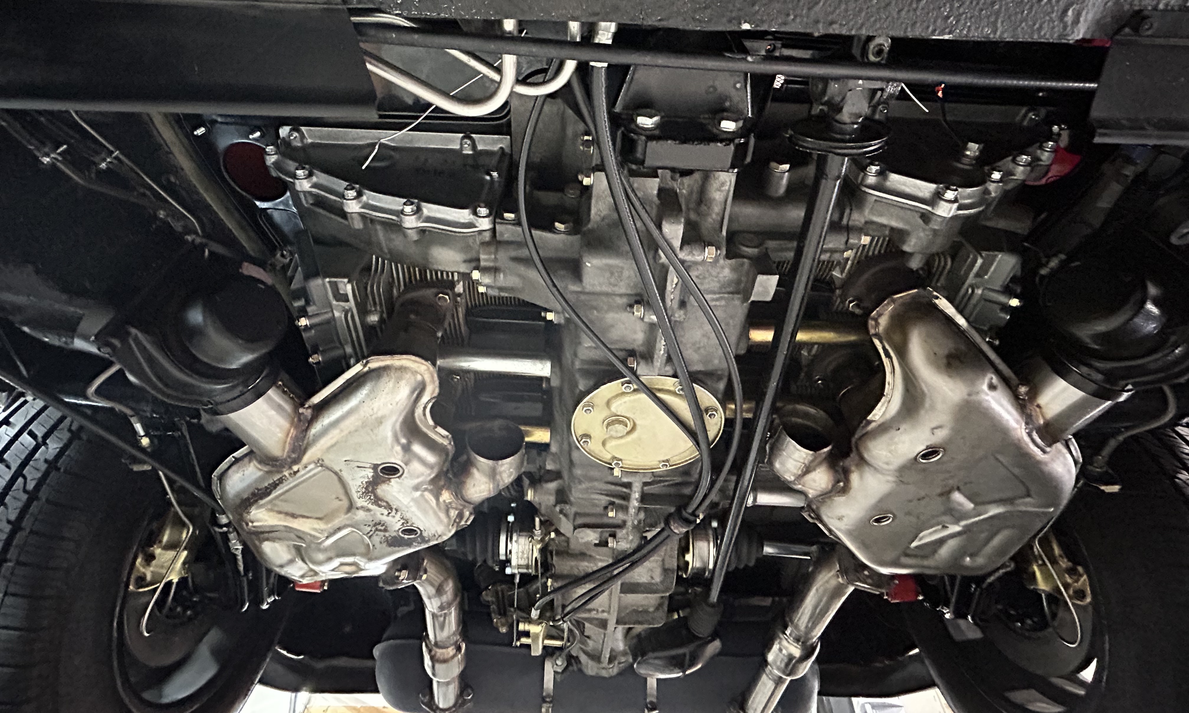

QUOTE(mb911 @ Mar 1 2023, 01:17 PM) *
Made some progress
This is excellent! I have been wanting at least 1 heat exchanger for a year now.
mb911
post Mar 2 2023, 06:26 AM
Post #1298
Posts: 7,794
From: Burlington wi
Member No.: 9,892
QUOTE(nditiz1 @ Mar 1 2023, 05:34 PM) *
Made some progress
Well this would be an option for you. But you would want to run 2 of these. Currently cost on a set of these heat exchangers from what I am seeing is about 500. I got my set for $100 but that was a deal. The work to make these work is time consuming. I have quite a few hours in this but for big engines this is a great solution. For me this is a clean setup and will be nice for my EFI setup.
