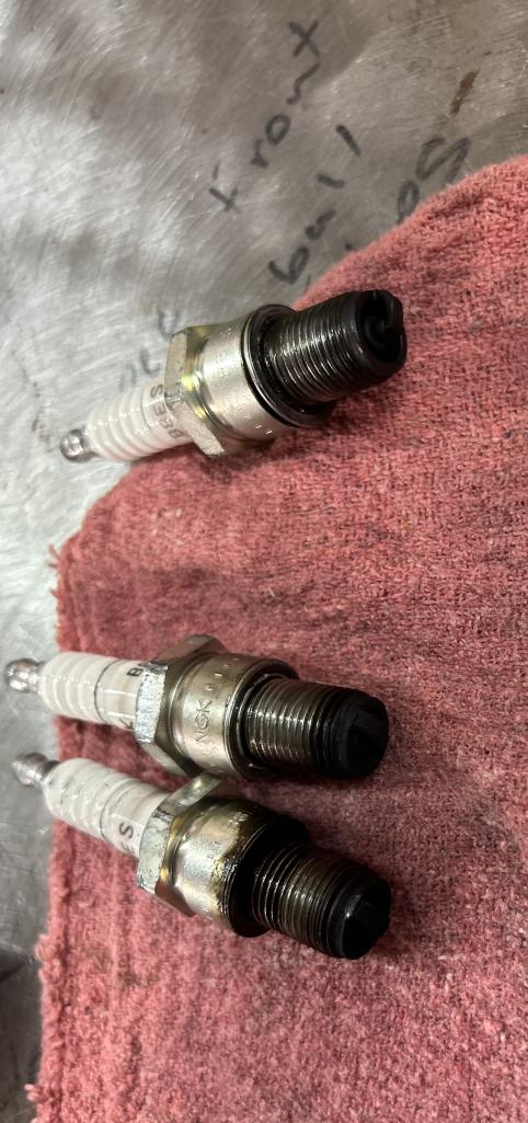

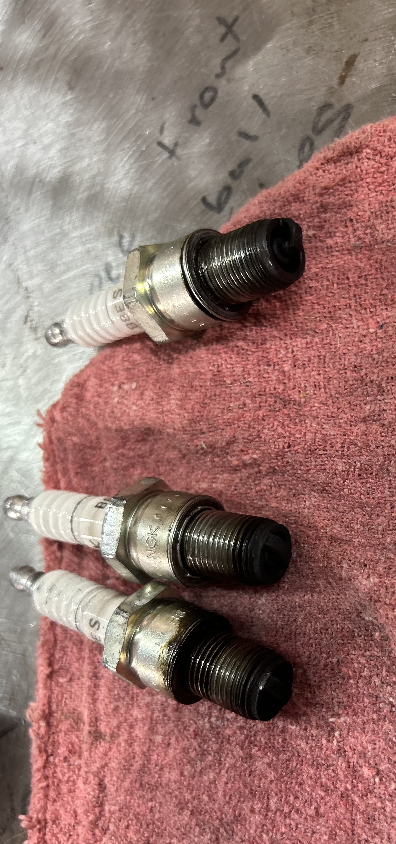

And plugs 4,5,6 time to change out as the I may have had it a bit rich for to long and fouled them out also because they are a pretty cold plug.Attached Image changed out for Br6es and all is good and running better AFRs now

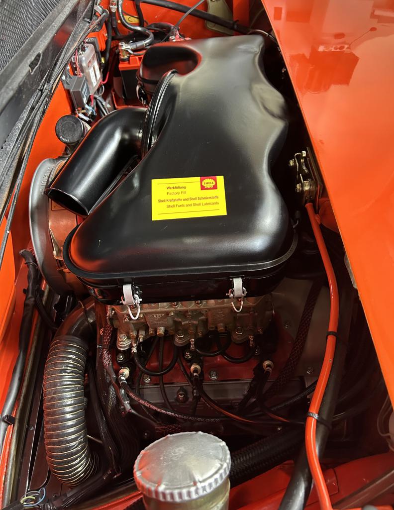

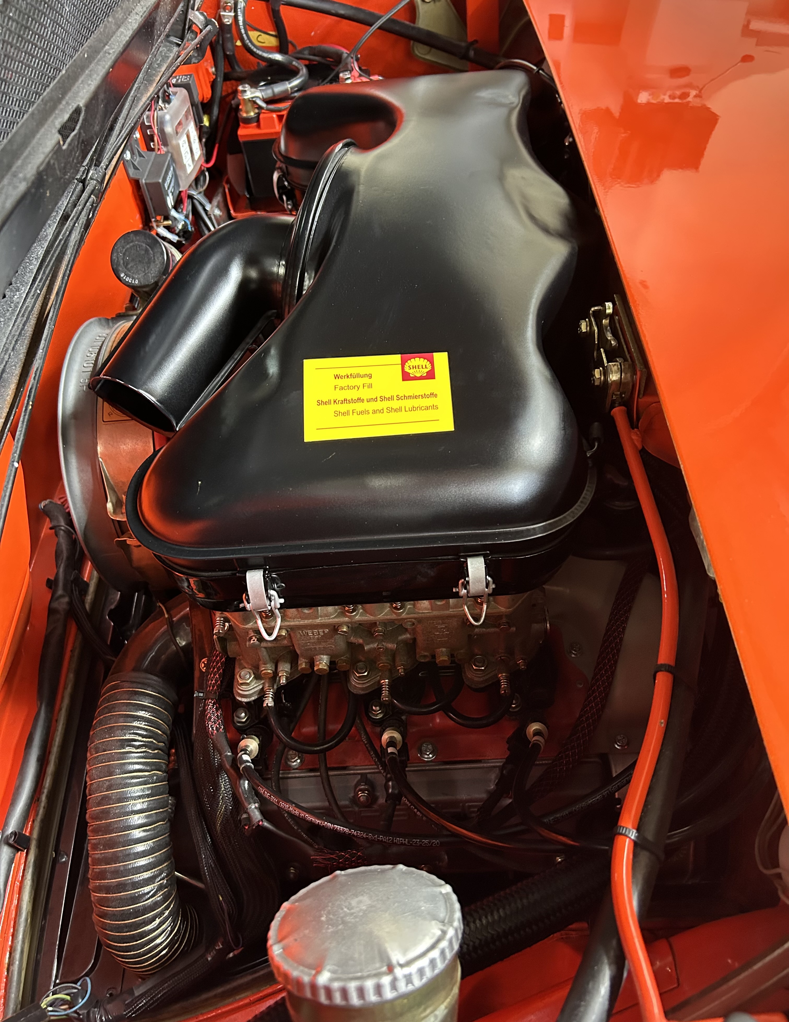

I really love the look of the 6 with the stock air cleaner - your ears will love it too. I also see you went with a satin finish- me like! (IMG:style_emoticons/default/beerchug.gif)
Yes wet sanded the gloss powder then spray max satin over it

Please share how you got it to fit? Mine interferes at cyl #3/firewall. Using Maddog OEM mount. TIA

I can probably get an .060 feeler between
The factory air filter I have just will not fit

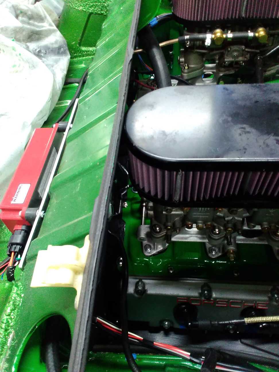

Where did you end up mounting your ECU for the EFI? I am thinking of a couple places...

Right behind the passenger seat near the floor. Great spot and easy to wire

Thanks I like that idea, looks like you just popped a hole at the bottom of the fire wall with an o-ring to seal it up?

There’s a dimple in the pan. It’s where I ran my 3.2 harness.

Yes
