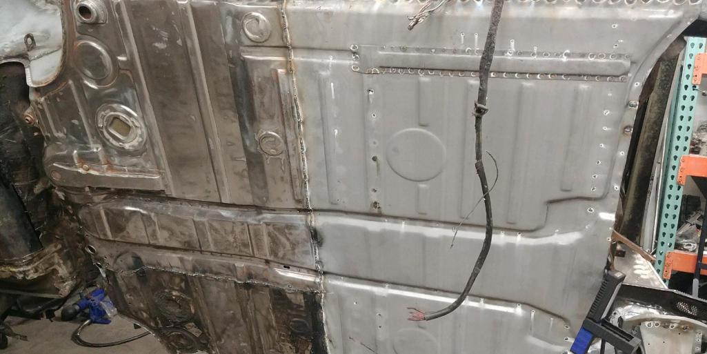

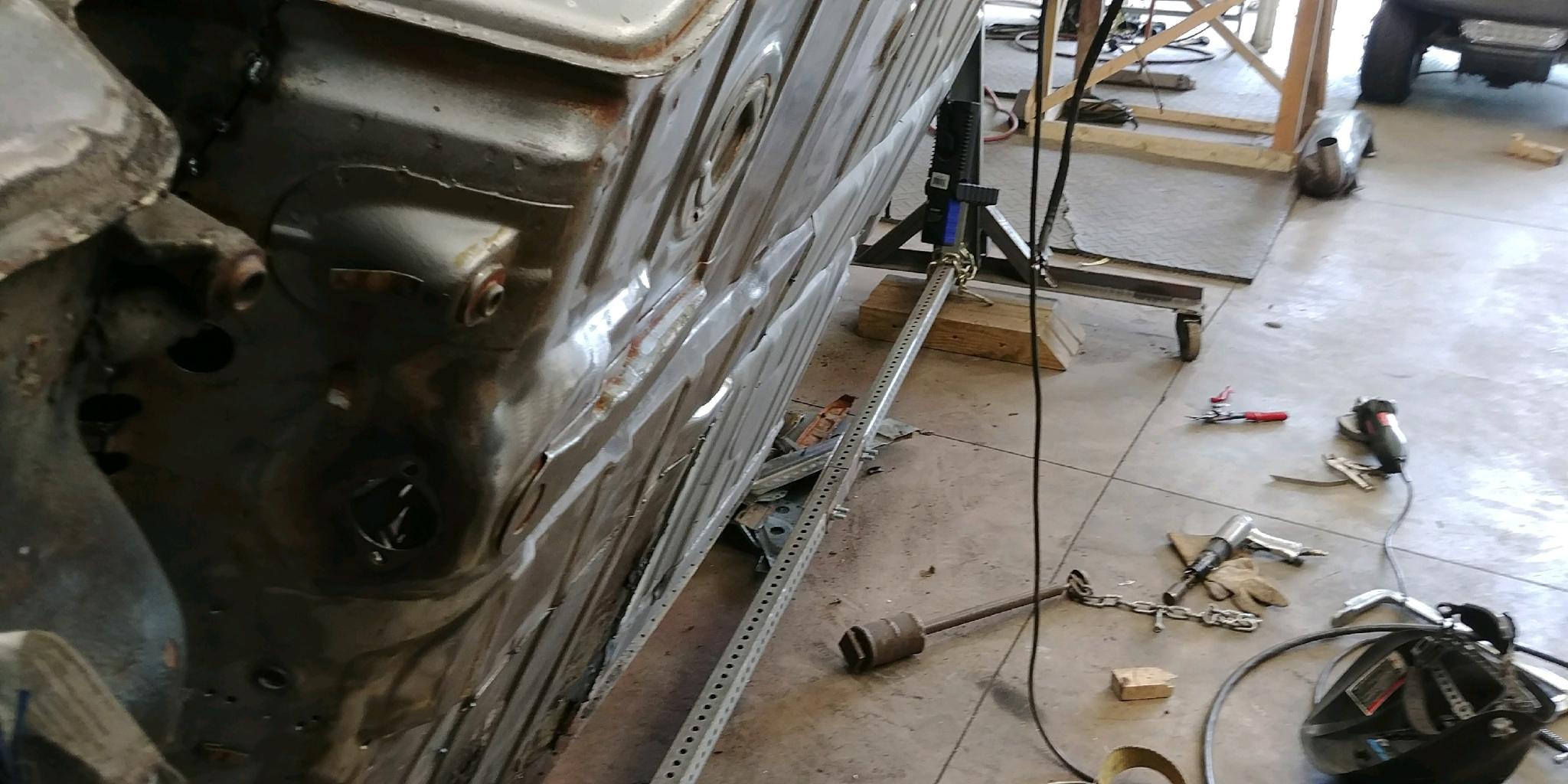

So finally done with the flood damage repair, cam and lifter change out in my suburban, going on our honeymoon after being married for 18 years I am back at it it.. I fit the floor pan section in from chris.. I cut a bit too far in the wheel well but I can fix that easy enough.. Attached Image

Ben - It's really coming along! The floor looks great... (IMG:style_emoticons/default/cheer.gif) But man, that's a big ol' chunk of the car you cut out to fit it. Glad to see the car I parted is going to such good use.

Thats for sure its good that I have it braced pretty well..

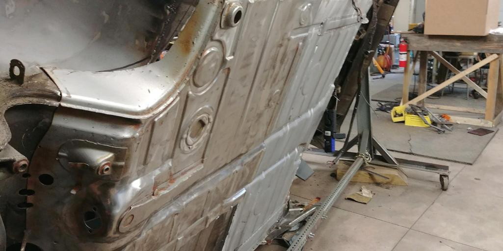

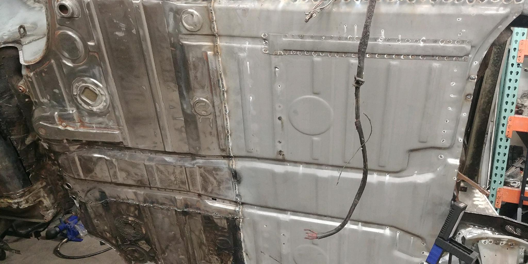

Well its tacked in.. Pretty happy with the fit. Going be really nice once welded and ground and blended. Thanks again Chris for the huge help.. Even if I would have bought a front floor pan from RD it would have not come with the metal I needed.. So i saved about 1/4 of the orginal floor pan.. Attached Image Attached Image

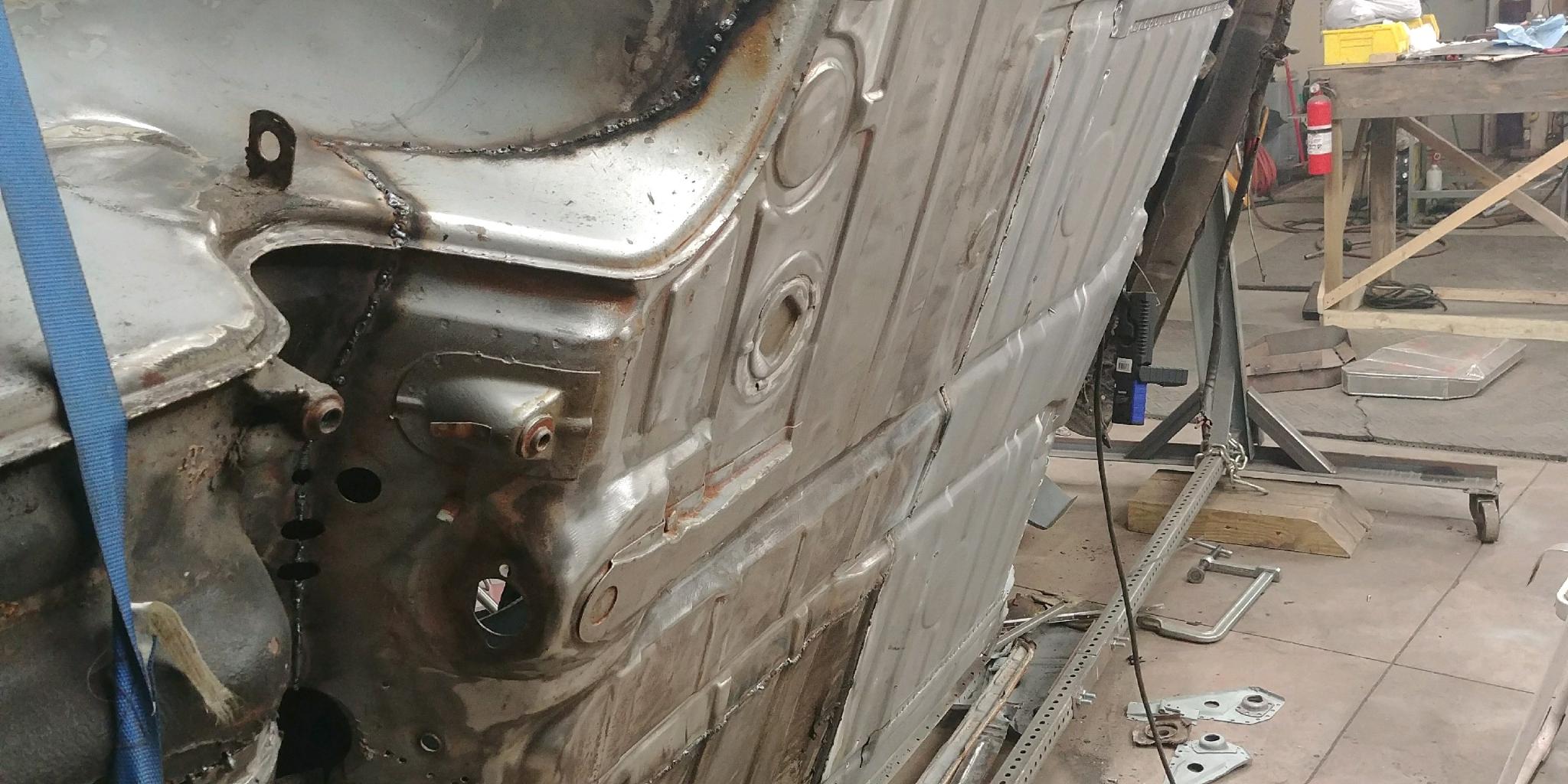

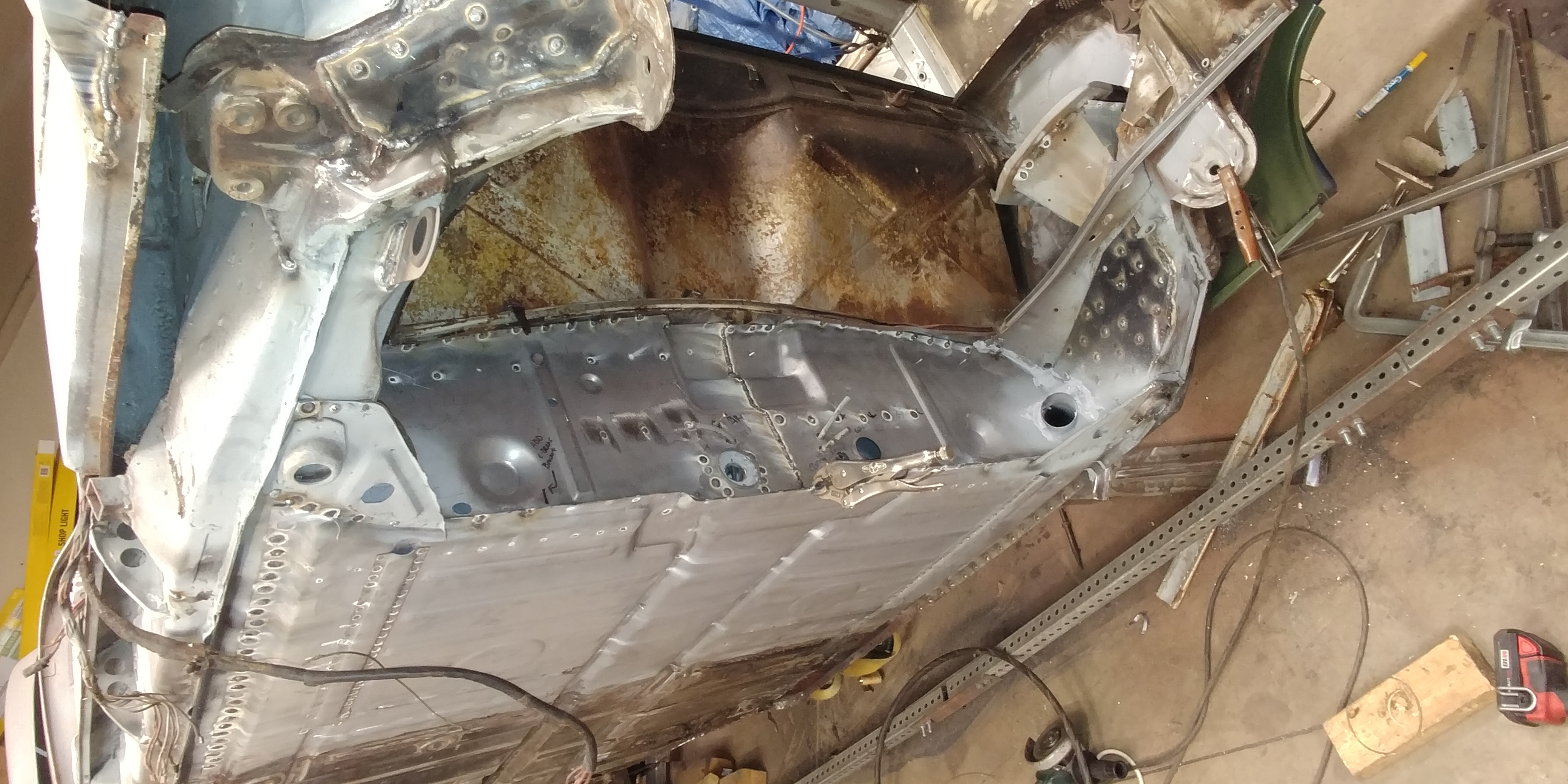

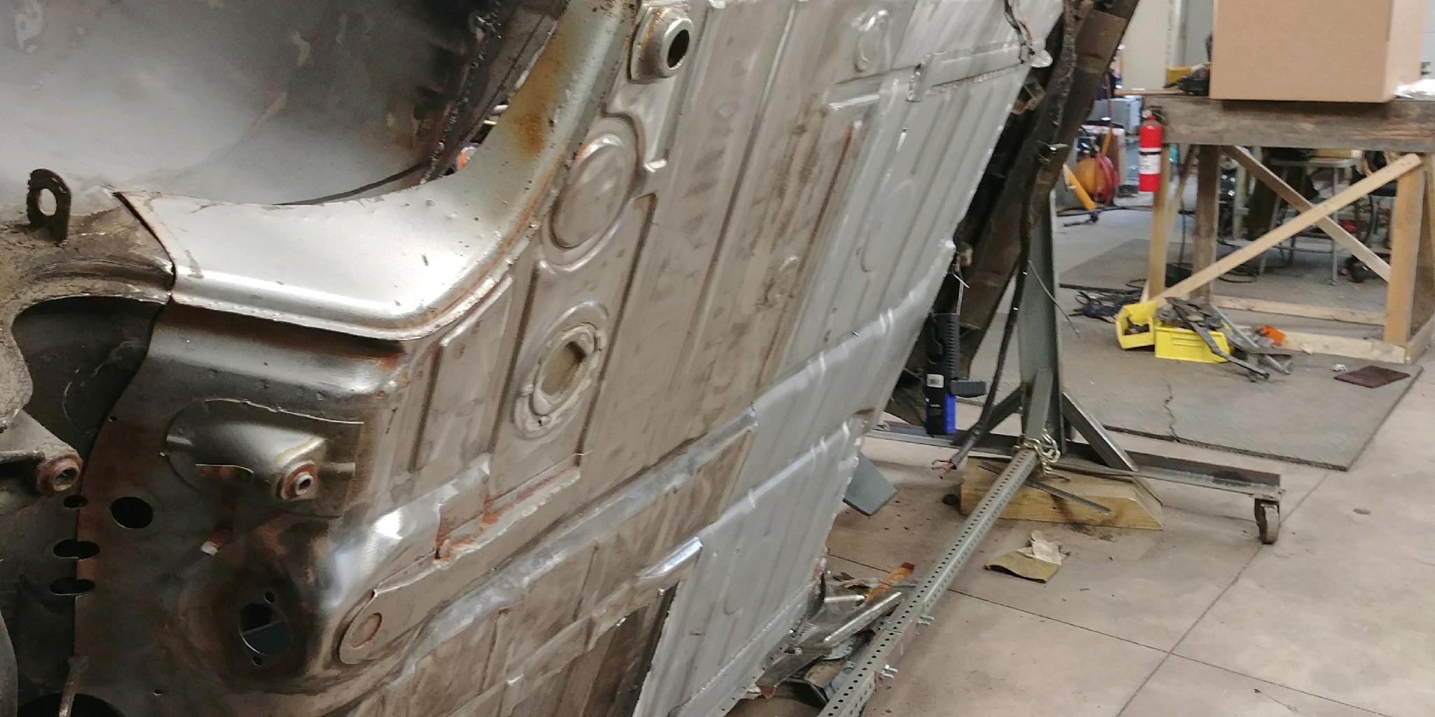

And now its completly welded in.. Now to grind and blendAttached Image Attached Image

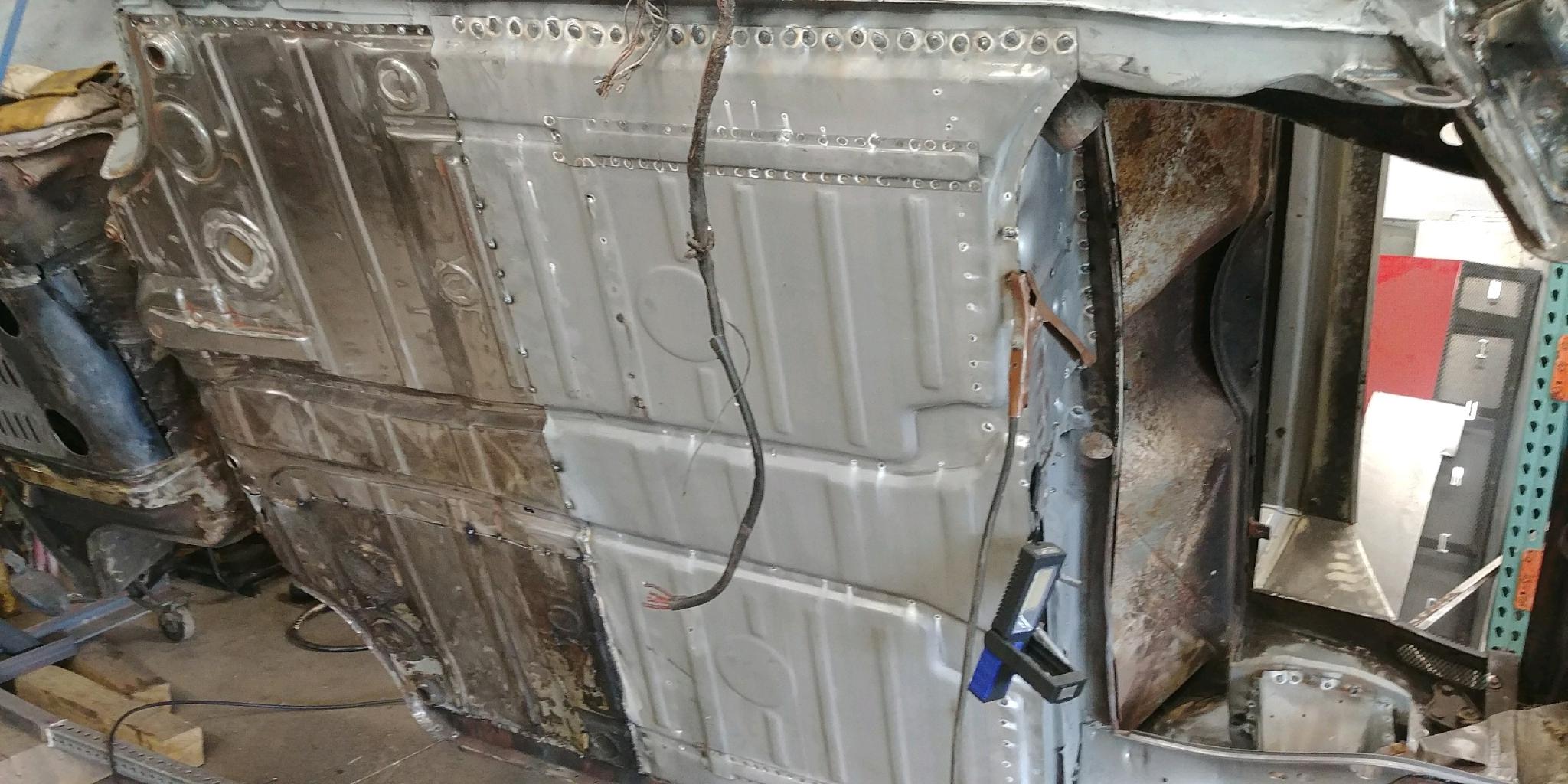

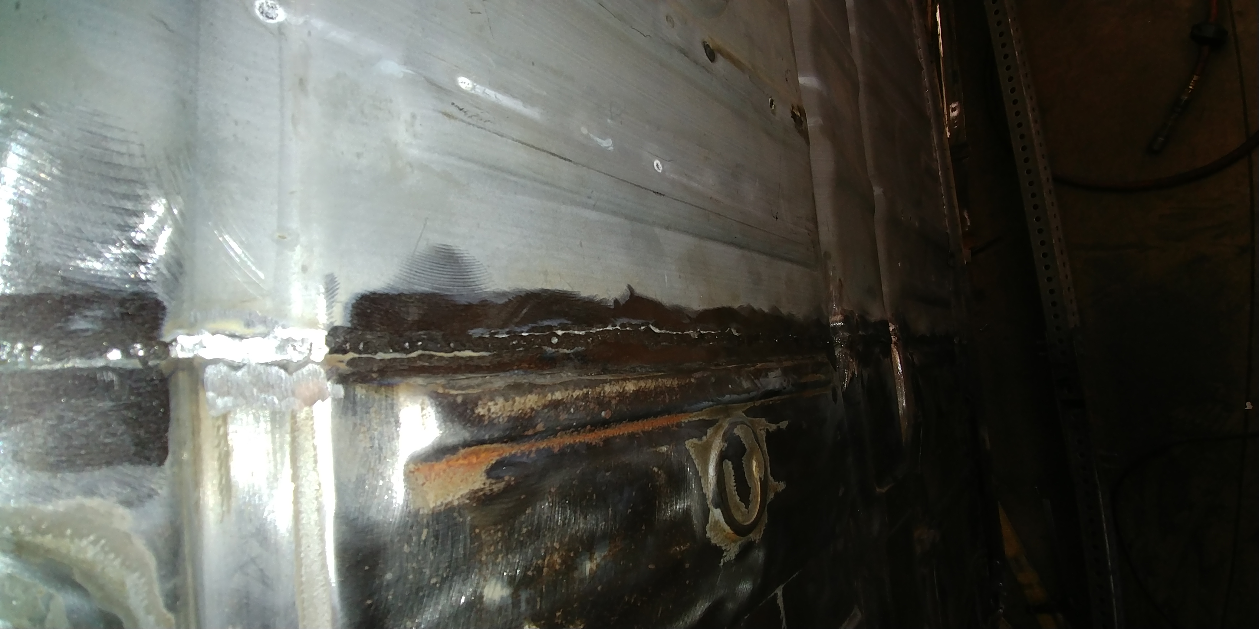

Taking the grinding really slow as if you rush it the seem will be noticable .. 1st step is to take the high spots off the weld with a 4.5 " grinder. Once thats done I use a die grinder with an abrasive wheel to further knock it down.. Next step is a blending disc and then check for any pinholes..
Once this is done only have half the firewall to weld on and the jack points and then done underneath the car.. Attached Image

And now other firewall half in along with tge chassis reinforcement plates.. I think welding will be wrapped up by the start of winter..Attached Image

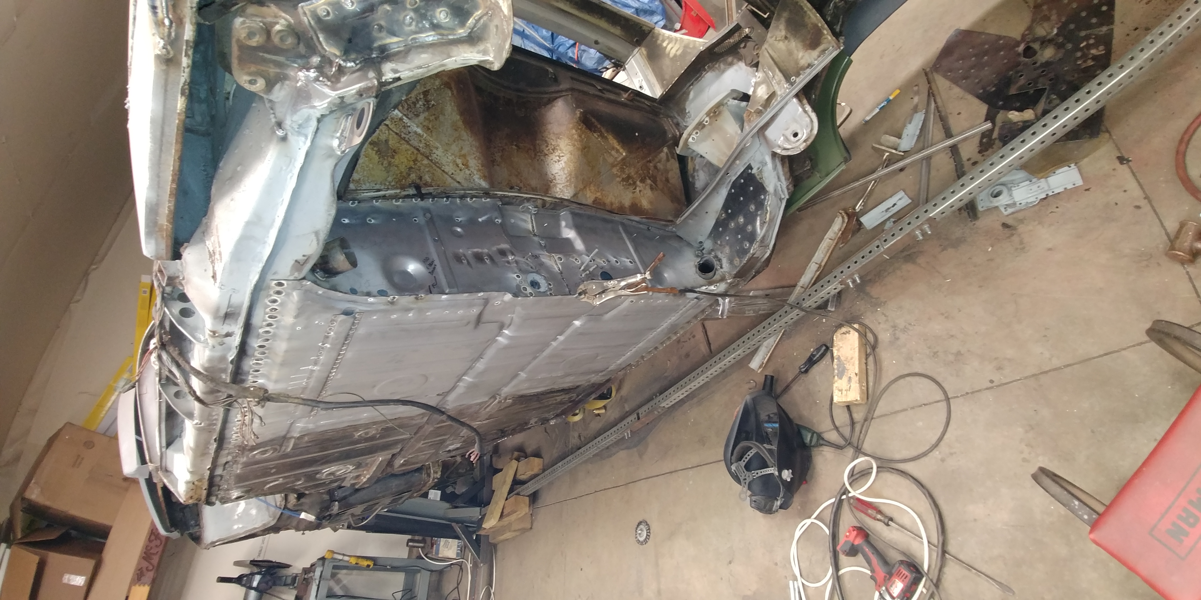

A little more progress.. The triangle jack plates are tacked on.. Once welded going to have a bunch of grinding to do..Attached Image

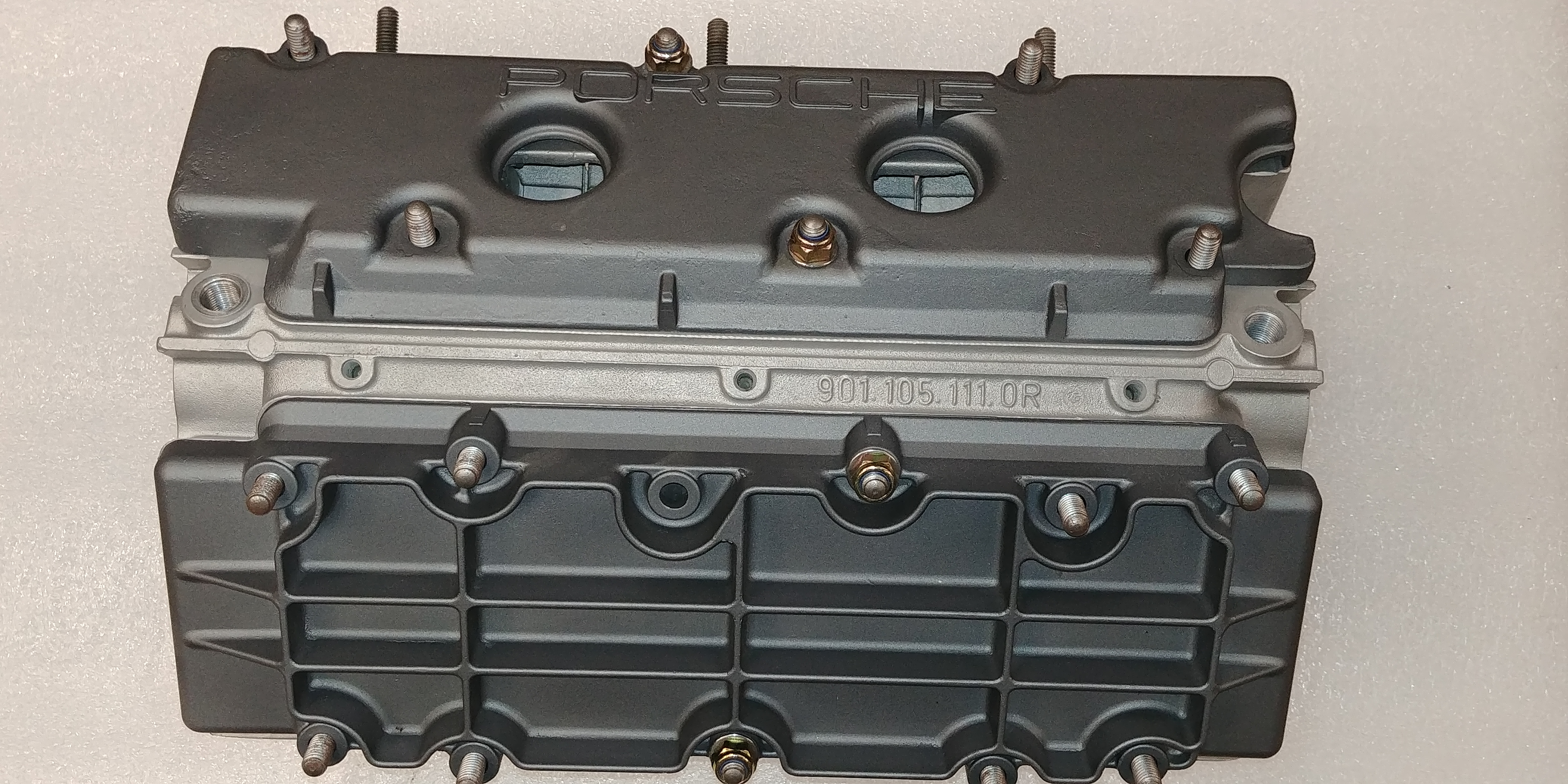

Took a little break from welding and grinding and put 1 head set together. I prefer to preassemble the whole assembly vs how waynes book suggests.. Attached Image

I need to now source the "freeze" plugs for the cam towers..
