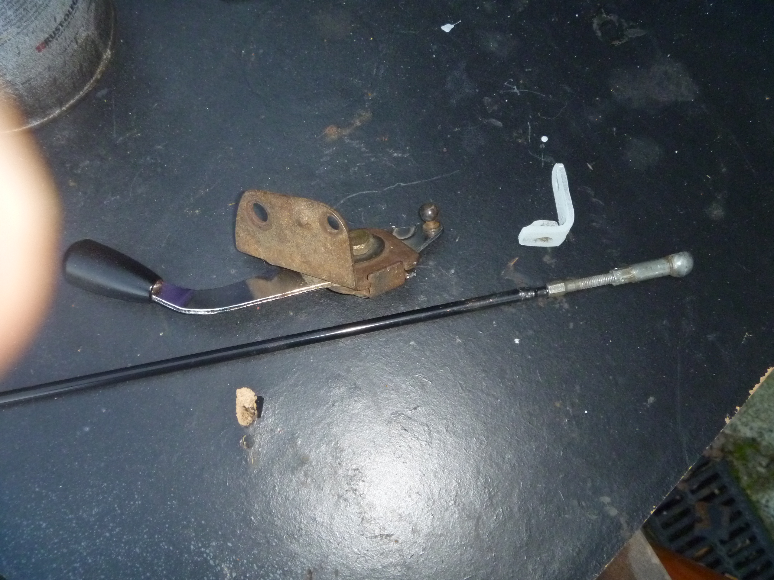

Real easy to make....man of your skills (IMG:style_emoticons/default/biggrin.gif)
Used and old carb linkage for the ball and socket,so handy for starting and warming your engine up,really like mine.

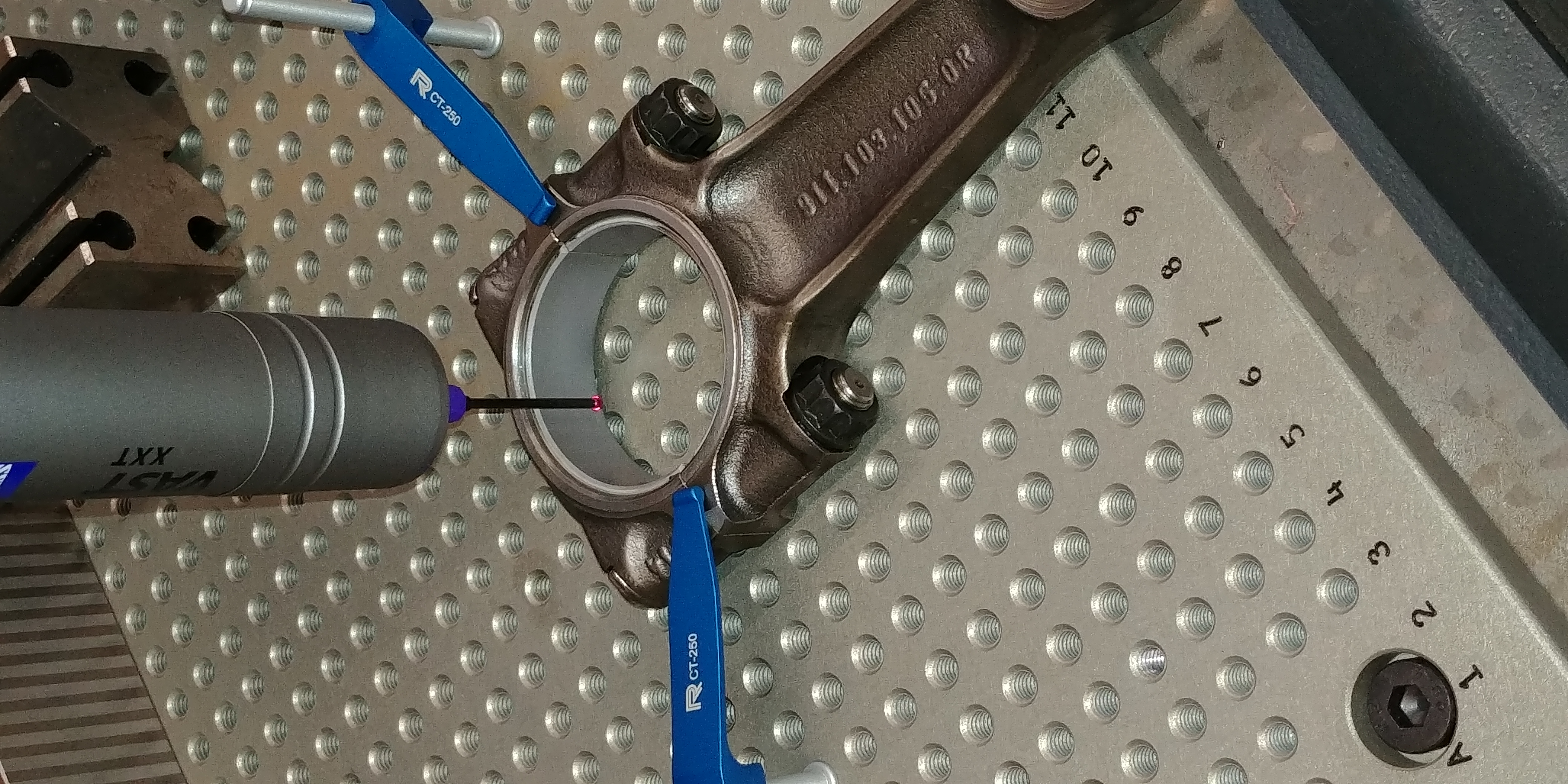

And here is the shot of cmm checking roundness and diameter.Attached Image

QUOTE(mb911 @ Sep 22 2017, 04:28 PM) *
Ohhhh... Very nice! (IMG:style_emoticons/default/wub.gif) (IMG:style_emoticons/default/pray.gif)

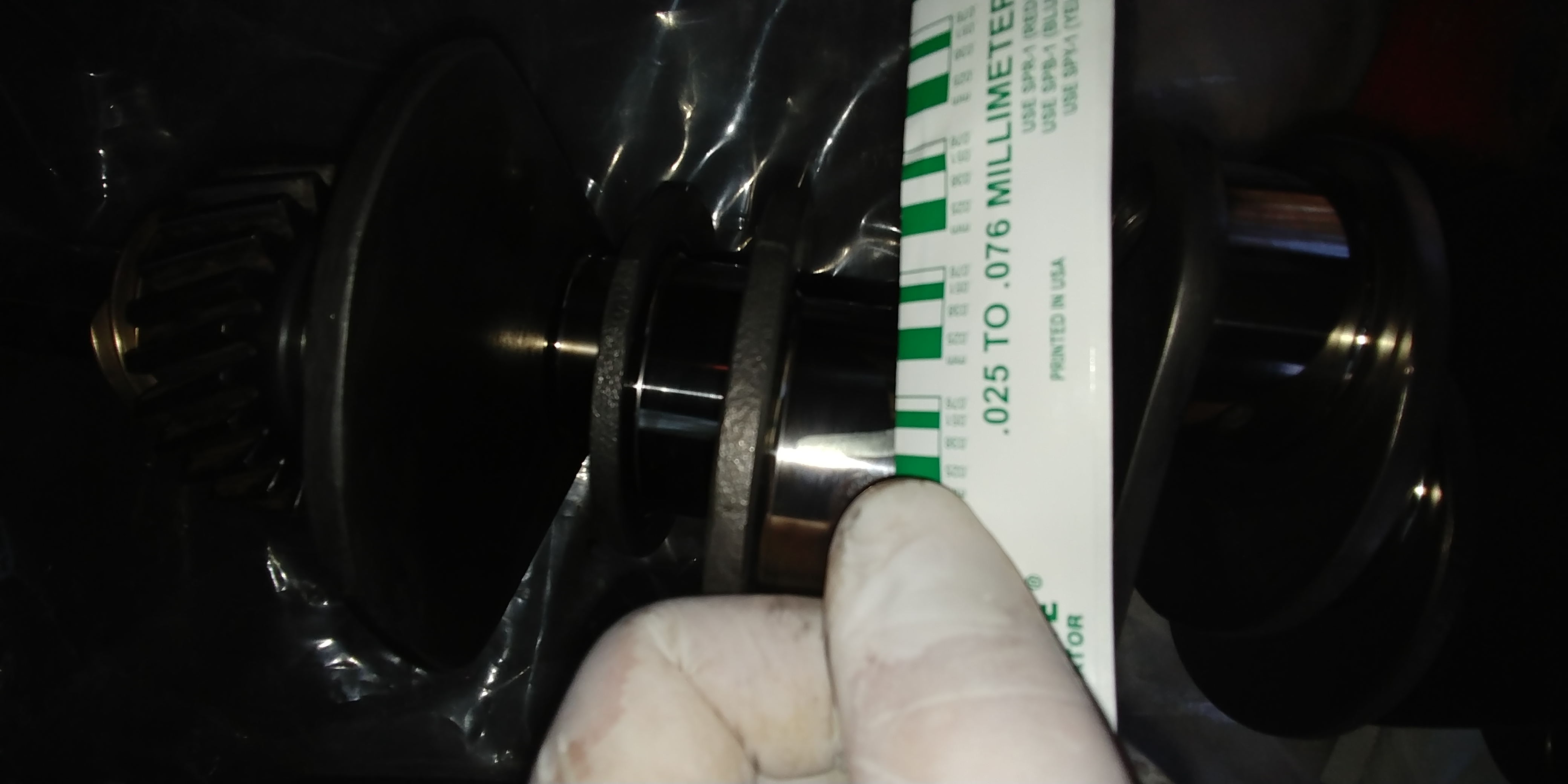

Confirmed that everything is round. Need to do plasti gauge to confirm clearance as rods were not torqued..

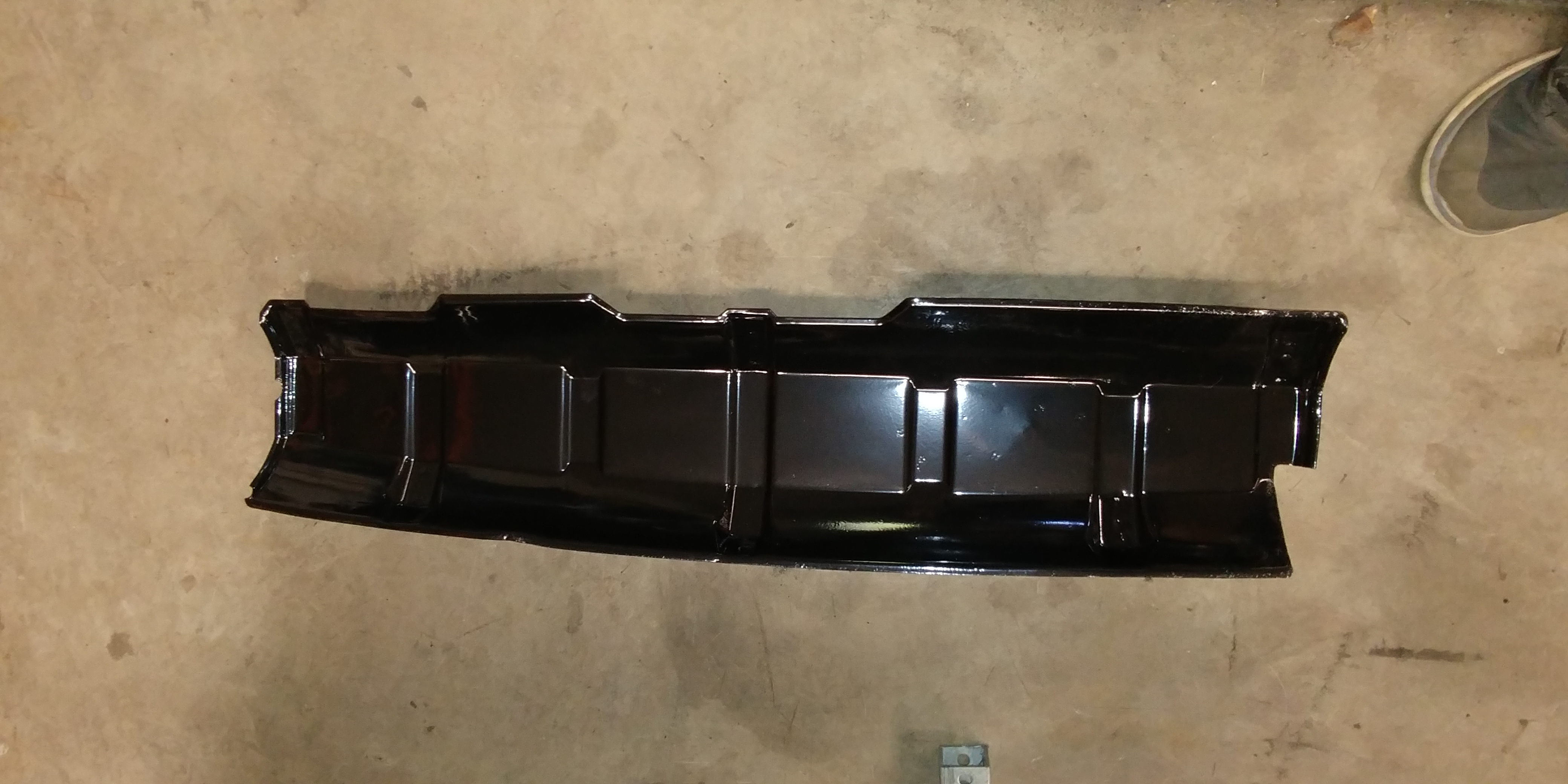

I know kind of a waste but powdercoated both sides of the muffler heat shield before installationAttached Image

post Sep 23 2017, 10:36 AM
Post #208
Michael
Posts: 10,748
Joined: 1-November 08
From: Auburn, CA
Member No.: 9,712
Looks nice- not a waste in my book.
raynekat
post Sep 23 2017, 10:43 AM
Post #209
Posts: 2,171
Joined: 30-December 14
From: Coeur d'Alene, Idaho
Member No.: 18,263
I agree....not a waste.

mb911
post Sep 23 2017, 11:18 AM
Post #210
Posts: 7,804
Joined: 2-January 09
From: Burlington wi
Member No.: 9,892
Thanks everyone.. It is turning into a decent car.. Though it is a Frankenstein it will still be very nice when done years down the road..

QUOTE(mb911 @ Sep 22 2017, 12:22 PM) *
Where does it connect too.? I need to see both ends so I can start planning. (IMG:style_emoticons/default/biggrin.gif)
Lever handle fits under the shifter in to a locating recess,handle go's up through the front of the shifter base,from memory my lever is the straight type,some are curved and maybe don't work,sorry don't know the year of my one.
Front guide piece for the rod fits in a hole that all 914's have (?),I didn't use a bush in this piece as per original and it works fine ,mines adjusted for 1500rpm.
I can measure all this up if you like as I have the assembly out of the car @ the moment (IMG:style_emoticons/default/beer.gif) .

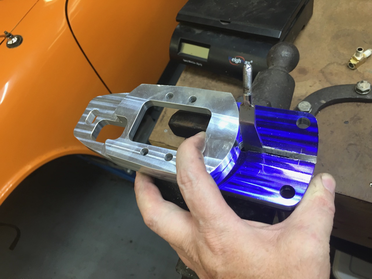

Ben,
Goes under the shifter base at the front. Now if your using a Rennshifter you will need to modify the base. Wish J-West did this for you.
But this is what I did to my Rennshifter to make the hand throttle work for me.
Everything else is looking great, your making nice progress

Ah I get it now... Guess need to find a lever..
Double checked crank vs rods with plasti gauge and though the picture is garbage it is perfect spec..

QUOTE(mb911 @ Sep 23 2017, 09:24 AM) *
Ben, I don't think its a waste. Most I see are pretty raty and rusty.

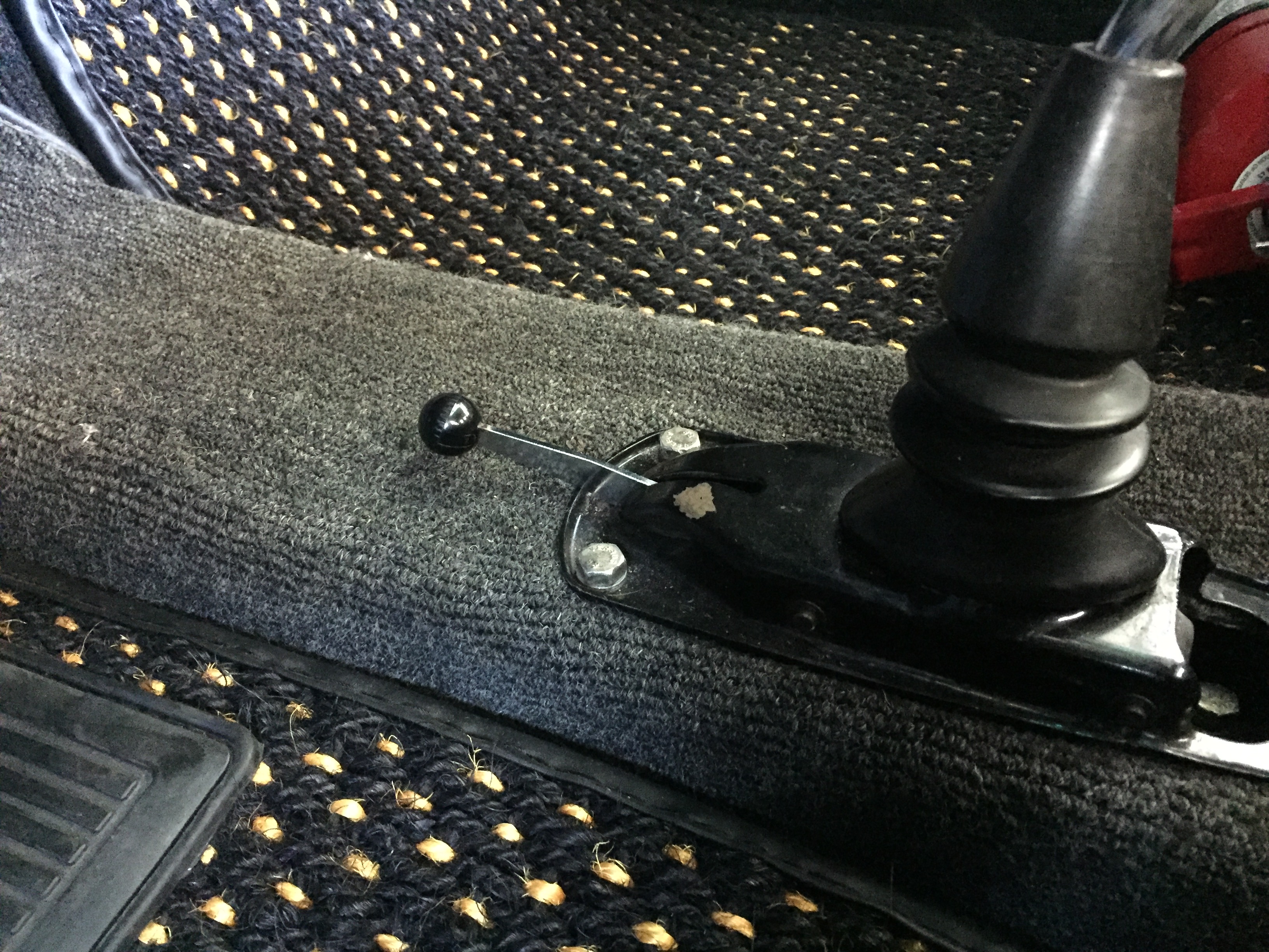

I used an original 914-6 bracket, rod, and pedal part (with the flap.)
My lever is 911 and works great. Really handy for cold warm-ups.

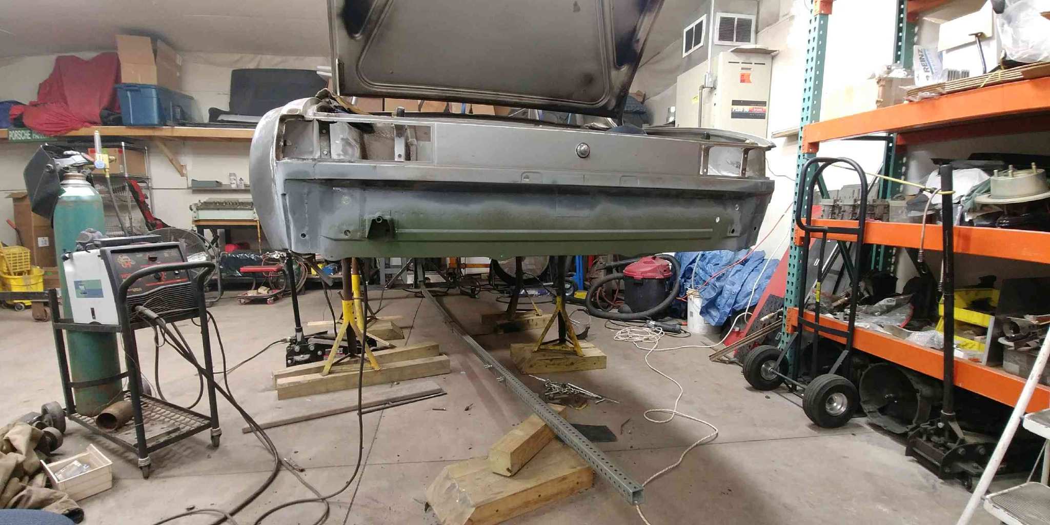

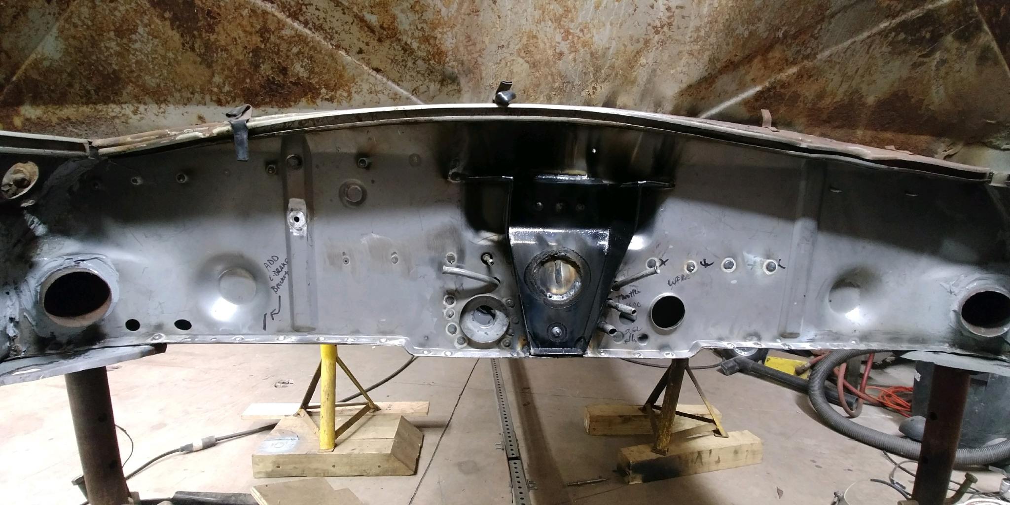

Spent a few minutes installing a new section of metal.. Need to fab a few pieces to complete.. Next week though gone the rest of the weekAttached Image

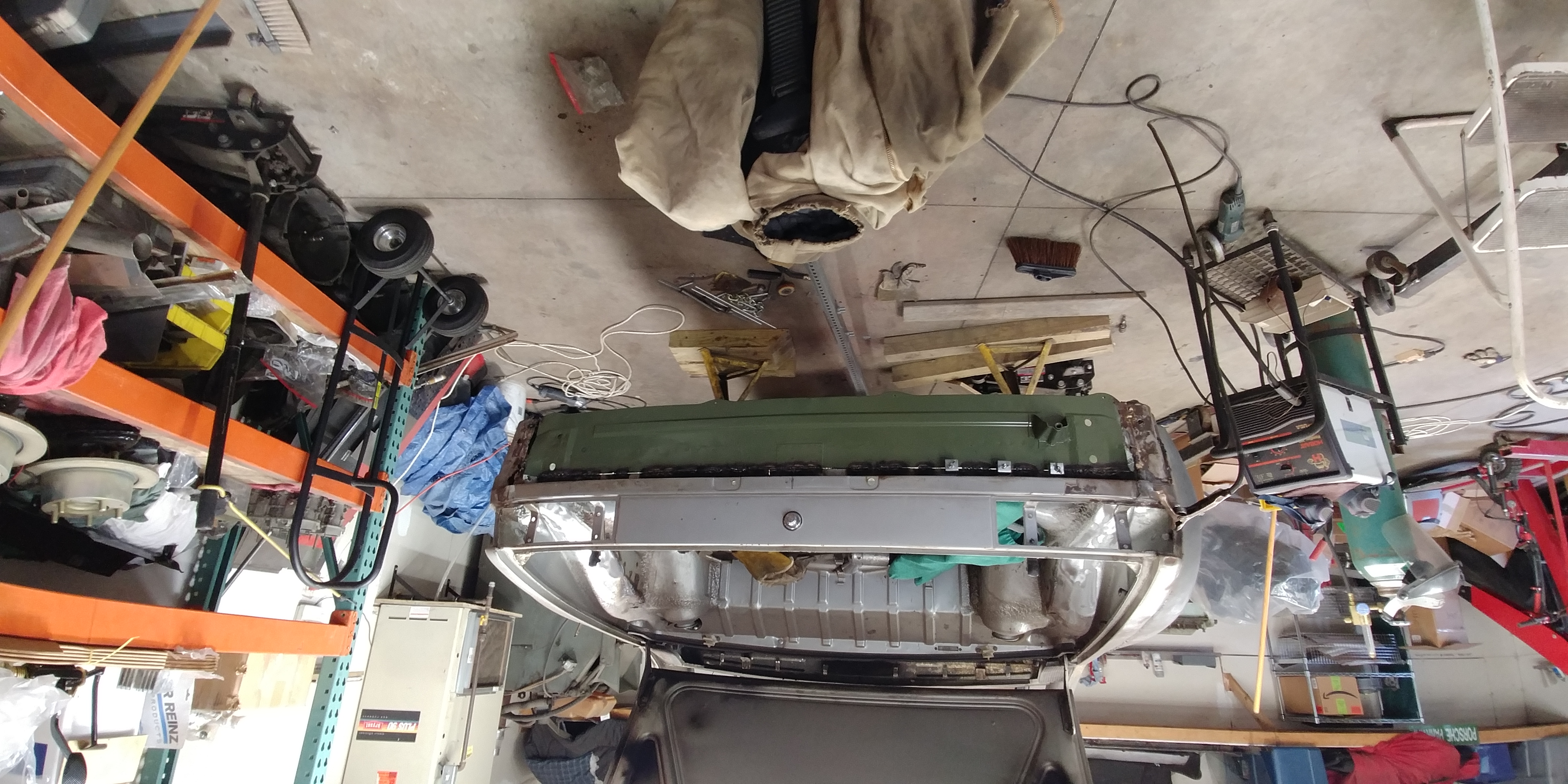

Spent some time finishing rear panel and installing engine mount.. Attached Image Attached Image

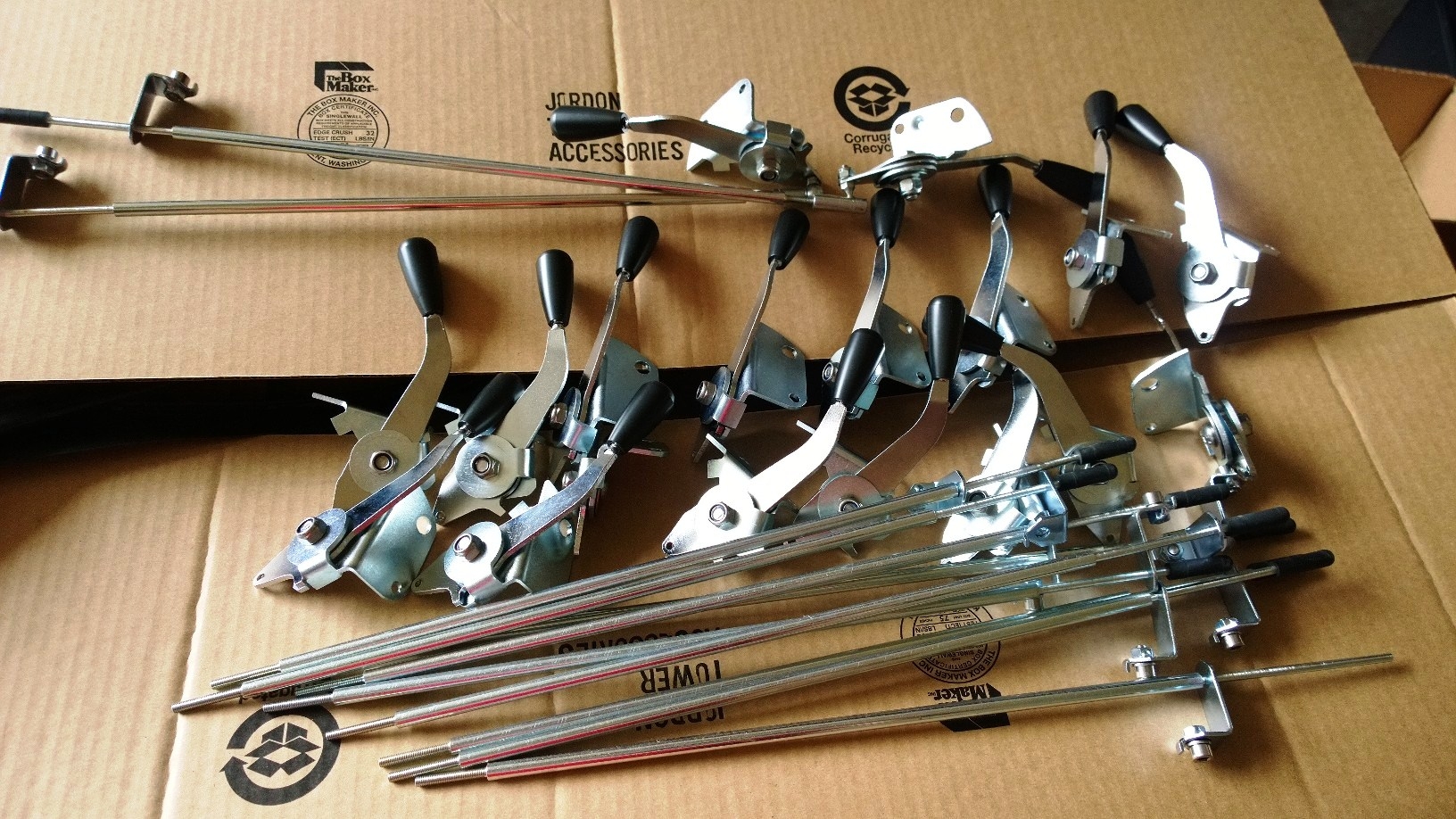

The discussion and photos regarding the hand throttle caught my attention. I guess I never really understood how the linkage was supposed to work, until I checked the system offered by 914Rubber.com. Here are the photos from Mark's (mikey914) site.
tygaboy
post Oct 3 2017, 08:09 AM
Post #220
Posts: 5,847
Joined: 6-October 15
From: Petaluma, CA
Member No.: 19,241
Little by little, it comes together... (IMG:style_emoticons/default/welder.gif)
Engine mount looks good on that shiny new fire wall!
