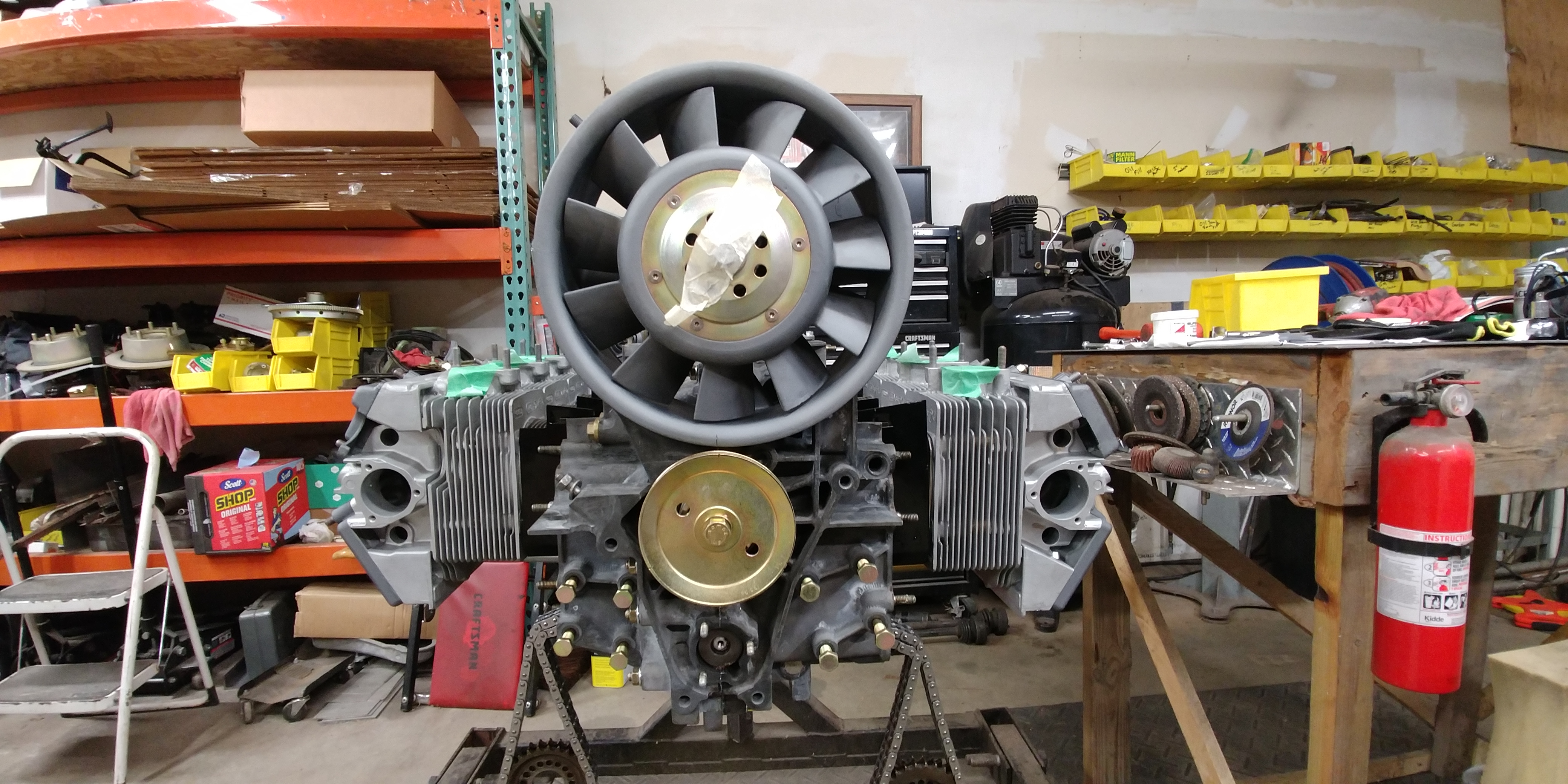

Did deck heights on cylinders 1,2,3 today and put heads on that bank. Waiting on shims for 4,5,6..

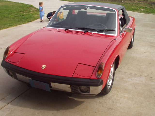

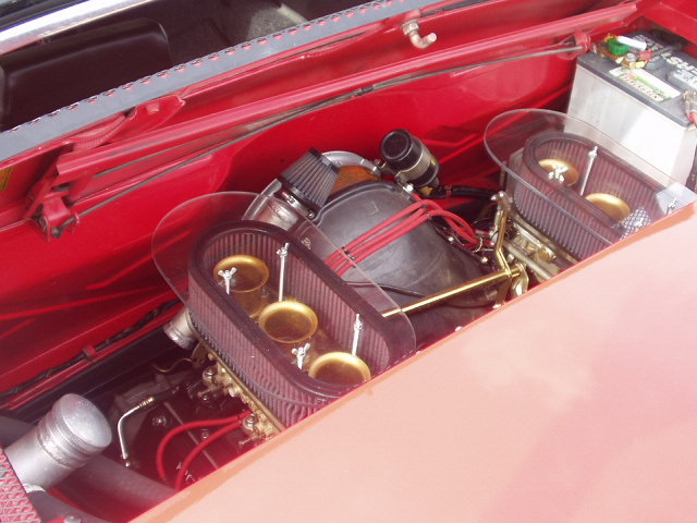

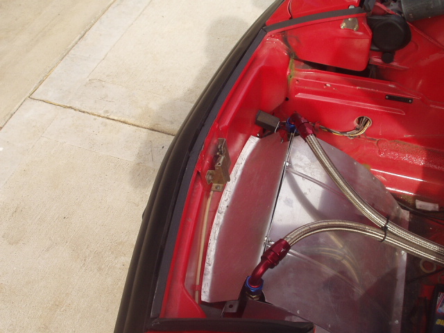

So I thought I would post pictures of my last 6. This what drives me to finish this car..Attached Image Attached ImageAttached ImageAttached Image

Was by far the nicest one I had seen in the Midwest ever..

Great looking car! Converting a ‘73 or ‘74 Car is probably the best way to get a great -6 and it looks like you did it right.

This was a 75 chassis that was a roller from new mexico..

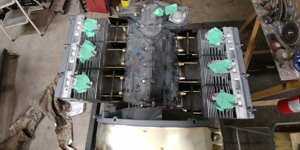

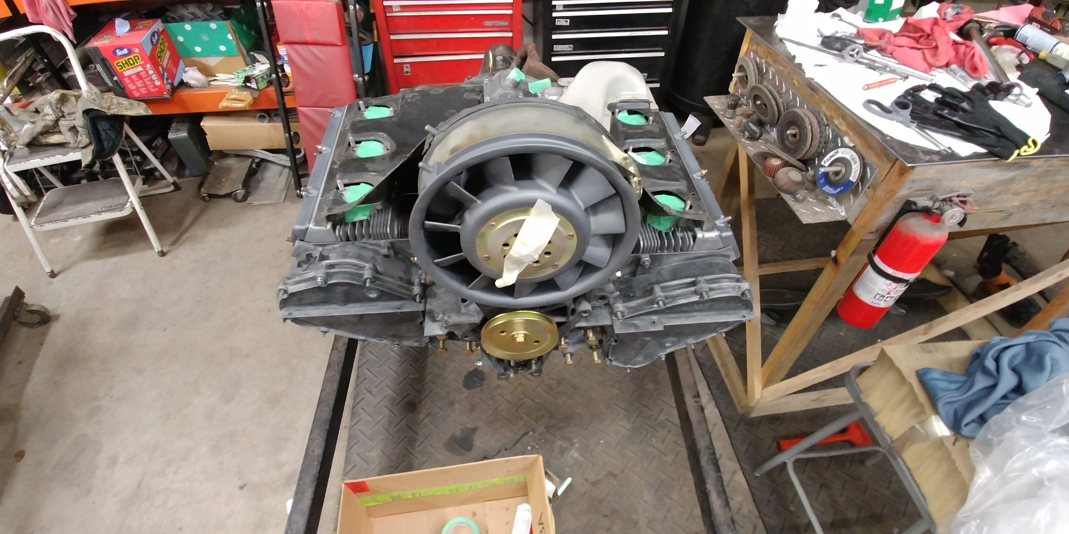

I spent an hour this morning torquing the heads/install 4,5,6 .. Installed the cam plugs(thanks Mark) and now just a few other things to tidy up as I wait for the rockers to be done.. I need to get back to grinding/some welding so that I can get this in primer..Attached Image

I also have notes written on the case as to order of pistons install and then actual cylinder locations and checks for install of circlips. This was done based off of when I have time and when I have to walk away to work on something else/family etc. I don't typically spend more than an hour at a time working on it and its hard to remember if you don't have notes..

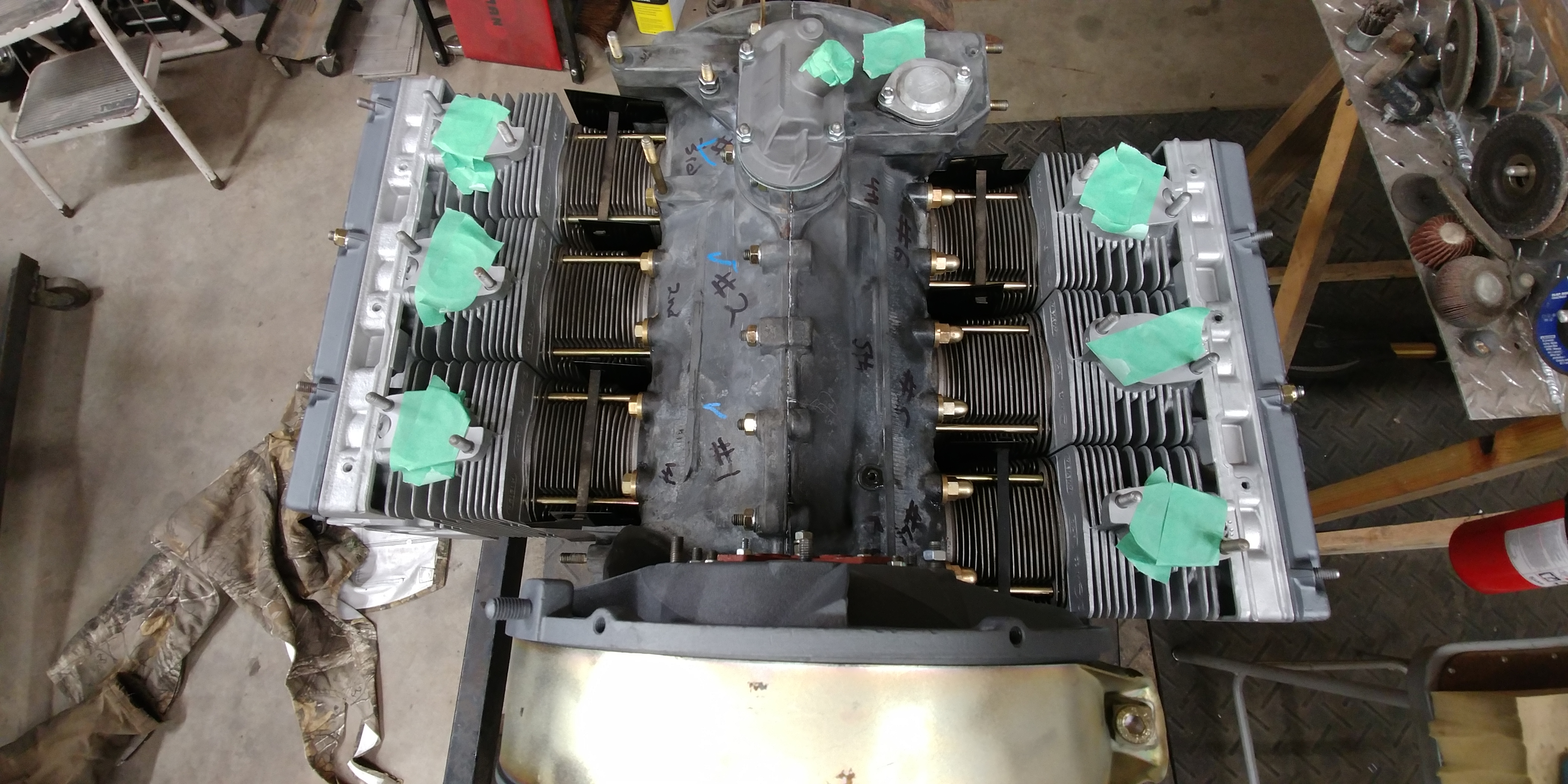

Got a little bit more done. Cams are in but don't have rockers on.. No engine cooler on yet. I need to have the one I have professionally cleaned.. Now done on the engine for a while.. Grinding is now ready to start..Attached Image

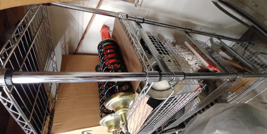

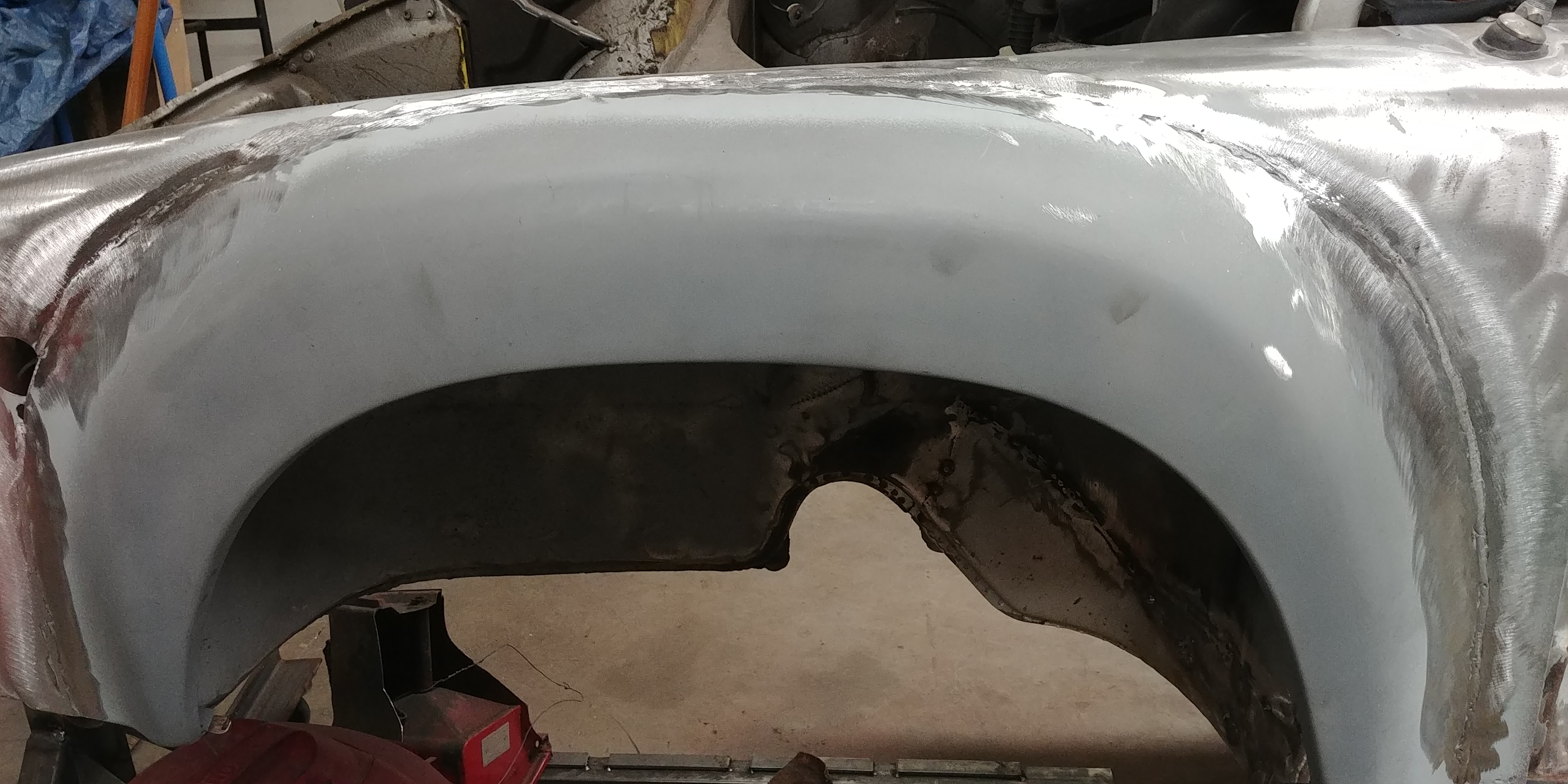

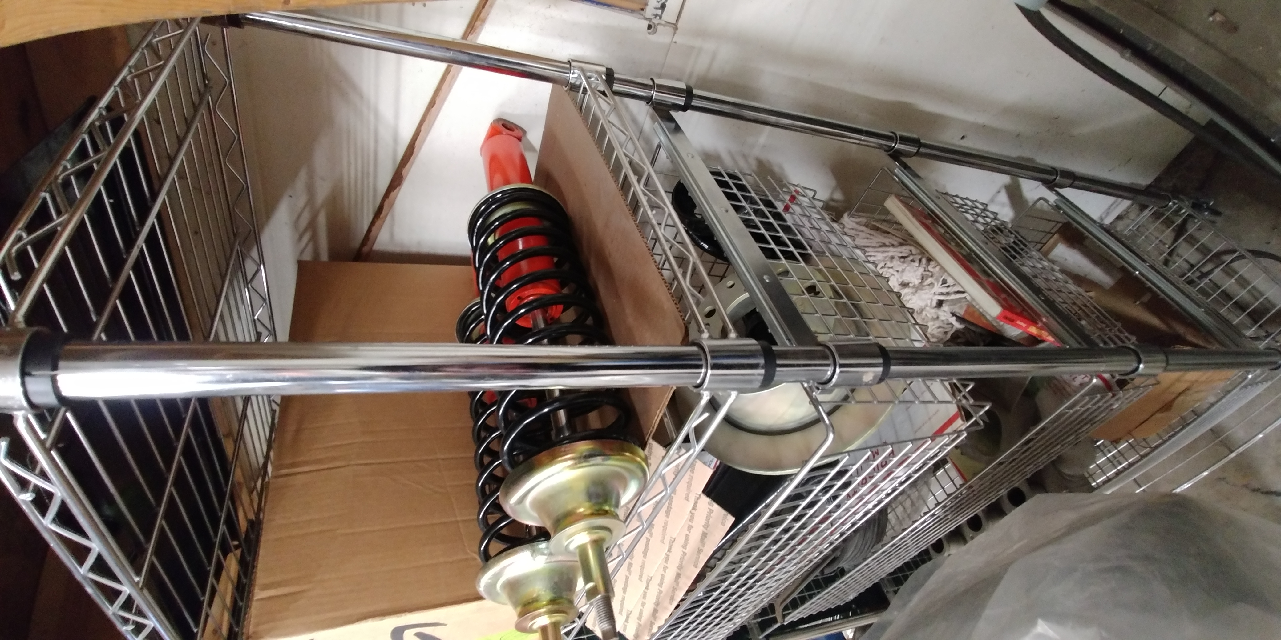

So a little update but no pictures as of right now.
Restored the rear konis I recieved from michael.
Put the powdercoated springs on I got from greg
Shocks are complete with replated and repainted everything
Put the engine in the corner on a different engine stand until I am ready for it..
Welded in patch right by the roll bar above door handle pocket on driver side

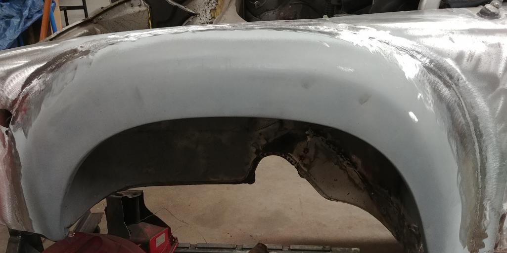

Ground all the flare welds down and started hammering out with hammer and dolly. Heated a few areas that were not coming along.
Made reinforcement for rear suspension pick up ears
Now second guessing my rear trunk panel may have to buy a new one after the holidays are done..
Reassembly of replated and powdercoated seat rails..
Took apart the steering rack , cleaned, inspected and ceramic painted. Will reassemble this week with fresh grease
Cleaned the shop.. So making progress

A few little pictures.
mb911
post Nov 30 2017, 04:43 PM
Post #277
Posts: 7,804
Joined: 2-January 09
From: Burlington wi
Member No.: 9,892

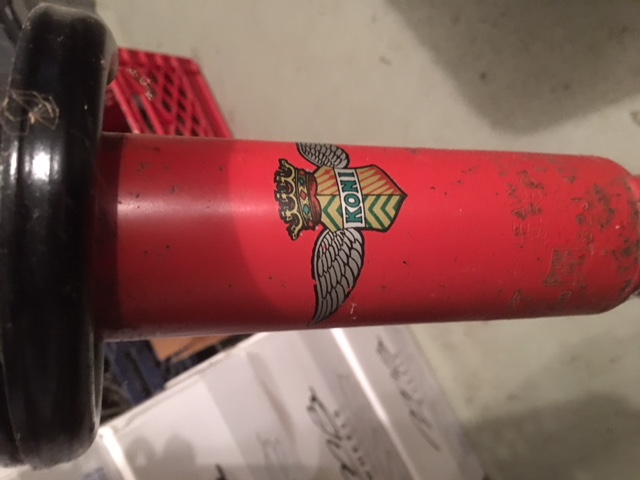

Just curious, did you rebuild the Konis when you restored them? I have a set dated 8/70 that I don't want to do anything to until I know the original style decal is still available. I haven't been able to find it anywhere, and I don't want to send these in for a rebuild if the label would be replaced with a newer one. These were made in Holland.
mb911
post Dec 1 2017, 06:20 AM
Post #279
Posts: 7,804
From: Burlington wi
Member No.: 9,892
I was unable to find those stickers but the newer version sticker is available..

Carbone will replicate those for you if you can give them a good example of image and size.
