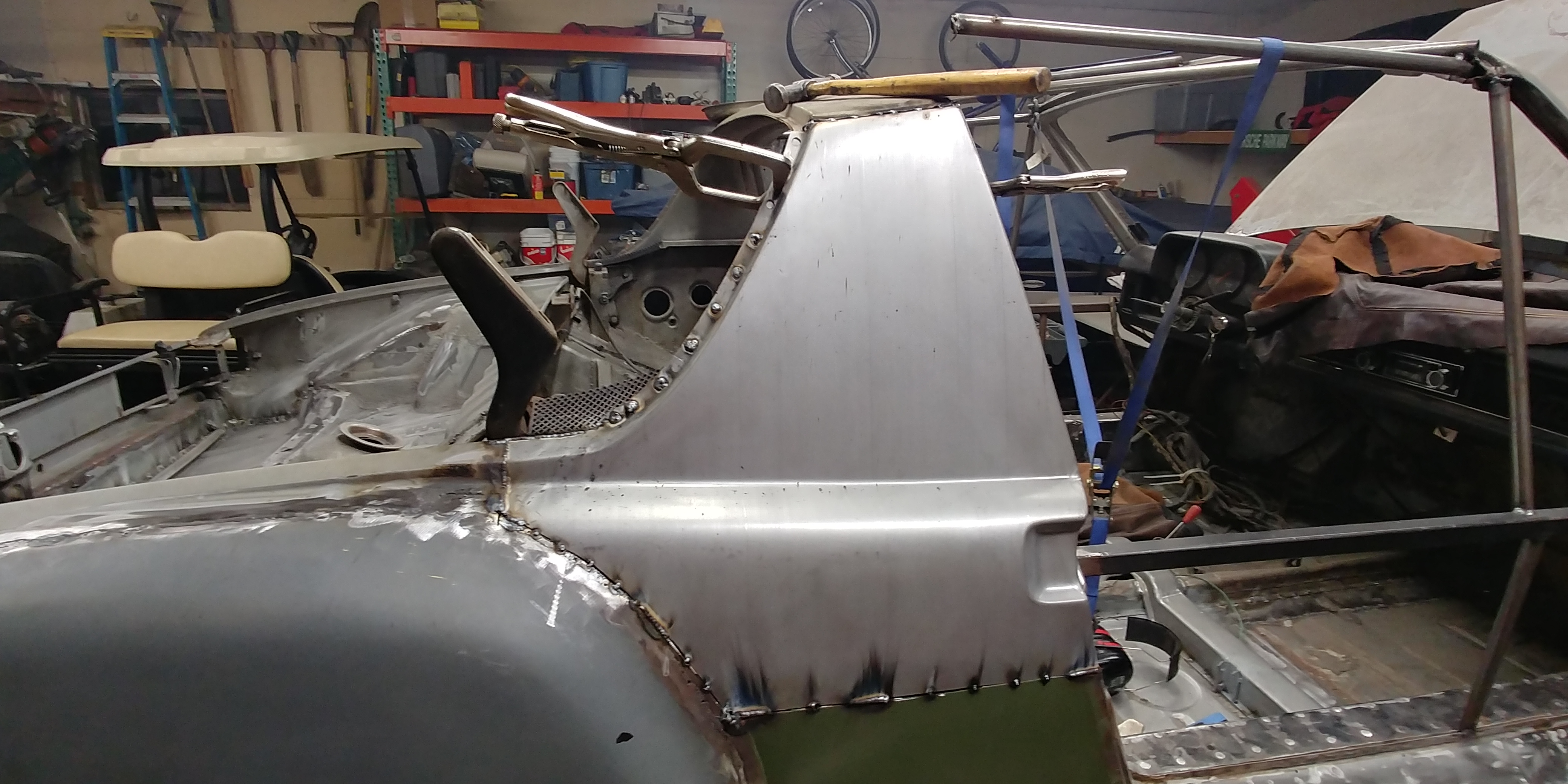

post Jan 28 2018, 01:34 PM
Post #326
Posts: 7,804
Joined: 2-January 09
From: Burlington wi
Member No.: 9,892

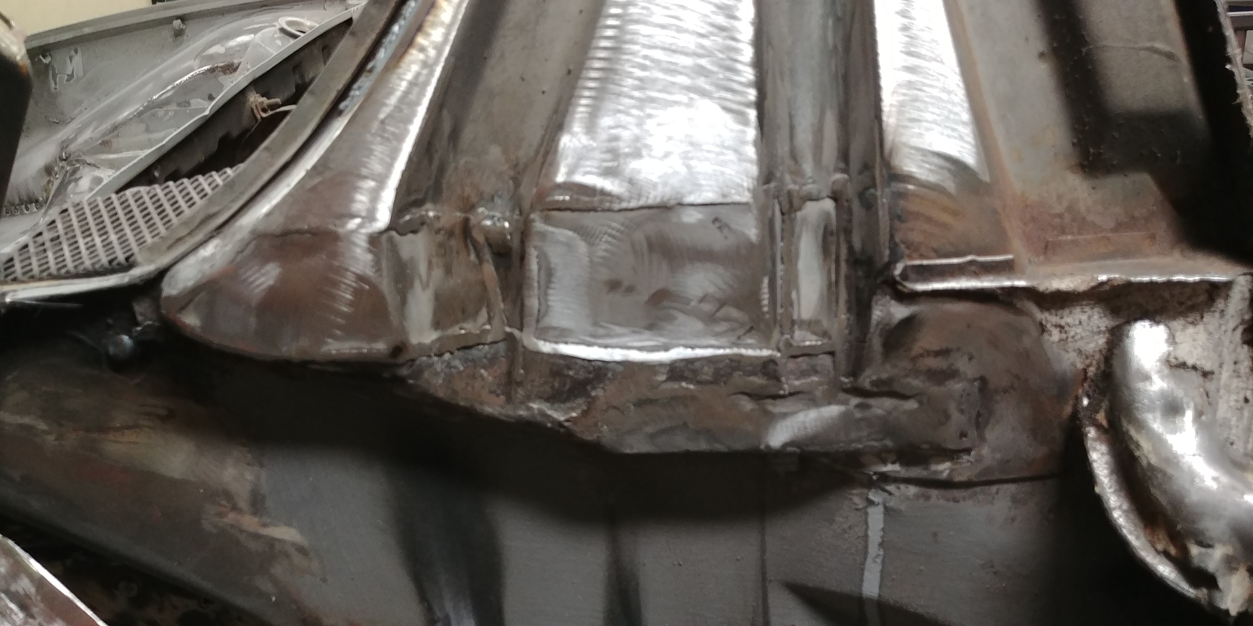

Well busy times, working allot in my day job as we have a company coming into the area looking for 13k employees and have allot of people looking for training..
Then business is very busy and growing. A website is under development thanks to a member here that has been an absolute blessing.. The GT hardlines have consumed allot of time and money..
That said I gave in and bought 2 new sail panels from restoration design as while I was in there make it 100% right.. It put me behind by a couple weeks of my target but will be worth it..

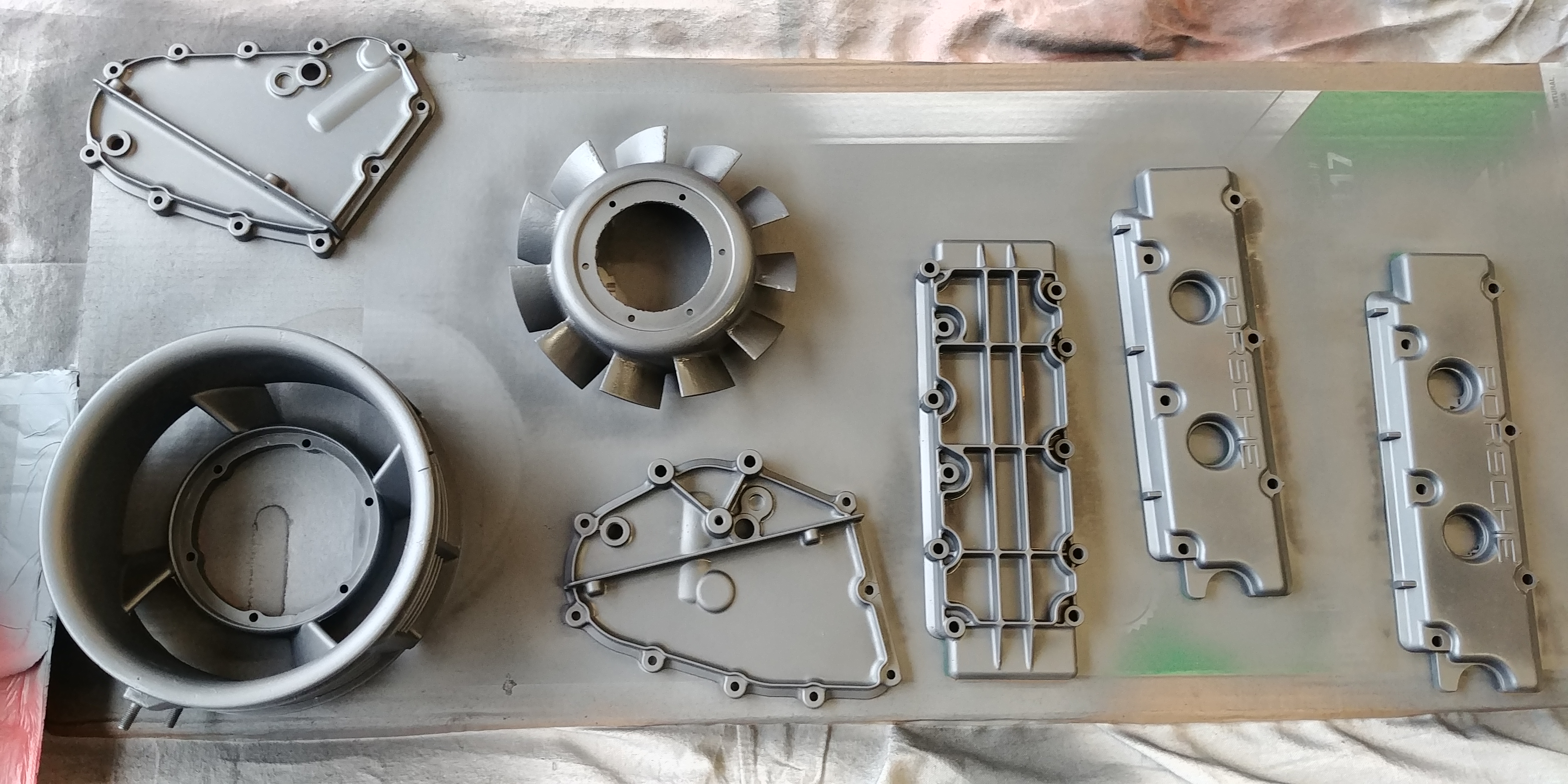

I cut the passenger side off yesterday inbetween cerakoting some engine parts after repair for a customer.
Front wheel well has been a constat issue where it was brazed etc.. Almost done welding pits and grinding in that area.. Hopefully prime that area this week and mount the door on so can weld the fender on.. Attached Image

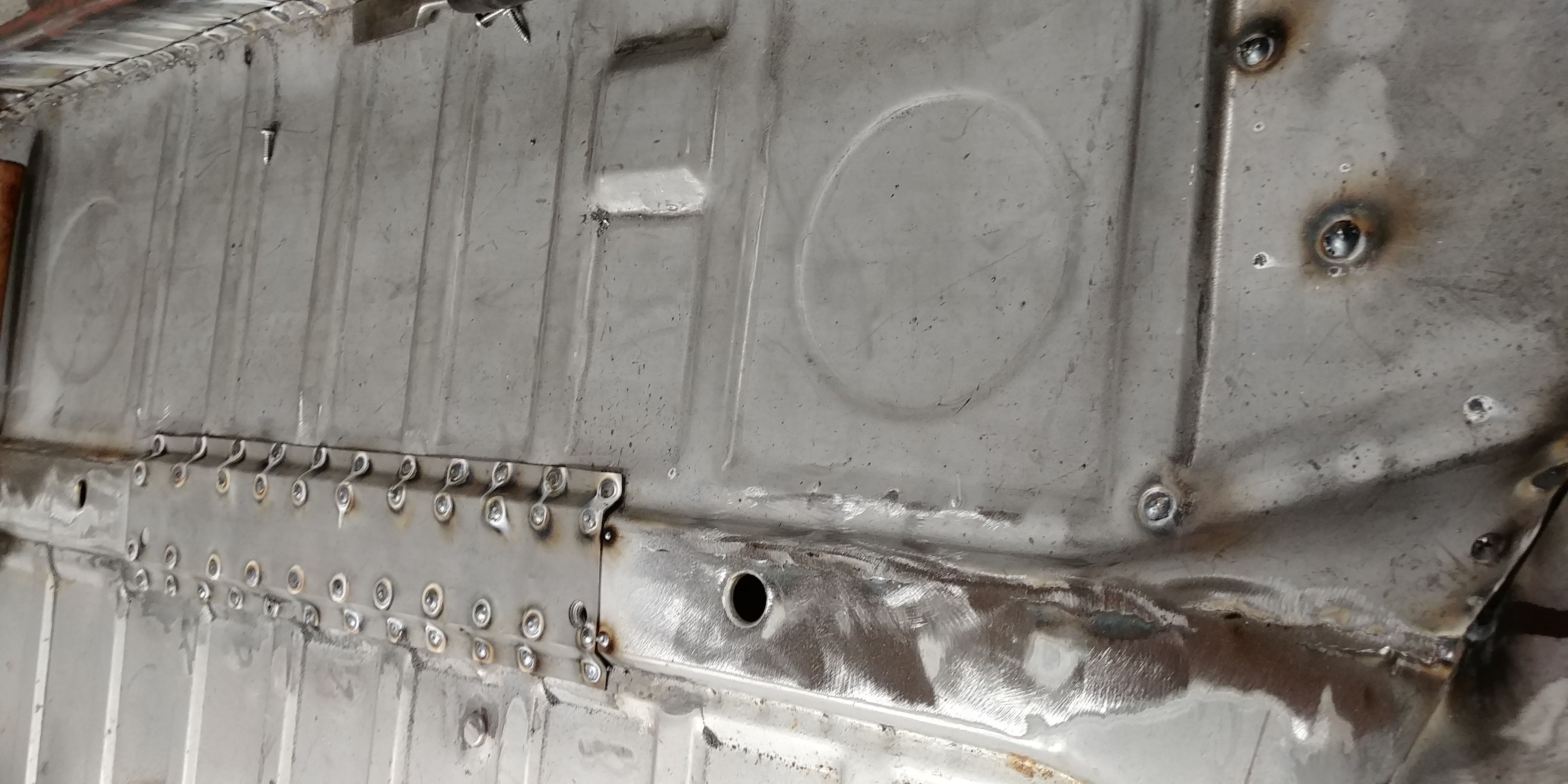

Oh and brace is in the trunk so that are is done.. Yeah.Attached Image
mb911
post Jan 30 2018, 07:01 AM
Post #328
Posts: 7,804
From: Burlington wi
Member No.: 9,892
And this mornings progress.. Was going to make it out of one piece but lent my brake out to someone and this will blend well enough once welding is completely done.. Attached Image
bbrock
post Jan 30 2018, 09:15 AM
Post #329
Posts: 5,269
Joined: 17-February 17
From: Montana
Member No.: 20,845
I've got a smaller patch in that general area coming up fairly quickly. Did you treat the inside of that cavity while it was open? Haven't decided what to do with mine. Always looking for examples.

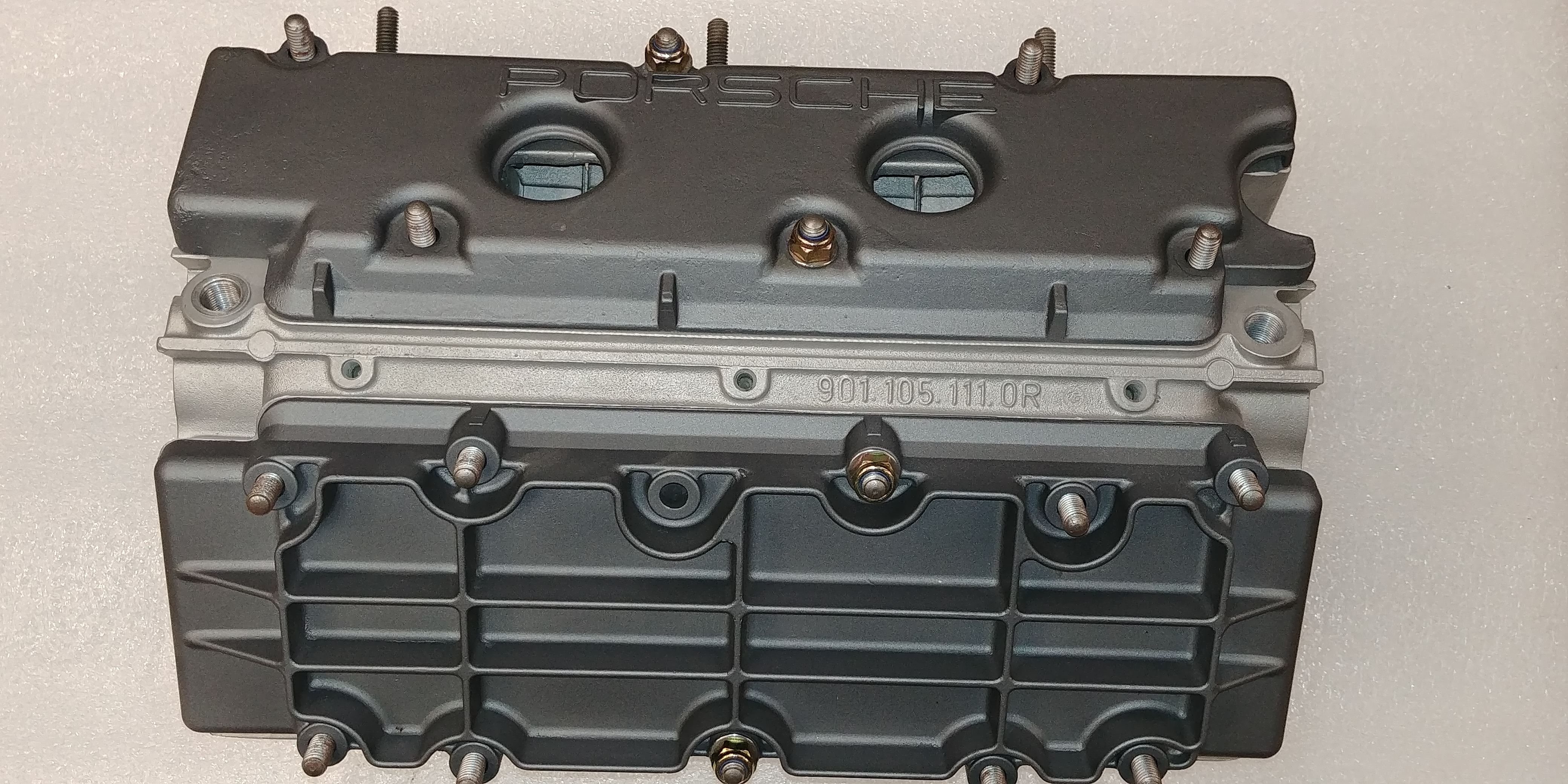

QUOTE(mb911 @ Jan 28 2018, 11:34 AM) *
I really like the finish on those parts Ben. Looks great man.
Is Cerakote finish similar to powder coating?
I’ve only read a few things regarding its use. Mostly gun finishes.
Regards
mb911
post Jan 30 2018, 09:37 AM
Post #331
Posts: 7,804
From: Burlington wi
Member No.: 9,892
QUOTE(bbrock @ Jan 30 2018, 07:15 AM) *
Yup just cold galvanized spray after wire brushing it. Then use som galvaneel cut offs from the RD parts..

QUOTE(Dion @ Jan 30 2018, 07:35 AM) *
Regards
Cerakote is a ceramic paint.. I used it on my engine build as well. Its sprayed in automotive spray guns.Attached Image
Dion
post Jan 30 2018, 10:35 AM
Post #333
RN
Posts: 2,931
Joined: 16-September 04
From: Shepherdstown, WV
Member No.: 2,766
A big step above the rattle cans then.
Thanks Ben.
mb911
post Jan 30 2018, 12:21 PM
Post #334
Posts: 7,804
From: Burlington wi
Member No.: 9,892
QUOTE(Dion @ Jan 30 2018, 08:35 AM) *
Thanks Ben.
Thats for sure.. it is rock hard and handles extreme heat.. does not discolor either
jd74914
post Jan 30 2018, 12:32 PM
Post #335
Its alive
Posts: 4,886
Joined: 16-February 04
From: CT
Member No.: 1,659
QUOTE(mb911 @ Jan 30 2018, 01:21 PM) *
Thanks Ben.
Those parts look great! I've also been very happy with the Cerakote in the past. Pretty easy to apply and lasts forever.
Not to hijack but...For those who just need aluminum or flat black/white colors and want/need it in an aerosol can, Superior Industries Thermal Kote is also very good. It's expensive ($90/2 pack), so nothing like cheap autopart store sprays.
The temperature rating is a bit lower (1325F vs. 1600F), but it holds up really well. I regularly use it in burners that see >1450 F (bright cherry glowing color) and haven't had any flaking problems either.

mb911
post Jan 30 2018, 03:55 PM
Post #336
Posts: 7,804
From: Burlington wi
Member No.: 9,892
QUOTE(jd74914 @ Jan 30 2018, 10:32 AM) *
Thanks Ben.
https://www.superior-industries.com/thermal...roduct_208.html
Interesting stuff. never tried that
mb911
post Jan 31 2018, 06:42 AM
Post #337
Posts: 7,804
From: Burlington wi
Member No.: 9,892

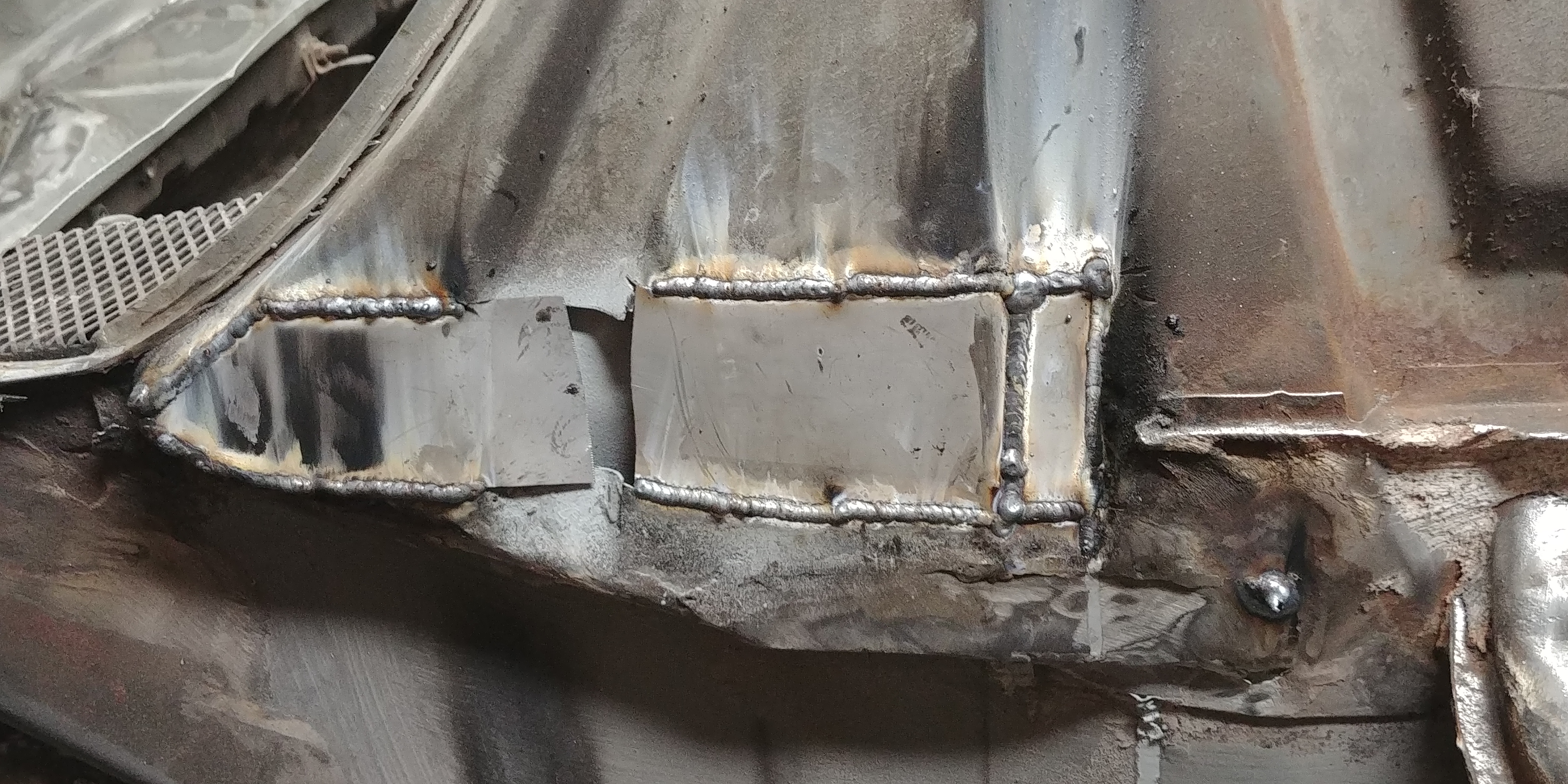

Finished welding the area this morning and then ground it down 90% and cleaned and sprayed zinc brite over it.. It is a perfect repair for a hidden area with all the correct contours but doesn't require the finish that an external panel requires.. Attached Image
mb911
post Feb 1 2018, 06:51 AM
Post #338
Posts: 7,804
From: Burlington wi
Member No.: 9,892

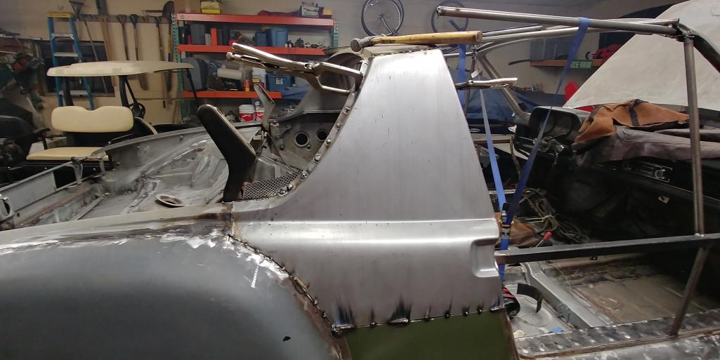

Woke up at 4:15 today went out and welded the sail panel on . Went well but have a bit to finish yet.. This will conclude my week of progress as busy the rest of the week but feel that I made progress. Attached Image
