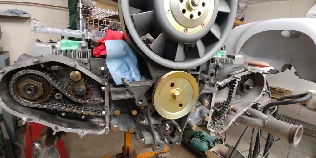

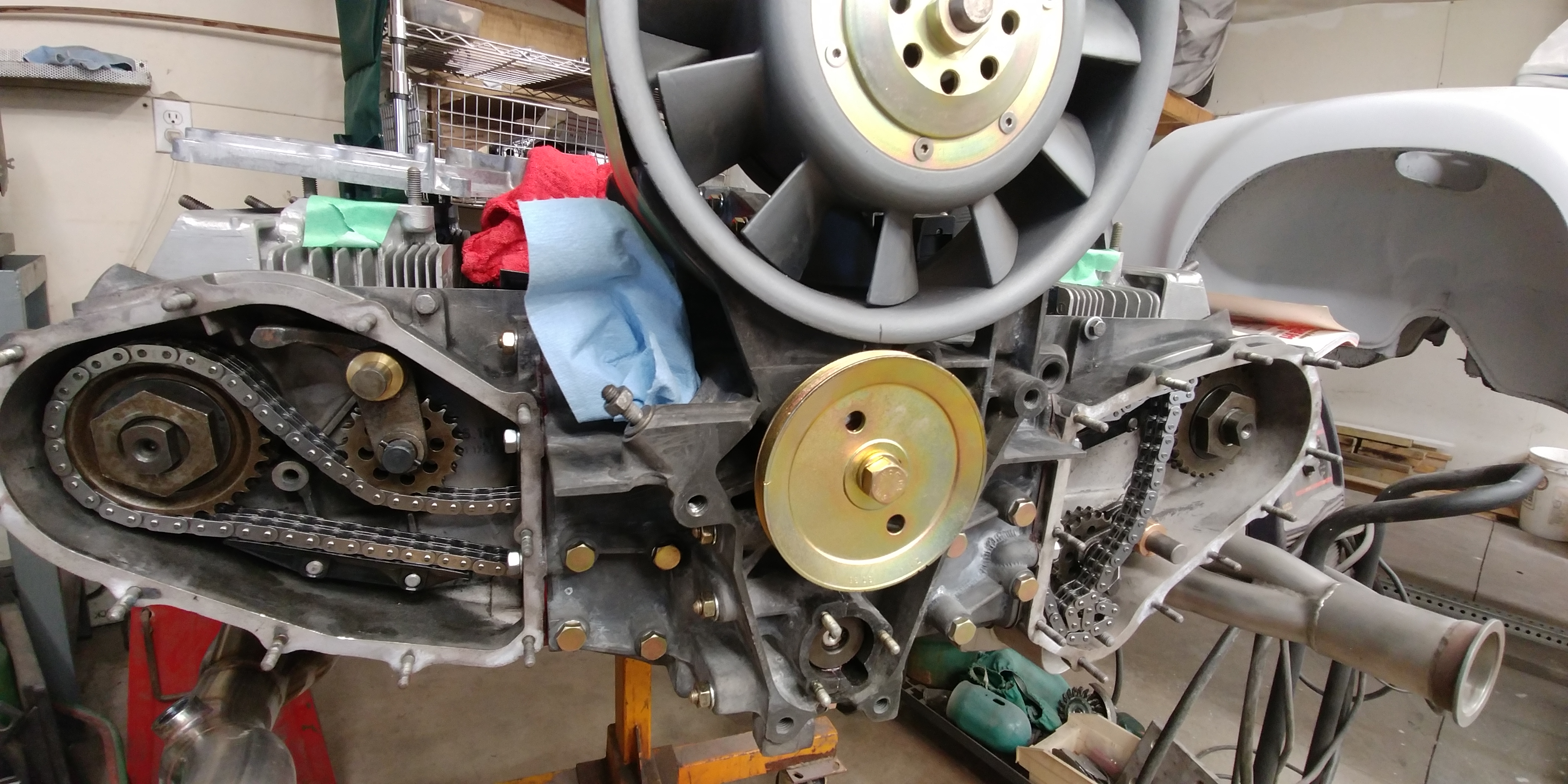

Update
Fuel pump arrived, carb parts and distributor coming from supertec, worked on aligning sprockets on the engine, then went to time cams and discovered that the cam sprockets were a little worn so ordered new ones,
No real work on chassis as want to wrap up the engine so I can run it for some testing of products.

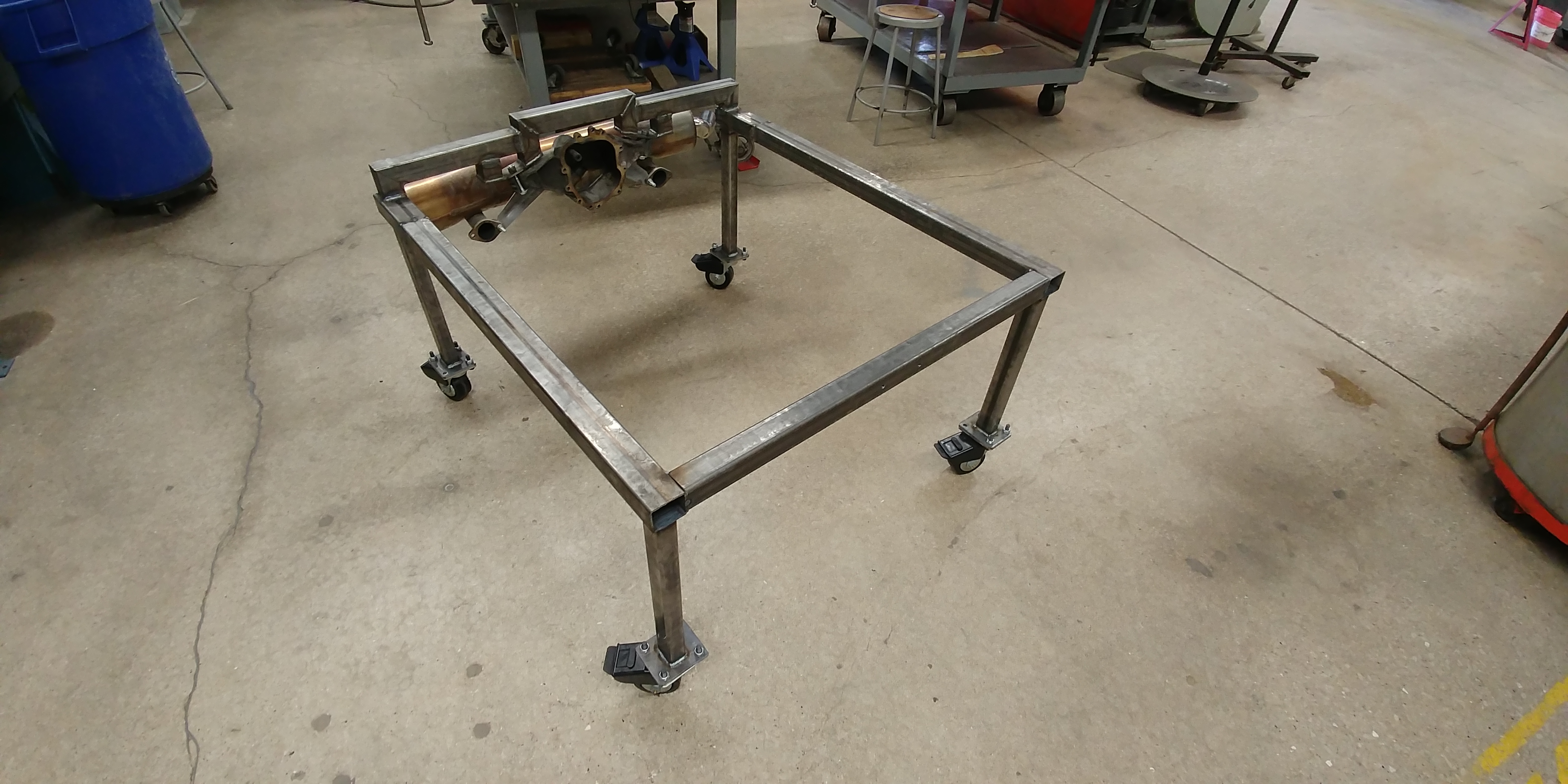

Test run stand in the making.. Attached Image

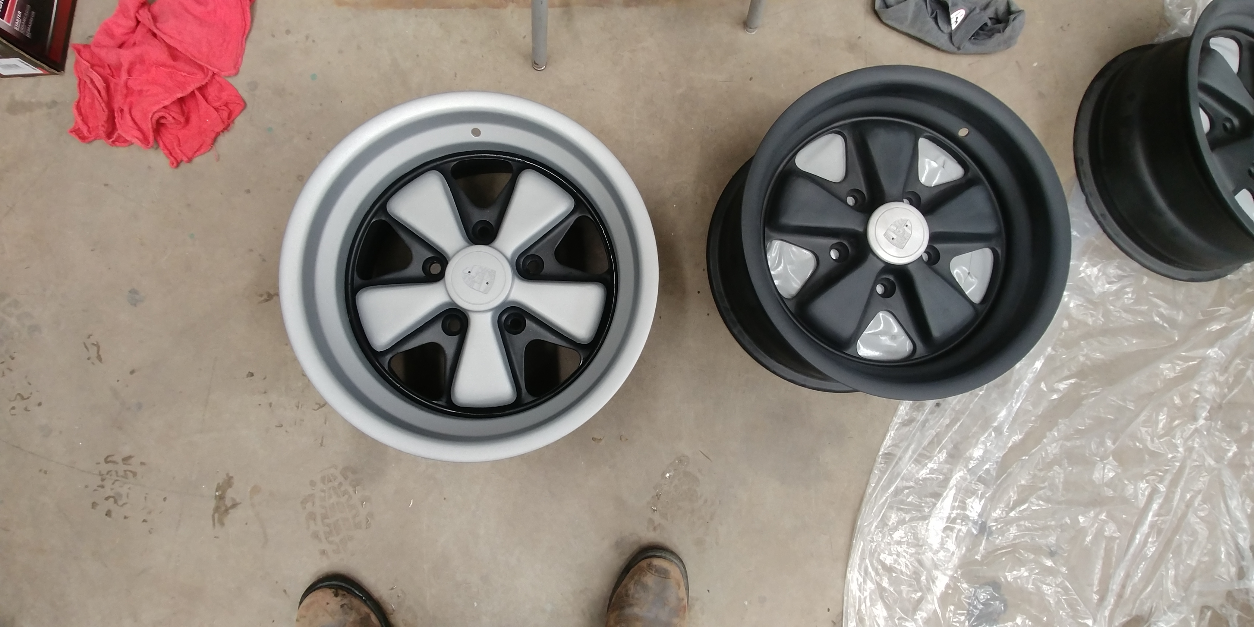

Cams are timed, put new sprockets on though felt the ones I had were good. It just seemed the thing to do. Then had my buddy powdercoat my sons phone dials and then I wet painted to rsr look on one of my 15x8 fuchs. This was done with water masking..Attached Image Attached Image

I don't normally like the all black wheels, but that matte finish with the bare aluminum center cap sure looks good!

QUOTE(Travis Neff @ Jun 14 2018, 01:29 PM) *
I thought about doing that as well..
The good news its all paint so doesn't matter cost much to change things.

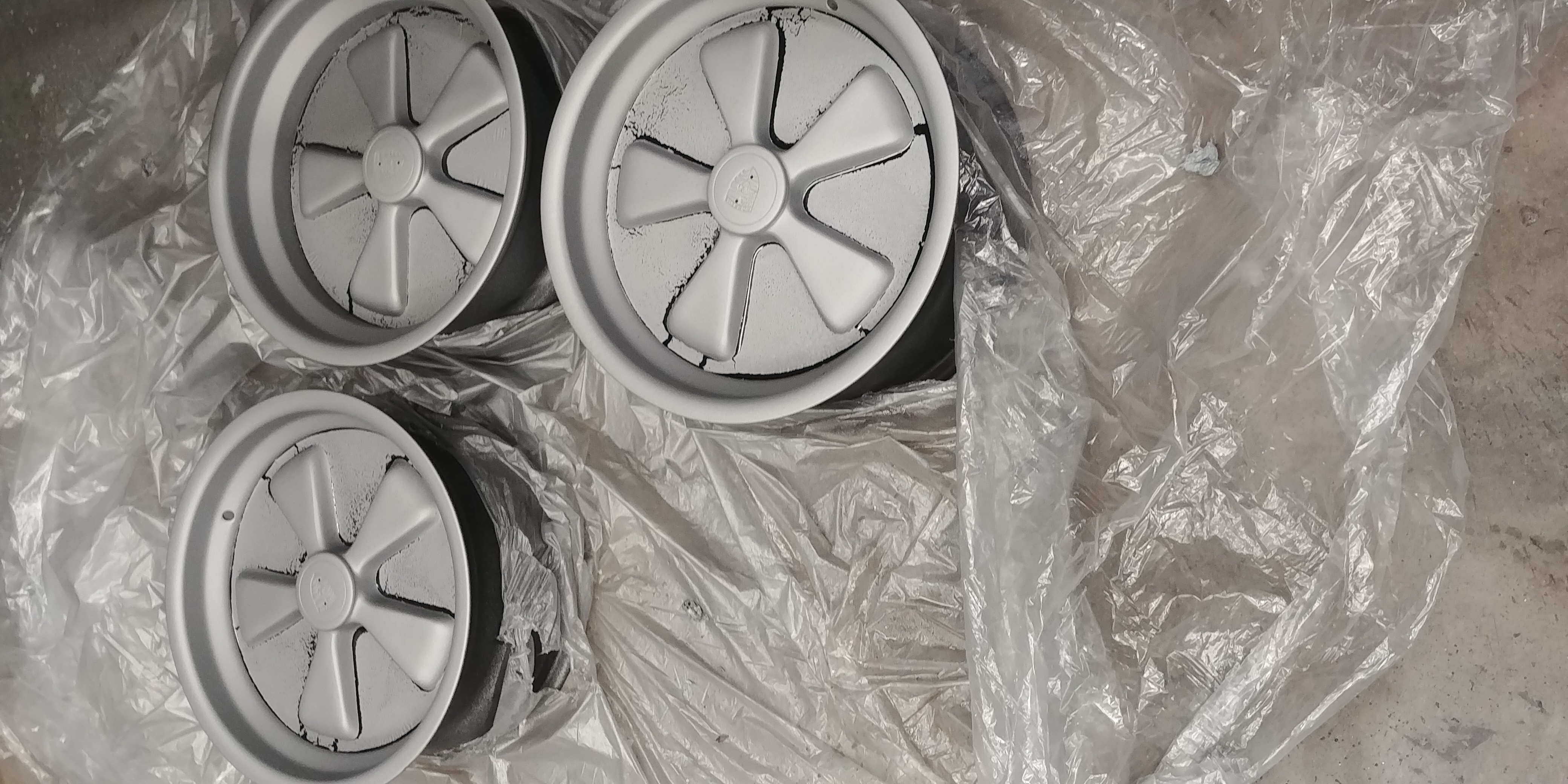

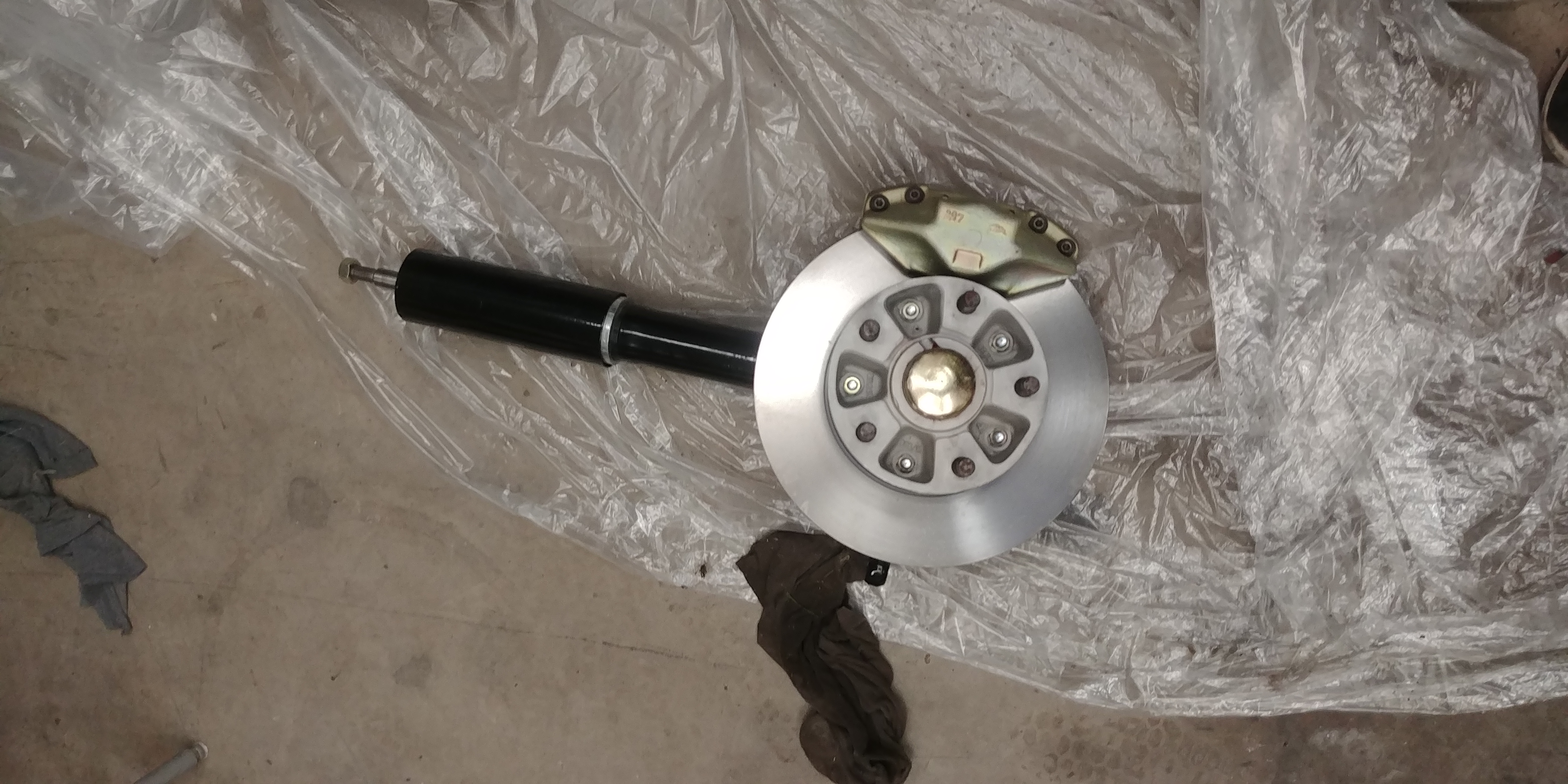

Here is 1 front strut assembled and the other 3 wheels with the water mask method. Attached Image

Ben, what paints did you use to achieve that look?

QUOTE(Beach914 @ Jun 16 2018, 06:44 AM) *
Matte black powdercoated then Cerakote silver mag ceramic paint.. Turned out pretty nice..
