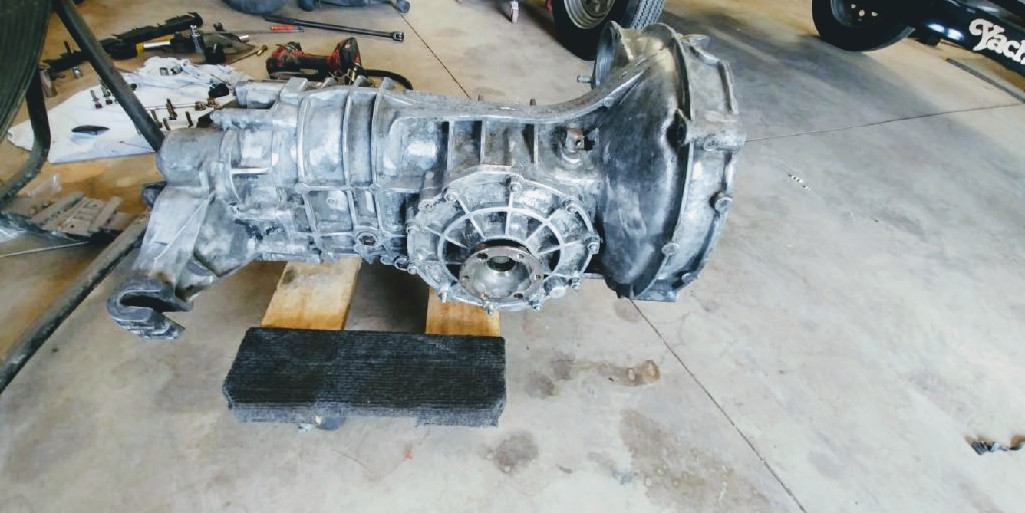

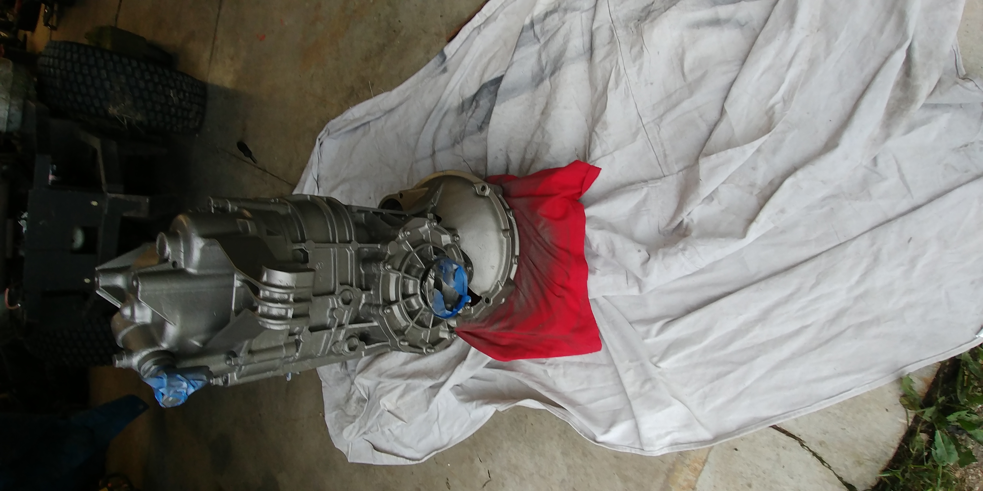

Trans all cleaned. My extra trans will get a complete cosmetic and internal restoration later on.Attached Image

That is one light transmission it is actually floating to the ceiling. (IMG:style_emoticons/default/rolleyes.gif)
Or you guys have some odd gravity in your parts.
Looks good Ben, I would leave it alone, but if doing any sort of painting you need to prep the Mag case for it, follow what the aircraft guys do, and you will be fine.

So far degreased, wire brushed, powerwashed, cleaned with scotch brite and brake cleaner.
Still undecided..

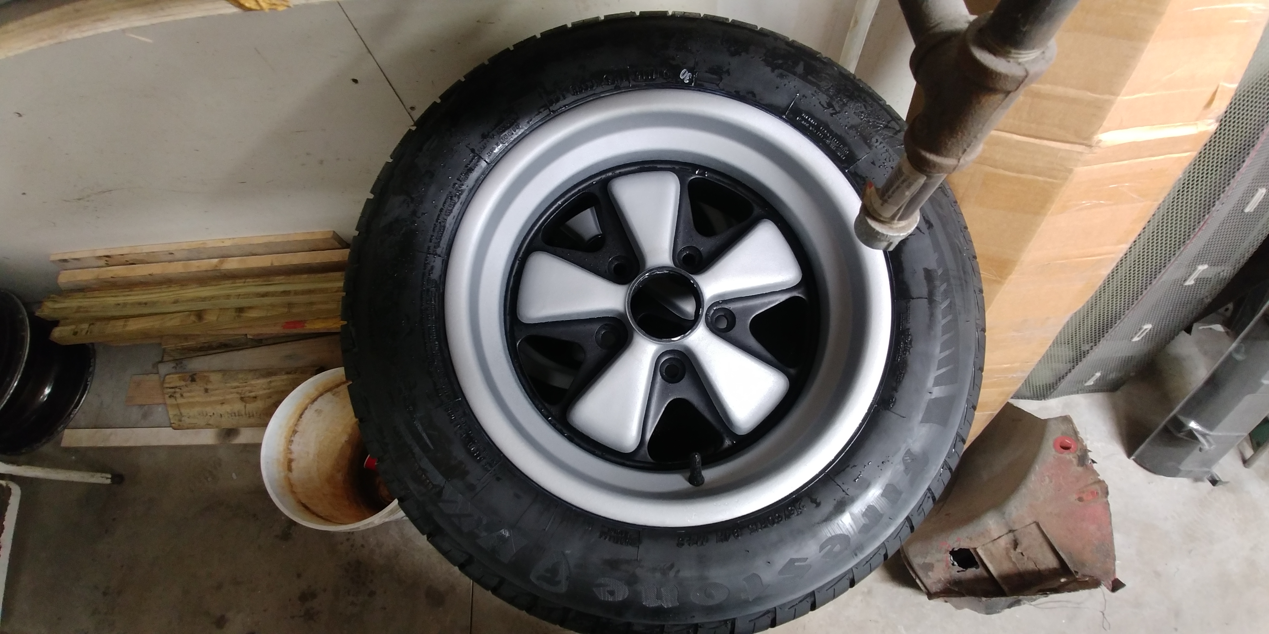

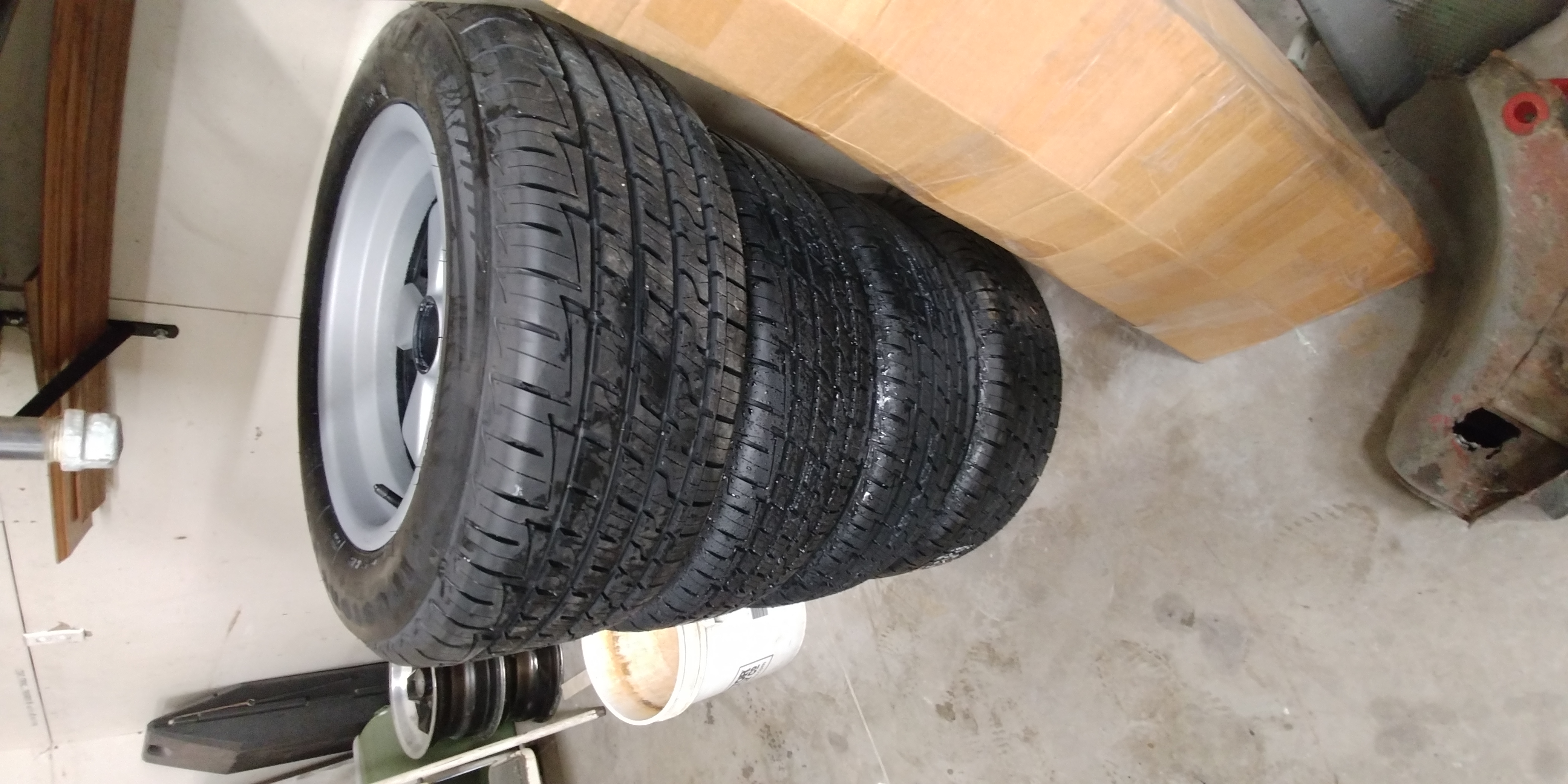

Firehawk AS tires mounted. Rated to 118mph which is fine for me until I decide a permanent tire wheel combo.Attached Image

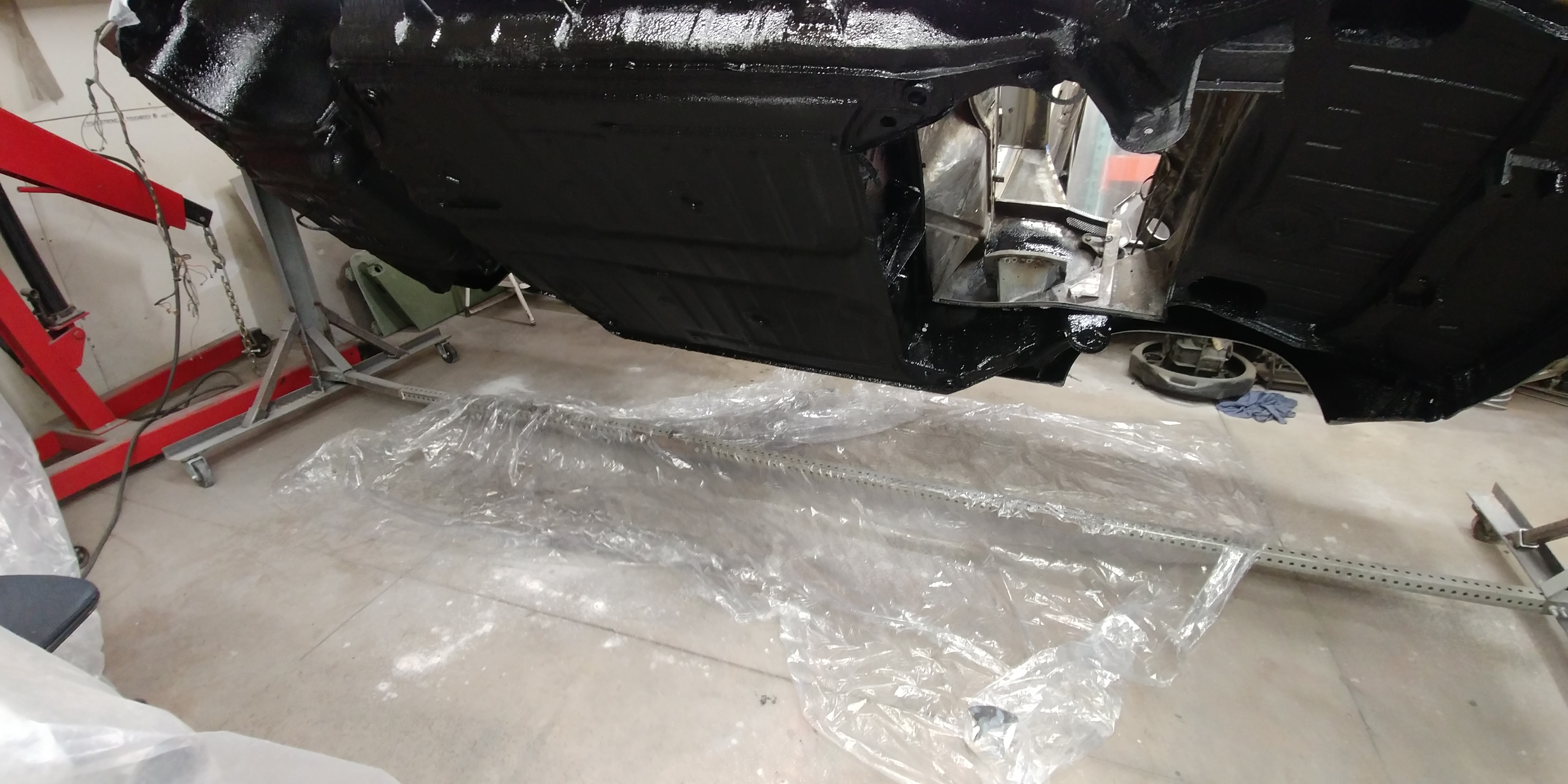

Thanks. I am going to finish all the bed liner underneath the car tomorrow night then suspension can go in..

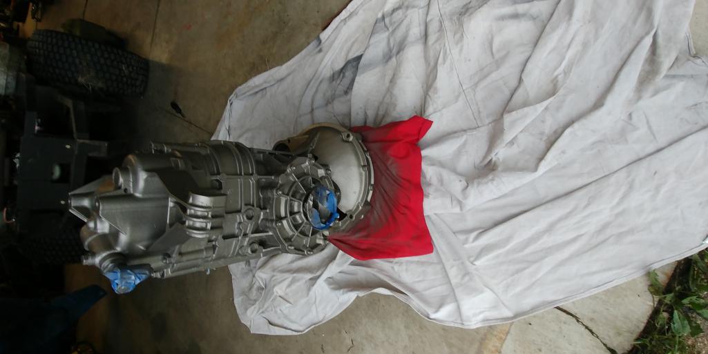

Just finished up everywhere that needed touch up. And painted trans.. Attached Image

I like the color you picked for the transmission. Did you end up doing cerakote?
mb911
post Jun 22 2018, 08:29 PM
Post #555
Posts: 7,794
Joined: 2-January 09
From: Burlington wi
Member No.: 9,892
QUOTE(Travis Neff @ Jun 22 2018, 06:17 PM) *
Thanks used cerakote titanium only because I bought a sample of the color and had some left. Its a "rebuild" in a can so to speak.

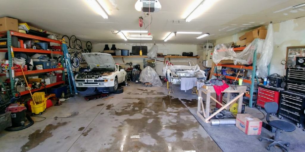

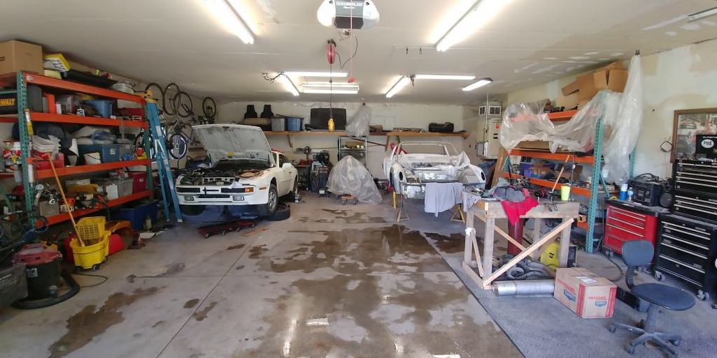

Off the rotisserie. 1st time in last 2 years.. Thinking I might sell the rotisserie not sure yet..Attached Image

Can't figure out why pictures are loading upside down etc.

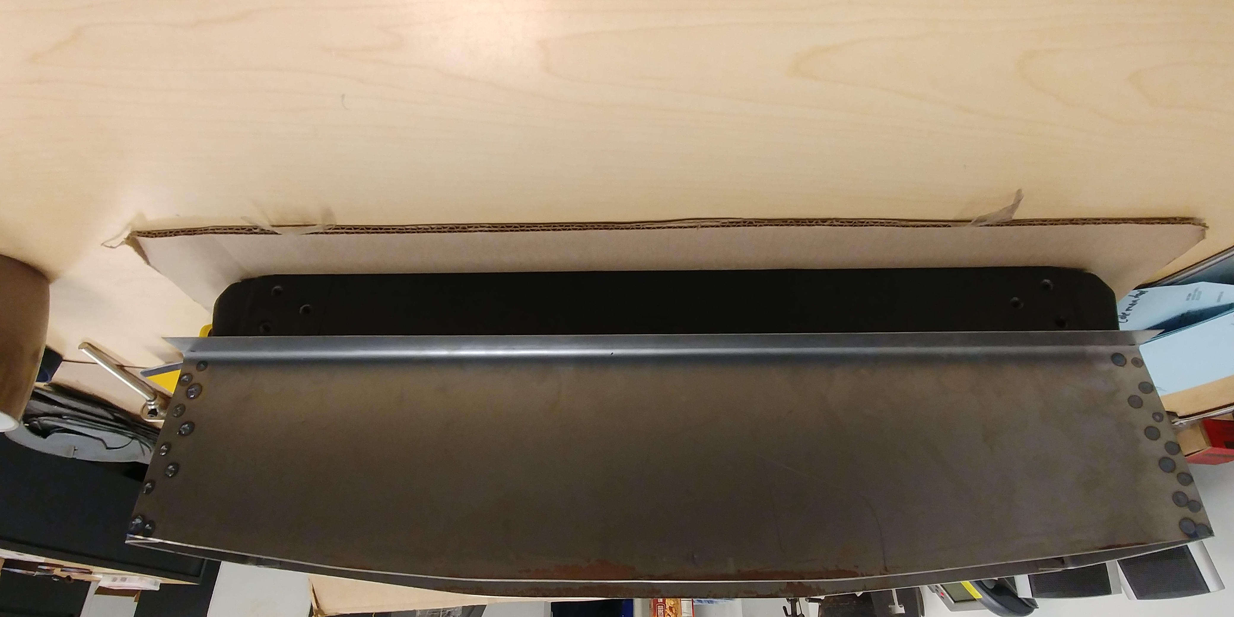

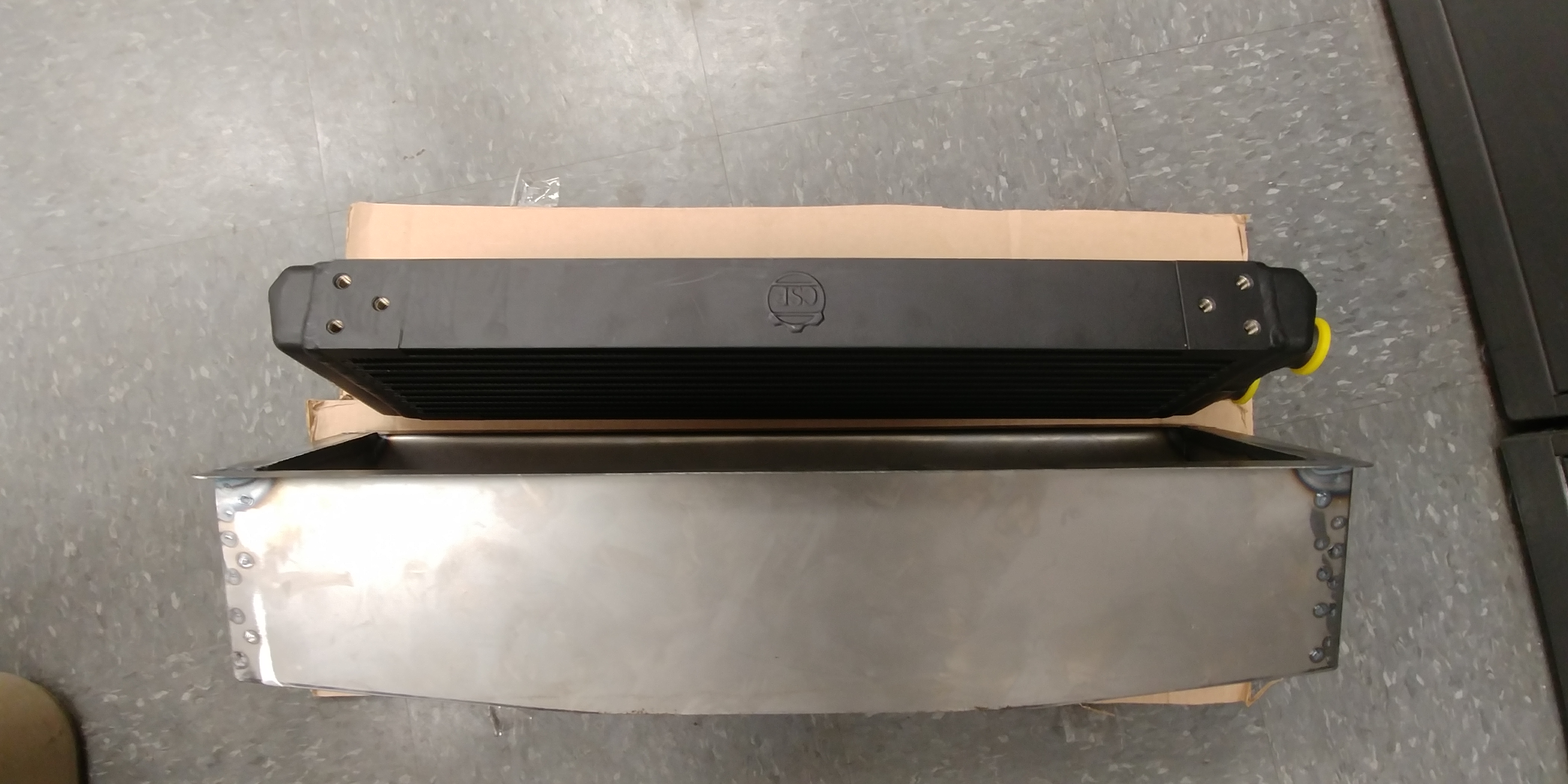

GT oil cooler set up has started.Attached Image
