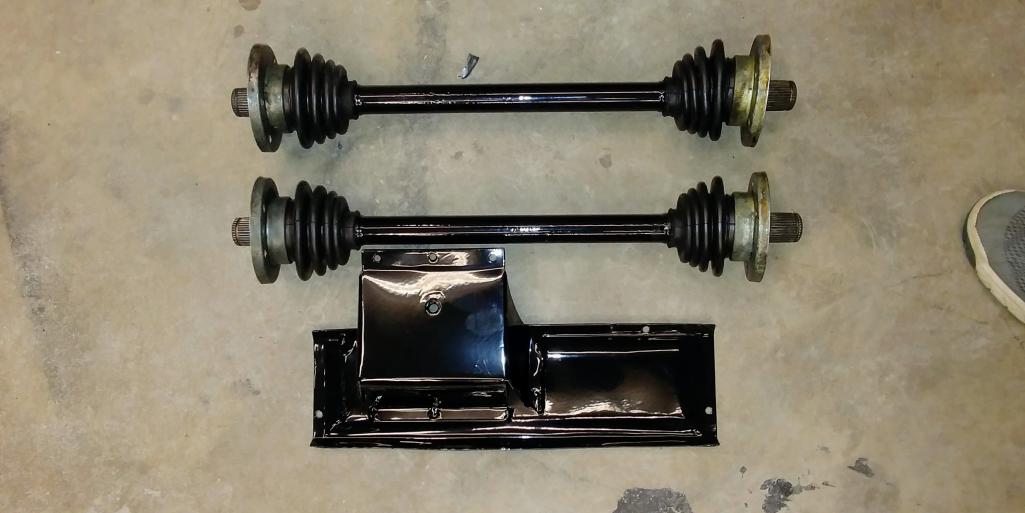

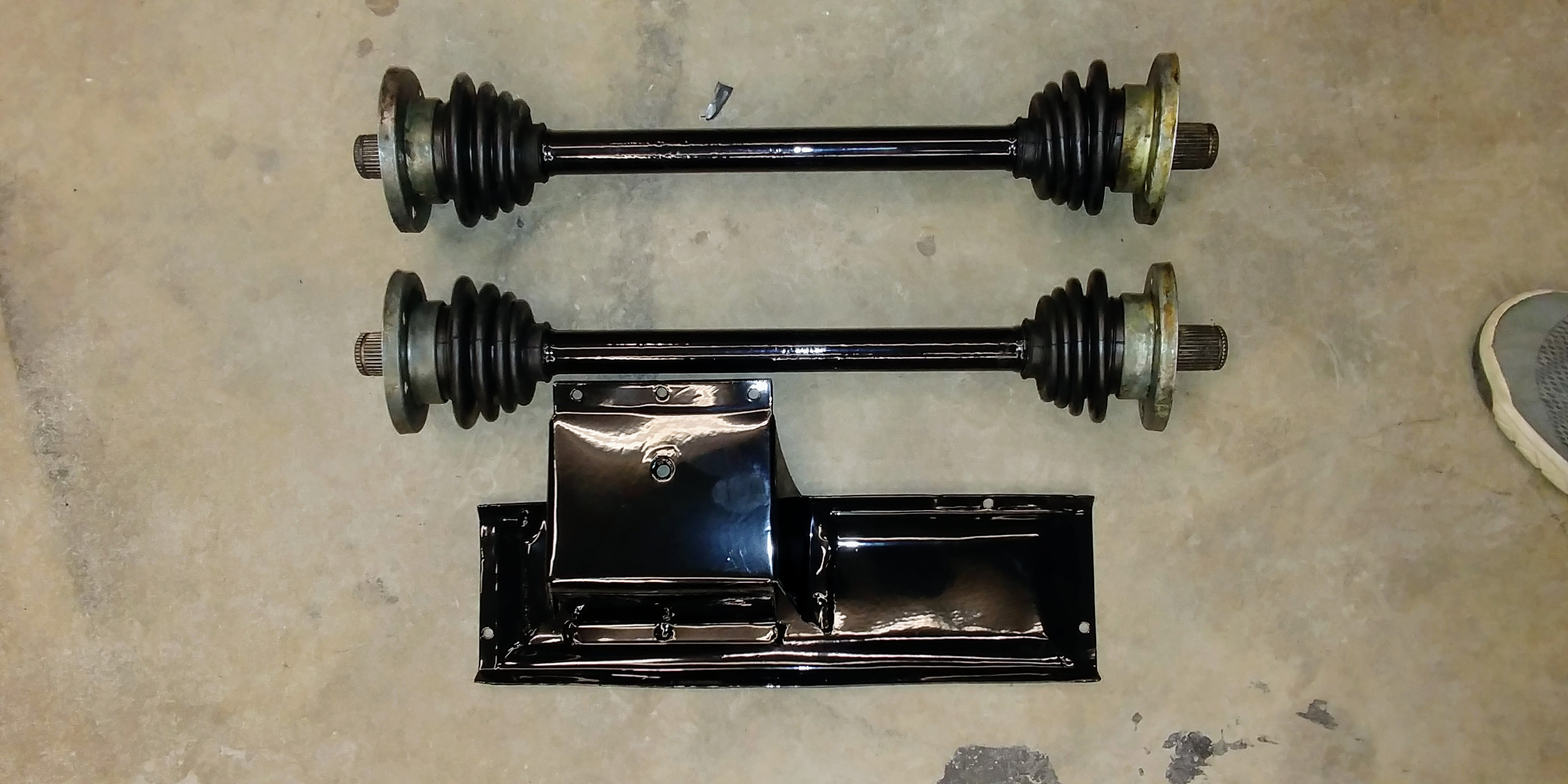

Freshly powdercoated axles and spare tire mount. Attached Image

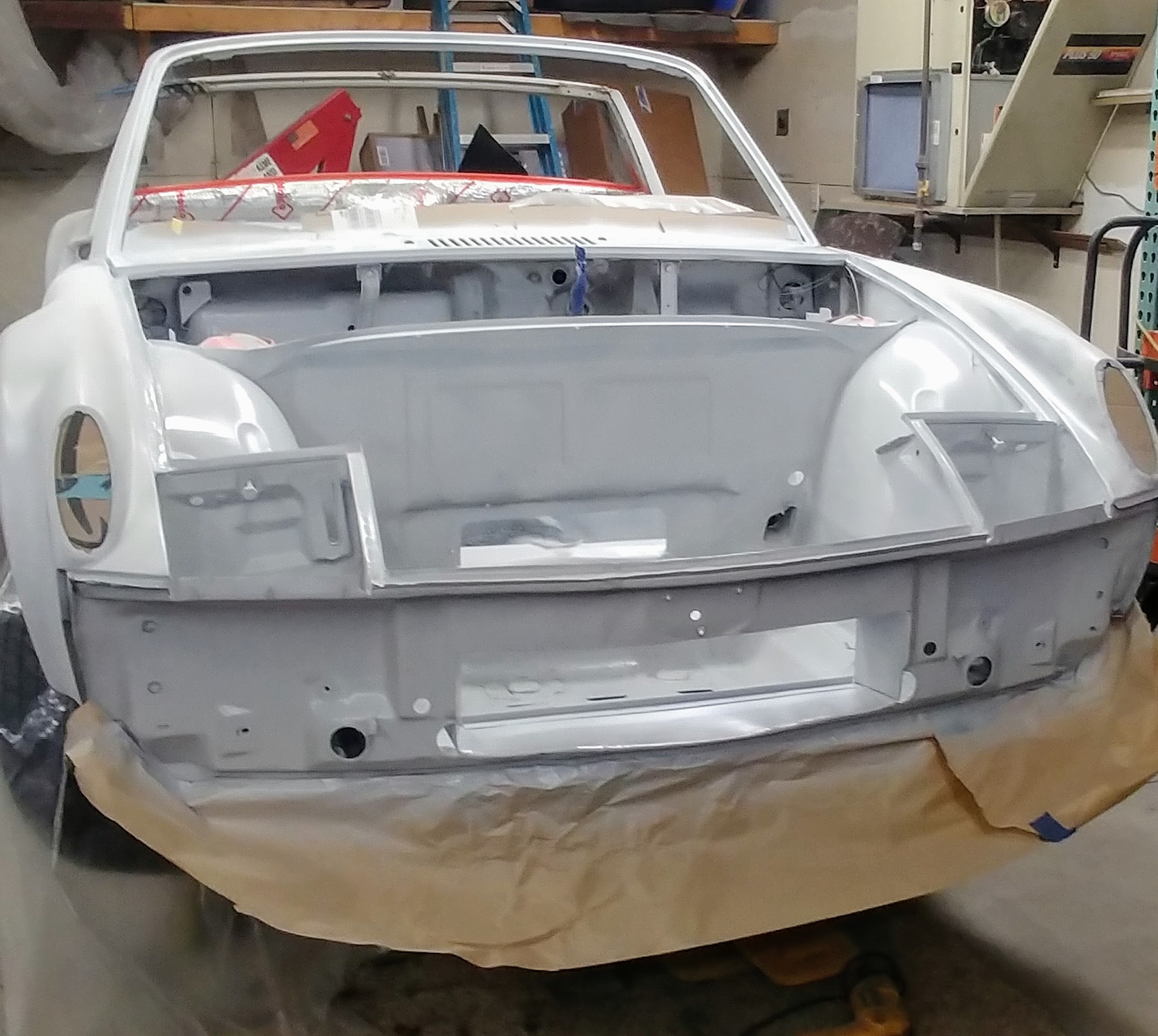

Finally epoxy primed frunk and windshield frame. Gonna let it cure and then prime with buildable/ sandable primer on the cowl and windshield frame.. Also gotta pick up a quart of bedliner this week to take care of some seams ala Kent and Bbrocks method. Attached Image

@bbrock quick question as you recently did this.. I read you can top coat epoxy within 5 days without scuffing. That said was thinking I might be able to spray surfacer on yet this evening. Never sprayed that quickly unless going sealer/base/clear. I don't believe it will be an issue but looking for some feedback.

QUOTE(mb911 @ Dec 8 2018, 03:06 PM) *
QUOTE(bbrock @ Dec 8 2018, 01:54 PM) *
Yowza! That looks purty! (IMG:style_emoticons/default/drooley.gif)
I wouldn't think it would be an issue. I used PPG DPLF epoxy and the recoat time is 15 minutes and the time to topcoat is 60 minutes for 1 coat and 90 minutes for 2 coats. Unless the spec sheet on your paint says different, I'd think you would be good to go. (IMG:style_emoticons/default/thumb3d.gif)

Well just sprayed buildable/sandable and sprayed out nice so we are all set.. I only sprayed on areas that will be externally seen and any spots that need attention.. Wet sanding /block will begine this week..

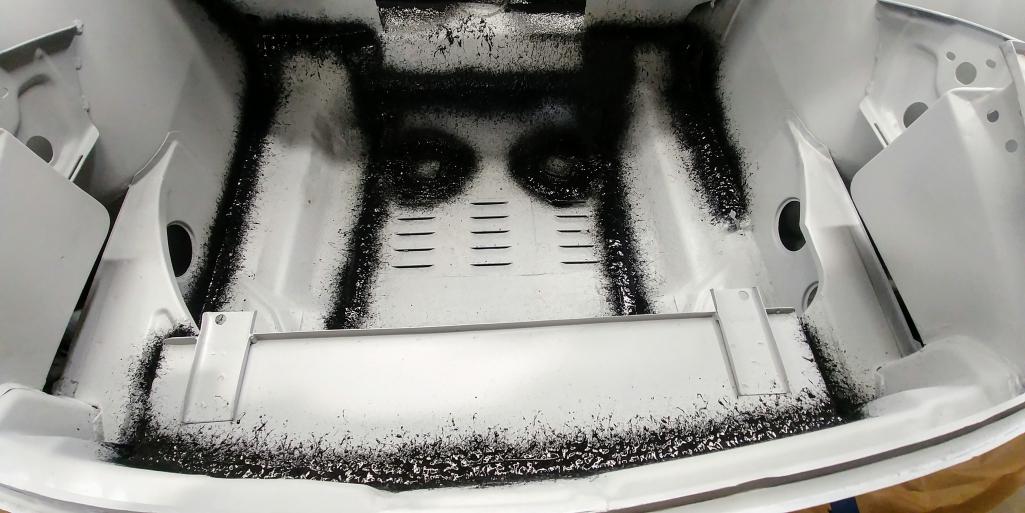

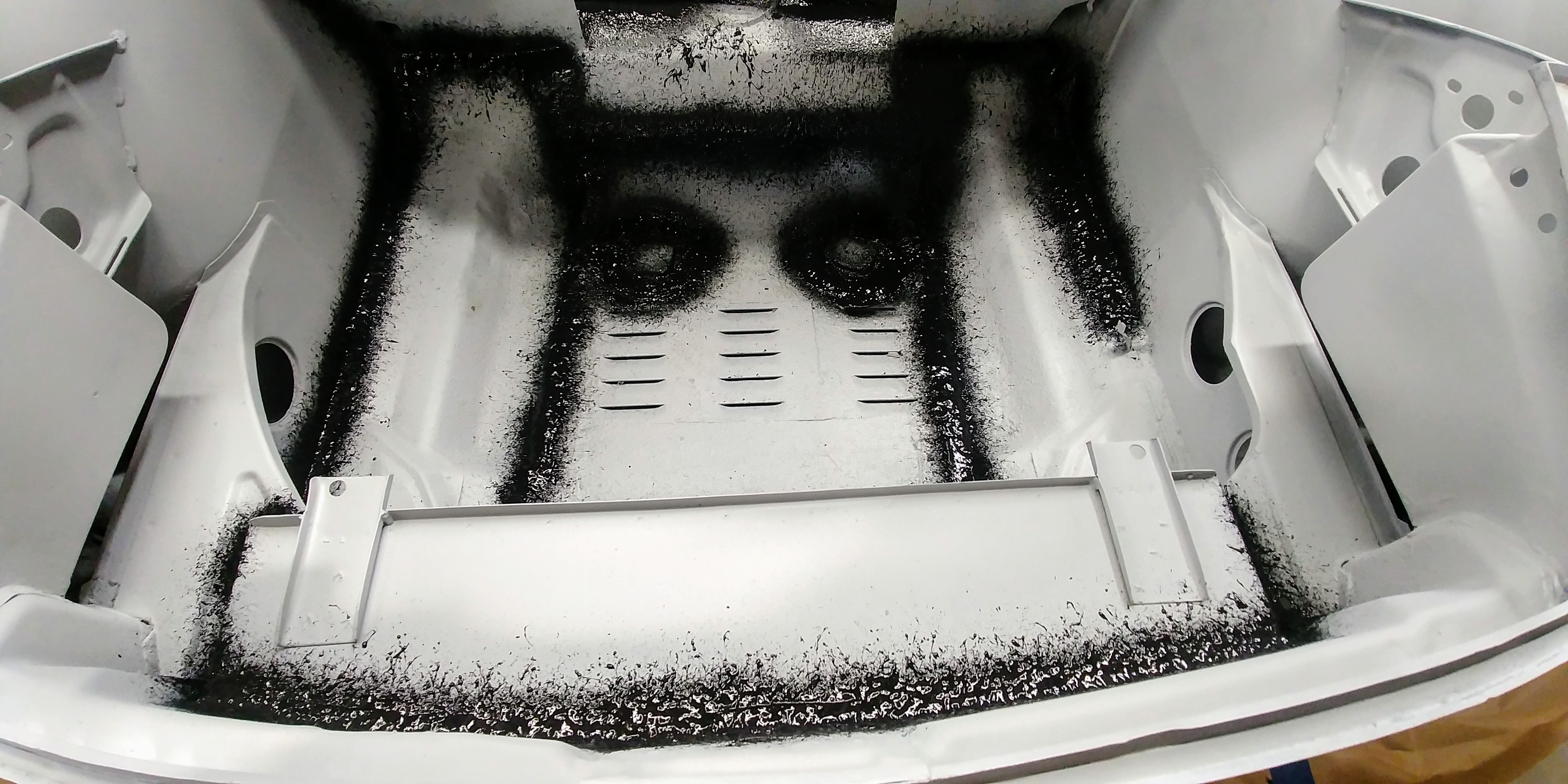

Sprayed final coat of seam sealer. I used upol this time instead of monstaliner only becuase it was available locally. Upol/raptor is more runny then monstaliner but much more tame smell wise. I did find out that my local paint store actually rents the real deal sealer gun made by SEM. Too late though .
Now just a little sanding and then sealer and color. Attached Image

QUOTE(TravisNeff @ Dec 10 2018, 02:12 PM) *
Sweet! This is looking fine Ben!
Thanks @TravisNeff allot of work to this point.. Moving towards the back of the car.. Will get steering rack in soon and then able to move the car around so I can get the engine bay done next..

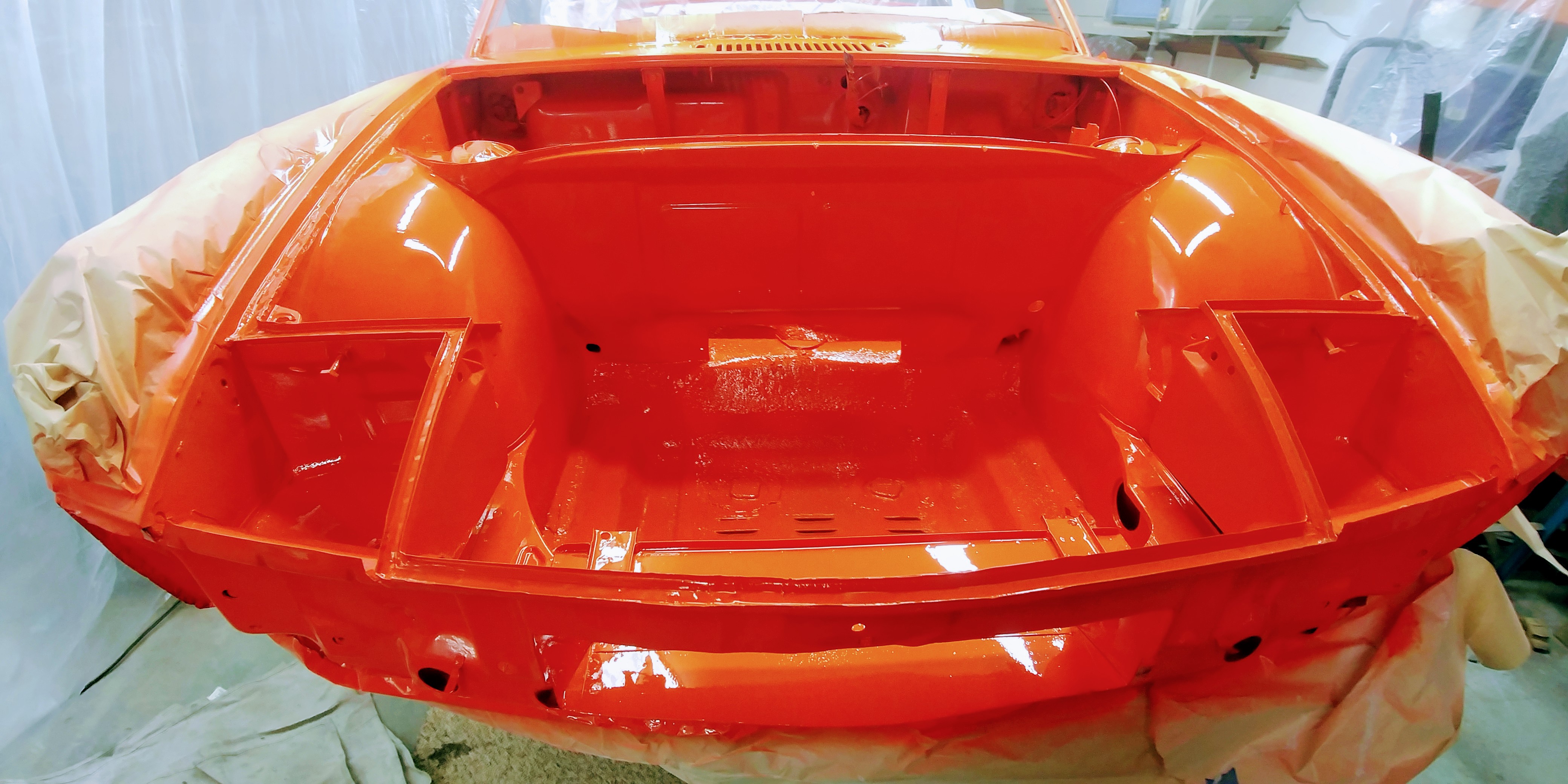

Spent a couple hours out there tonight.. We have some color.. Frunk and cowl are painted. Turned out pretty nice.. Attached Image

QUOTE(mb911 @ Dec 15 2018, 06:43 PM) *
Oooh man! Colour! (IMG:style_emoticons/default/cheer.gif) awesome Ben.
That looks great. Tangerine? I wasn’t sure what colour you decided on.
Nice milestone fer sure.

Saturn red which I think is very close to tangerine.
