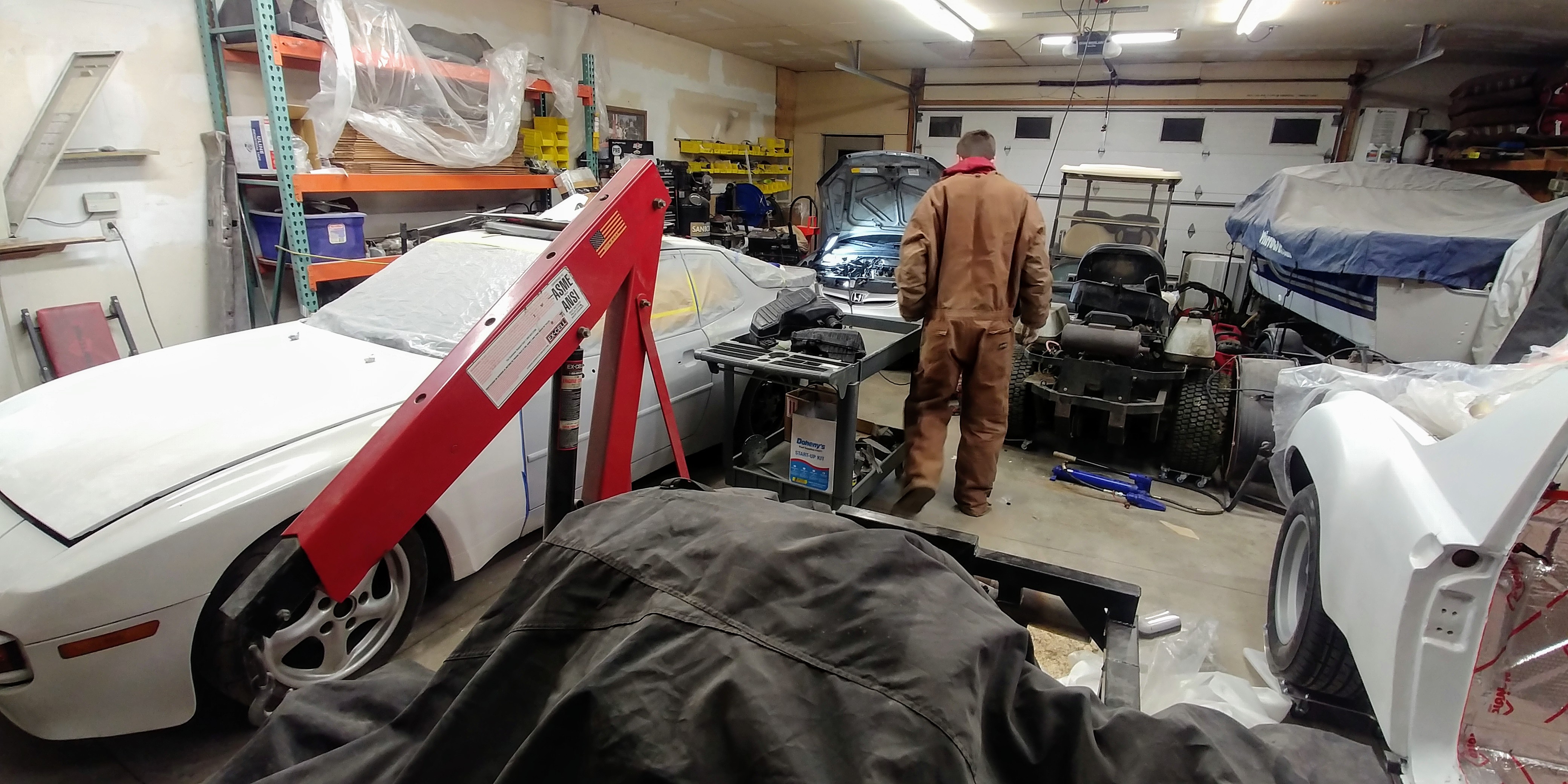

Anyone spot my spare tire/fuel pump mount?

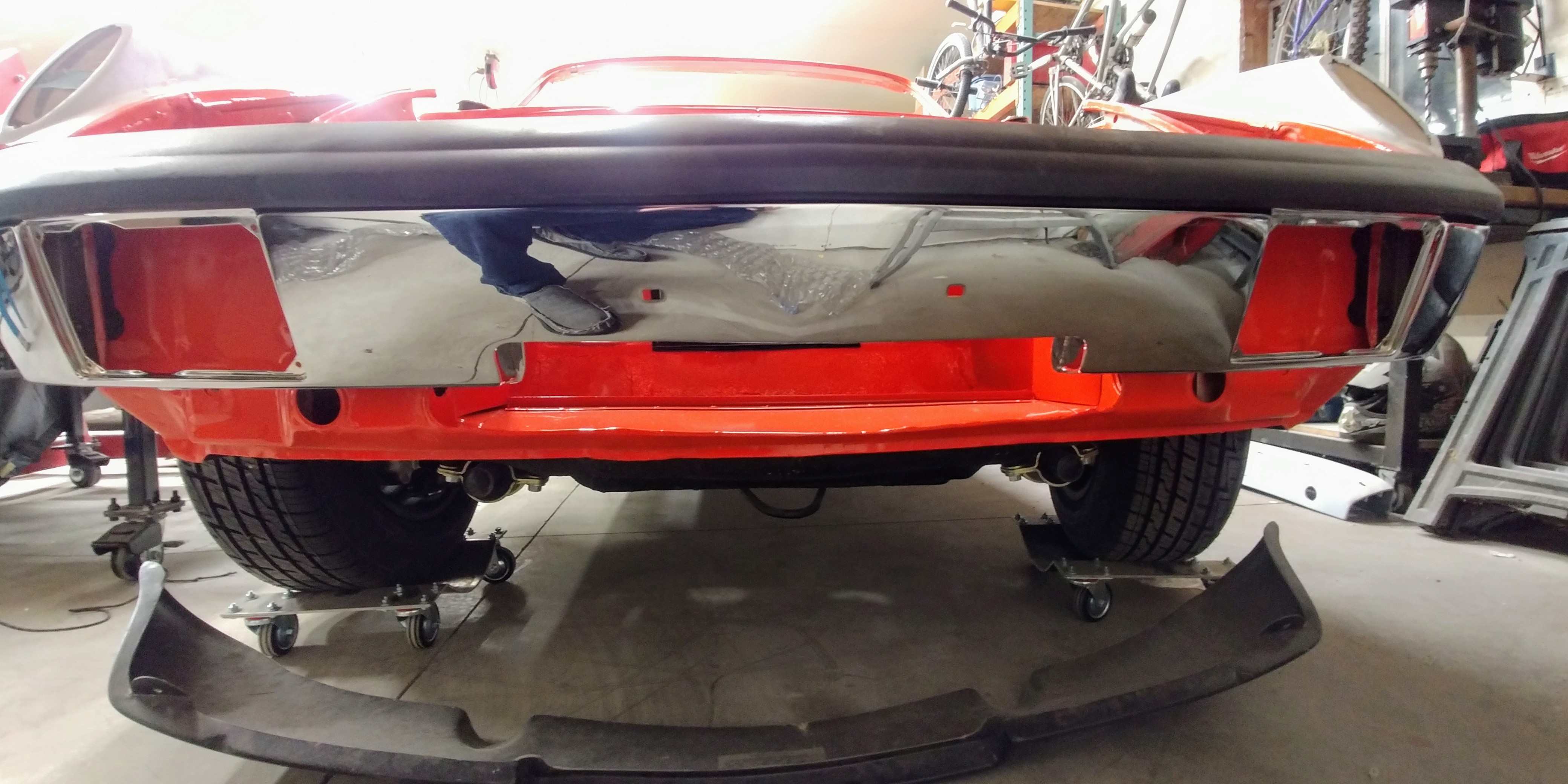

Hung the bumper so it was safe and out of the way. Over the next 10 days we have to paint the 944 , do a head gasket on my son's civic so he can sell it. So my shop is packed. Attached Image Attached Image

QUOTE(mb911 @ Dec 20 2018, 07:09 PM) *
Hung the bumper so it was safe and out of the way. Attached Image
All the better for sitting inside making vroom, vroom sounds. (IMG:style_emoticons/default/smilie_pokal.gif)
Where did you buy those roller skates for the car? I think I want to get a set for when mine comes off the spit. Do they help with doing an alignment?
mb911
post Dec 22 2018, 02:19 PM
Post #754
Posts: 7,794
Joined: 2-January 09
From: Burlington wi
Member No.: 9,892
QUOTE(bbrock @ Dec 21 2018, 08:28 AM) *
@bbrock I made them and as far as alignment I suppose so.. When I get to that point I think it will help

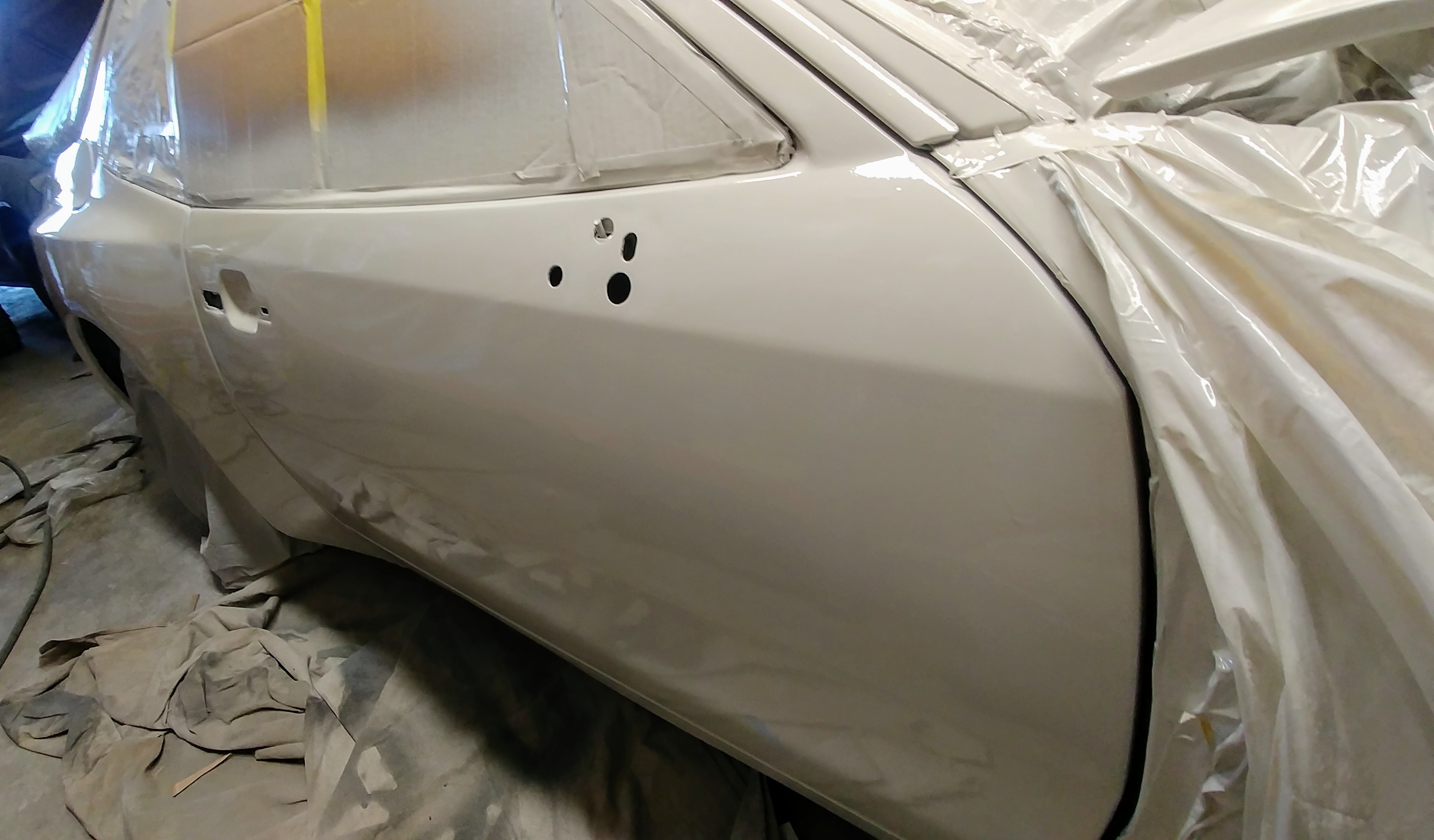

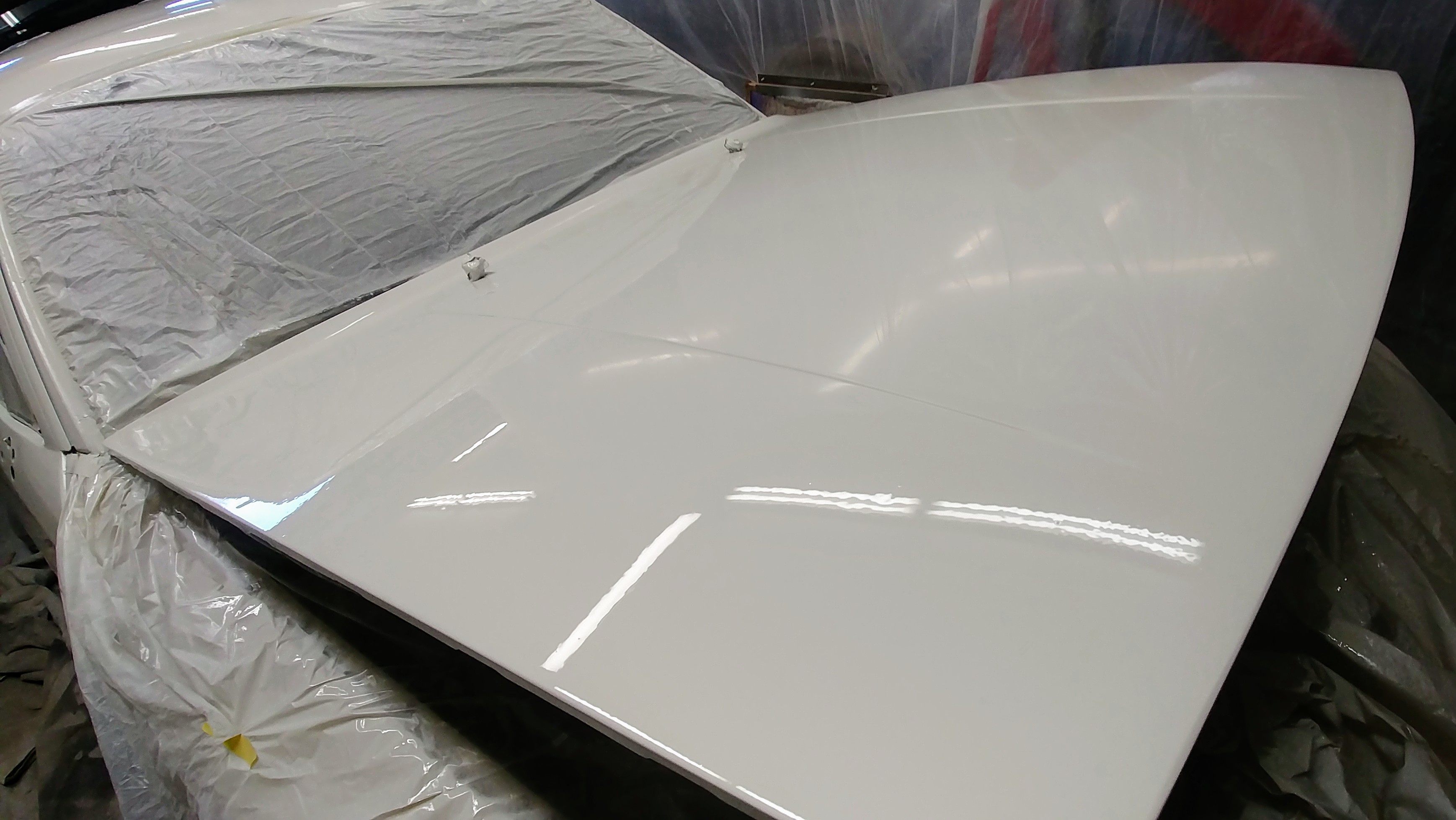

Side tracked this weekend.. Had to finish painting my son's 944. Turned out pretty nice.. 1 spot had a little run but should be able to wet sand it out or I will spot it in.. Attached Image Attached Image
whitetwinturbo
post Dec 26 2018, 11:30 PM
Post #759
Posts: 1,391
Joined: 22-October 11
Member No.: 13,704
Nice!
Is that creme or white?
