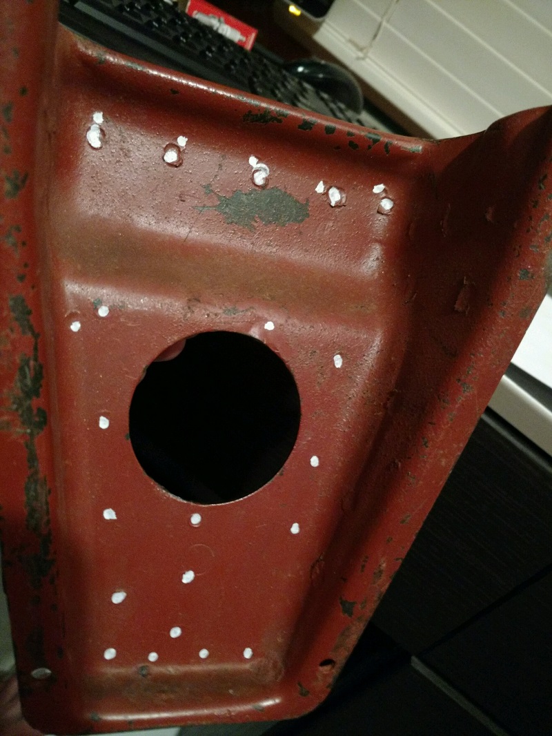

QUOTE(sixnotfour @ Jul 31 2016, 06:48 AM) *
Stupid me I had you original layed out on my firewall for height etc and I wirebrushed the marks off headbang.gif .
The factory piece sits on the bottom pinch weld...comparing the one you made and sent me to the OG one your need to be 1.5mm above the pinch weld..
Appears to be spot-welded directly to the body ...wonder in how many places,mines a copy just like the on shown but is plug welded and the round cutout has been welded also.
Great pic thanks.

sixnotfour
post Jul 31 2016, 01:53 AM
Post #87
Posts: 11,427
Joined: 12-September 04
Member No.: 2,744
approx. 40 spot welds

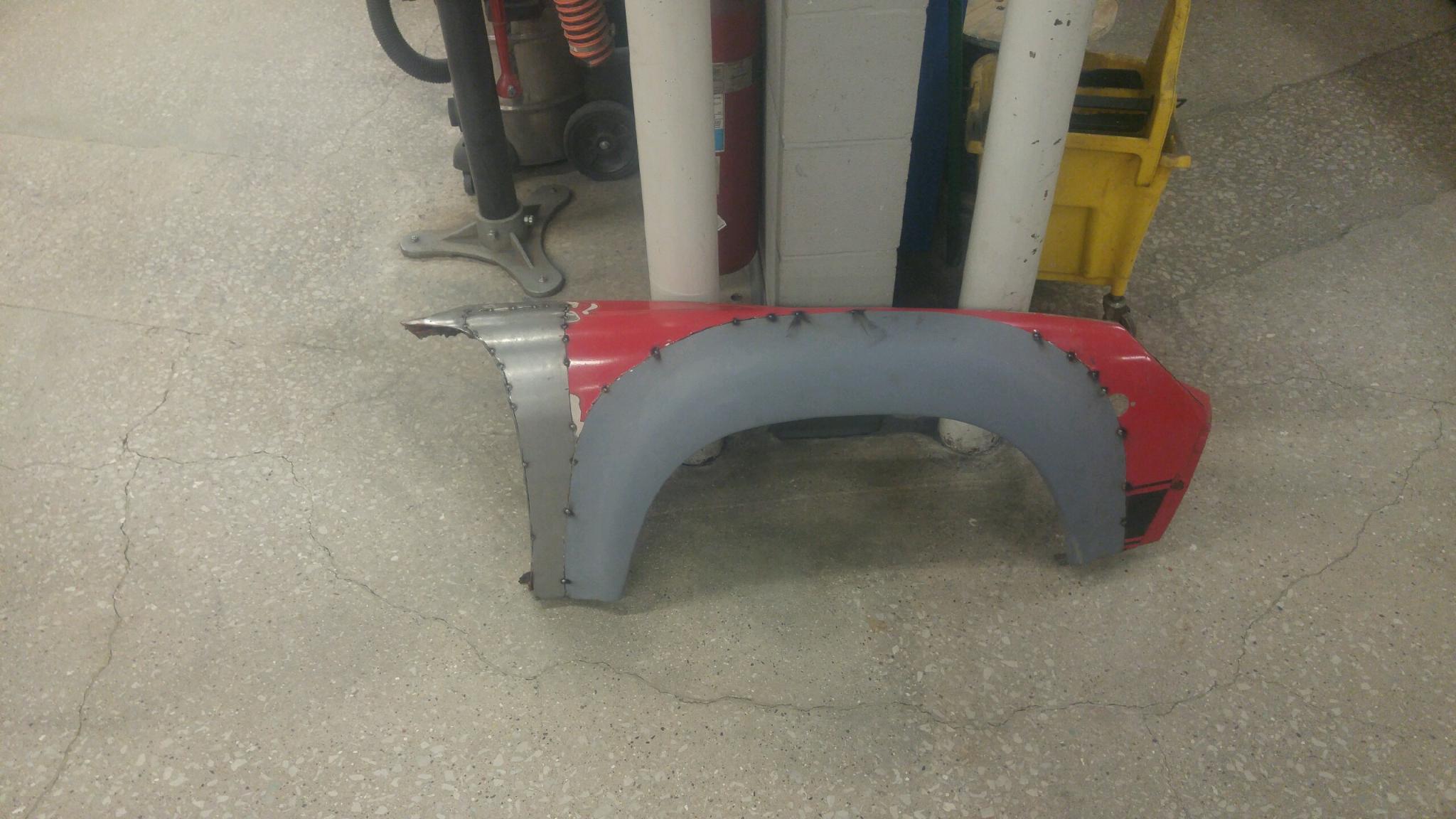

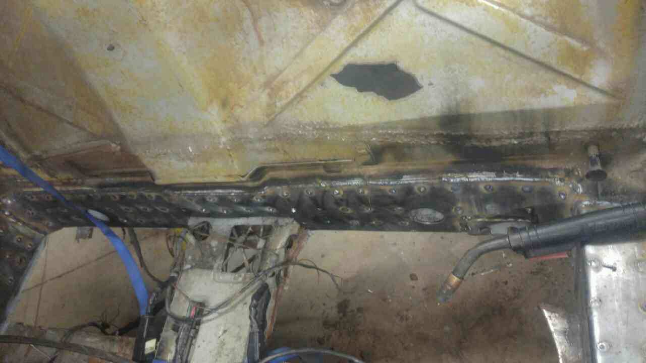

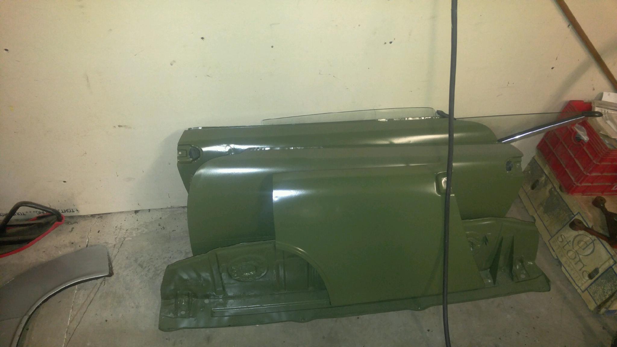

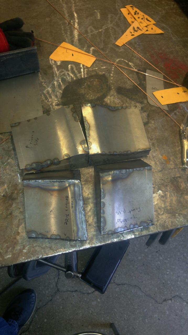

A few update pictures. I have a pile of sand blasted and aviation epoxy primed parts for the car now done. Also a student and I are working making the flares rockers out of steel. That part is hard for me as it only takes me a few minutes but the students much longer to make parts but they really learn allot about fabrication when they start building these types of things Attached Image Attached Image
mb911
post Aug 5 2016, 04:43 PM
Post #93
Posts: 7,845
Joined: 2-January 09
From: Burlington wi
Member No.: 9,892

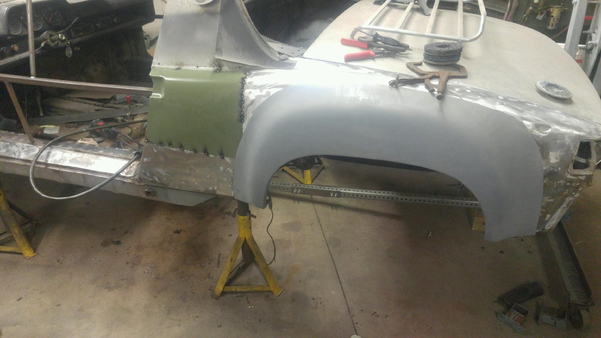

Closer to finished product

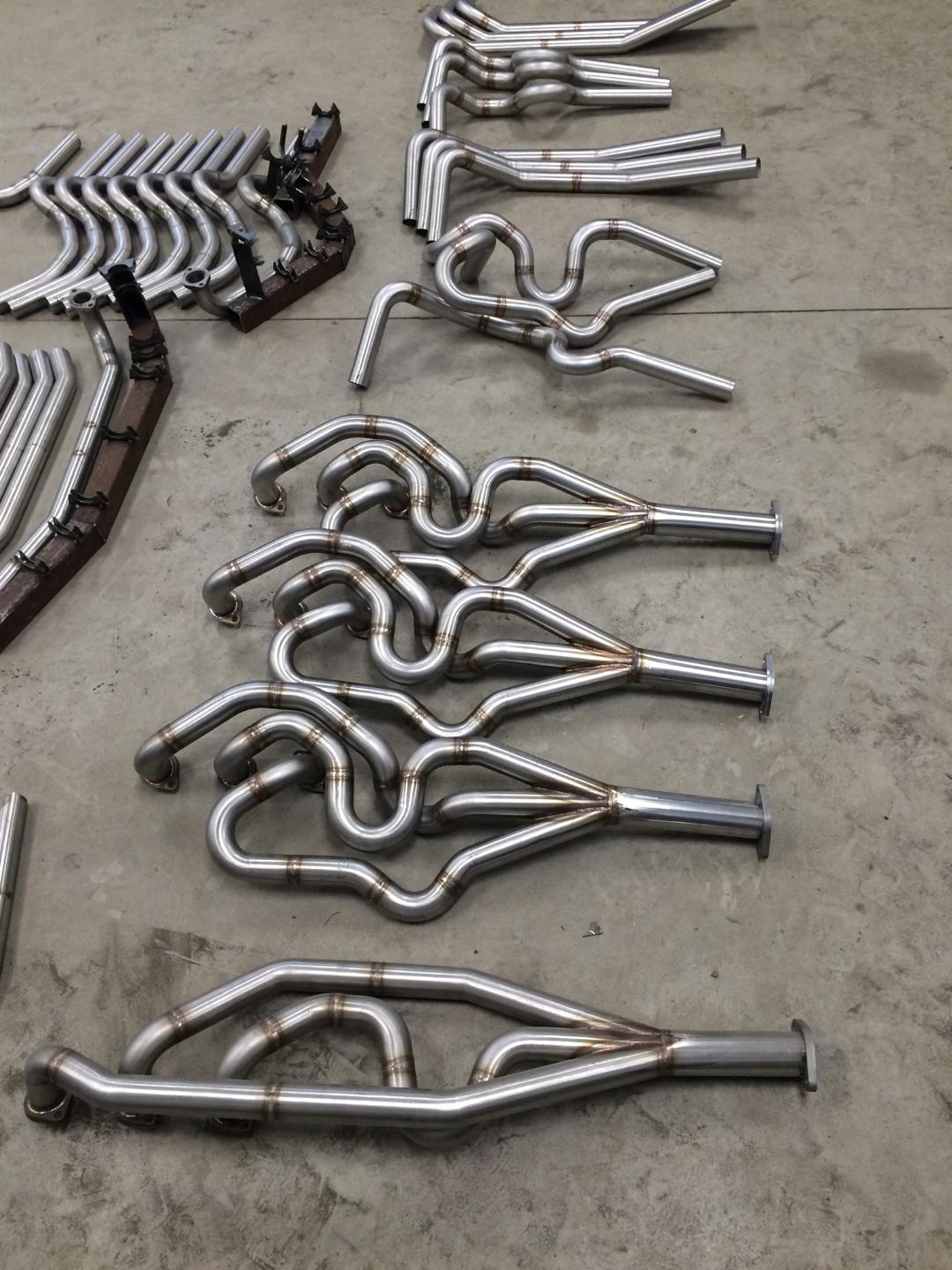

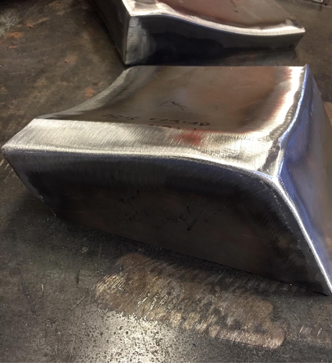

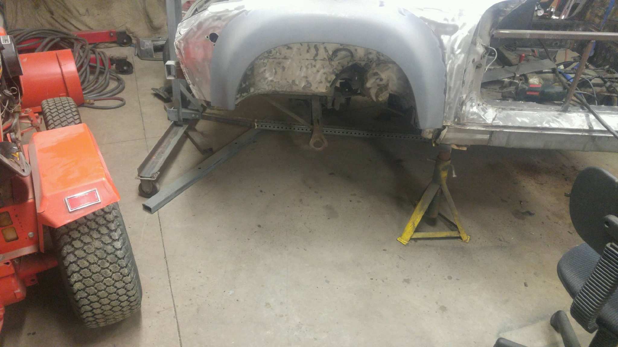

Been a while since I posted on this thread.. I make small progress as I work on oil tanks and heat exchangers..Attached Image Attached ImageAttached ImageAttached Image

Member No.: 17,743
Early in the thread you mentioned wheeling out some flares, then later said you located some. Did you end up making any?
mb911
post Nov 3 2016, 08:32 AM
Post #96
Posts: 7,845
From: Burlington wi
Member No.: 9,892
I made one rear and then found a great deal on a set so I bought a set..much easier

mb911, love your headers......any chance of making 1 1/2 for 2.2L engine sizes. Best, Mark
mb911
post Nov 3 2016, 12:02 PM
Post #98
Posts: 7,845
From: Burlington wi
Member No.: 9,892
QUOTE(mlindner @ Nov 3 2016, 07:19 AM) *
Possibly but not on radar right now.
mb911
post Nov 3 2016, 01:21 PM
Post #99
Posts: 7,845
From: Burlington wi
Member No.: 9,892
Did this today.

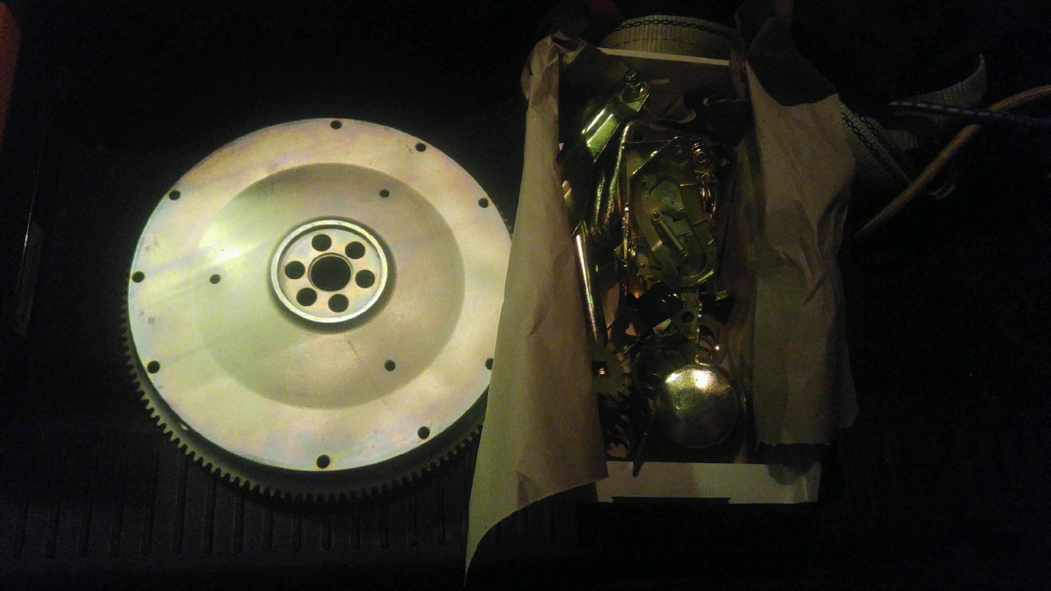

And some parts back from the plater.. I like doing flywheels and brake rotors..Attached Image
