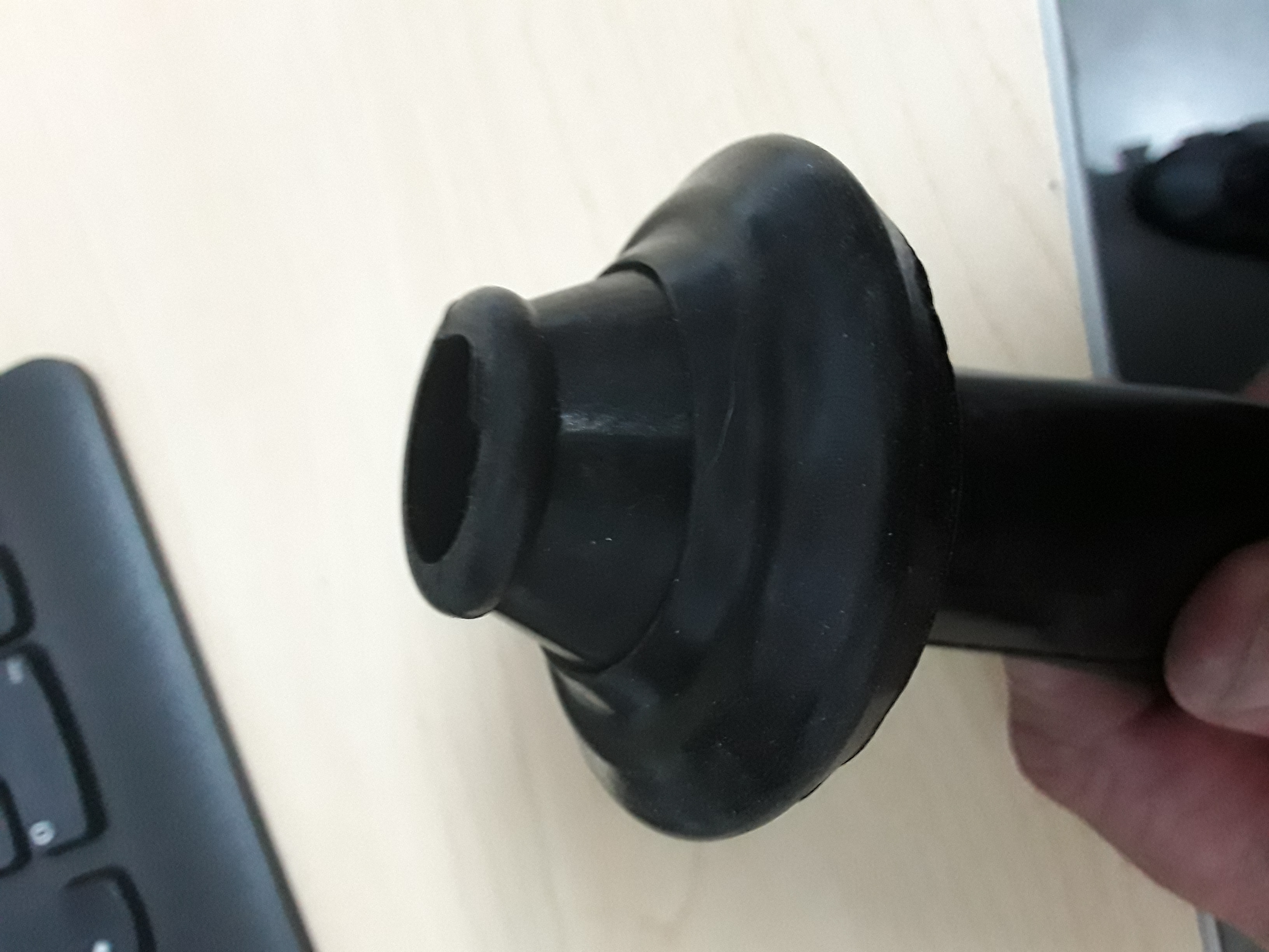

Just placed an order for a new snorkel and the solution that Mark noted. Frustrated a bit.. Attached Image

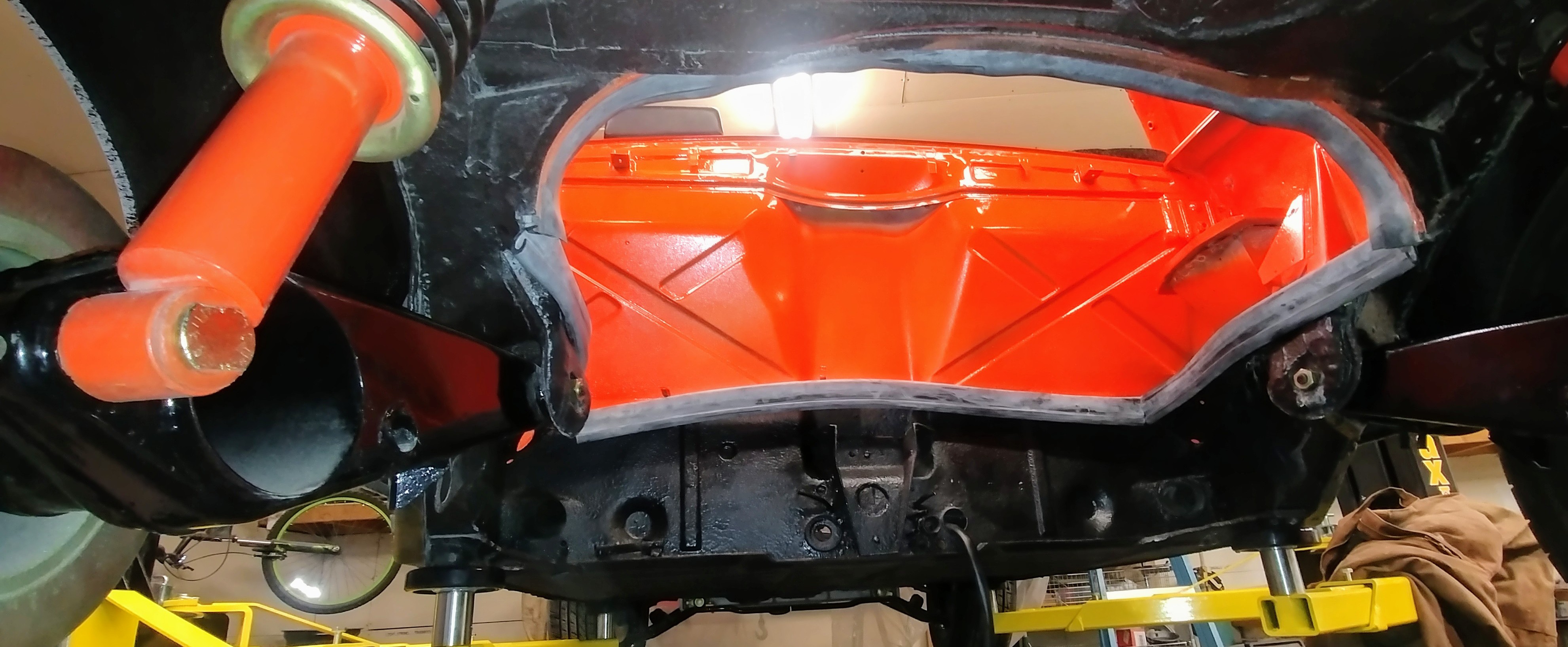

Spent a couple hours working on it tonight. Putting the engine shelf seals in.. Wow so much fun is all I can say..

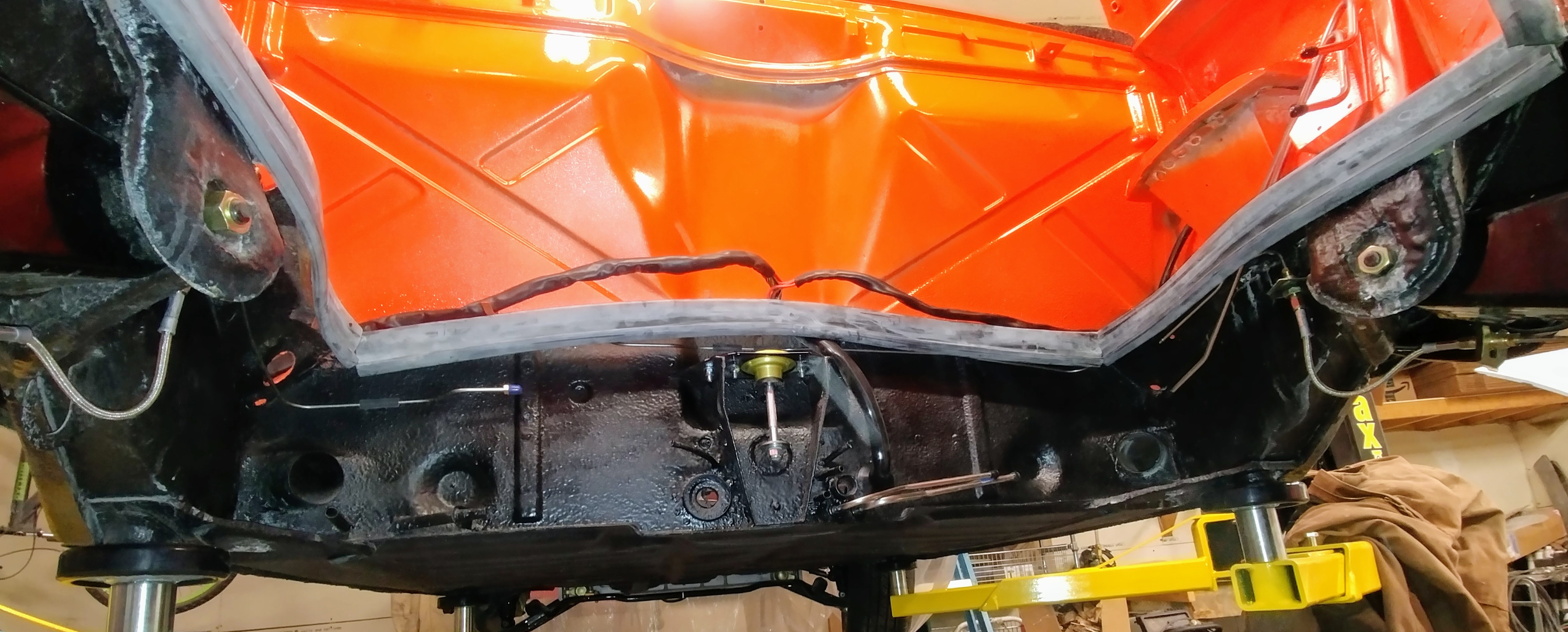

Well spent an hour finishing the engine seal install while I guided my son on Upholstery for the 944. Got the seals in and cut the old snorkel off waiting for the new one to come in. Attached Image

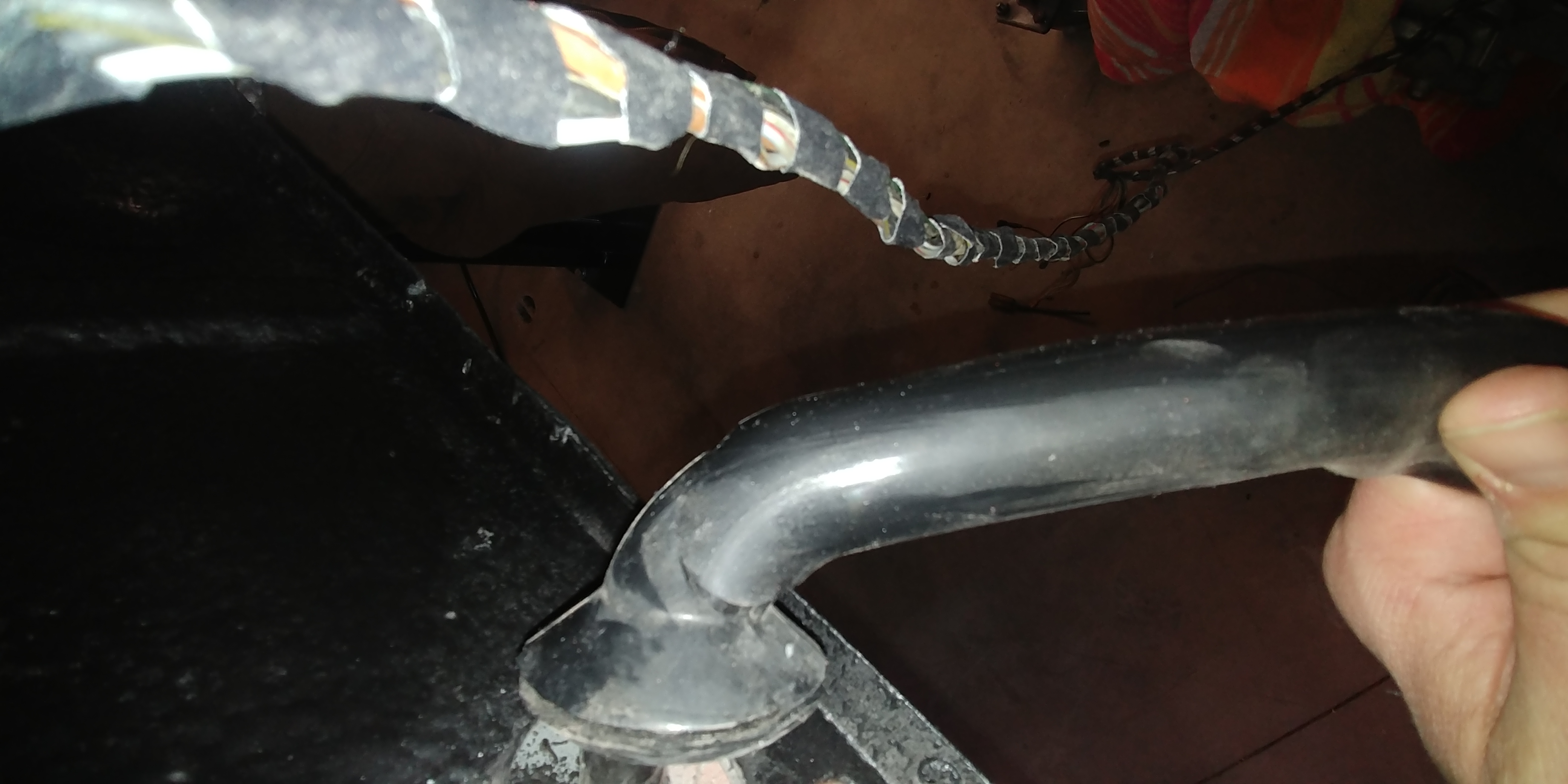

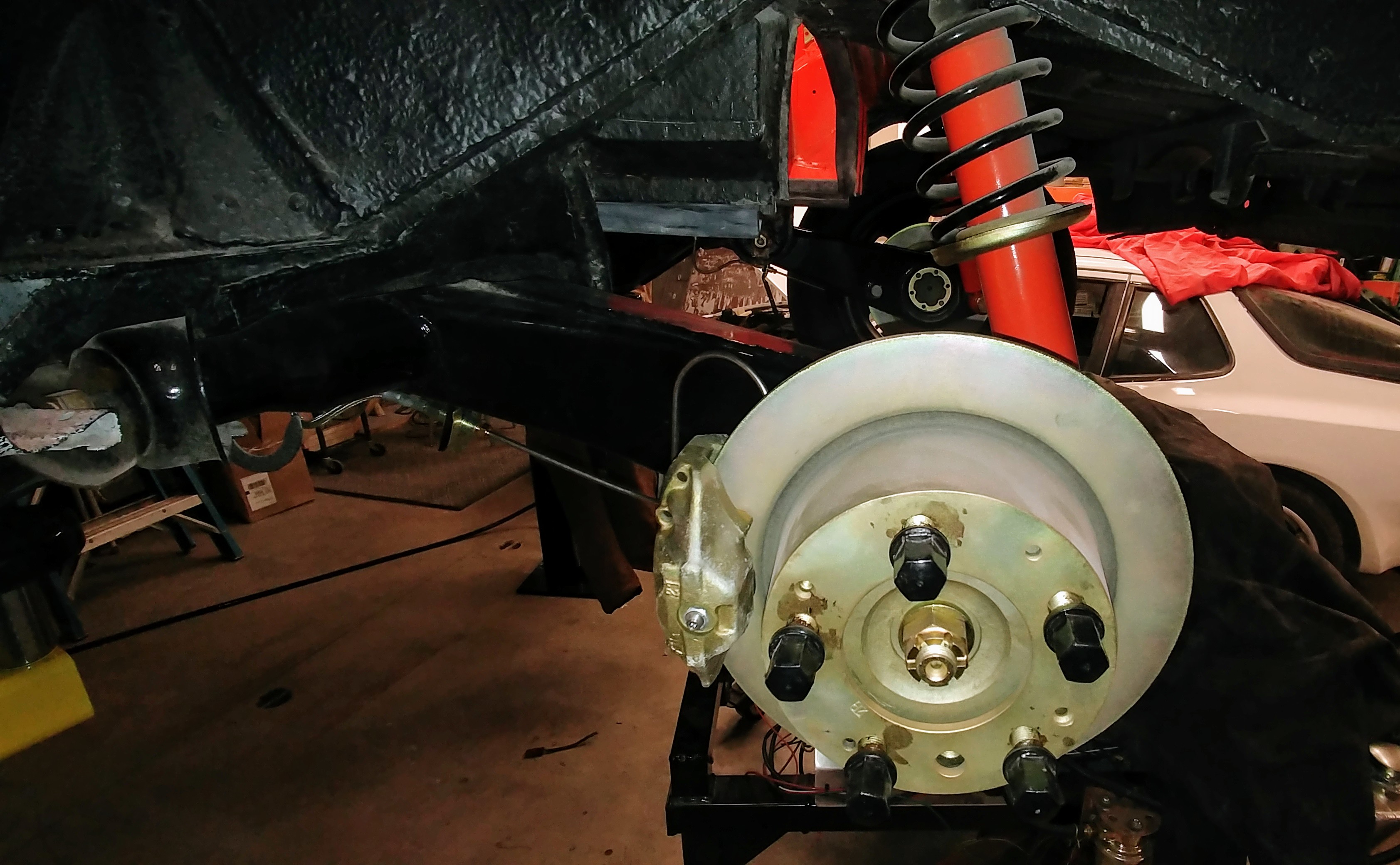

Made some progress.

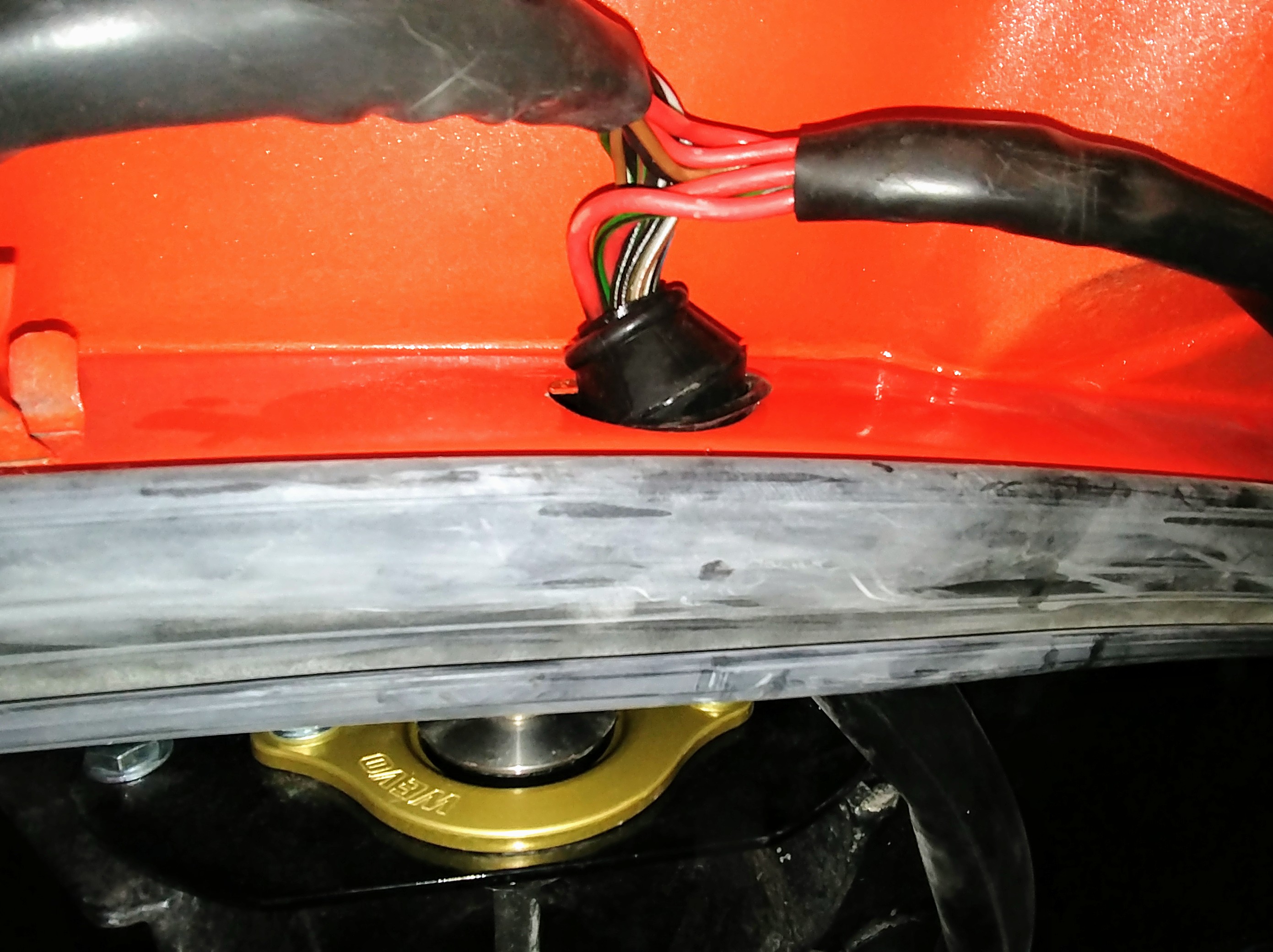

Stainless brake lines from PMB in, braided stainless lines in, 914rubber m/c in Thanks to @mepstein , stainless fuel lines in, wevo front engine mount in, wire harness in with the second 914 rubber snorkel that came in the mail today. Still not happy with the fit and not sure what I am going to do yet. Also note that I need to tape the wire harness yet with the gaffer tape.
Any thoughts on the snorkel fittment. ??? Anyone? @bbrock ?Attached Image Attached ImageAttached Image

[quote name='mb911' date='Mar 30 2019, 08:14 PM' post='2701318']
Am I seeing it right that the rubber adapter piece Mark made is separating from the snorkel? If so, what do you suppose would happen if you glued that piece on. Think it would have enough bite in the hole to hold everything in place? Another thought I had was making or buying a metal adapter piece to reduce the hole diameter. Something like like electrical reducing washers. Might even be able to find one the right size already made? (IMG:style_emoticons/default/confused24.gif)

I might cnc plasma cut something but just stinks that the snorkel is for a 31mm hole and the hole on the chassis is 34mm .

QUOTE(mb911 @ Mar 30 2019, 08:51 PM) *
(IMG:style_emoticons/default/agree.gif) I can't figure out why mine fits okay. Like I said, it was a little loose in the hole, but once I got it positioned, it seems pretty solid. (IMG:style_emoticons/default/confused24.gif)

Member No.: 9,892
QUOTE(bbrock @ Mar 30 2019, 09:11 PM) *
Other than the snorkel, you're car is looking fantastic. (IMG:style_emoticons/default/smilie_pokal.gif)
I am not sure either. I think because it fits around a stock 6 bulkhead mount so it angles it?

I believe the real answer is that there were different size holes through the years, and the 914rubber guys didn't realize that when they first made this product...

I would just start wrapping the end of the rubber snorkel with black electrical tape until it fits the hole.

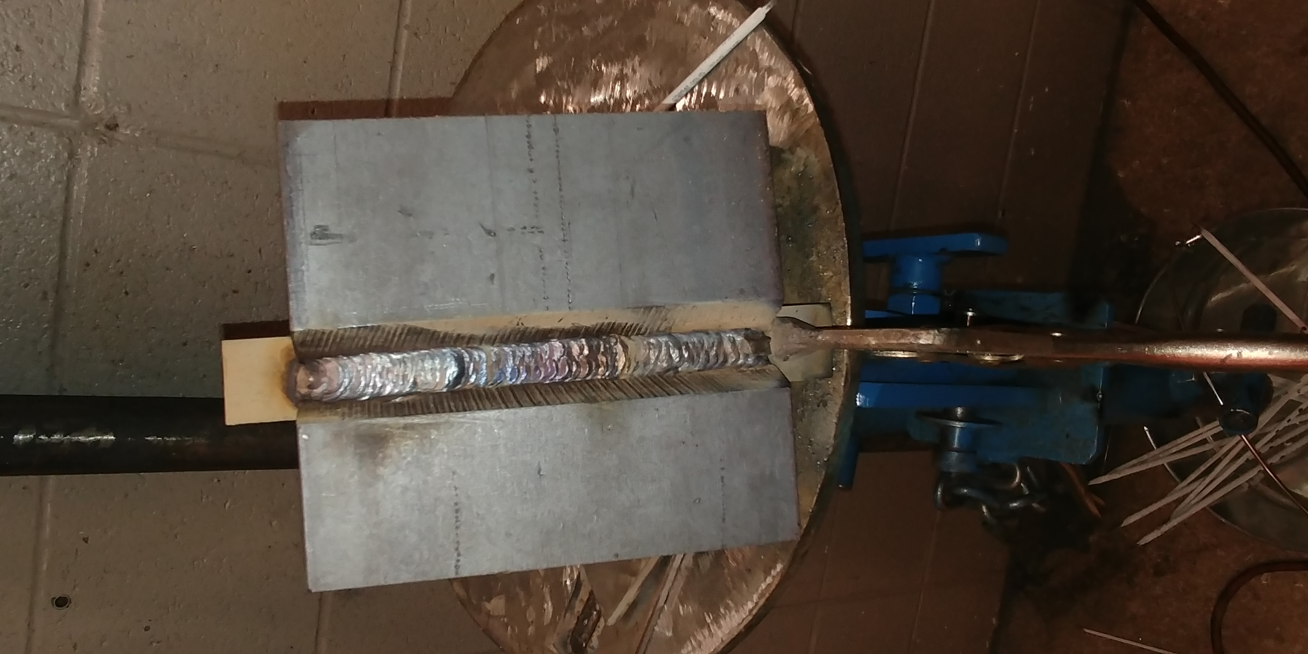

And a nice shot of a d1.1 cert practice. I haven't done one in 15 years as I primarly do TIG. Attached Image Attached Image
