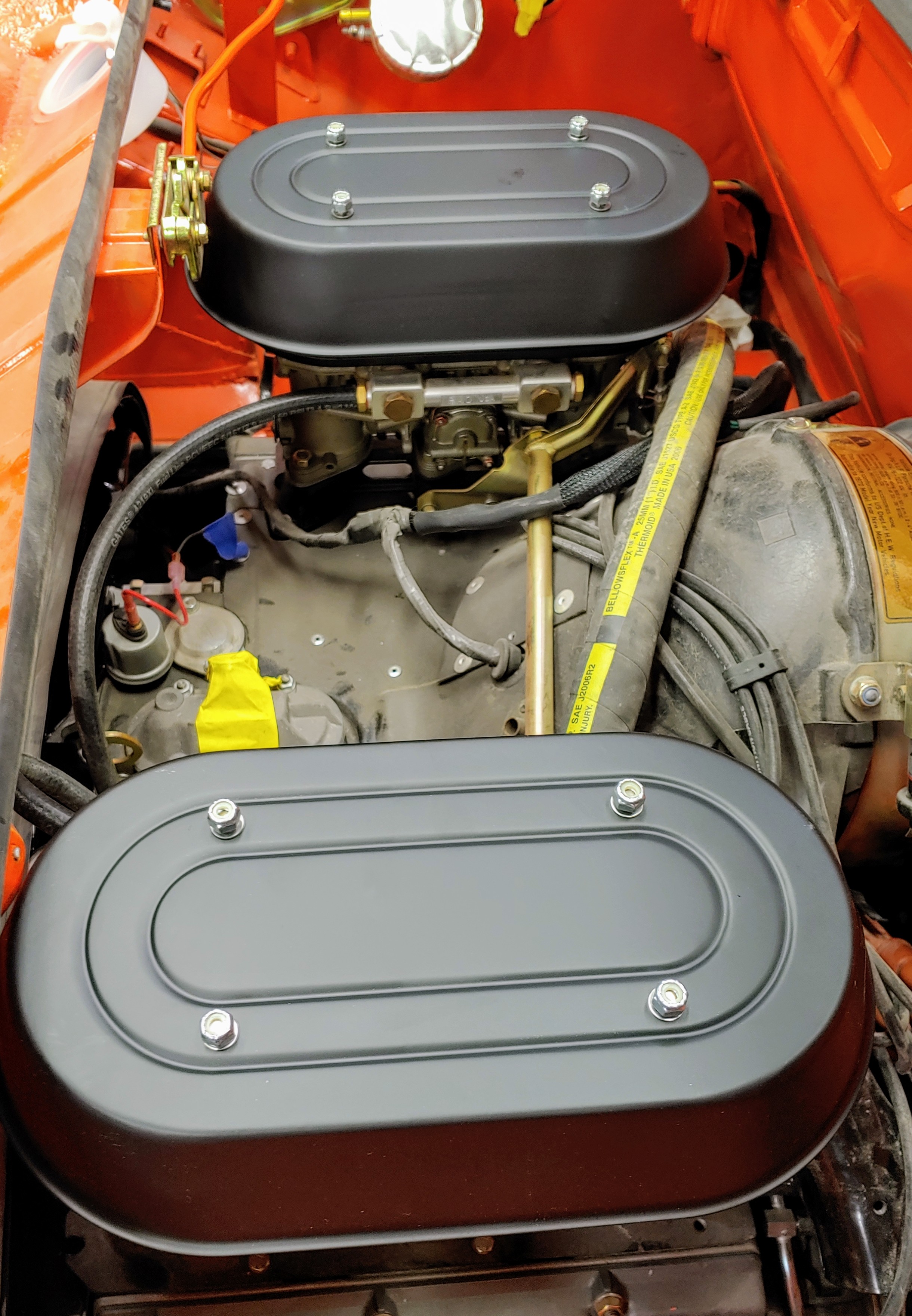

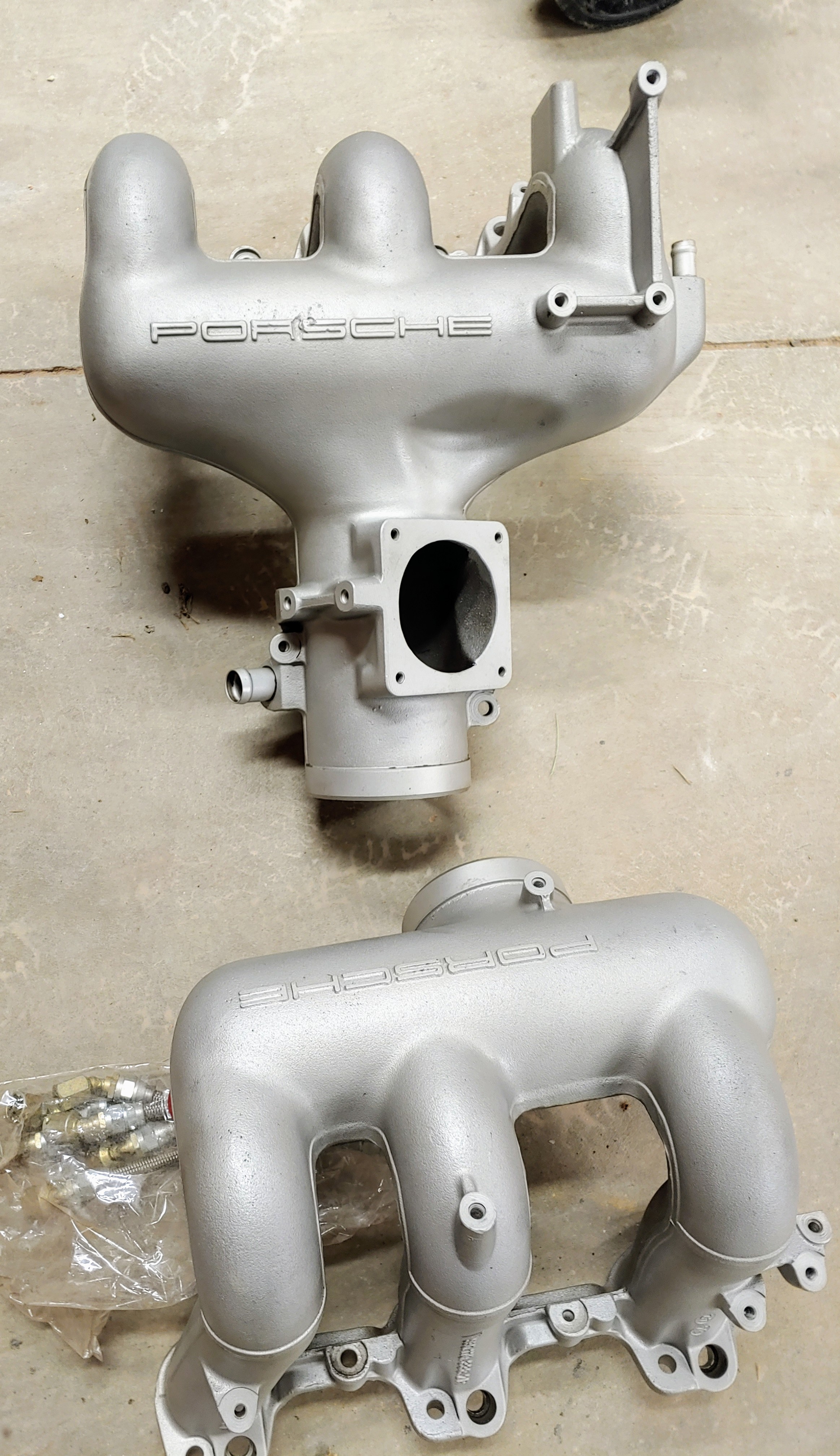

Put the air filter in place though that doesn't seem like a big deal it makes me feel like I am making progress. James car has taken 4 months of summer.. I am almost done but have to get on with some of my projects as well.. I also recieved my 911s calipers the other day. I took them apart today and found they have stainless pistons in them so that saves me some money.. Was going to send them out to PMB but think I am just going to save the money and scuff and cerakote them. I did get ready my first step in efi parts hoarding and clear cerakote on the 3.2 intake.

That is a great intake for an EFI swap, much easier with a single throttle body. And they make decent power.

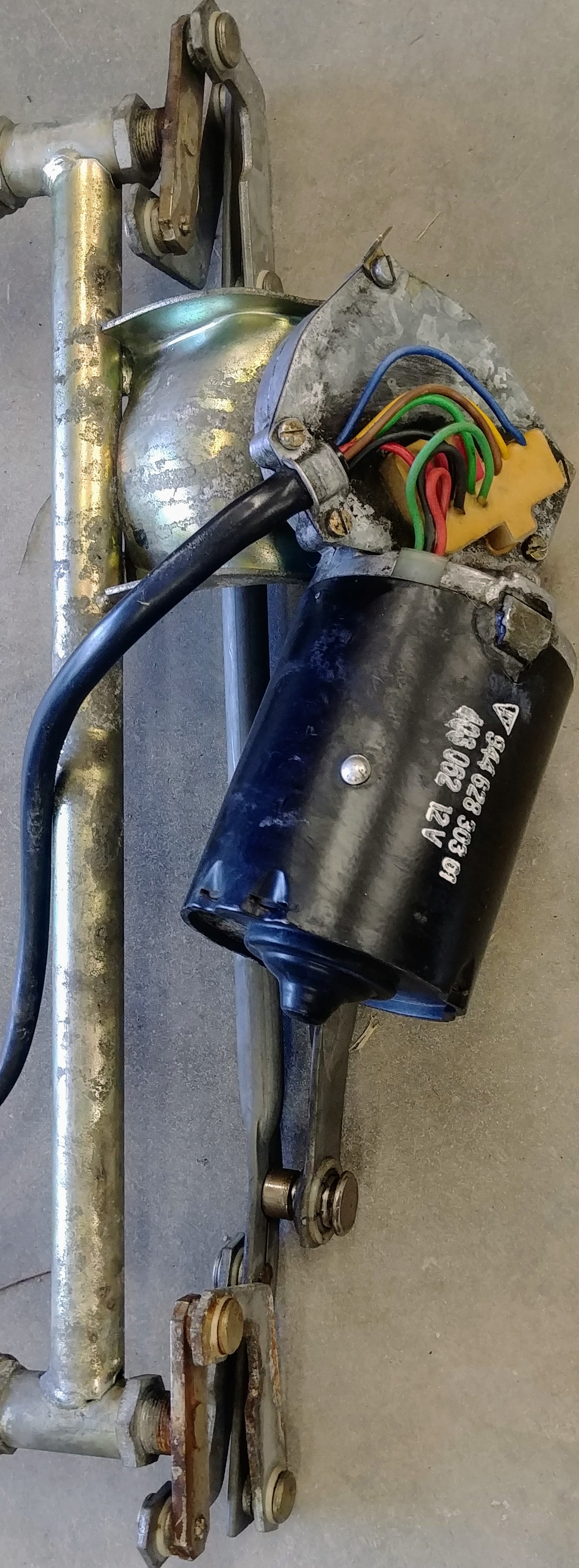

Hello Ben,
I may have missed it in the thread somewhere, but what are the details on your three speed wiper project? Thanks! |

Hello Ben, I may have missed it in the thread somewhere, but what are the details on your three speed wiper project? Thanks! @bahnzai it is just a 944 motor on the stock 914 linkage so that my left side ignition setup with 911 wiper and turn signal stalks work as designed. |

Ah, got it. Thanks!

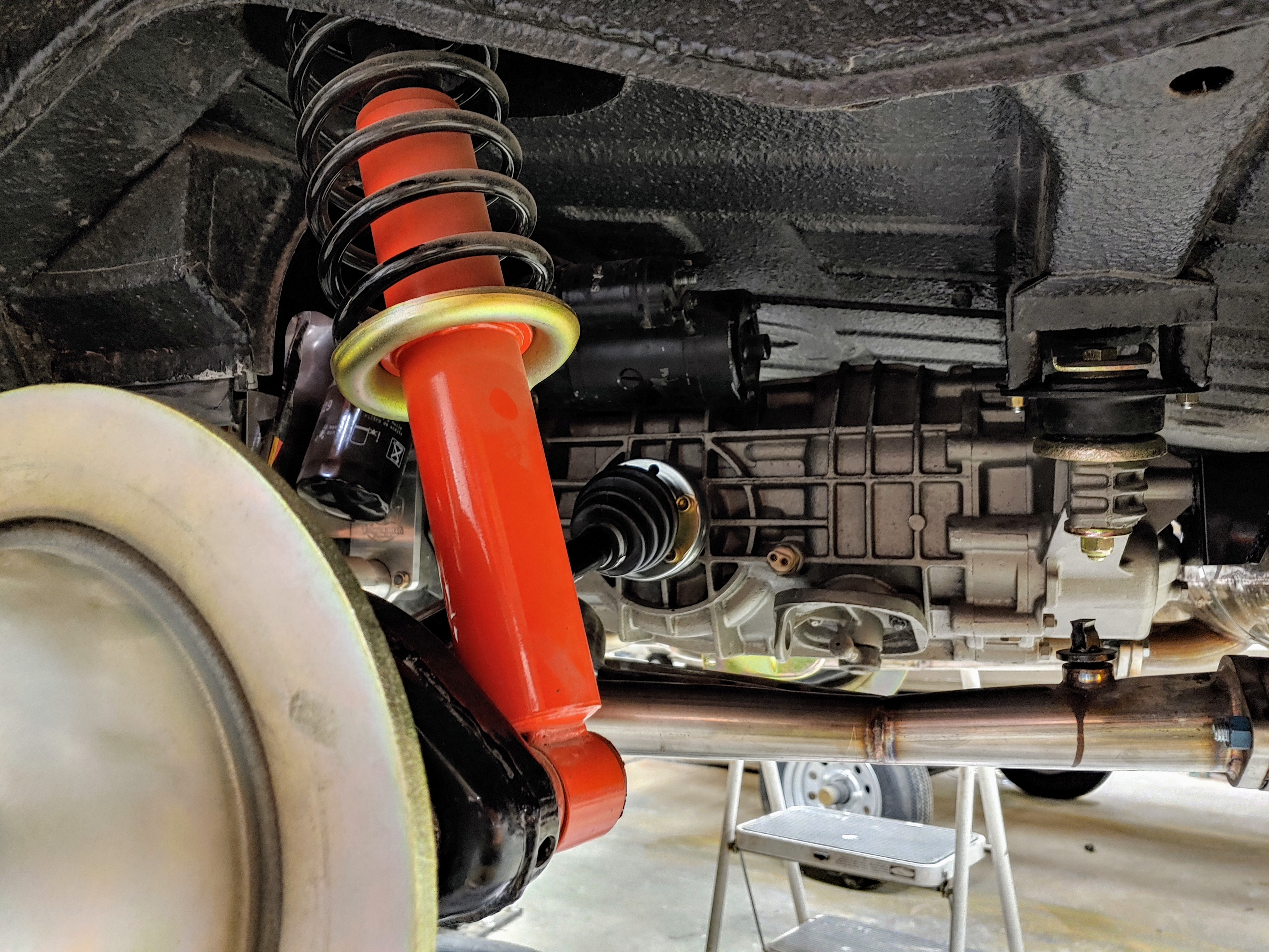

Got a replacement sheet metal part from Garold today for the Front trunk.. So back to weld a small panel in and repaint a little area.. Did spend way to much time putting cvs together then had to put them in the swing arms and had to ask for help because I was in a hurry from @mepstein and @bbrock ..

Got a replacement sheet metal part from Garold today for the Front trunk.. So back to weld a small panel in and repaint a little area.. Did spend way to much time putting cvs together then had to put them in the swing arms and had to ask for help because I was in a hurry from @mepstein and @bbrock .. And I was totally worthless. Did you get them in? |
| mb911 |
Sep 13 2019, 04:37 AM
#890
914 Guru ![]() ![]() ![]() ![]() ![]() Group: Members Posts: 7,794 Joined: 2-January 09 From: Burlington wi Member No.: 9,892 Region Association: Upper MidWest
Yes I did shock bolt removed and it worked perfectly

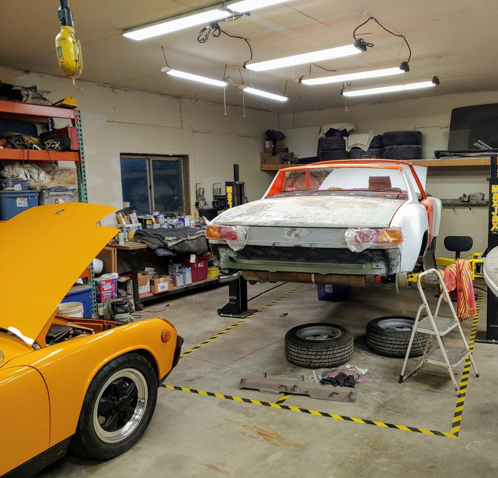

Today I bolted the trunk lid on (the bottom side is already body color), the GT engine lid and started on bolting in muffler heat shield.. Tomorrow the realtor brings the drones for pictures for MLS.. Gotta make the car as much one piece as possible.. I also installed James head light and eye brow covers on. Trying to also purge as much junk as possible.. I now have a pretty good handle on things.

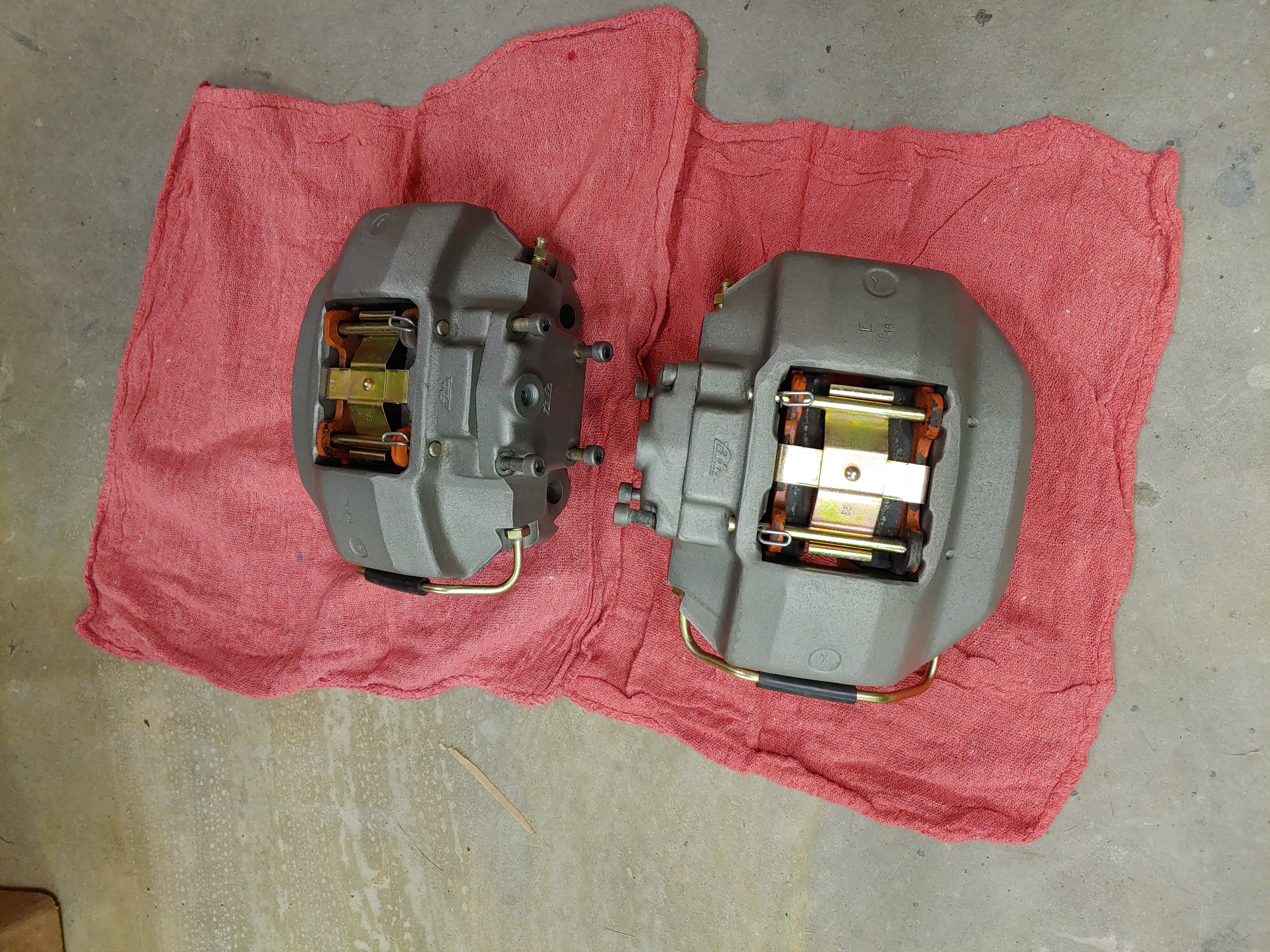

Poor man S caliper rebuild. PMB duro ano pistons, cerakote and replating the steel parts.. The seal that goes on the plate that gets bolted on was not included in the new seal kits. Gotta call Eric Monday and get those and the banjo fittings and then I will finally have an entire working brake setup.
| 914forme |
Sep 28 2019, 07:56 PM
#900
Times a wastin', get wrenchin'! ![]() ![]() ![]() ![]() Group: Members Posts: 3,899 Joined: 24-July 04 From: Dayton, Ohio Member No.: 2,388 Region Association: None
@MB911 Ben is that oven cure or air cure? They do look very nice.
