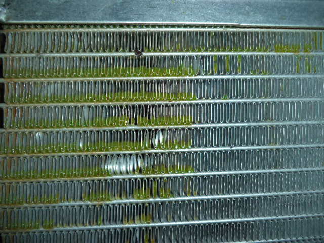

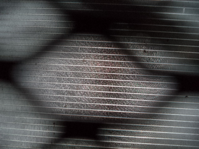

looking at radiator from front, but I have a grill blocking obscuring the view, the leak seems to be along a horizontal tube at the far drivers side of the radiator. pic of center of radiator, so no value related to our discussion (IMG:style_emoticons/default/sad.gif)

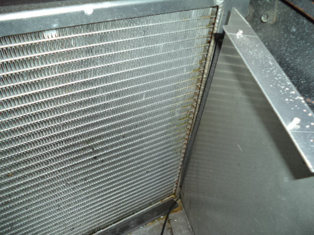

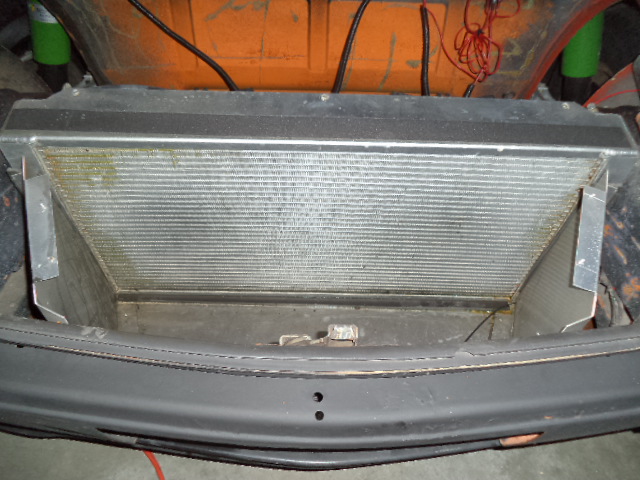

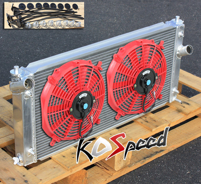

removed shroud cover. seems leak is clearly far more on the passenger side, up high. and radiator is 30.5" x 14.5".
also note that this celica radiator on ebay for $170 is almost exactly the same size.

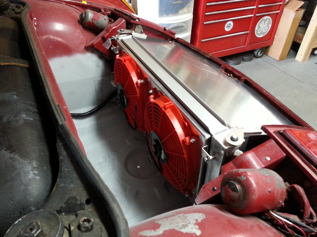

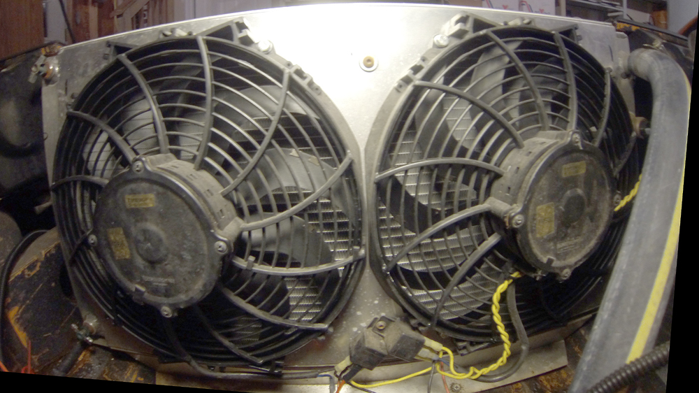

Thats the radiator I have and Mike Bellis has. He's ran it and hasnt had any issues, I have just fabricated my mounting and seems like its a good quality dual core radiator.

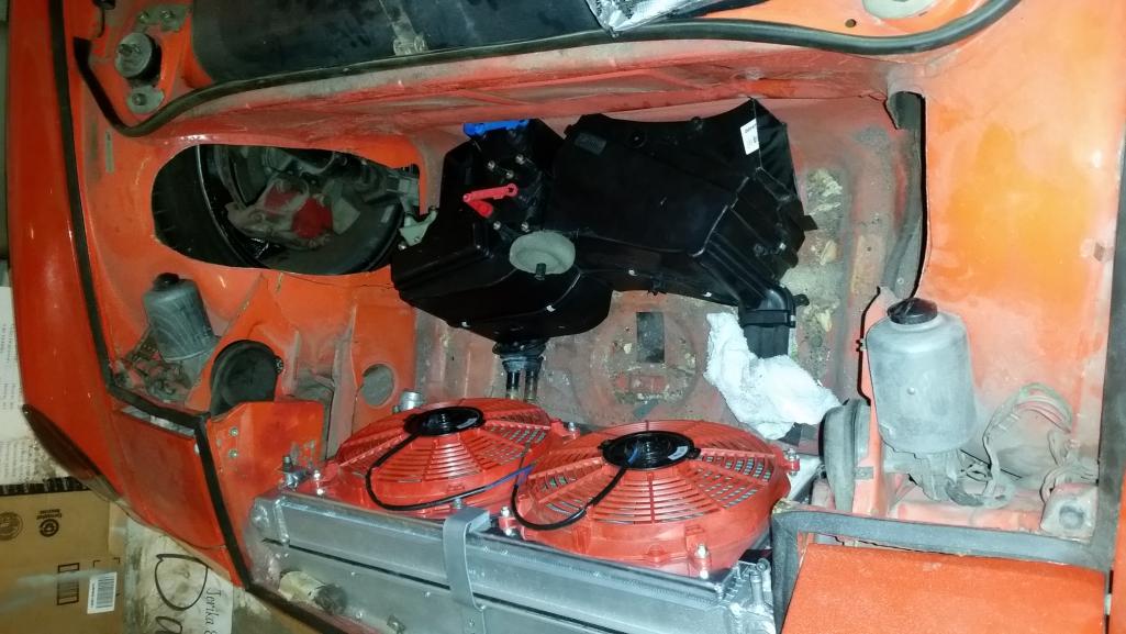

celica radiator threads and a pic from each
http://www.914world.com/bbs2/index.php?sho...4780&st=300
http://www.914world.com/bbs2/index.php?sho...7914&st=400
http://www.914world.com/bbs2/index.php?sho...220569&st=0
http://www.914world.com/bbs2/index.php?sho...=196107&hl=
and an interesting one, non celica.
http://www.914world.com/bbs2/index.php?sho...=132273&hl=

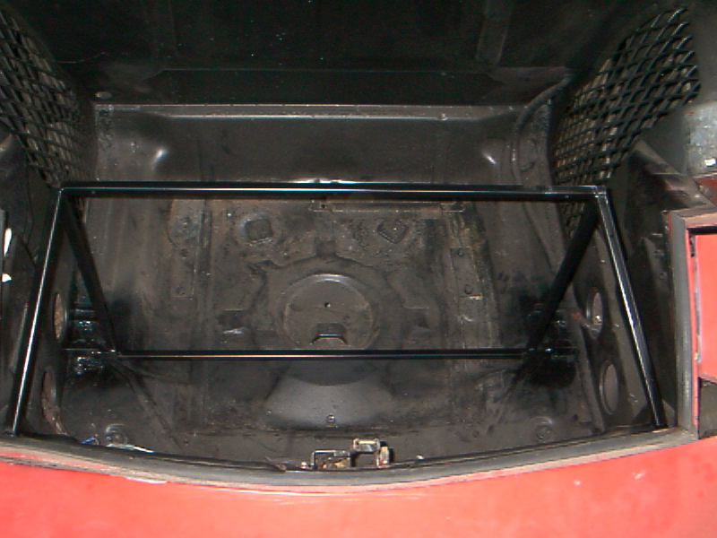

Yup. You can see that I mounted mine really close to the front for extra trunk room since I am doing some other things with my trunk.
