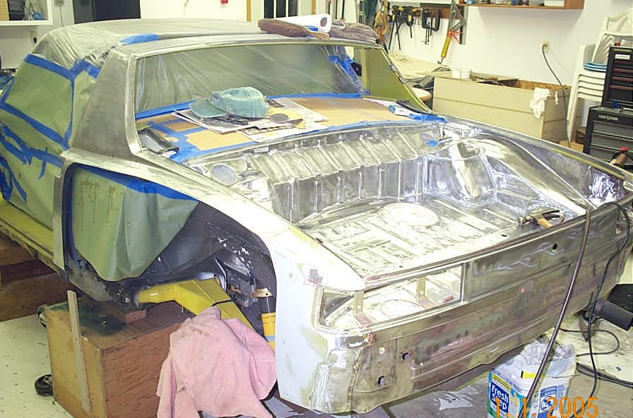

Here's a pic of the hood...half-way through the removal.
(IMG:http://www.hardman.org/pix/914_progress/914_progress-Images/92.jpg)
