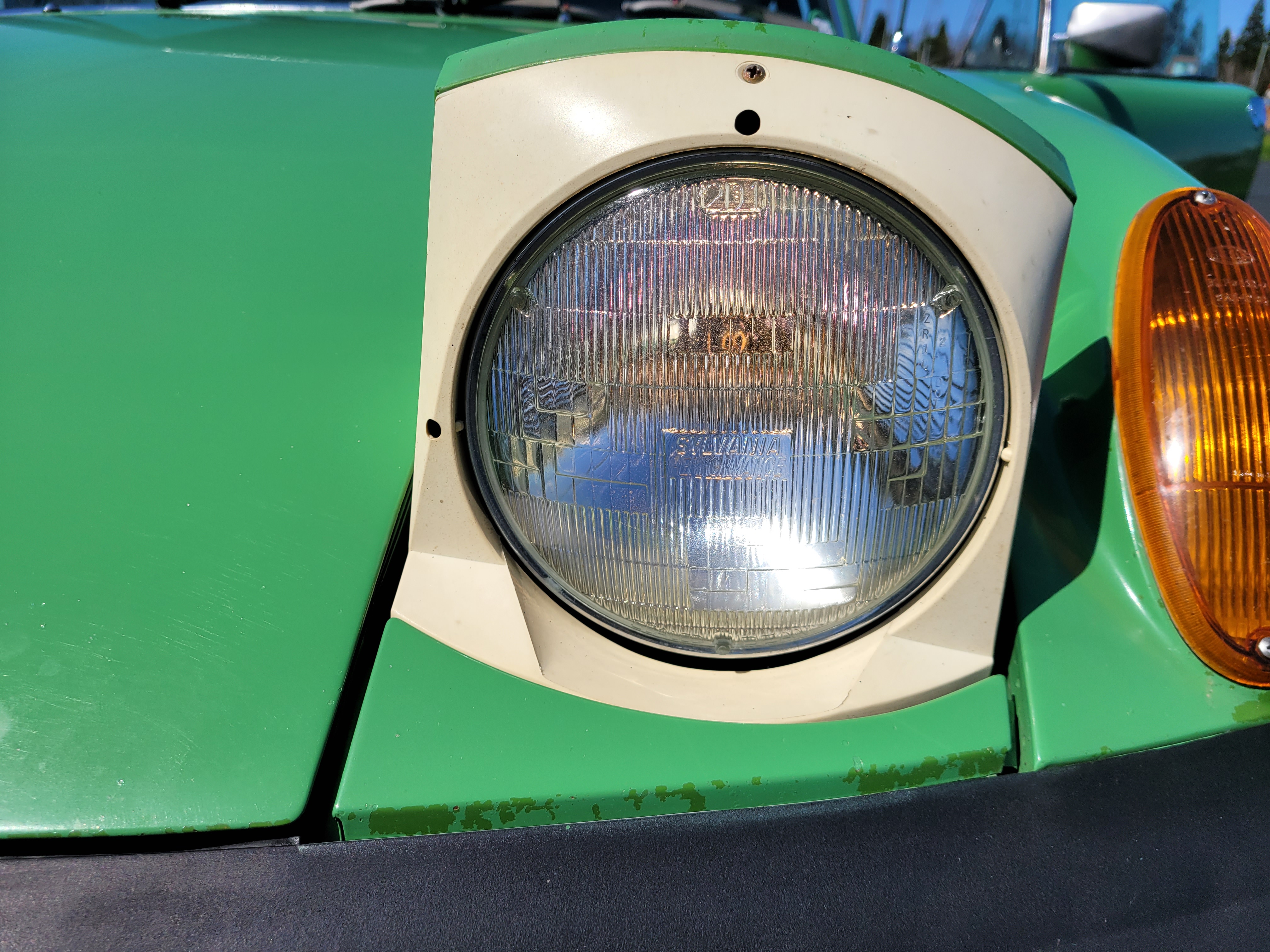

Clean and in the sun. 1972

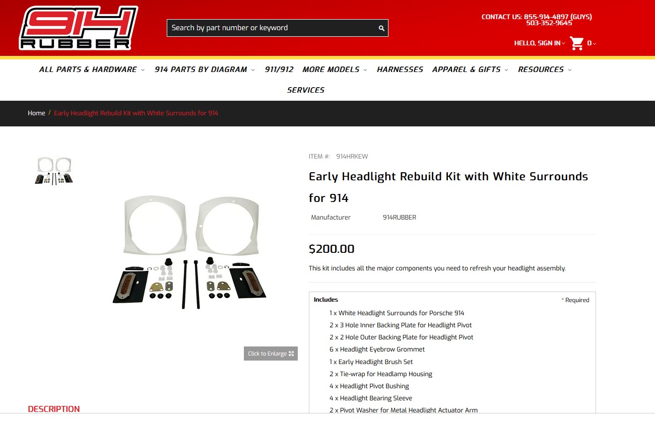

Actually, they were white when they shipped from the factory. We actually did quite a bit of research on these before we made them. Thinking that they were an Ivory. I obtained several sets, and what was confusing was the fact that some were textured and some were smooth.
Here's what I found out -
1- Lots of folks have "restored these". The smooth was actually textured and someone had primered and painted them with an ivory white paint.
2-I got a NOS set and they were textured, also an ivory color.
It makes more sense that they all were textured, as the mold cost was quite a bit. Changing made no sense.
To make sure we got the correct color we actually sanded into the plastic (on the inside where it couldn't be seen). We found that the plastic was actually not an ivory, but a more true white. Over time and UV exposure it gets an ivory color. I suspect this is why factory changed from the white to the black.
Got everything you need to rebuild the assemblies right here -
https://914rubber.com/early-headlight-rebui...rrounds-for-914
As well as stand alone (just the surrounds) -
https://914rubber.com/headlight-surrounds-for-porsche-914

QUOTE(Shivers @ May 23 2023, 08:36 PM) *
What was your process? Going to try easy off this weekend for starters.

QUOTE(flat4guy @ Jun 1 2023, 07:17 PM) *
I cleaned several sets with soap and water and the submerged in a partial bleach bath for a week, but checked and cleaned them daily until they looked original again. Had to buy a cheap fish tank to hold the bleach water.

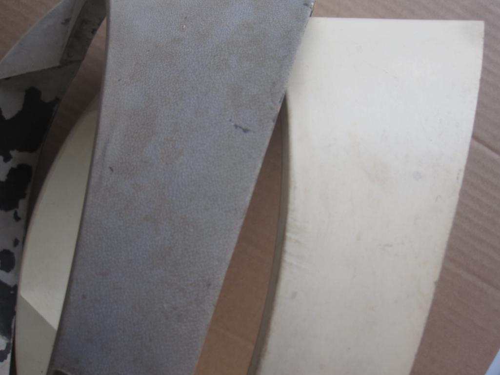

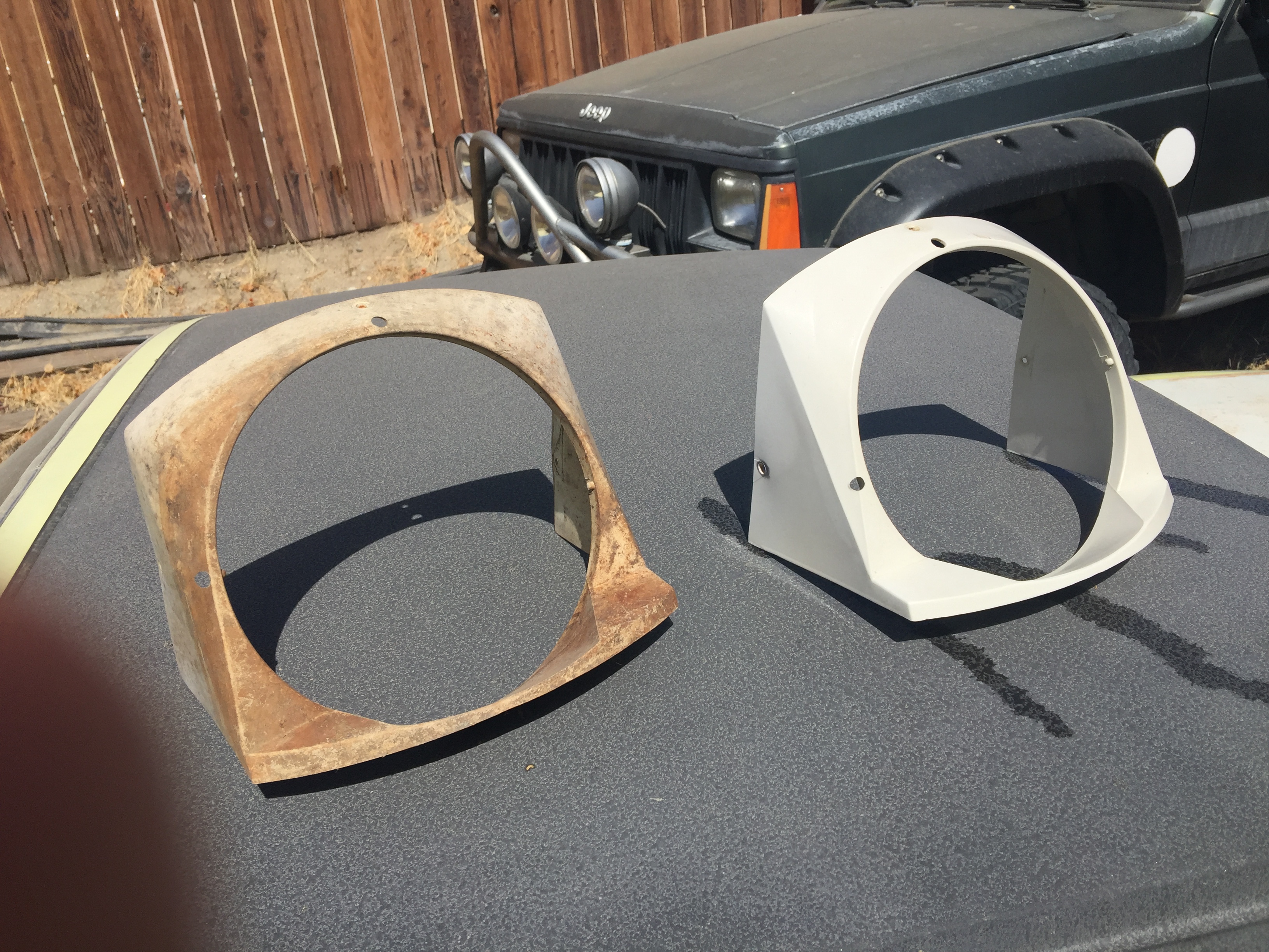

I don't know if this will be of interest to anyone, but there must have been a few different vendors for these. After many hours of stripping with acetone and soaking in a bleach solution, there is where we are left. These are clearly different materials. The one on the right is semi-opaque. Neither has a Porsche part number on them. Neither has any texture. I am guessing they are old, but aftermarket. I thought I was restoring something original, but may end up painting them after all.

Dennis be carefully with acetone,used sparingly it fine but it can cause plastic to go brittle or melt.
IMO a good colour would be VW Alpine white code L90E ,a lacquer and you could get it mixed into a spray can ,seen it mixed and its bright white with yellow and black tinters should be spot on.
I would apply a primer suited for over plastic just to be correct for maximum adhesion.
See how you go,cheers.

The problem you run into "restoring " these is the texture. Acetone will remove some of the texture, and paint fills it in.
Yes the new ones are an off white, but you will never be able to make them look like new with correct finish.
That's why we made them
Like others said it was a bleach / water bath for a week and simple green after. I didn’t
use anything abrasive.

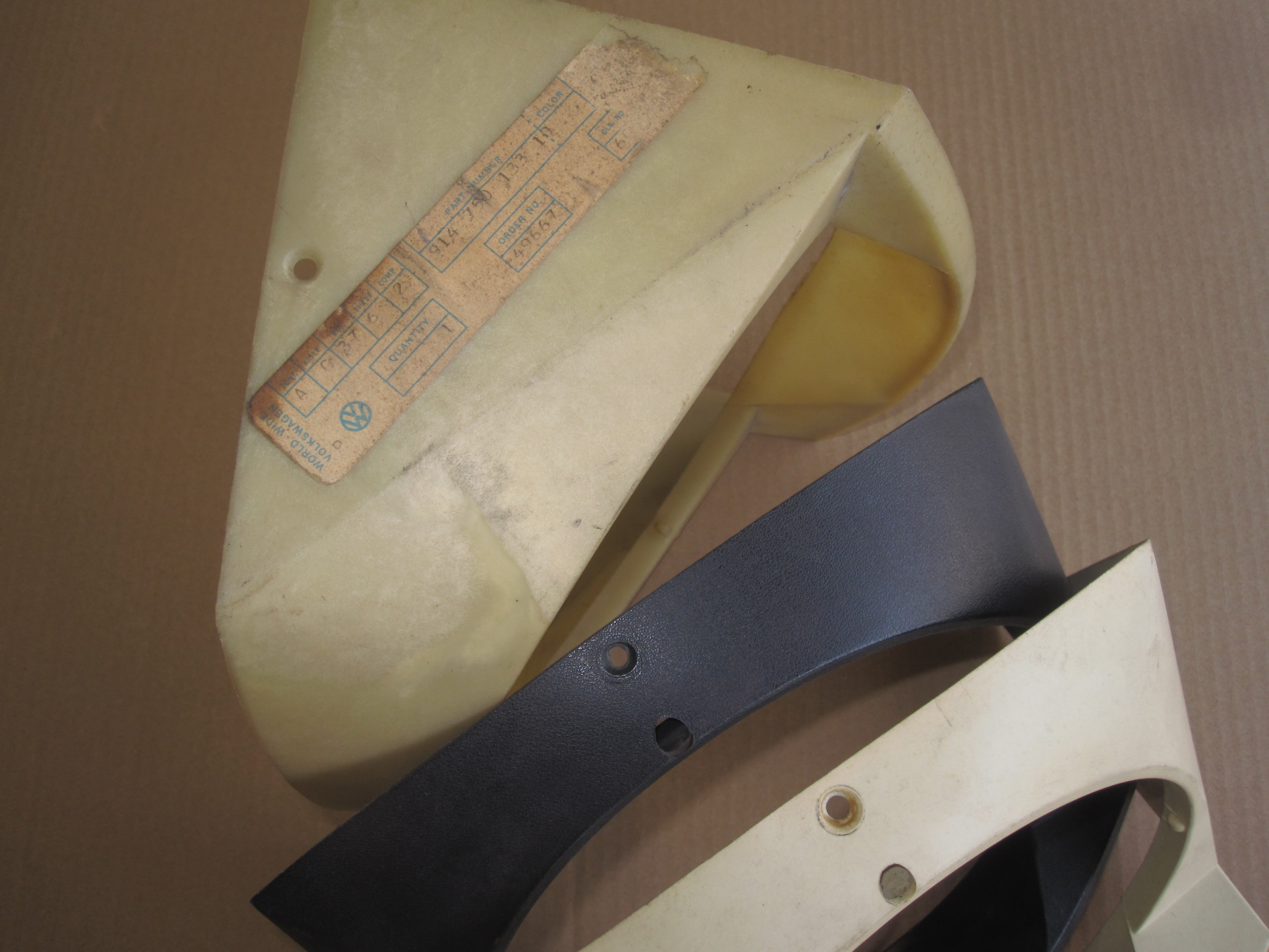

Since joining this thread, yes 2 years ago, I've been on the lookout for originals in good shape. My understanding is ones with Porsche part number raised inside qualify as original.
After looking at a ton of photos, I have a theory that the part numbers ending in .10 were smooth and white. The part numbers ending in .11 were textured and could be white or black. Has anyone seen something to the contrary?
Did your NOS textured ones part number end in .11 Mikey? If not, you can bust my theory. (IMG:style_emoticons/default/biggrin.gif)
