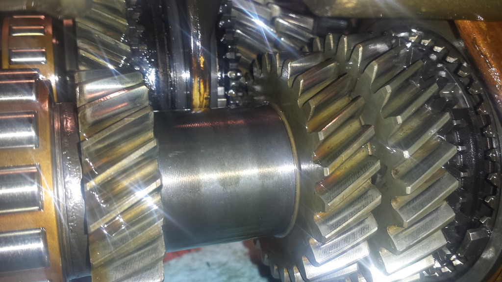

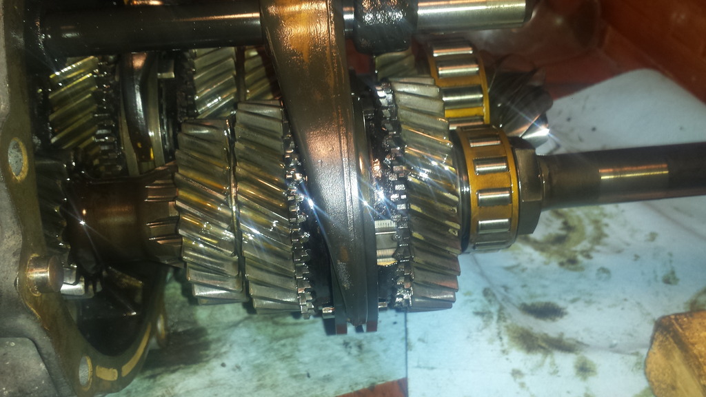

That's all good information. What I'm hearing is that unless you're trained transmission mechanic, you're best just using the original stack, case and intermediate plate.
Yesterday I pulled the stack out of the spare transmission (with the bad 1st gear dog teeth, slider and syncro). Mainly just to see how the other gear sets looked and to help with re-assembly on the '76 trans shift forks and rods. The syncros and dog teeth on that stack look okay but not as good as the '76.
Everything went back in well but unfortunately the threaded end of the pinion shaft got mushroomed a bit and I'll need to chase those threads. It's always something (IMG:style_emoticons/default/sad.gif)
(IMG:http://www.914world.com/bbs2/uploads_offsite/i1336.photobucket.com-16456-1451867492.1.jpg)
(IMG:http://www.914world.com/bbs2/uploads_offsite/i1336.photobucket.com-16456-1451867492.2.jpg)
(IMG:http://www.914world.com/bbs2/uploads_offsite/i1336.photobucket.com-16456-1451867492.3.jpg)
