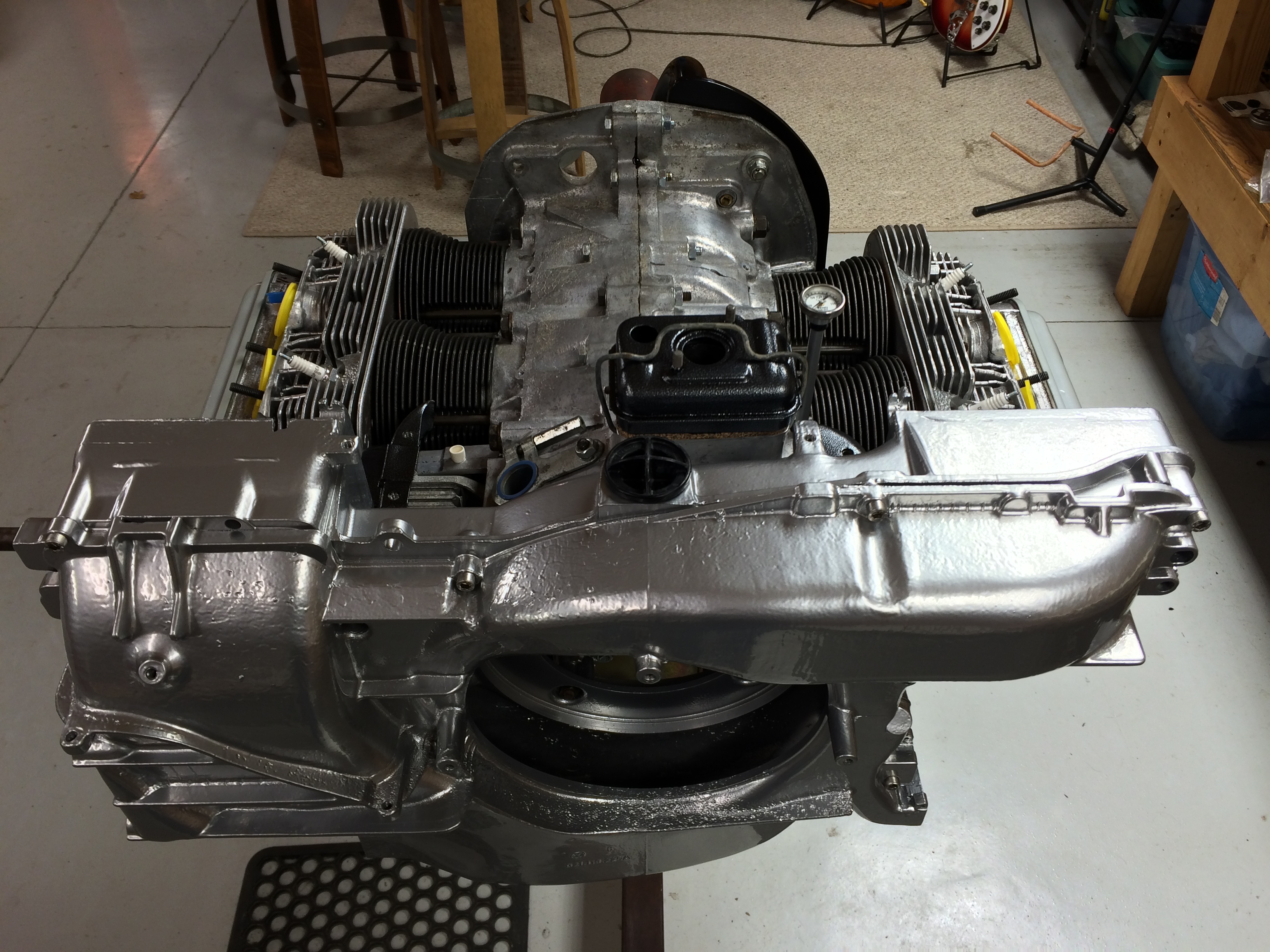

QUOTE(sdoolin @ Aug 15 2016, 09:31 PM) *
Powder coating finally done. I think it all turned out pretty nicely. Still gonna be awhile till it runs. I still need a dizzy, going to ceramic coat the header/muffler (Bursch), and the dual Dells need to have the CB update kits installed along with complete rebuild.
Are you missing some tin?

QUOTE(billh1963 @ Aug 21 2016, 07:10 AM) *
Don't believe so. I just did a complete mock-install with it all today, and all is accounted for. The rear plate is not in the picture but I have it. Now if I could just find all of the rubber bits I need (Alt cooling elbow and a half dozen grommets for wiring harness(es)...

QUOTE(sdoolin @ Aug 21 2016, 05:36 PM) *
Looked like you were missing one of the under cylinder head pieces. Maybe I just didn't see it.

QUOTE(billh1963 @ Aug 21 2016, 05:39 PM) *
I have them both, they are sandwiched together in the pic. Good eyes...

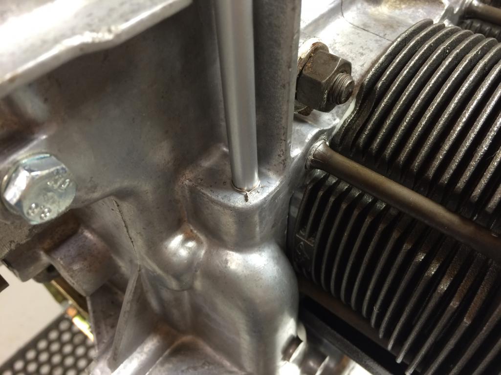

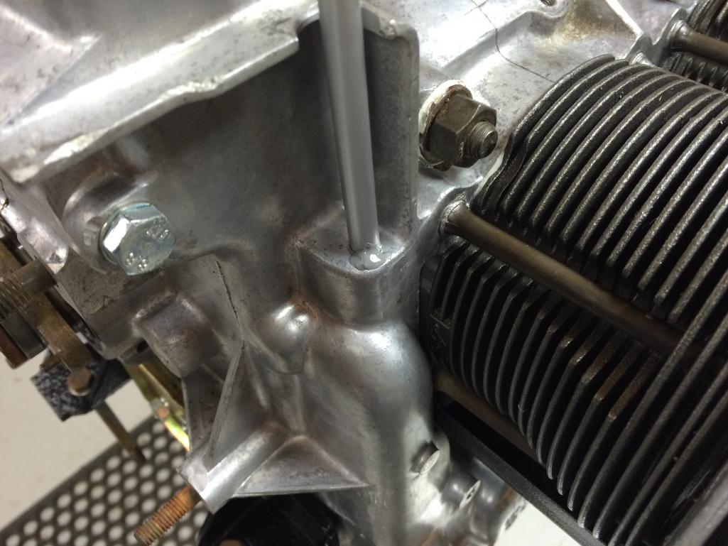

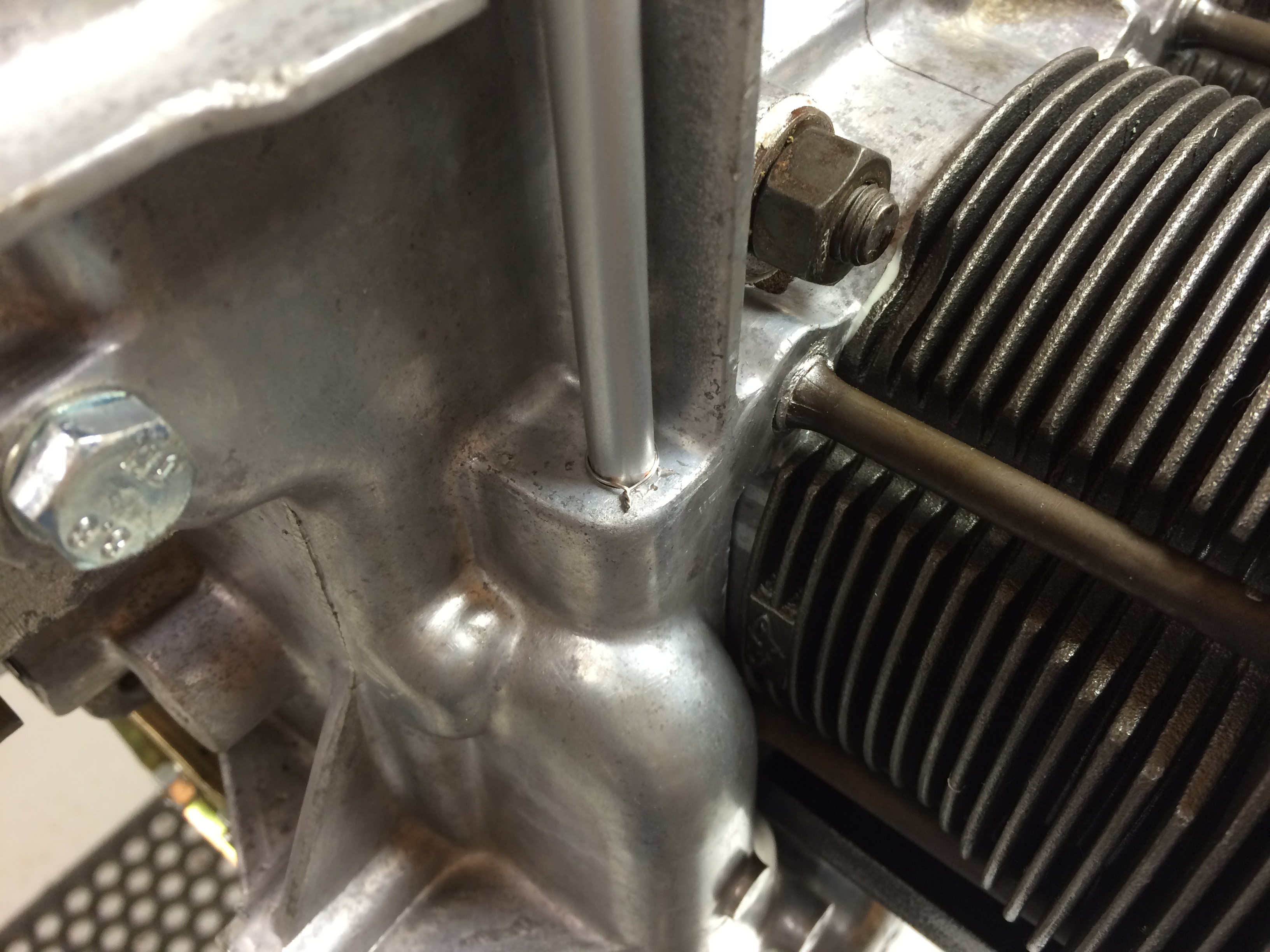

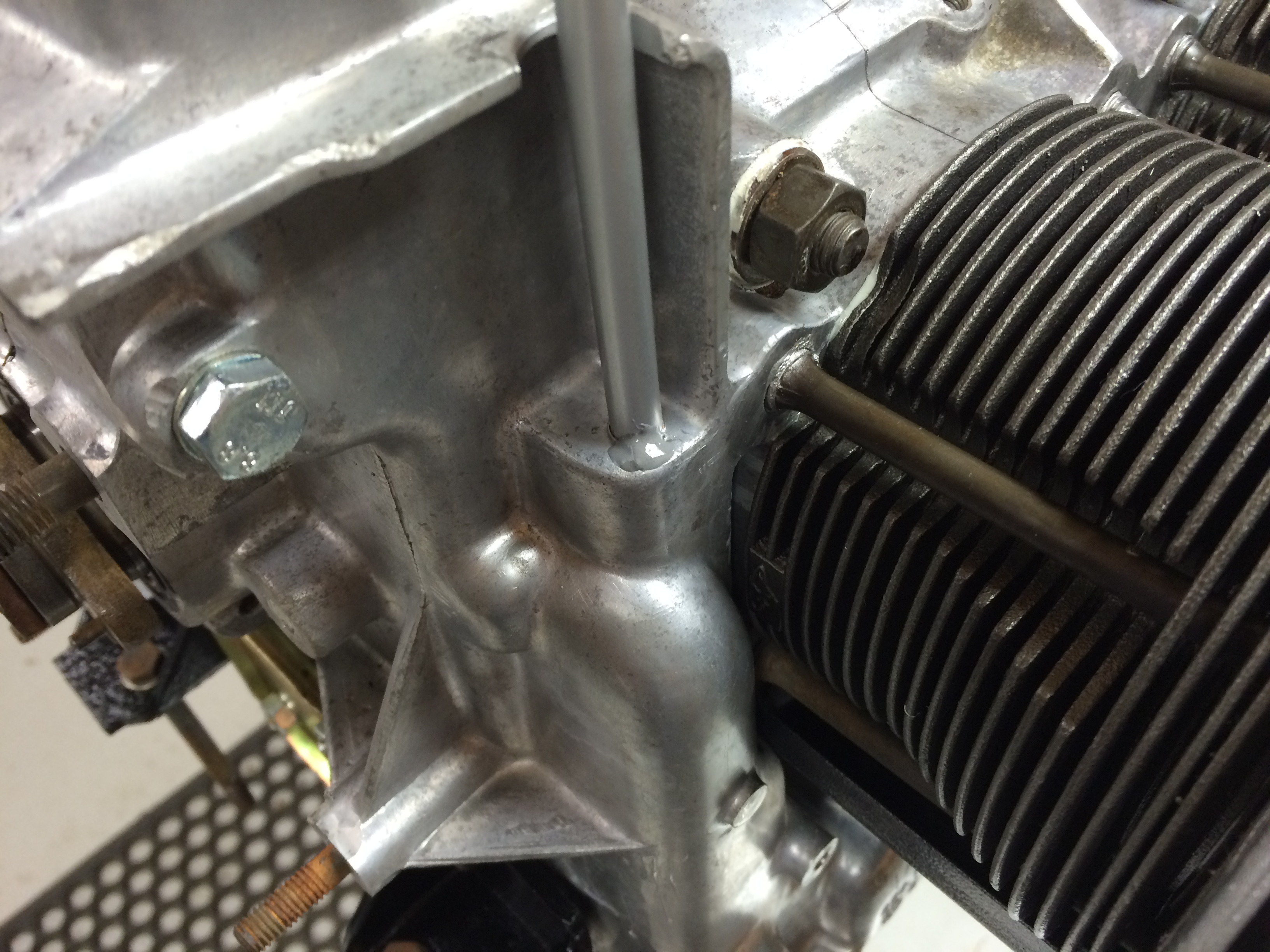

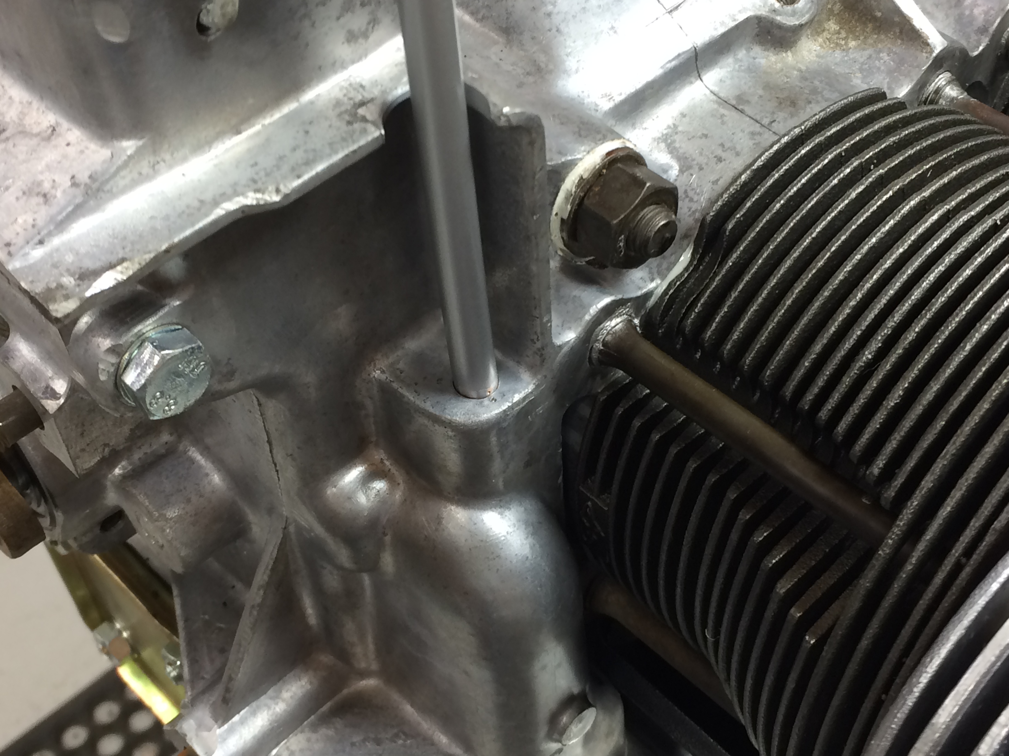

Lots of work completed today. Fan shroud assembled, all engine tins test fit. I am really happy with the powder coat on the tins. Using anti-seize on everything. I think I spent more then an hour on the oil dipstick tube, recall these cases are from a bus I used to own so the oil dipstick needed to be relocated.
Peened the case and the tube in the neighborhood of where they come together...
Slotted the tube and safety wired it to limit movement (I love safety wire).
Then (next post), used some JB weld to give it some glue.
sdoolin
post Aug 21 2016, 09:25 PM
Post #171
Posts: 424
Joined: 1-May 14
From: LouKY
Member No.: 17,299

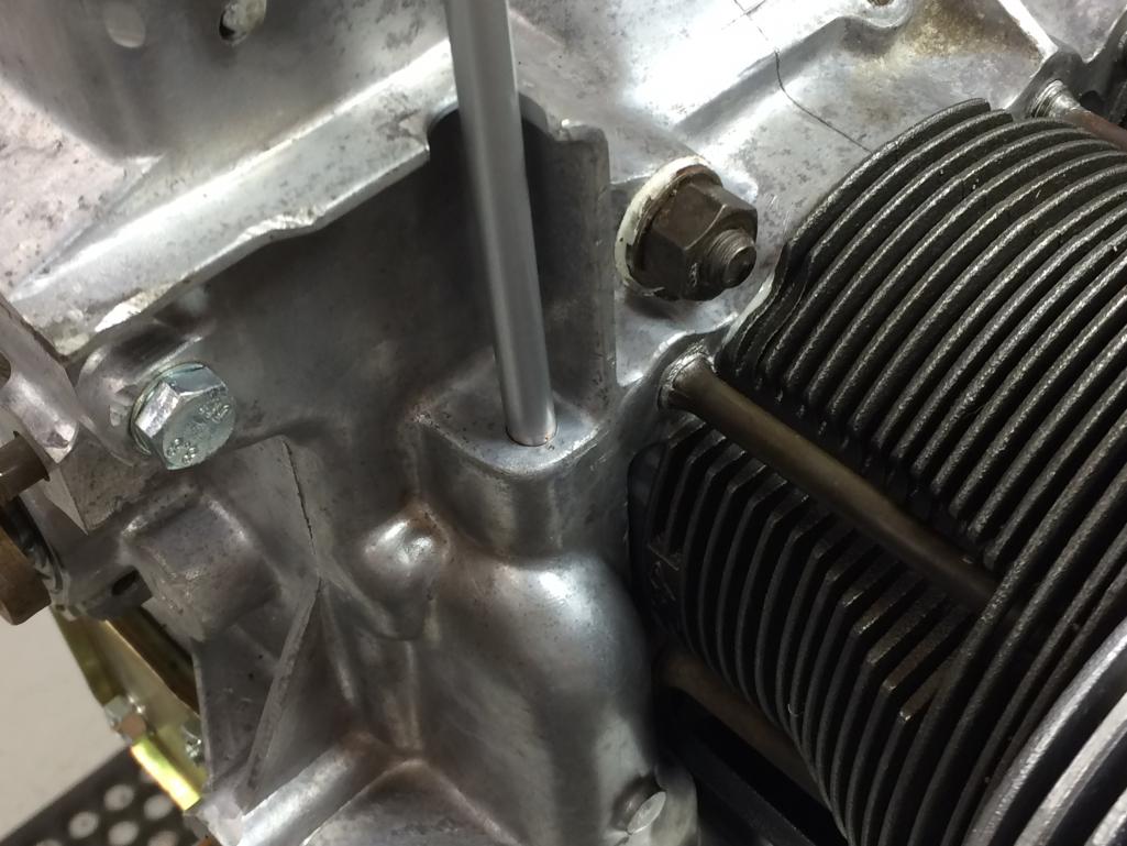

And here's the final solution. Kind of crude side of the shop but I have had these cases since my college days (a very long time ago) so keeping them going in this 914 is just cool. Plus, no one can see this crude solution unless they follow this thread. No concourse here..

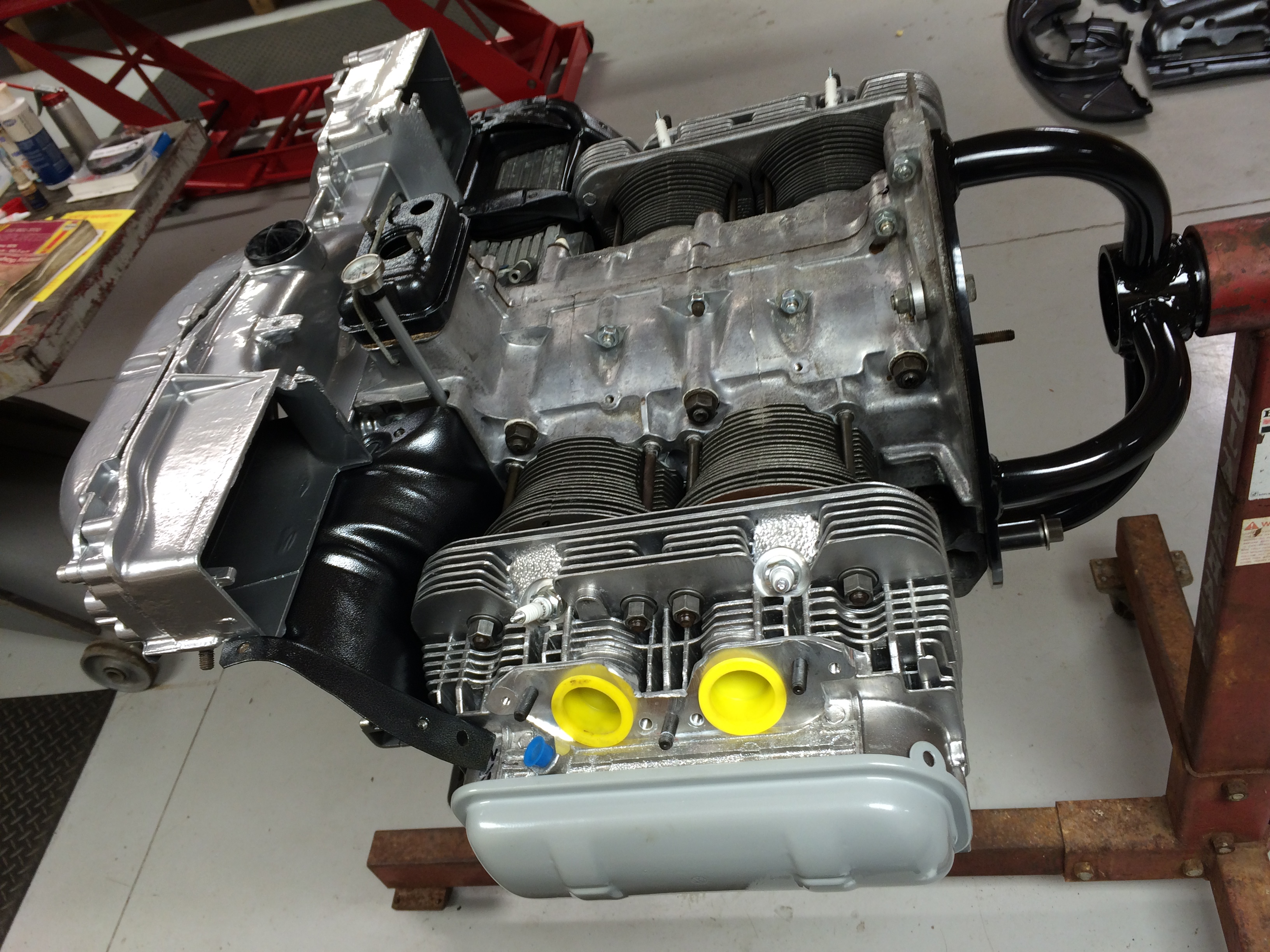

sdoolin
post Aug 21 2016, 09:30 PM
Post #172
Posts: 424
Joined: 1-May 14
From: LouKY
Member No.: 17,299

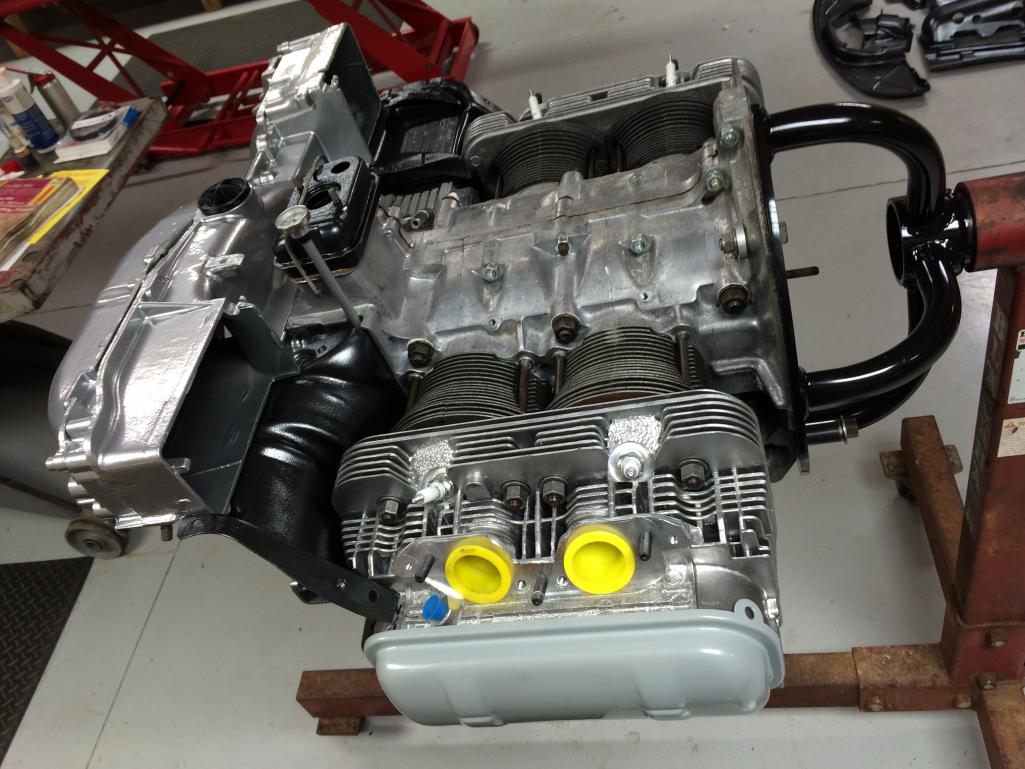

More pics because I am bored and this thing is coming together nicely...

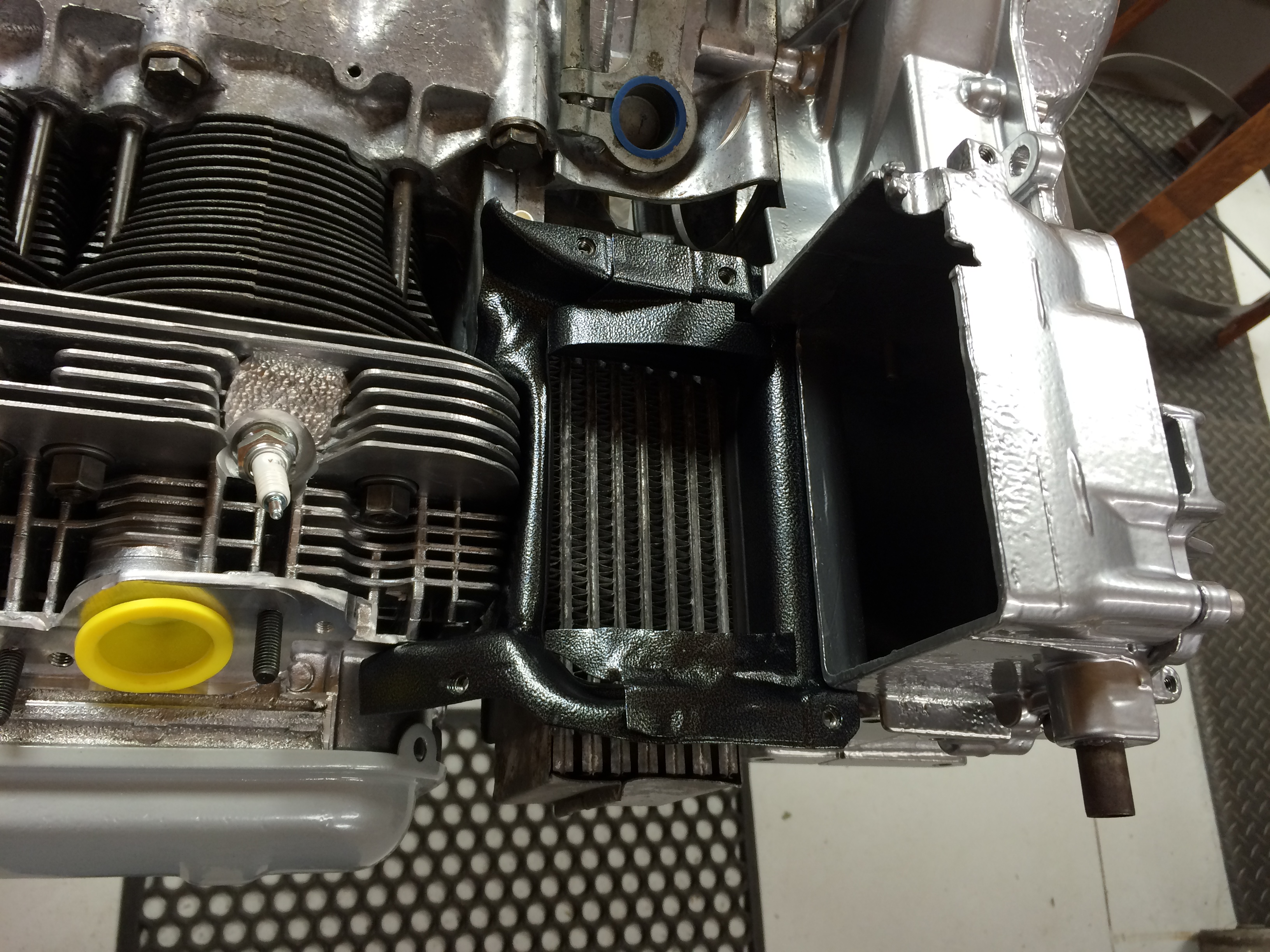

sdoolin
post Aug 22 2016, 11:49 AM
Post #175
Posts: 424
Joined: 1-May 14
From: LouKY
Member No.: 17,299

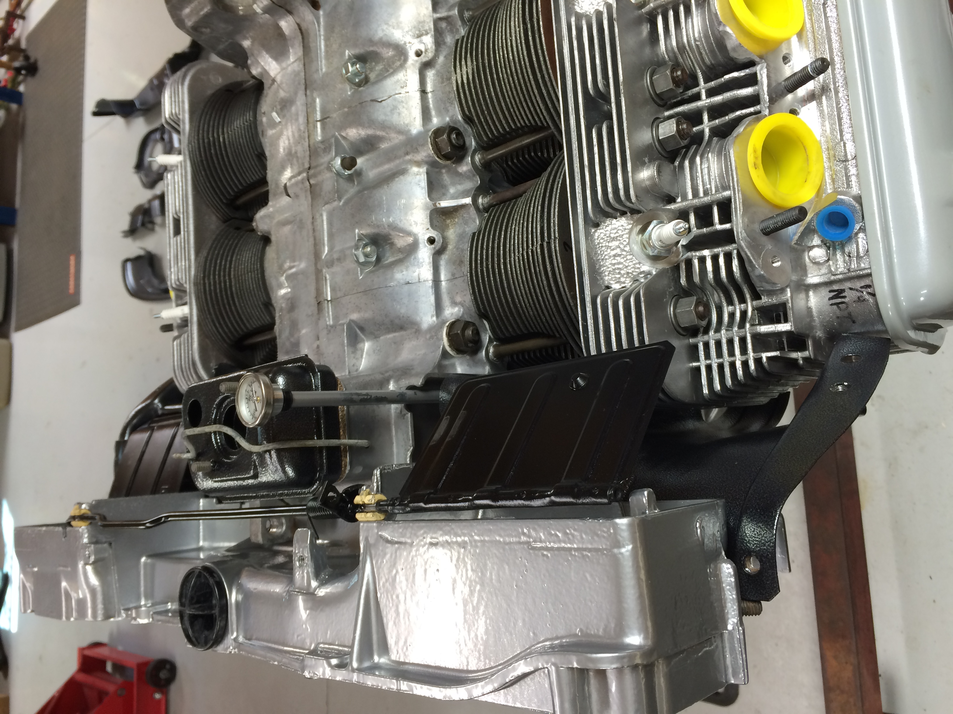

Cooling flaps going back in. It doesn't seem to me like the flap on the left (cyls 1 & 2) opens far enough? At full open (travel limited by other flap bottoming on oil cooler vent/tin), it still seems kinda closed to me...
Pic below is full open (thanks 914world for rotating my pics)...

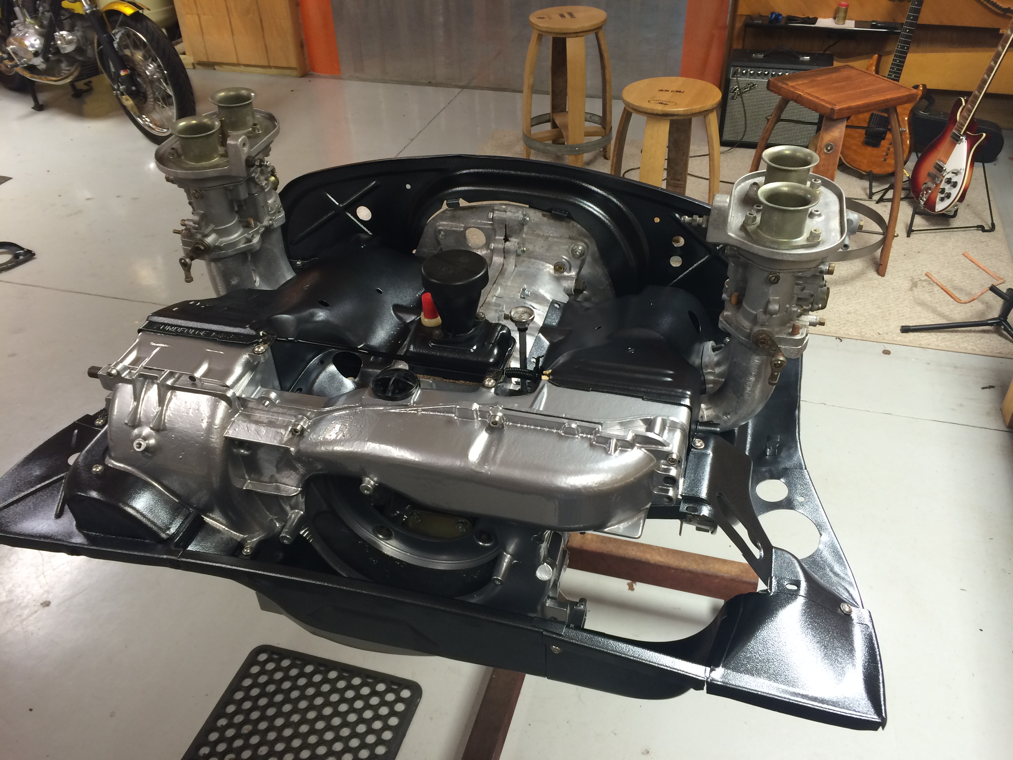

sdoolin
post Aug 26 2016, 01:40 PM
Post #178
Posts: 424
Joined: 1-May 14
From: LouKY
Member No.: 17,299
Engine tins all installed -just as a mock-up. It'll all come back off for some tweaking on the fitment. Fan along with alternator brackets and alternator back cover plate come back from powder coat today but may not get installed until I get back from - wait for it - the Formula 1 GP at Monza next week.
Muffler is out for ceramic coating, I still need a dizzy (someone pls sell me one), and I still need to rebuild the carbs. Then, maybe it will run.

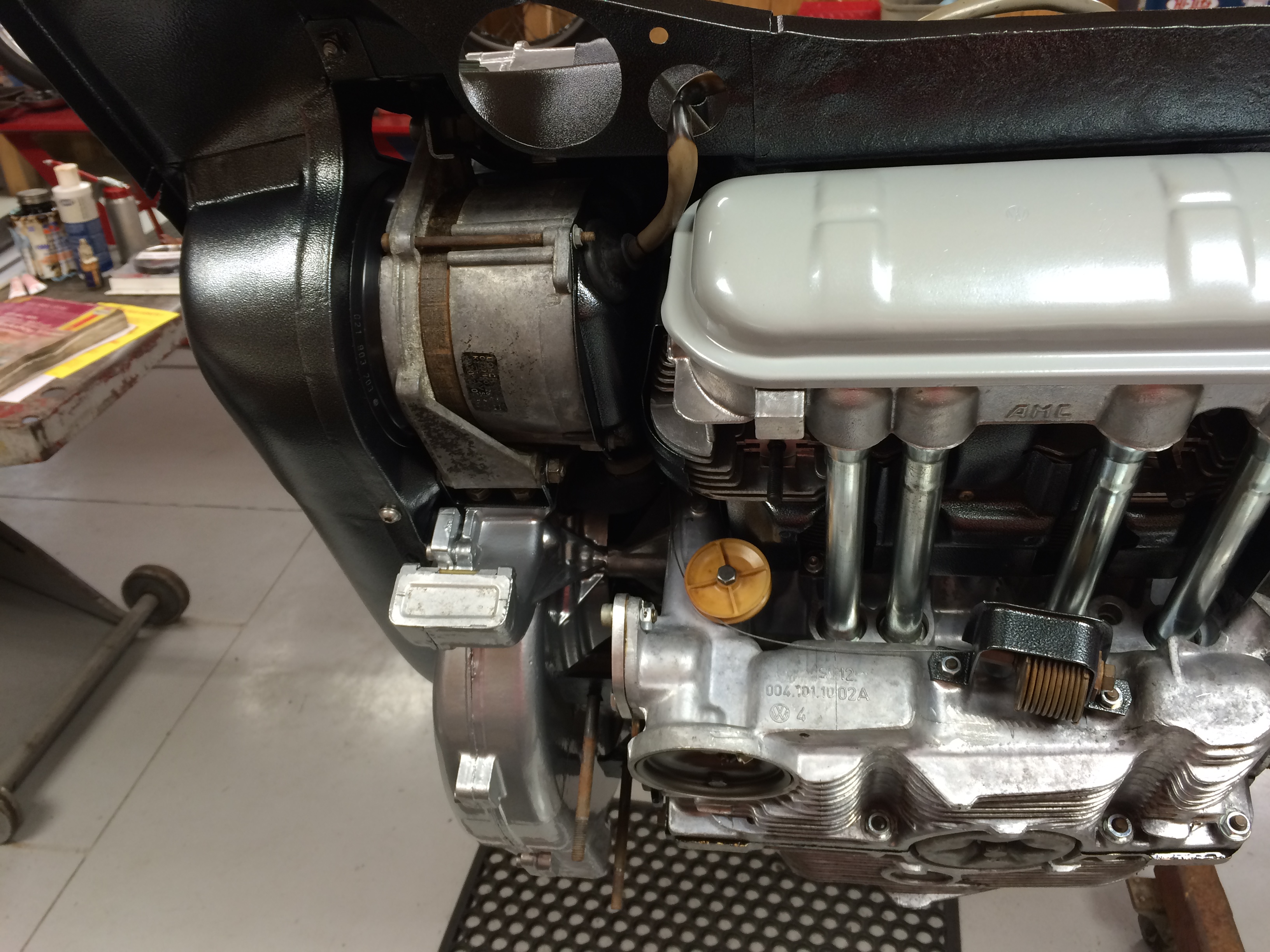

Alternator installed, more tin work fitment, removal, tweaking, re-fitment. Thermostat bracket and alternator cover plate powder coated. Thermostat not hooked up (yet).
Driver side detail pic...
Does anyone make stainless valve cover bales for these engines? Seriously I'd buy 2 pair.

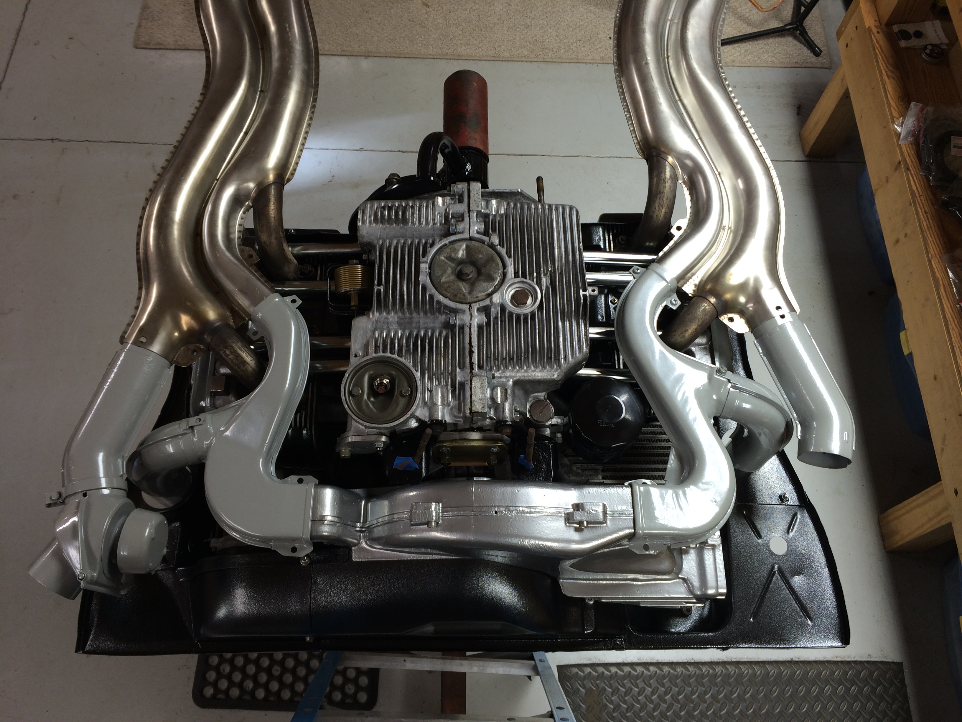

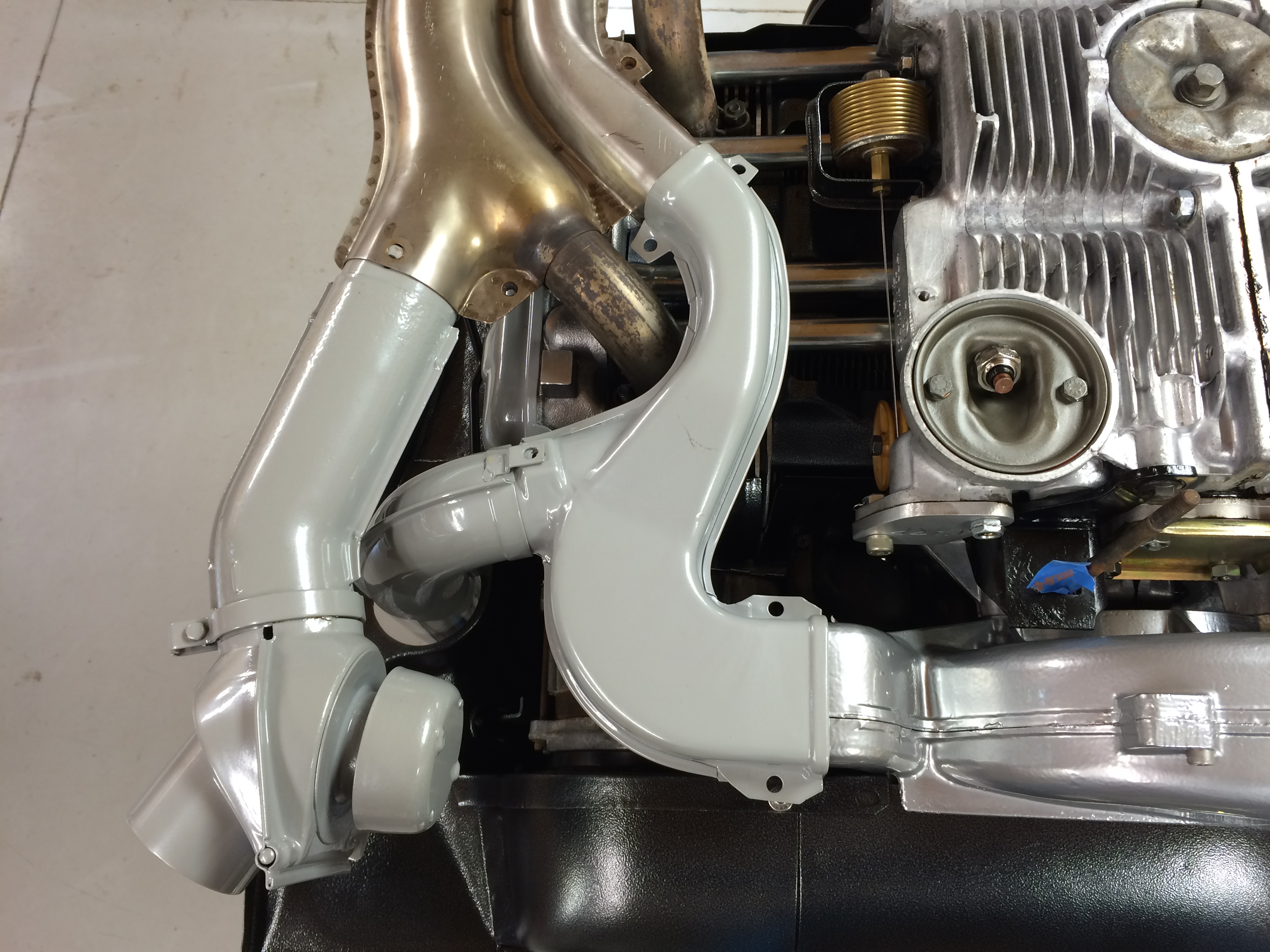

post Sep 18 2016, 08:30 AM
Post #180
Posts: 424
Joined: 1-May 14
From: LouKY
Member No.: 17,299
Finally back from my Italian vacation. Took in the F1 race at Monza and decided that F1 drivers are sissies and Porsche Super Cup drivers are real men. I wish they televised the Super Cup races on this side of the pond.
Anyway, more work on engine tin fitment. I have installed and un-installed the tins maybe a dozen times. Tweaking it each time for details that I have always hated. Removed some metal on the tins around the Thermo cable so no rubbing. Removed some metal around intake manifolds to ease gasket & manifold placement.
Also work on mocking up the heat exchangers and various heating system bits. The OE rust on the heater tubes was replaced with powder coat in the color "Porsche Silver". What appears what/grey in the pics actually has a leeeetle metal flake in it, and my powder coat guy clear coated them. Will have to sand away some of the PC for perfect fitment, but I am OK with that. Going with all stainless hardware on this side of the engine as well.
New thermostat & cable from Awesome Powder Coating.
Does anyone know what gasket material was used as OE on the surfaces where the fan housing meets the heat exchanger tube(s)? The two more or less "S" shaped tubes that take forced air from the fan and directs it down the HE? Appeared to me that there was some 40+ year old cork there when I took things apart. Would like to replace it.
