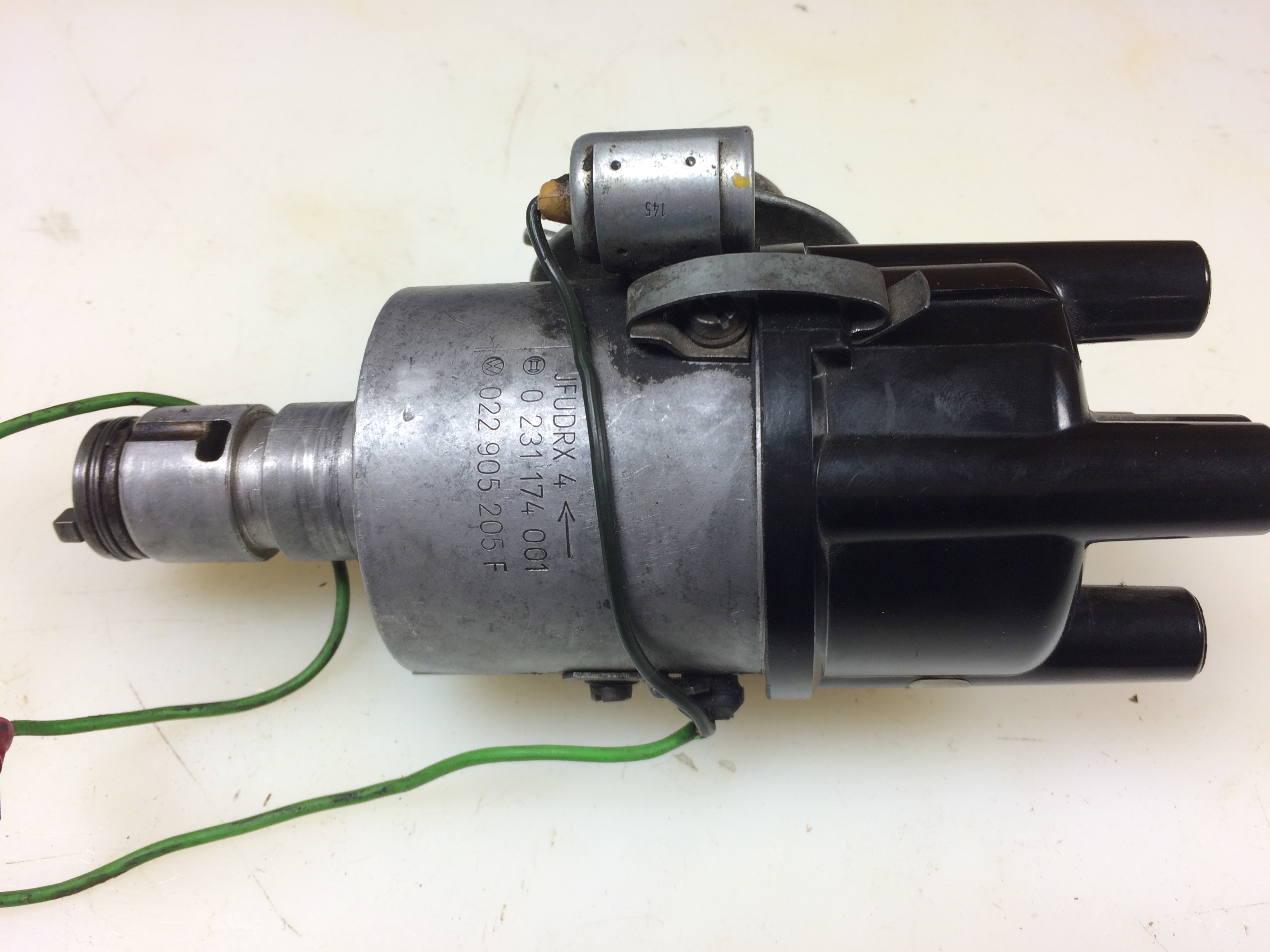

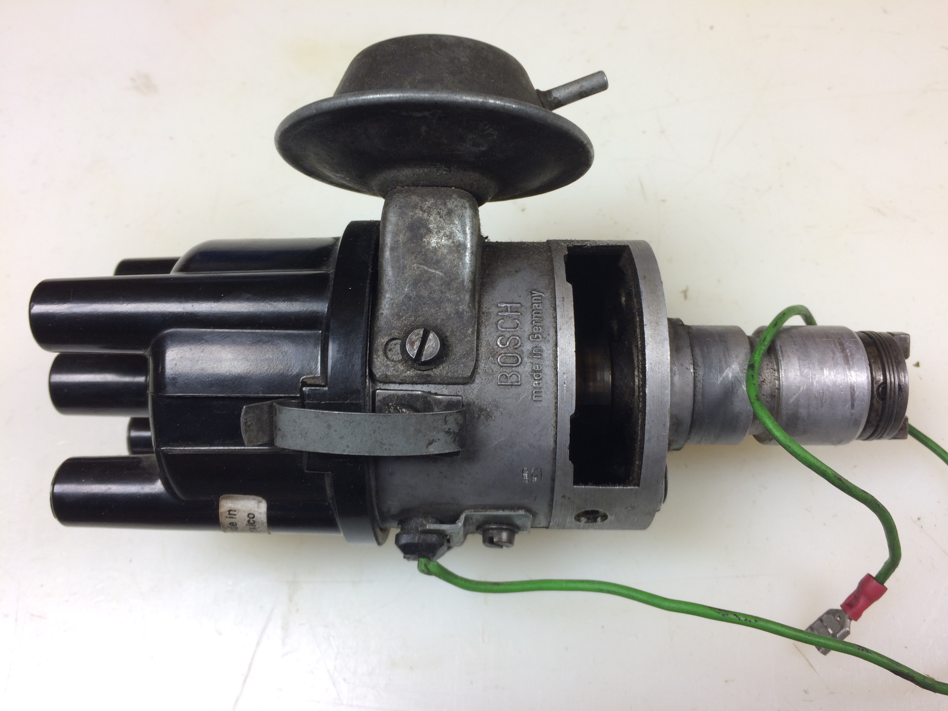

I found this on a shelf with 4 - 5 derelict Solex carbs for beetles (or something). I suspect it is either off this exact engine (1976 bus cases used in this thread), or my other bus engine (1979). When I first built the '79 (in 1986), I removed whatever dizzy was on it 'cause I was convinced that the 009 was the way to go. I spent years and years driving around a flat spot in that bus.
This likely needs some love, and I can send it out for service but wondering if it is more desirable (for driveability) than re-using the OE FI dizzy?
So my options now are:
1) re-use OE FI Dizzy
2) service this one (in the pics) and use it
3) run the 009 (not really an option).
As always all assistance appreciated...

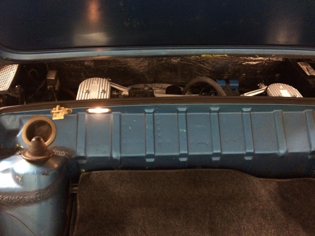

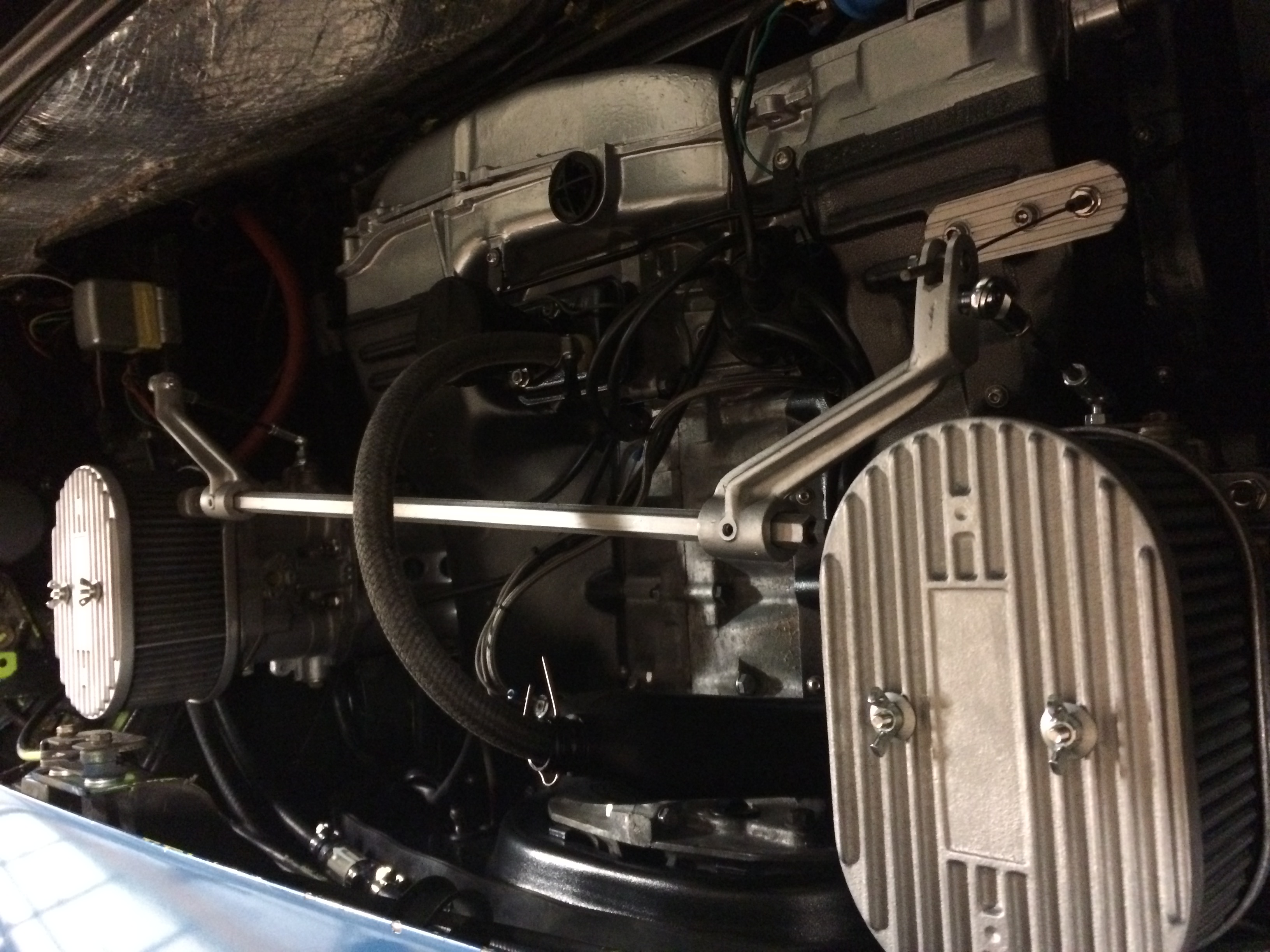

Pic of the engine installed from the top side. Pay no attention to the Brad Penn oil bottle crankcase breather apparatus. It is temporary (and it works). I will fabricate a proper crankcase breather box in the coming weeks.
Custom throttle cable bracket and linkage arm work great. Carbs are nicely synched and she idles very smooth from side to side and takes throttle smoothly also. Engine and transaxle have solid mounts from PO, I may change that. Even with solid mounts vibration not too bad with carbs synched well.
For now, she runs. Pretty well. Pulls stronger almost each time I drive her and if it weren't for the freak'n 009 dizzy I'd call this done! Heat works well and I will drive her all winter - in between salting and brining.
Oh, and my trunk light works. Never knew until tonight...

If the vacuum canister is working on the FI dizzy then you might as well just give it a light cleaning and see how it works before you spend time refurbishing it.
I thought for sure you'd get more input on this. The board must be in hibernation for the holidays.

Yes RoadGlue, I had thought that asking about which dizzy to use might attract us much attention as my "1mm step in the cylinder heads" bit from months ago. My plan is to re-use the FI dizzy with a light cleaning. I know it was functioning well on that engine.
My real desire is to understand if the dizzy pictured a few posts ago with the last digits of "205" stamped on it is a contender, if it might be better suited than the FI dizzy (2 vacuum posts), and if yes (it is a contender and better suited), I'll have it fully serviced - which is kinda pricey.
I will fit the FI dizzy soon and do some driving...
