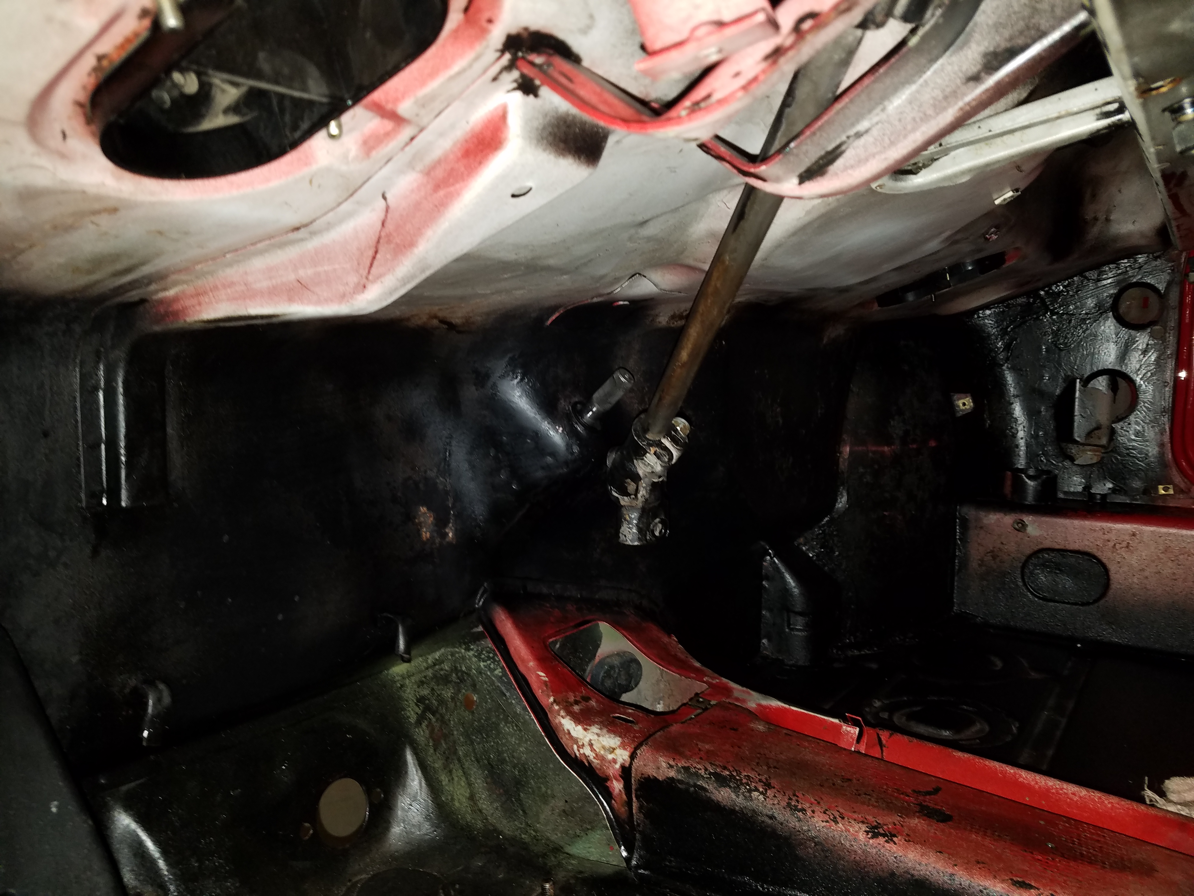

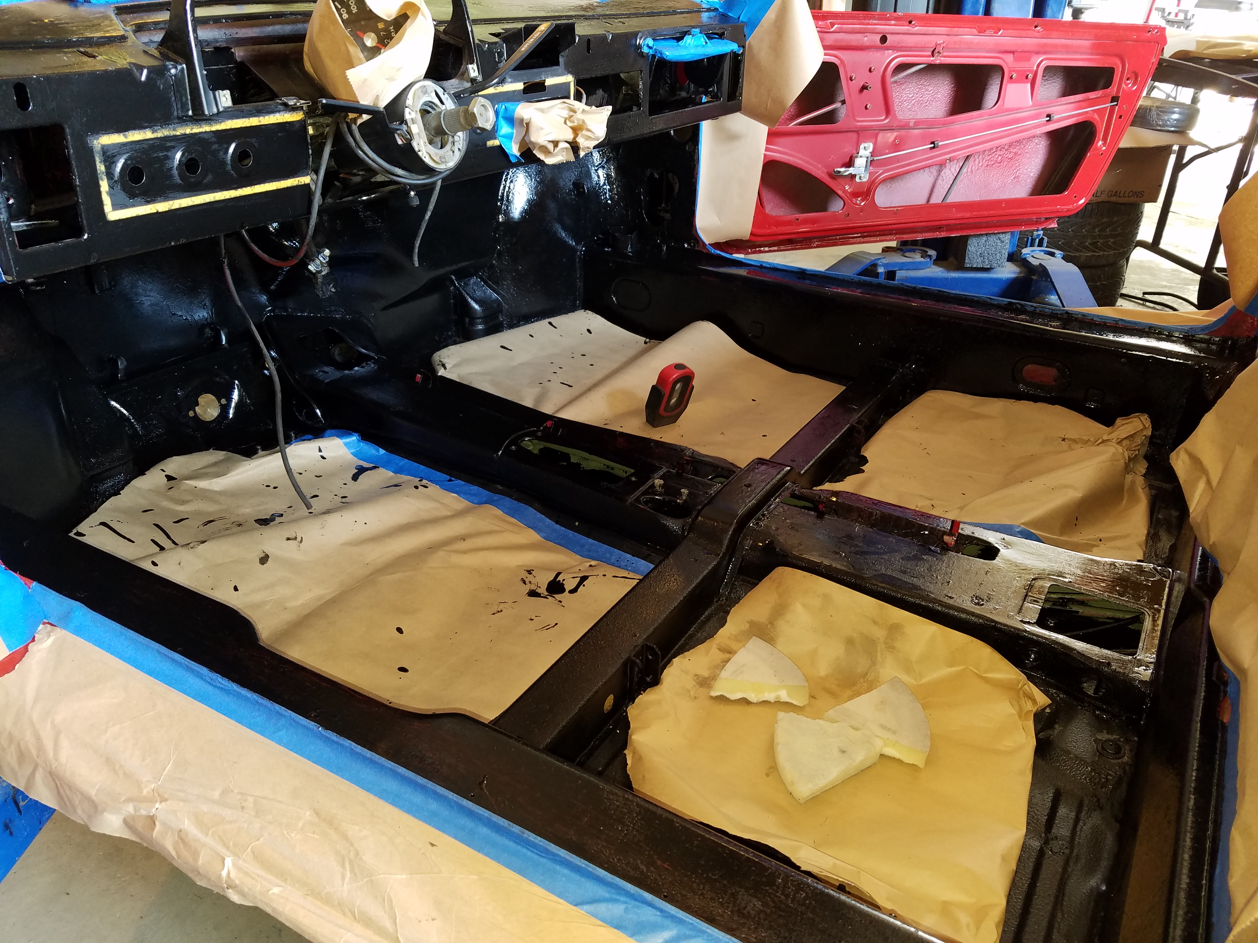

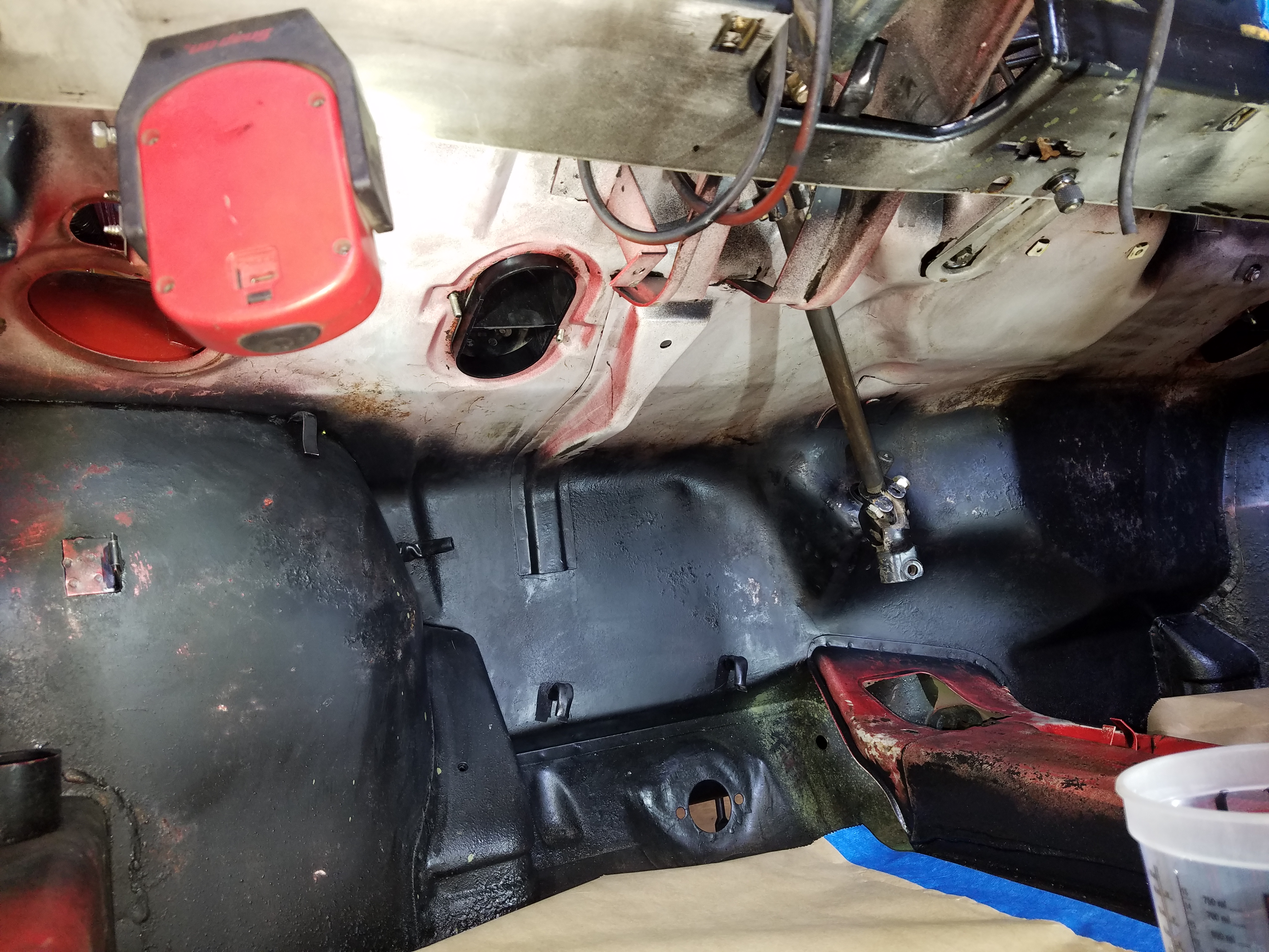

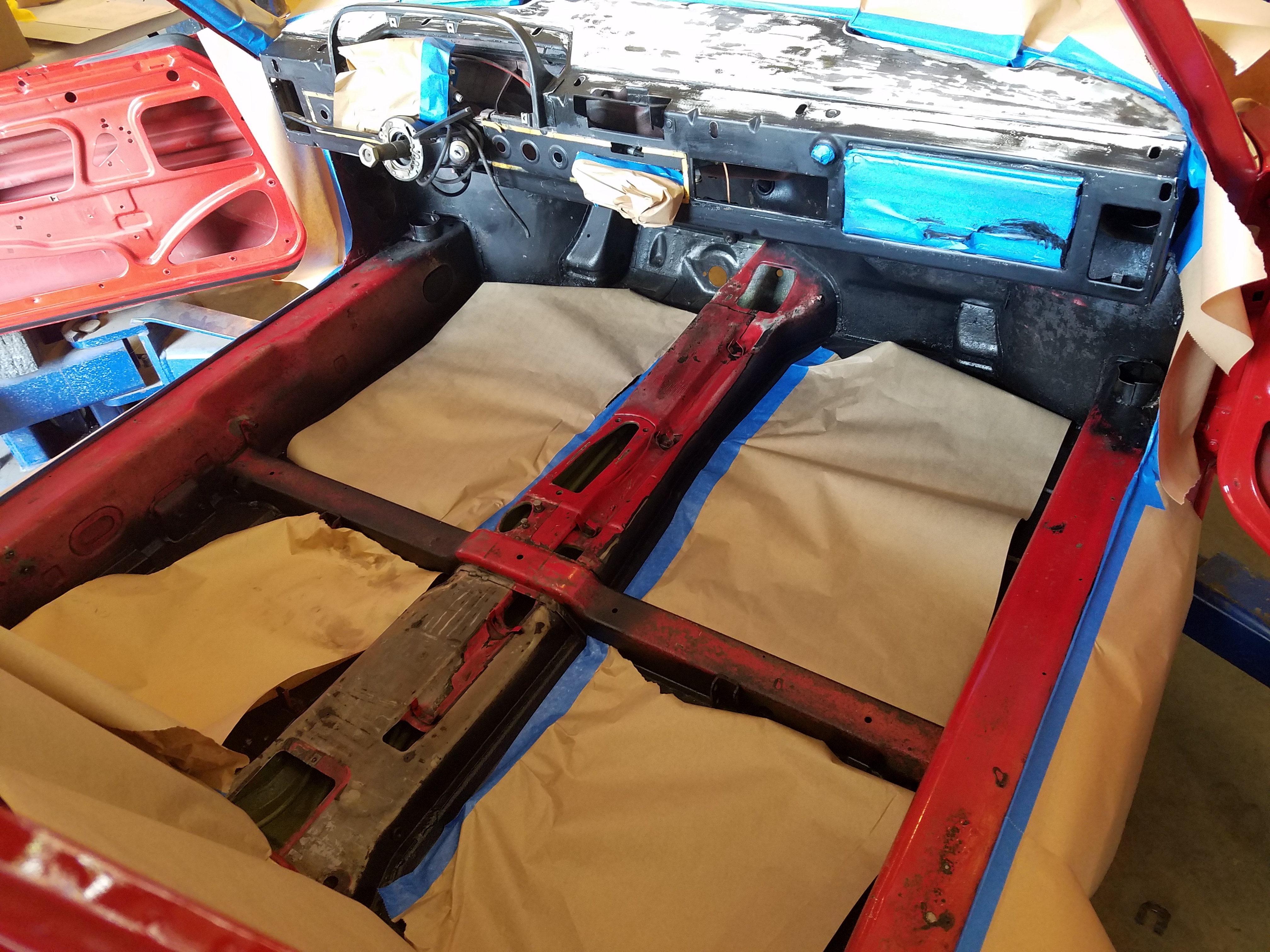

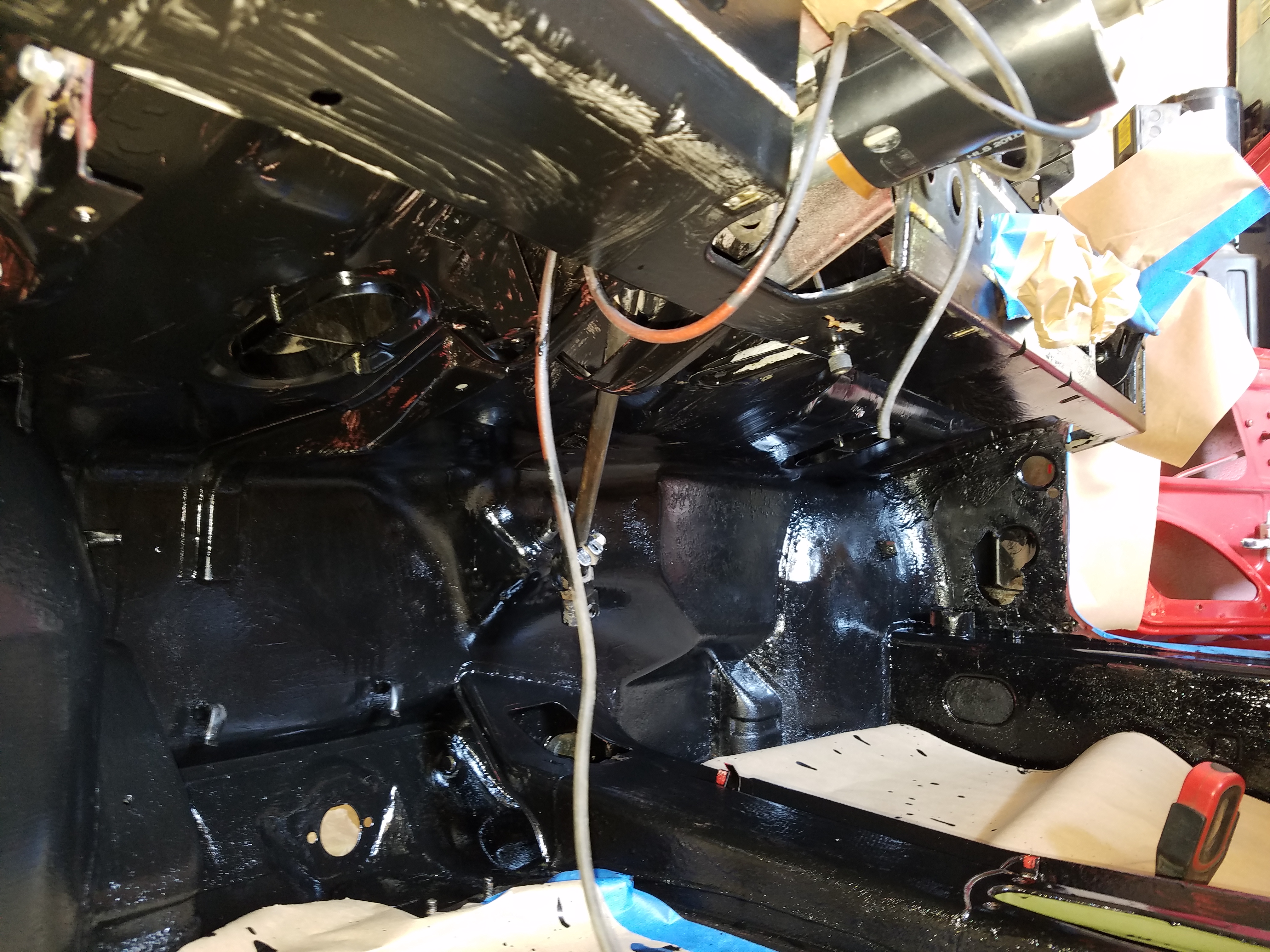

I had treated (painted) under the dash, the longs and the top of the tunnel with "rust treatment" After a week of it still not drying I went back to read the can to find out what was up. I had painted it with Eastwood frame sealer. It's finish is a tacky / oily finish to keep moisture out Under the car (IMG:style_emoticons/default/headbang.gif)

Today I worked on my yoga stretching reaching all the hard to reach places with a rear and mineral spirits, wiping off my mistake
Matty900
post Aug 11 2017, 11:15 PM
Post #264
Posts: 1,305
Joined: 21-February 15
From: Oregon
Member No.: 18,454
Got it all cleaned up. Tomorrow I will treat it with Por15 and then paint over it.

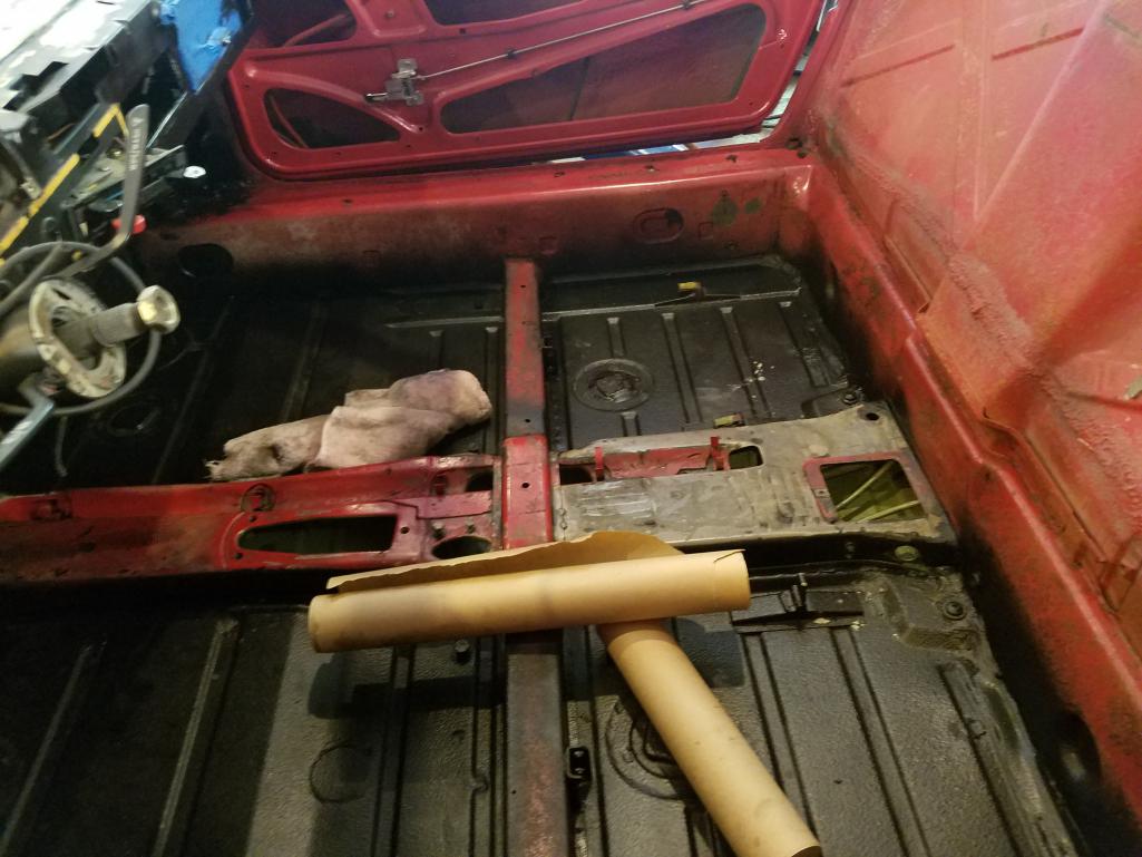

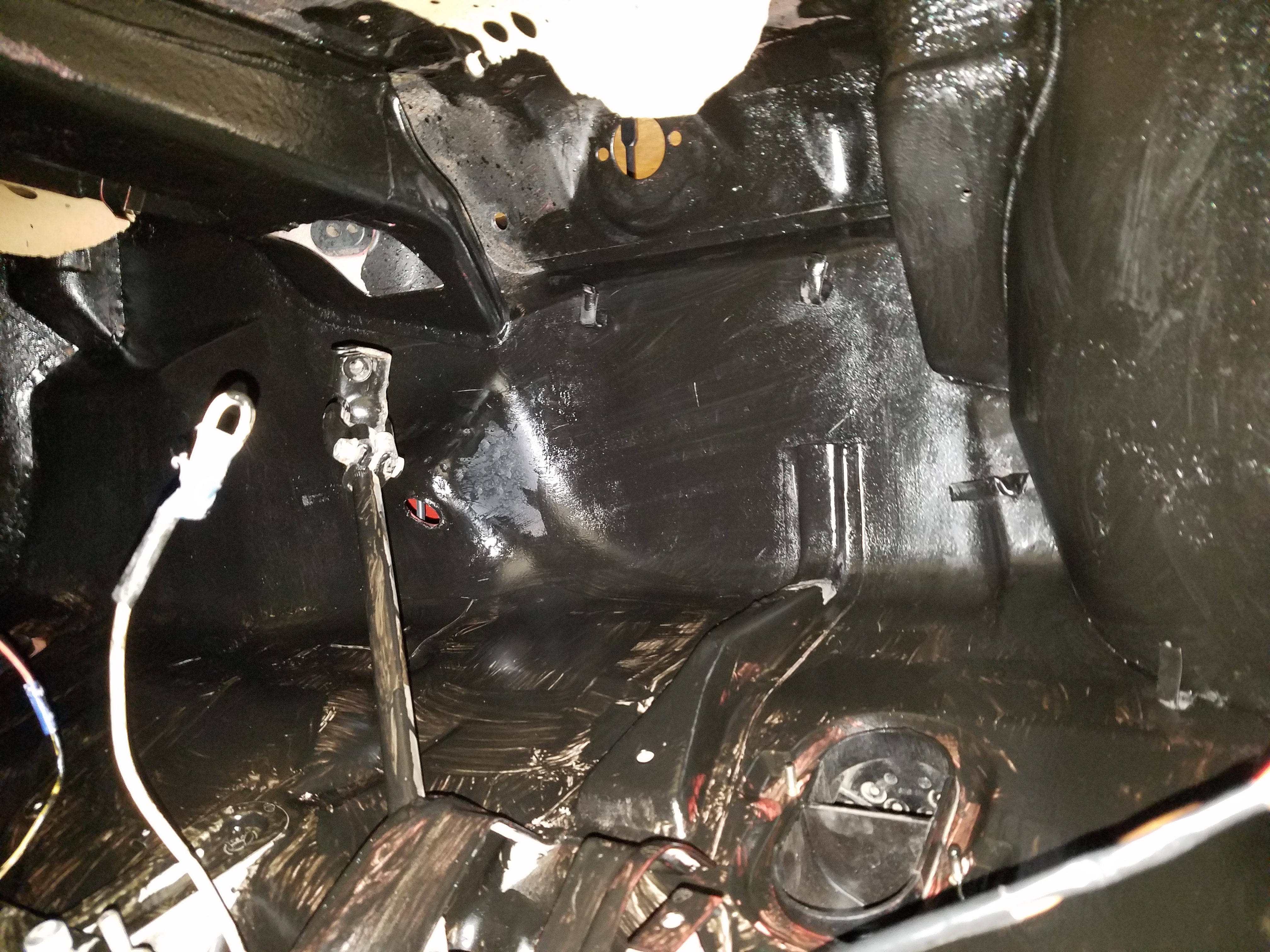

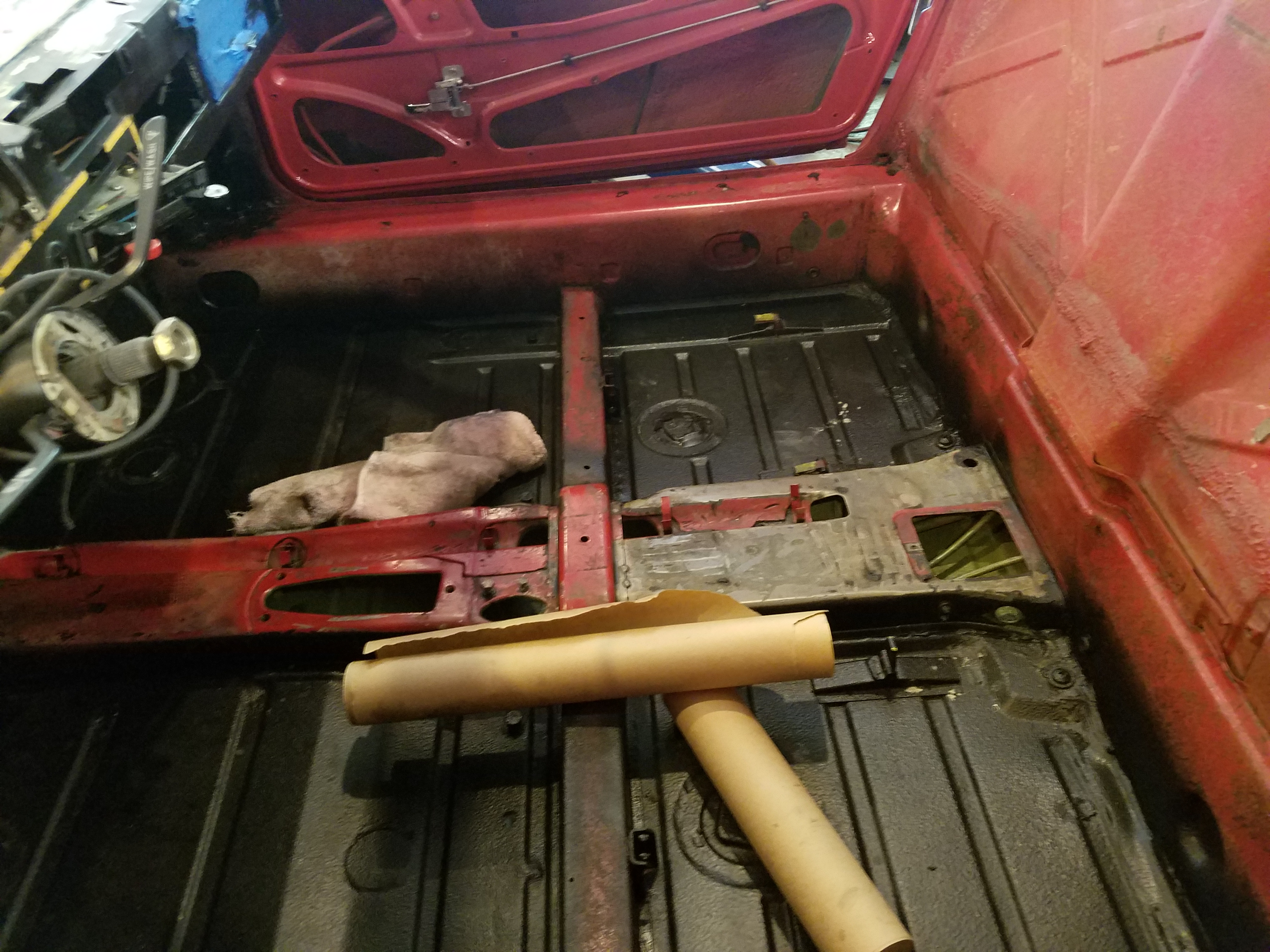

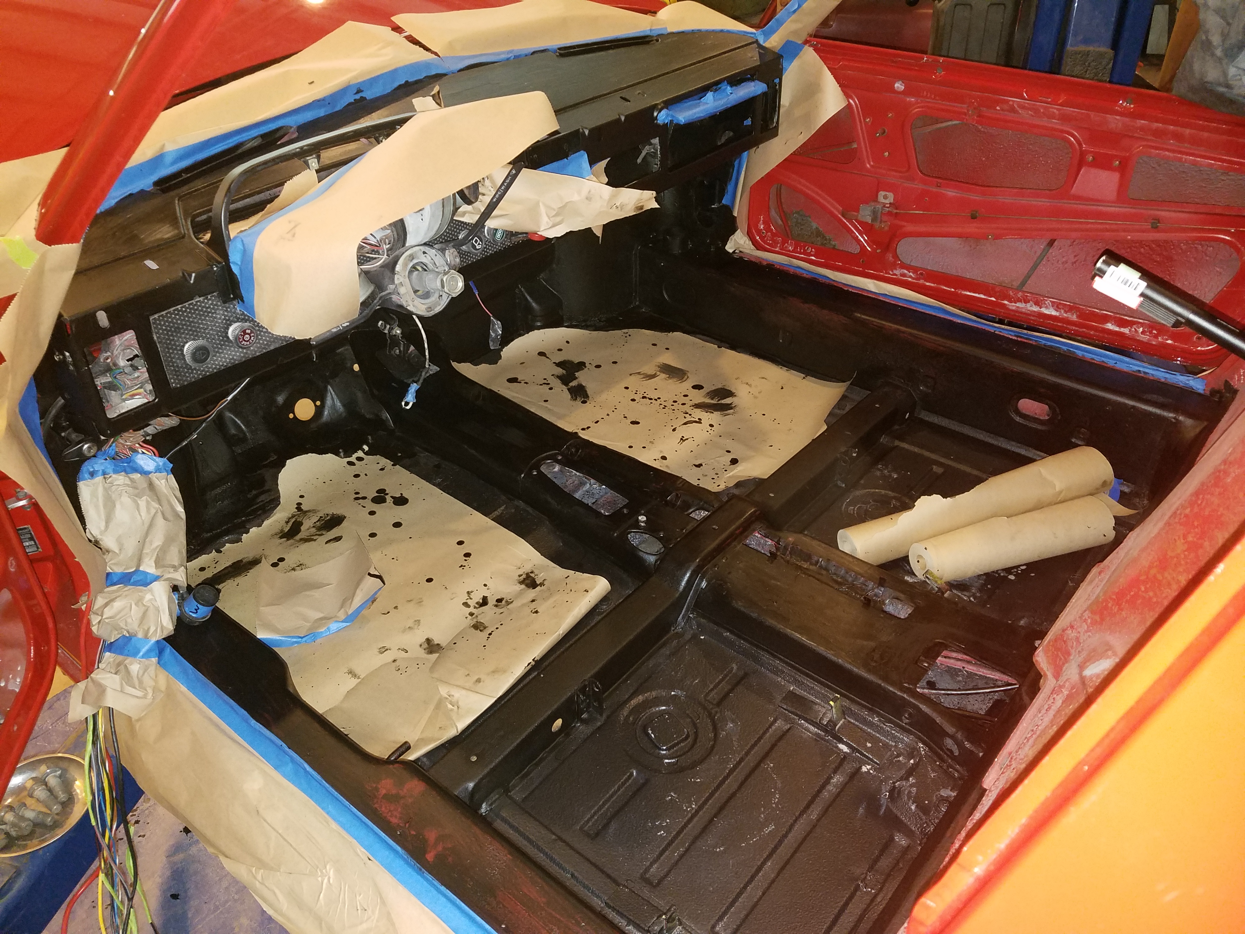

Preparing to treat with Por15 top coat
Matty900
post Aug 12 2017, 10:08 PM
Post #268
Posts: 1,305
From: Oregon
Member No.: 18,454
Before

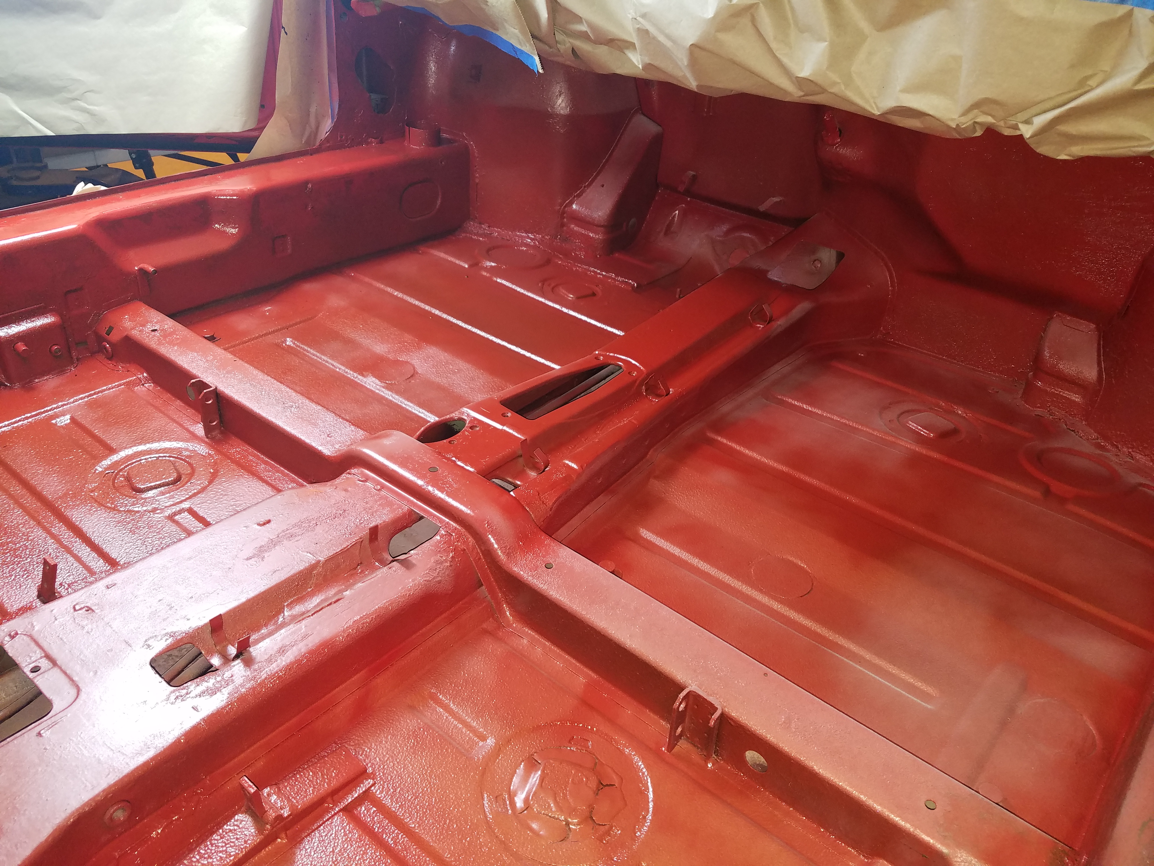

Matty900
post Aug 12 2017, 10:09 PM
Post #269
Posts: 1,305
From: Oregon
Member No.: 18,454
After
Matty900
post Aug 12 2017, 10:13 PM
Post #270
Posts: 1,305
From: Oregon
Member No.: 18,454
Next question, do I paint this red now, or leave it be? I will be putting down a fatmat type material.

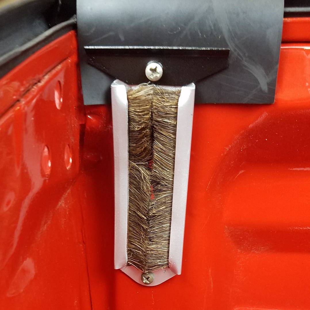

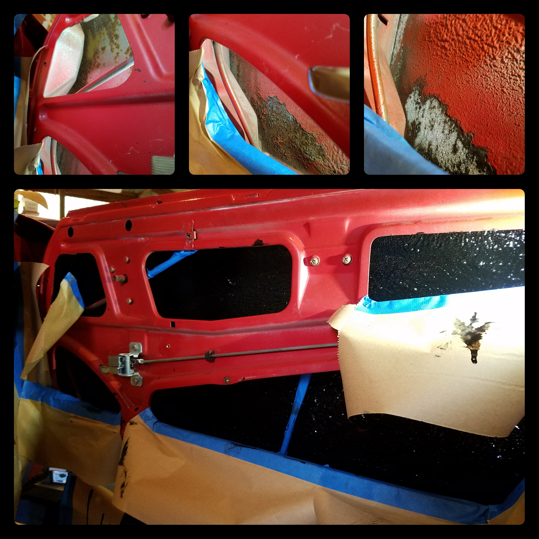

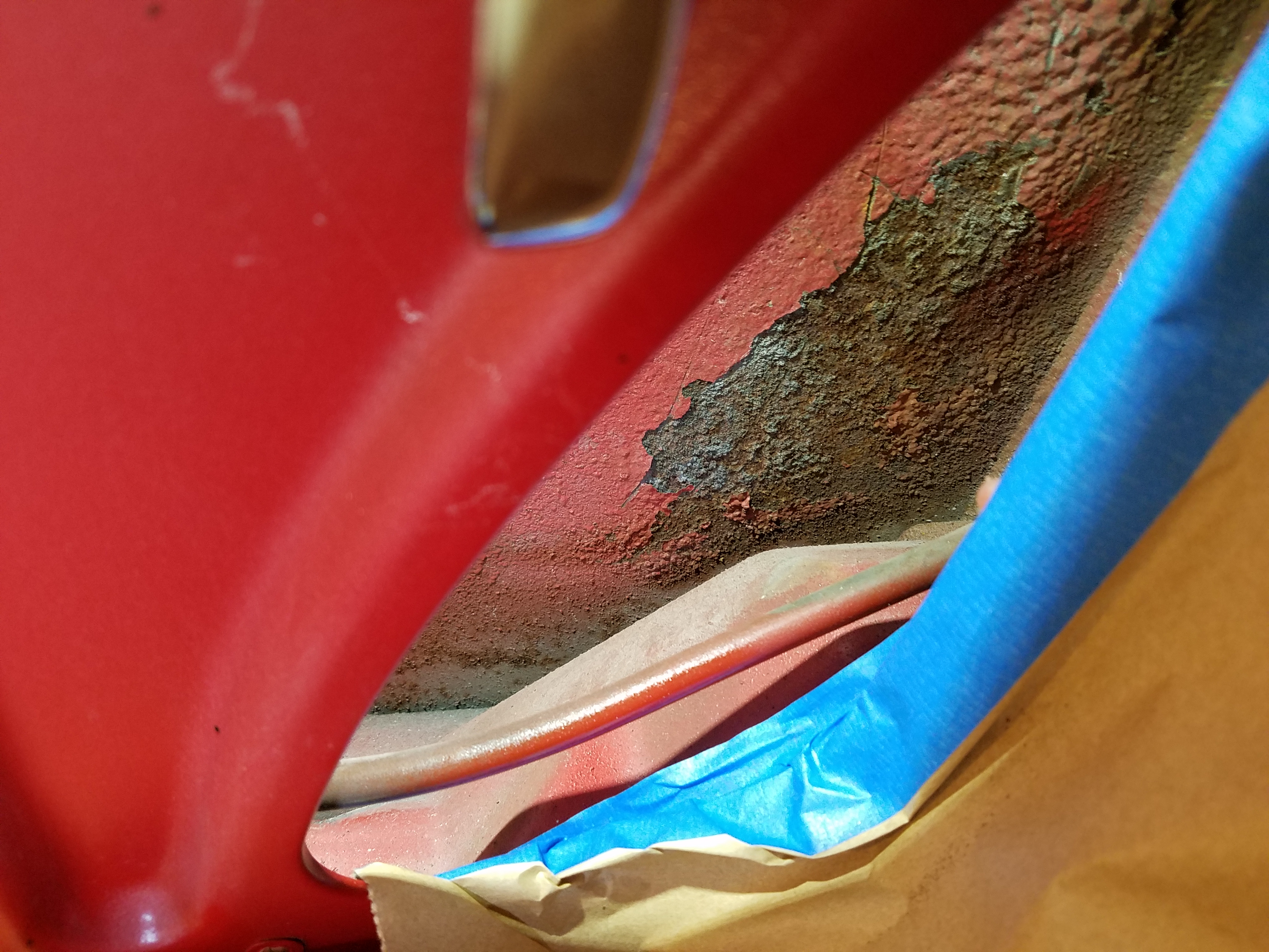

After I cleaned up the brush from painting the Por15, I noticed rust in the door. How dis I miss this before? (IMG:style_emoticons/default/WTF.gif)
Matty900
post Aug 12 2017, 10:33 PM
Post #272
Posts: 1,305
From: Oregon
Member No.: 18,454
Uses wire brushes and dremmel tool with a wand to get the rust off. Then vacuumed it out, wiped it all down with acitone. After it was dry, I acid treated the rust. After that was dry, I wiped it down again, I painted the entire inside of the door skin with Por15. I will be putting the fatmat type material in here as well.

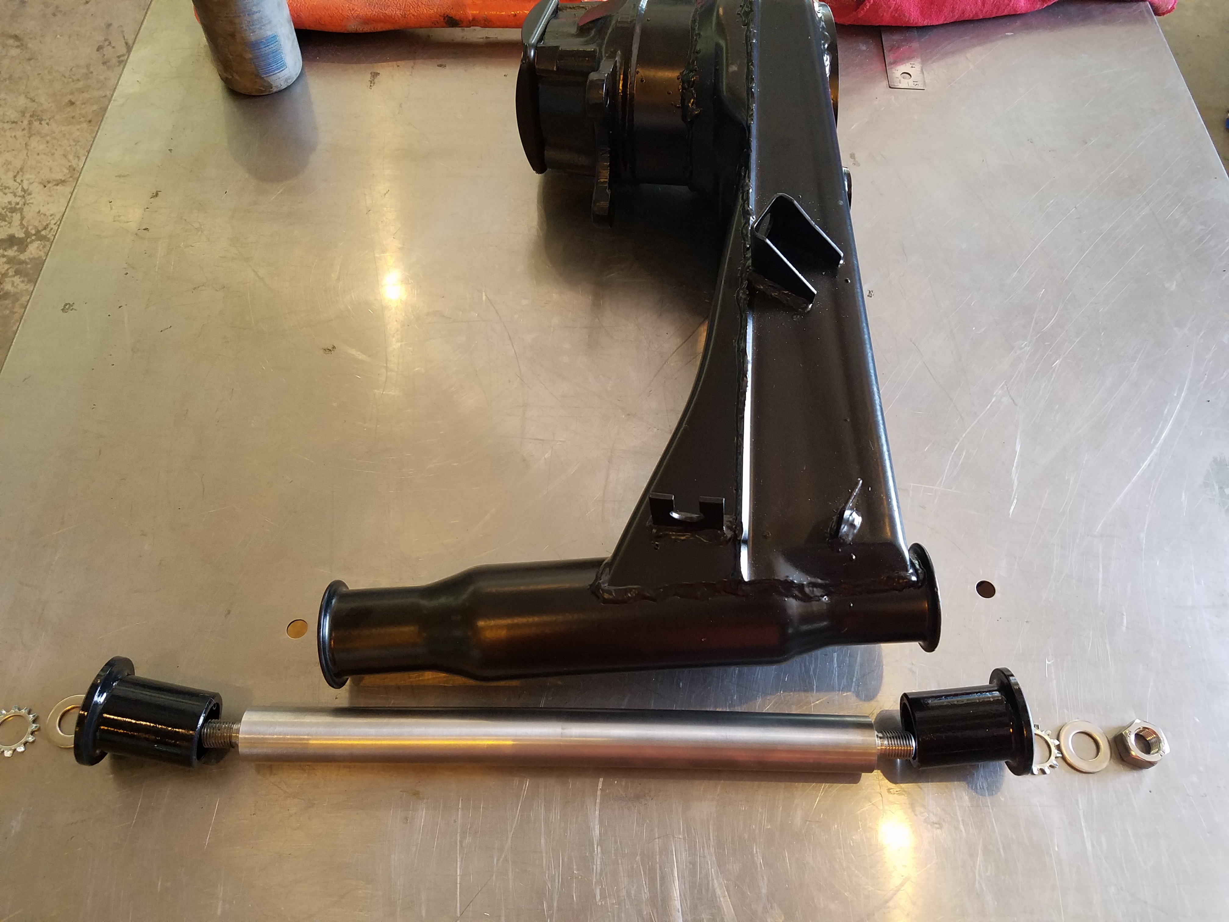

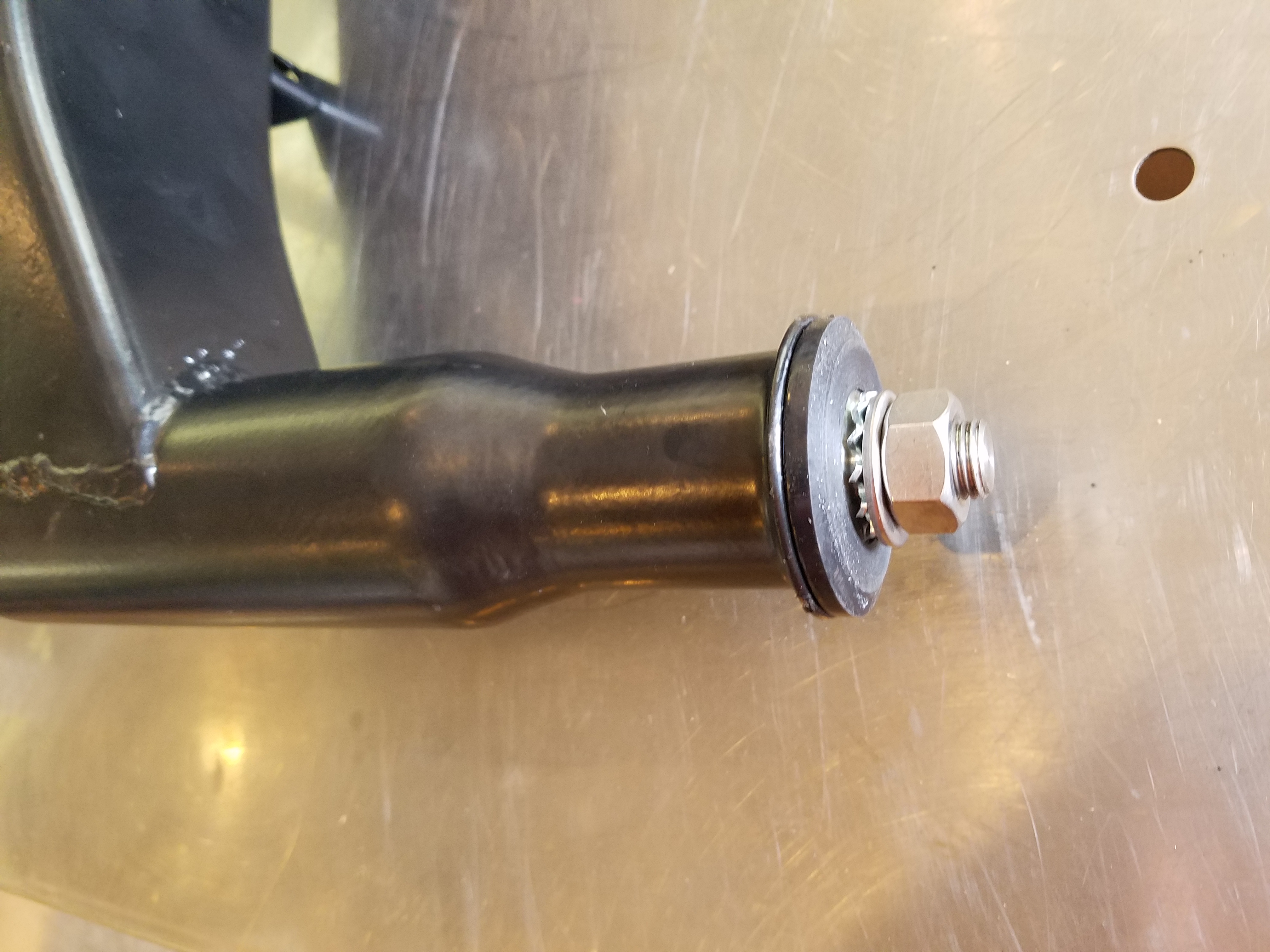

Spent some time sorting through the parts I have left to put on the car today. I did get the new stainless steel pivot shaft and new polygraphite bushings pressed into the trailing arm. (914Rubber parts preview)

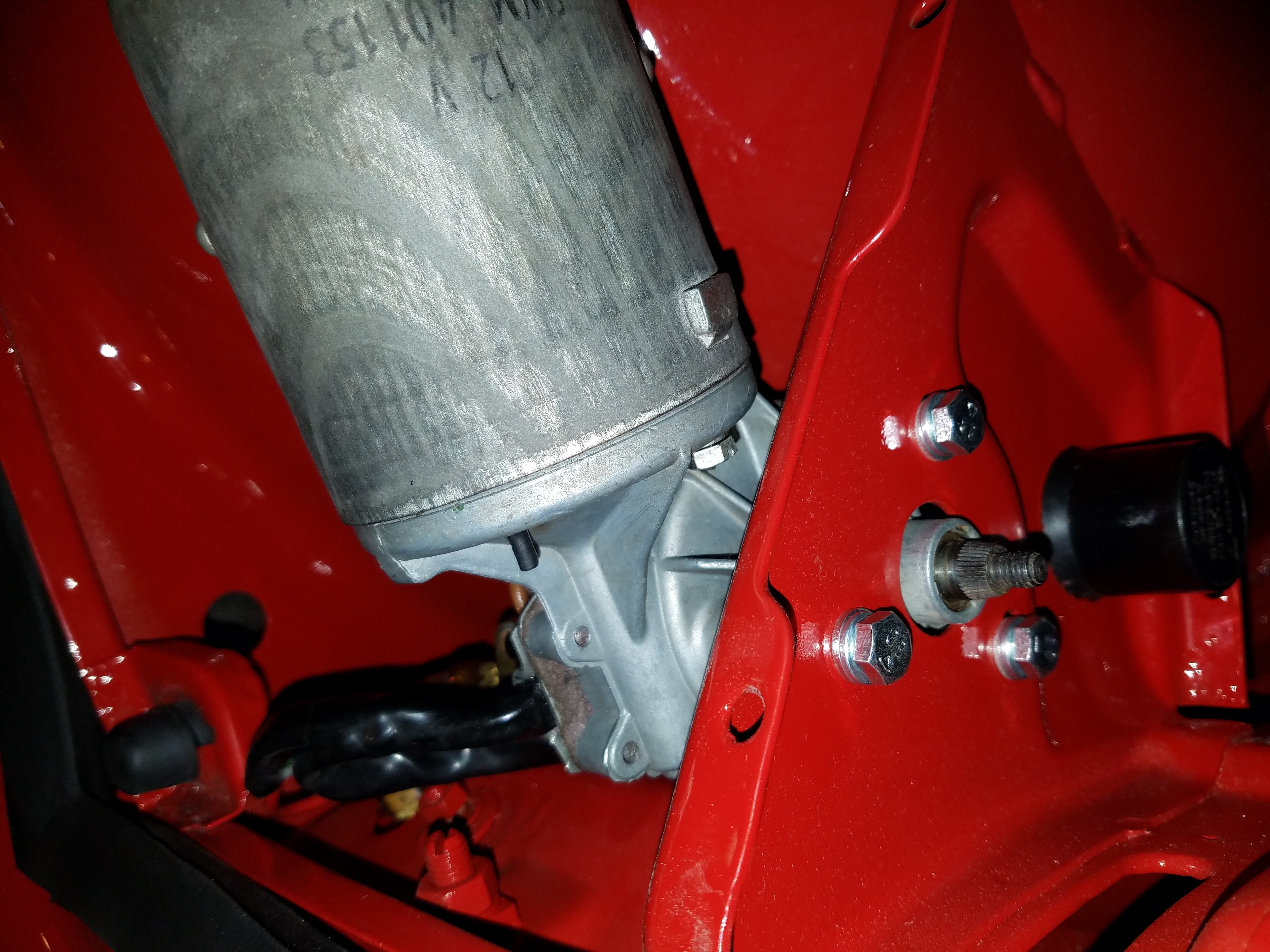

Got the headlight motors cleaned up and installed.

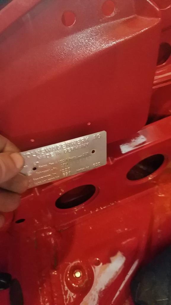

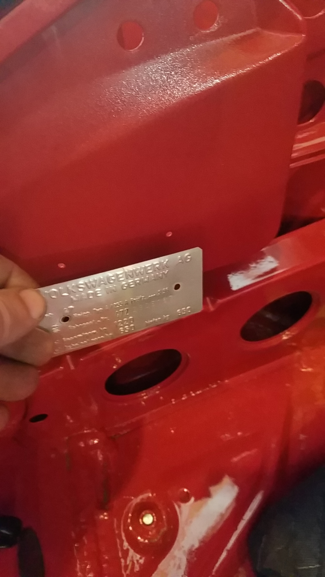

Body shop took off my vin plate. Anyone have any suggestions on where to get the correct rivits to put this back on?
