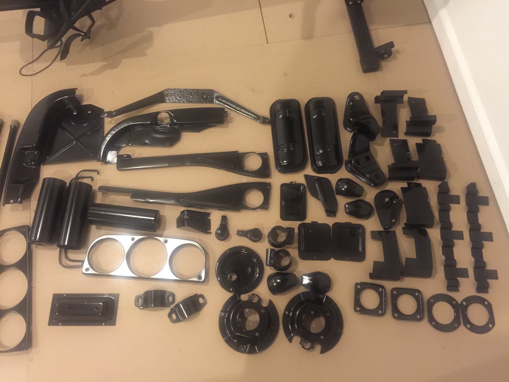

My suggestion is to find a local place in an industrial park that will work with you. Our local place isn't pretty and my order isn't typical (they mostly do patio furniture and aluminum awnings). $275 got all this done and my 914-6 tank. Everything looked like crap on the way in.

Amphicar770   Looks great and that is awesome pricing. I took ...   Feb 17 2016, 07:10 PM

Puebloswatcop   :trophy: Man your parts look awesome. I see sever...   Feb 17 2016, 08:04 PM

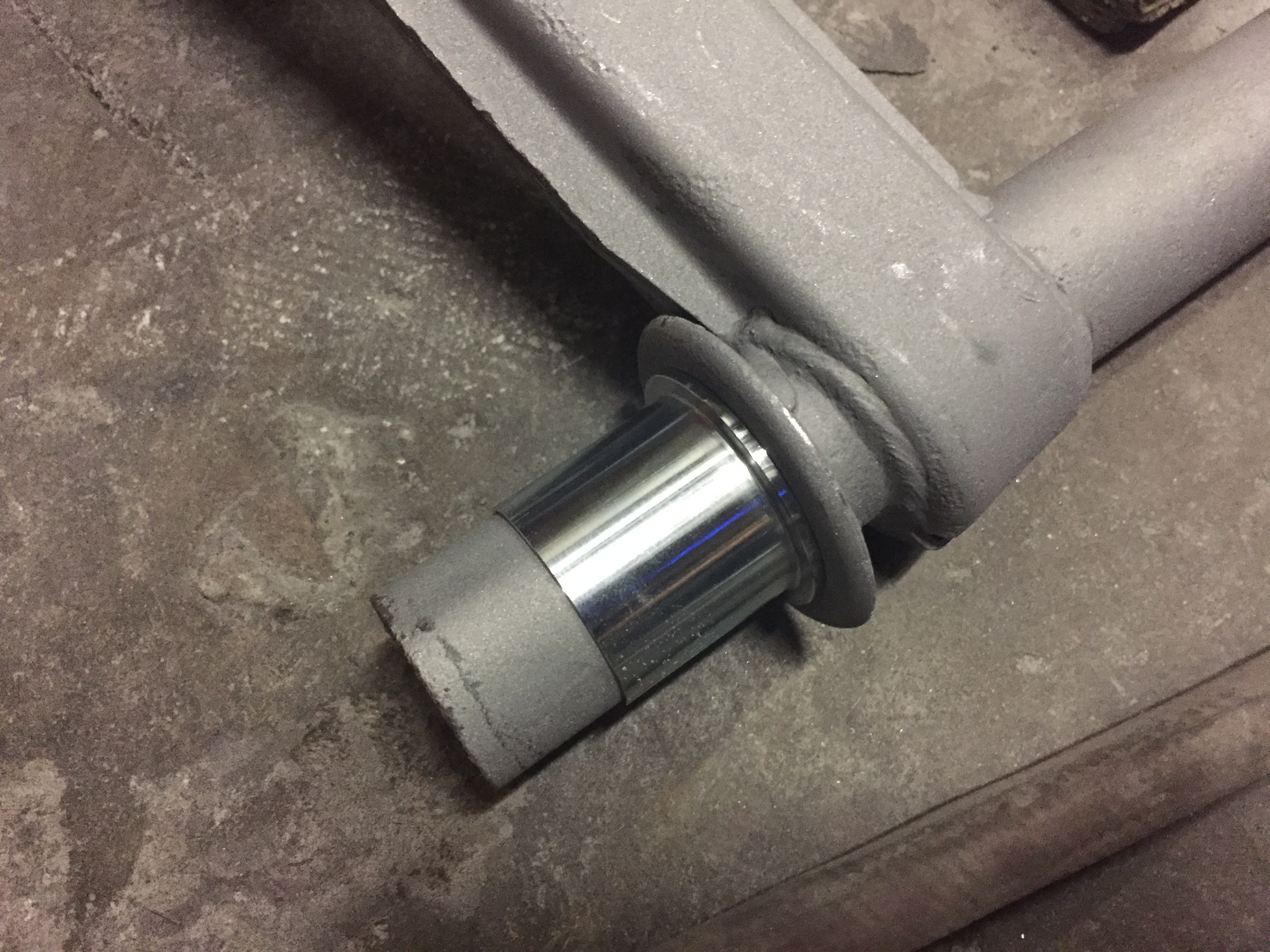

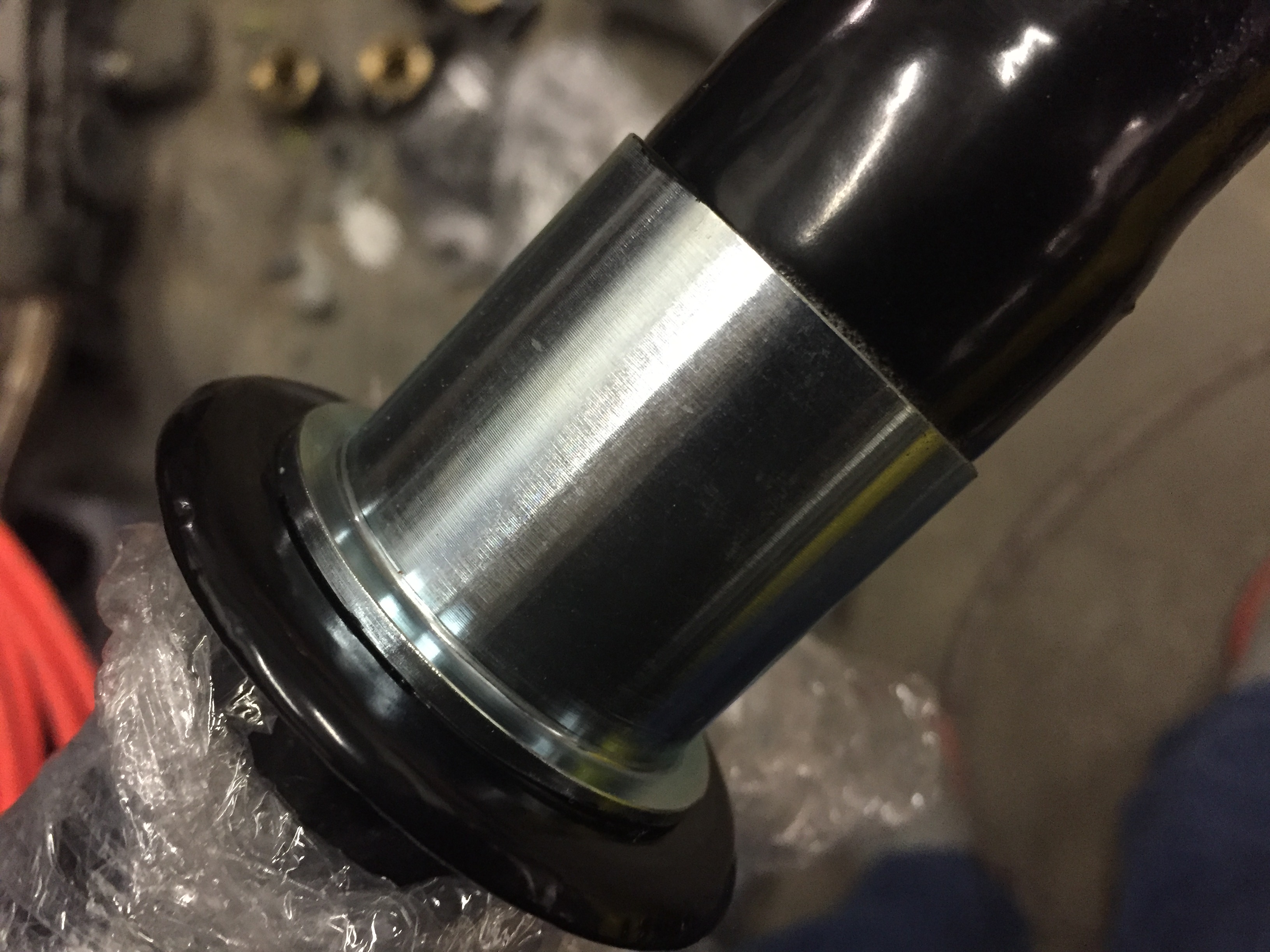

jkb944t   My Elephant Racing poly-bronze bushings slide over...   Feb 23 2016, 07:25 AM
db9146   Kypton tape can be used to mask off areas prior to...   Feb 23 2016, 10:32 PM
