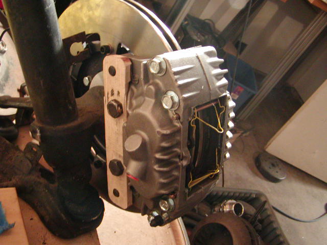

> Yippee...problem solved...I've got big brakes :), up front at least for now :)
Mueller
post Mar 20 2005, 01:59 AM
914 Freak!
Posts: 17,155
Joined: 4-January 03
From: Antioch, CA
Member No.: 87
The pad overhang was not as bad as I had originally thought.....taking the pads to the bench grinder (recommended by a high performance brake pad engineer), I just need to add a chamfer to the edge of the pad to get rid of the overhang......pretty darn easy once I gave it a shot....
the adapter itself will be pretty easy to make and shouldn't cost me much at all for supplies....
I know have to decide what color to paint the calipers (IMG:http://www.914world.com/bbs2/html/emoticons/smile.gif)

Mueller   closeup of the pad overhang   Mar 20 2005, 02:00 AM
Mueller   this ought to look nice behind my Revolution rims ...   Mar 20 2005, 02:01 AM

scott thacher   so 500 including pads... ouch   Mar 20 2005, 09:58 AM
scotty b   http://www.914world.com/bbs2/...   Mar 20 2005, 10:00 AM
914efi   I milled the 'mazda' off mine. I wish I di...   Mar 20 2005, 10:09 AM

Bleyseng   Big diff between the NA and Turbo brakes IIRC on ...   Mar 20 2005, 08:43 PM

914efi   Are you using larger wheels? When I did this I wel...   Sep 6 2005, 10:05 AM

phantom914   Mike, What are the piston diameters on these cali...   Sep 6 2005, 11:46 AM

Kevin@ojai.net   Mike, Why didn't you finish the part? Didn...   Sep 7 2005, 12:27 AM

Howard R   Mike, Are the Mazda calipers aluminium or cast ir...   Sep 7 2005, 01:13 PM
BIGKAT_83   Mike the strut in the picture is a 3" 911 strut th...   Sep 7 2005, 01:30 PM
Mueller   <...   Sep 7 2005, 02:47 PM
