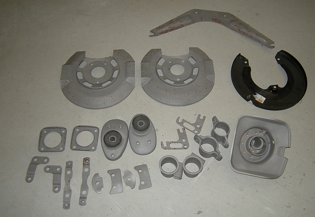

I want to give some parts of my original /6 the original finish again. They are sandblasted, but I am not sure which parts have had zink or paint finish originally.
I think the break shield are yellow zink plated for a /6 and the tank filler unit should be black painted as well as the holder for the muffler. But what about the remaining items.

IIRC the muffler hanger (top), rear brake shields (2nd row L) & gas tank filler/overflow tank (bott/rt.) were all the factory satin black paint finish - like what looks to be an NOS front brake shield at the 2nd row top right - on all 914s 4/6 - so if that's an original part with original finish, you have the match for your painter or PC shop to use with it - keep that as is if it's the genuine Porsche part on the sticker. Recheck below guys one the rear shields.
The rear shock spacers ("L" shaped in 3rd row 2 over from fuel overflow) were silver zinc.
IIRC the the shock top caps are black too - but check with socalandy & toolguy on here by PM for that & the other parts. PM them directly since they may not see this otherwise.

the shock top camber plates are yellow zinc plated

Brake dust shields are yellow zink. Later cars were black.
Yes, that's right those are yellow, but I thought it was yellow cadmium, not yellow zinc. Not that is makes that big of difference, but yellow cad does look a little different.

You are right, originals were cadmium plated, but you can't cad plate anymore so everyone has to use yellow zinc.

Thank you all for the feedback ... as there are different anserws on the brake shields ... I am still not sure if they should be black or yellow?

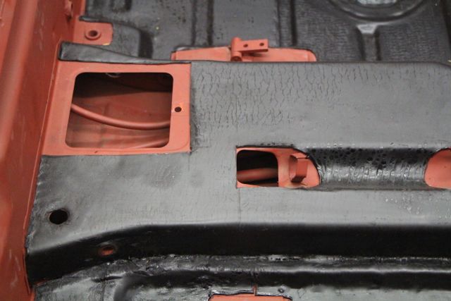

Tom, thank your for your suggestions. The car as well as most of of the parts have been soda blasted and only the rusted areas have been sand blasted. I have also plenty of pictures of everthing, but brake shield etc were in terrible condition so I did not know...
I even made pictures of the tar on the floors, which I have reproduced accordinlgy and glued into before painting ...

Brake shields on sixes were definitely yellow. One of the neat differences IMO.

Zinc is a better rust protectant.
Bearing Caps = Yellow Zinc
Front Dust Shields = Yellow
Rear Dust Shields = Black
Shock Caps = Black. Only yellow on later SC's
Alignment Plates = Yellow
Everything else black as described. Your call on the alignment shims. I'd have a nice heavy coating of clear zinc on them.
