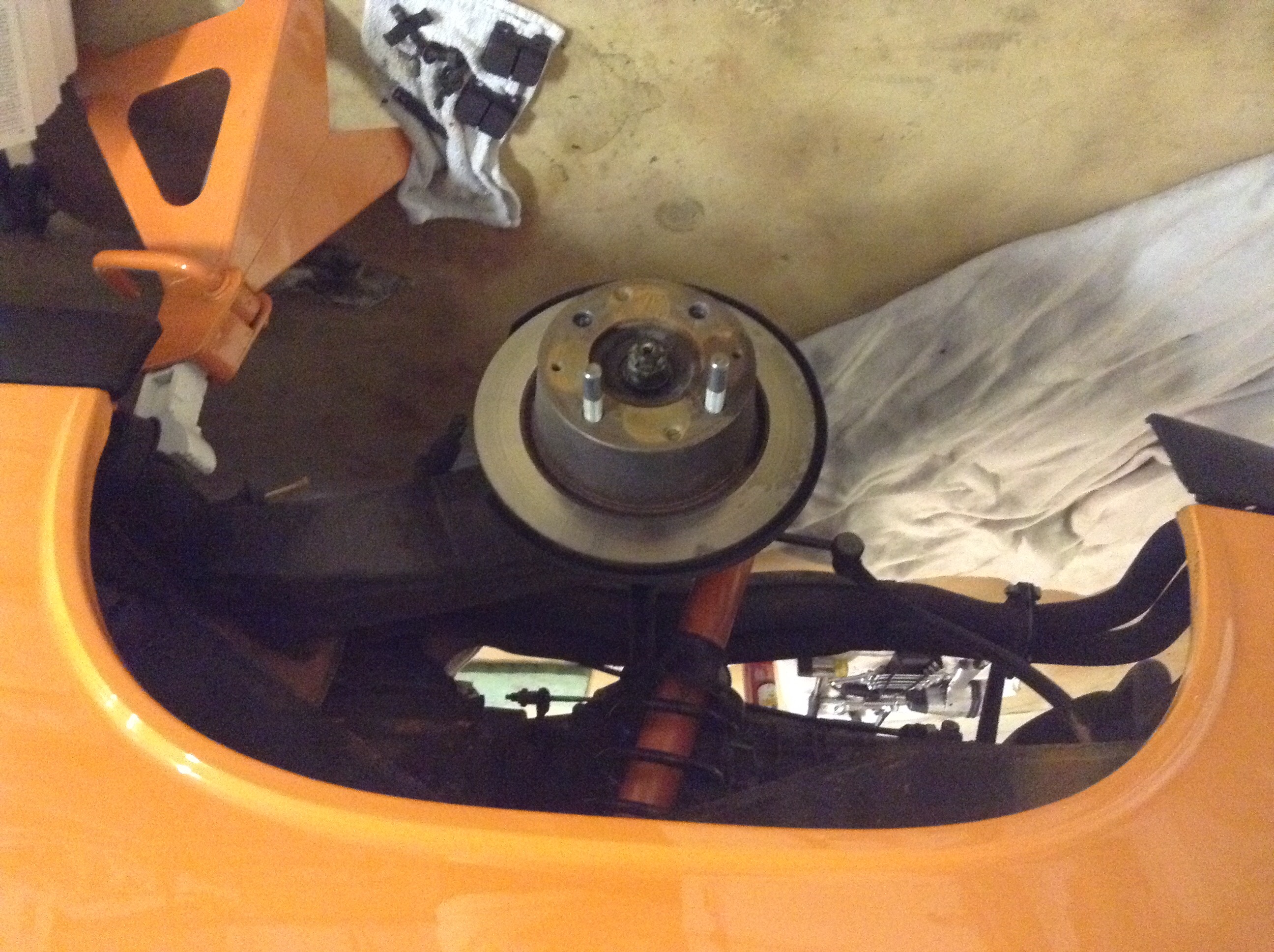

I'm doing suspension and brake work this winter. After mounting and dismounting the wheels several times I finally figured out something most of you have probably known forever.
I went to ACE and bought two bolts that match the thread of the lug bolts and cut the heads off.
I've always been a late bloomer...
Next I'll figure out how to post a photo in the correct orientation (IMG:style_emoticons/default/idea.gif)

So, why did you do that? Just to line it up? That's actually a pretty good idea.
Thanks for sharing.

Makes it easy to hang the wheel on the hub. Screw in the first two bolts, unscrew the studs and screw in the last two.

Somebody makes knurled studs to do that. but your idea is cheaper, and you could just cut a slot with a hacksaw to make it easier to unthread them if they bind up.
Good idea. (IMG:style_emoticons/default/thumb3d.gif)

My 91 Audi came with a plastic stud to help mount tires. Now I use it on my VW. Makes mounting a breeze. So she said.

Not to burst anybody's bubble, but they've sold those headless bolt wheel alignment studs since back in the day 60's-70's, & still do at almost any Porsche parts retailer.
Plus - they're gold Cad or zinc plated all around so they won't rust sitting in your tool kit or trunk.
So all the usual suspects have them today - unless you just want to cut off your own bolt-heads for some reason.
You can get by with just one if you put it at 12-o'clock, which is what most of us do/did.
But then, I always just used the old forehead at the top of the tire trick when changing a flat on the road.
