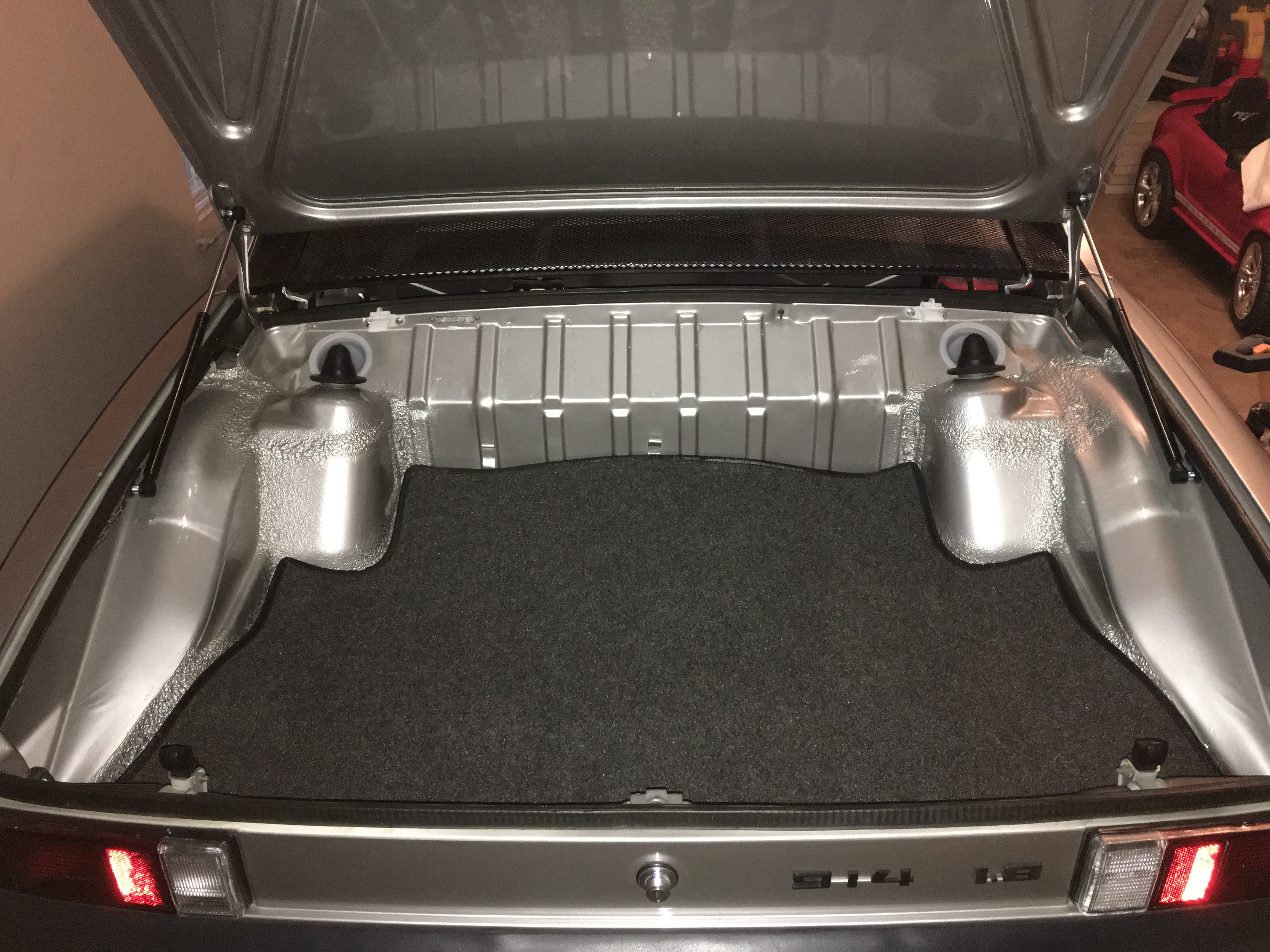

QUOTE(The Cabinetmaker @ Feb 10 2016, 09:09 AM) *
Never seen one riveted. M6 bolt.

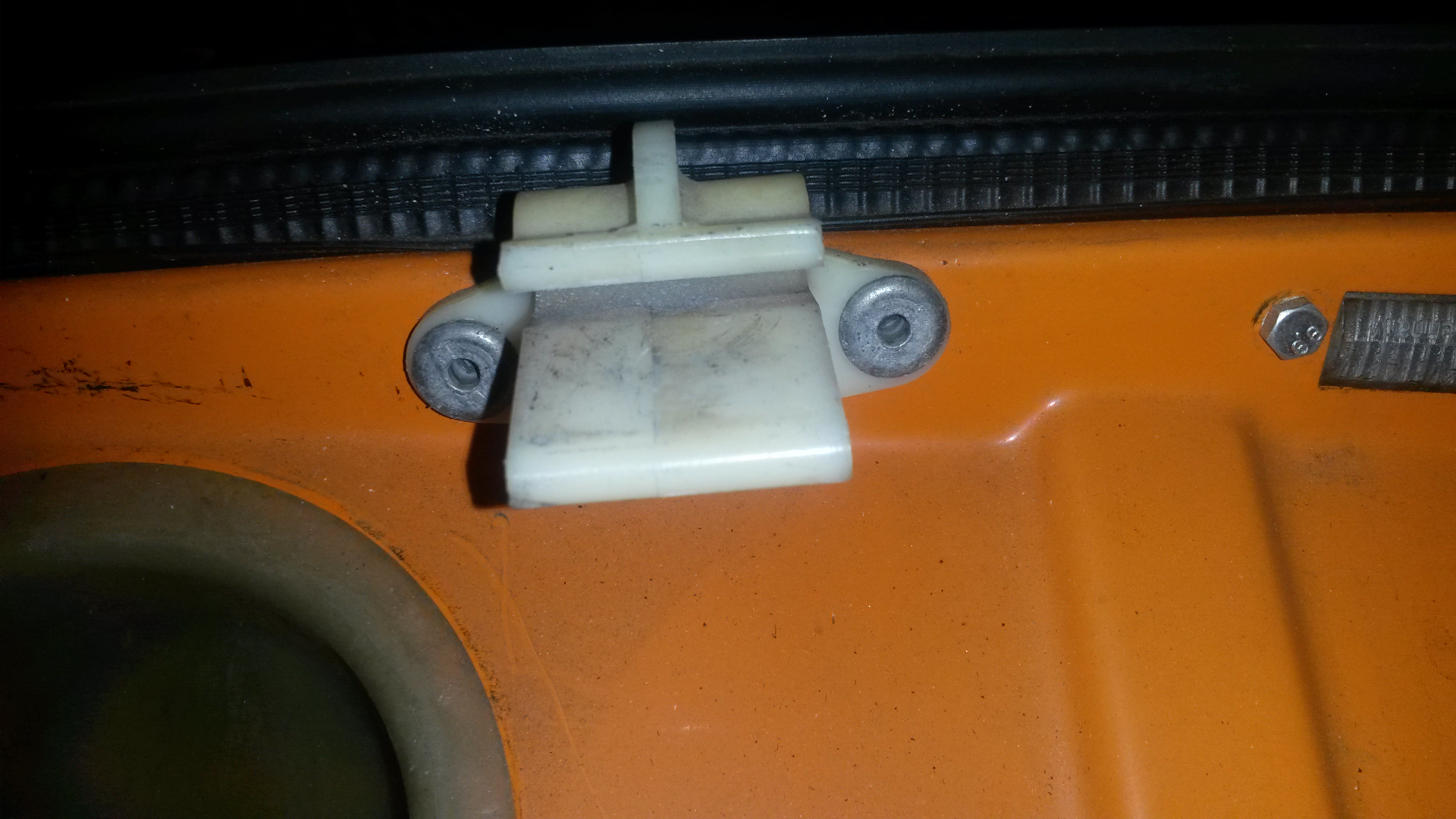

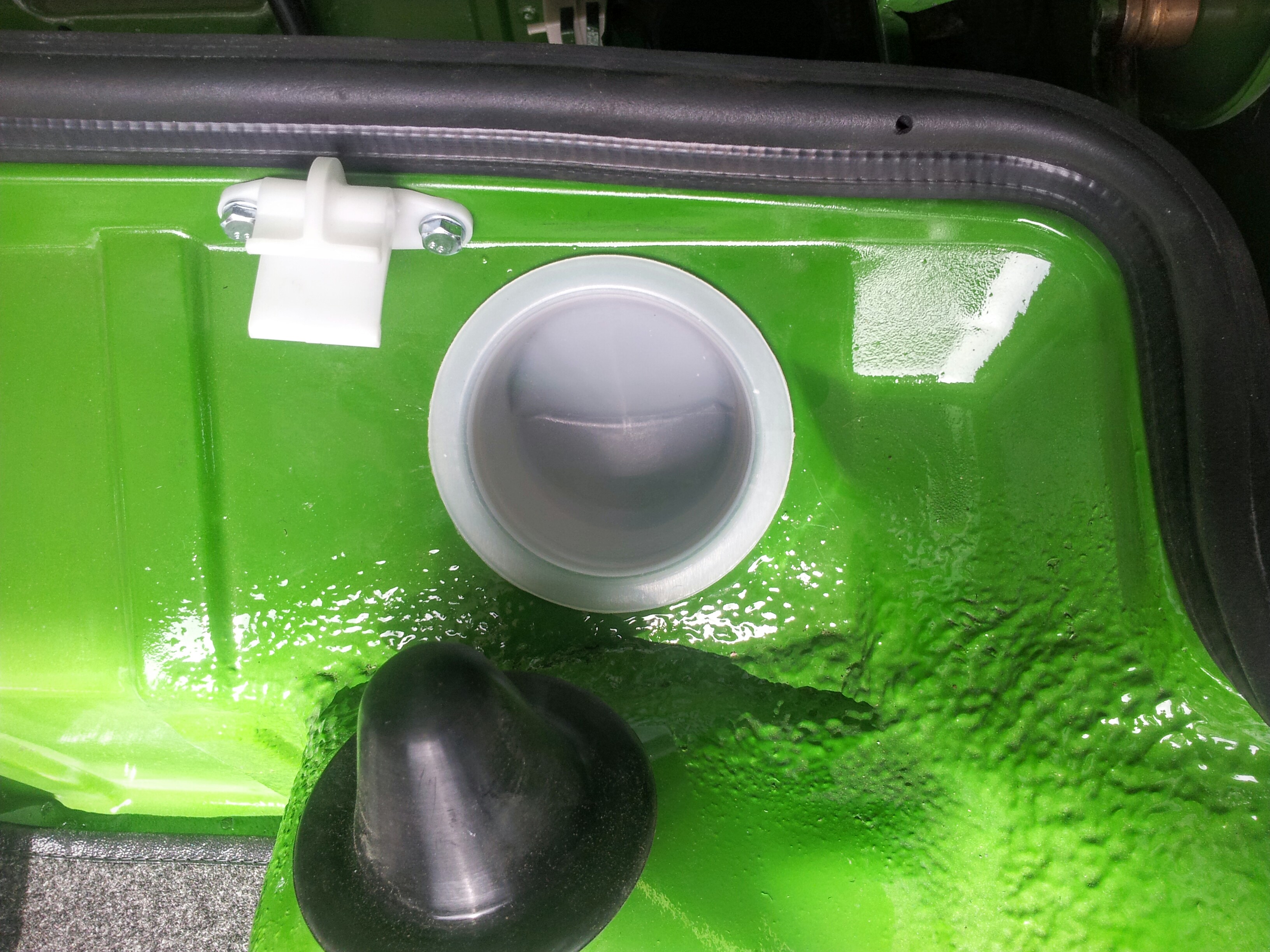

Ok I just hobbled my butt out to the garage
One side has bolts, the other has these
The side that broke has bolts, so I'll assume that the holes were reamed out to accept them. In that case, rivets are out (IMG:style_emoticons/default/dry.gif)

Must be an early versus late model year change. My picture above is from my car which is an early '72.
