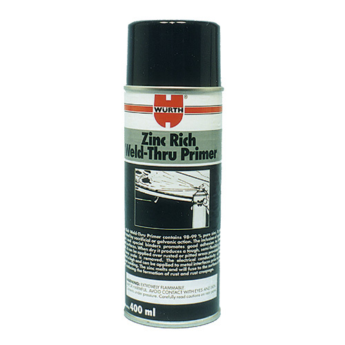

I use Wurth
![]() Zinc Rich Weld Through Primer Description 13.53 fl. oz. Aerosol Features - 98 - 99% pure zinc content - Long term cathodic protection for all metallic surfaces - Adheres reliably to all metals - Heat resistant up to 914ºF - DO?NOT apply filler after application - Good electrical conductivity - Special epoxy resin for better adhesion 914 degree heat resistance is why I use it has to be an a sign from the 914 Gods (IMG:style_emoticons/default/smiley_notworthy.gif) |
