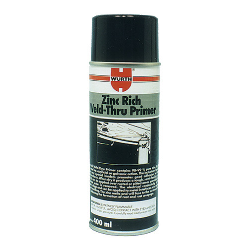

914forme
I use Wurth
Zinc Rich Weld Through Primer
Description
13.53 fl. oz. Aerosol
Features
- 98 - 99% pure zinc content
- Long term cathodic protection for all metallic surfaces
- Adheres reliably to all metals
- Heat resistant up to 914ºF
- DO?NOT apply filler after application
- Good electrical conductivity
- Special epoxy resin for better adhesion
914 degree heat resistance is why I use it has to be an a sign from the 914 Gods smiley_notworthy.gif
