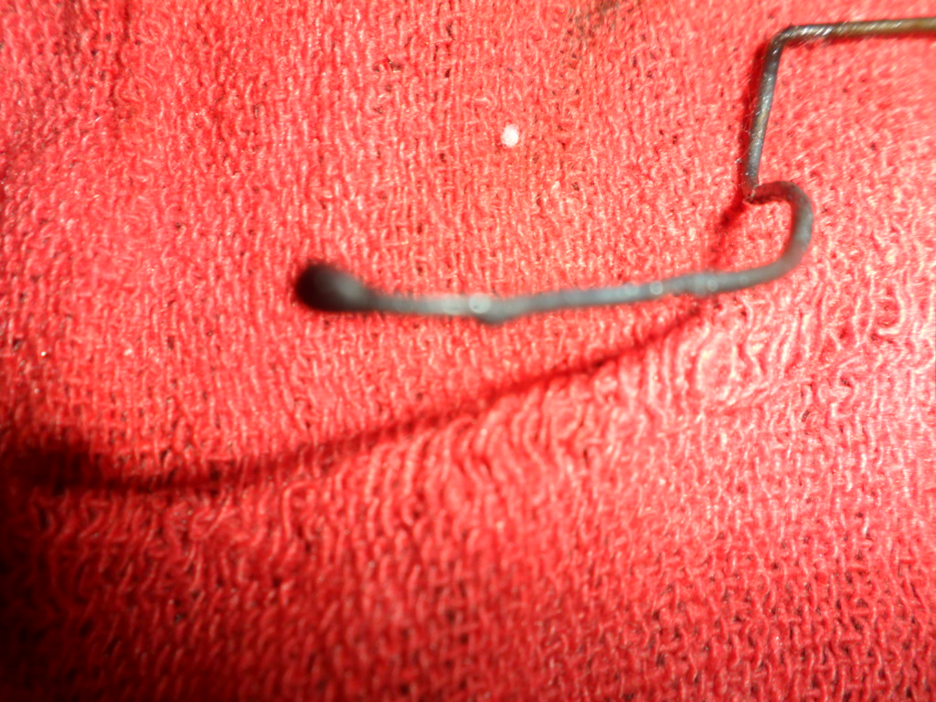

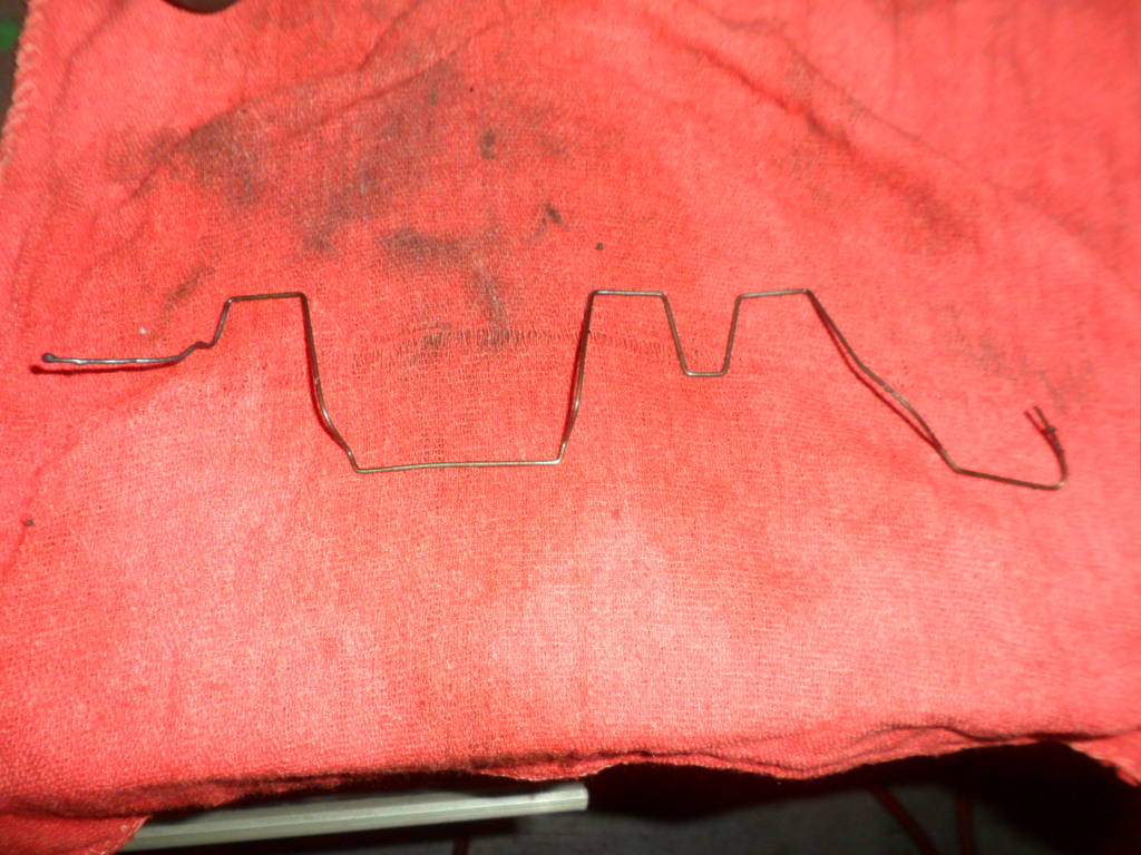

Disassembling my engine, I found that one of the pushrod tube holders was in two pieces...it looks as if someone tried to weld it back together at some point, but it broke at the weld.
If using Locktite 565 on the pushrod tubes, as recommended by Jake, are these still required? Just trying to figure out if I need to pick one of these up or not. Thanks! ![]() ![]() |
saigon71 Pushrod tube "holders" Feb 14 2016, 12:00 PM
mepstein Bob - I have a bunch of that stuff from different ... Feb 14 2016, 12:15 PM
saigon71
Bob - I have a bunch of that stuff from different... Feb 15 2016, 04:49 PM
Dave_Darling You still need them...
--DD Feb 14 2016, 08:58 PM
brant yes needed.
many threads on here about why
buy a u... Feb 15 2016, 09:58 AM
ConeDodger I purchase these new from the dealership. Minimal ... Feb 15 2016, 08:33 PM![]() ![]() |
