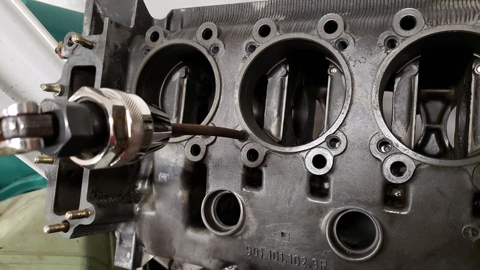

Ok, now you're up to speed. I finally decided it's time to get serious about this engine. I will be sending the case out to Ollie's in the coming week or two and to do that I needed to pull the studs.
I've read all sorts of stories about stud removal and decided to get one of these since I wasn't going to be re-using the studs.
Stud extractor by Ares tool
(IMG:http://live.staticflickr.com/65535/49483005043_ecbf91249d_c.jpg)
This thing made life so much easier, it took about 20 min to pull these 12. The rest I am going to do tonight then package it all up.

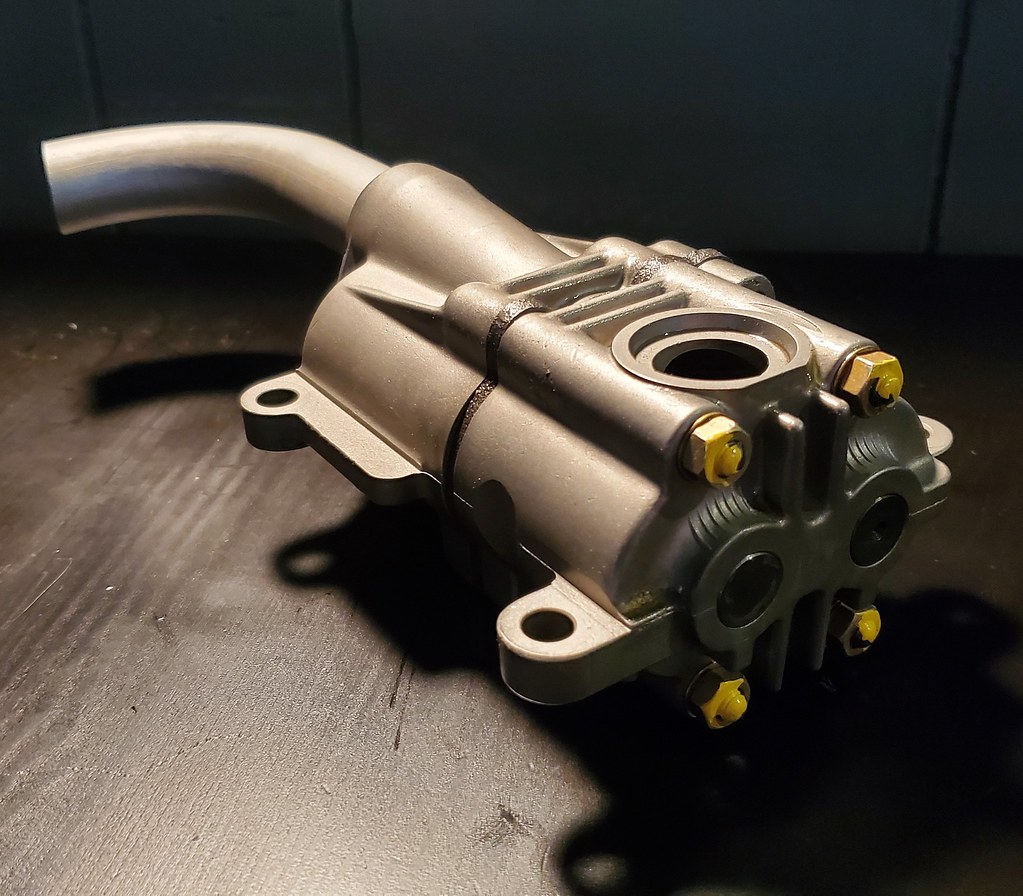

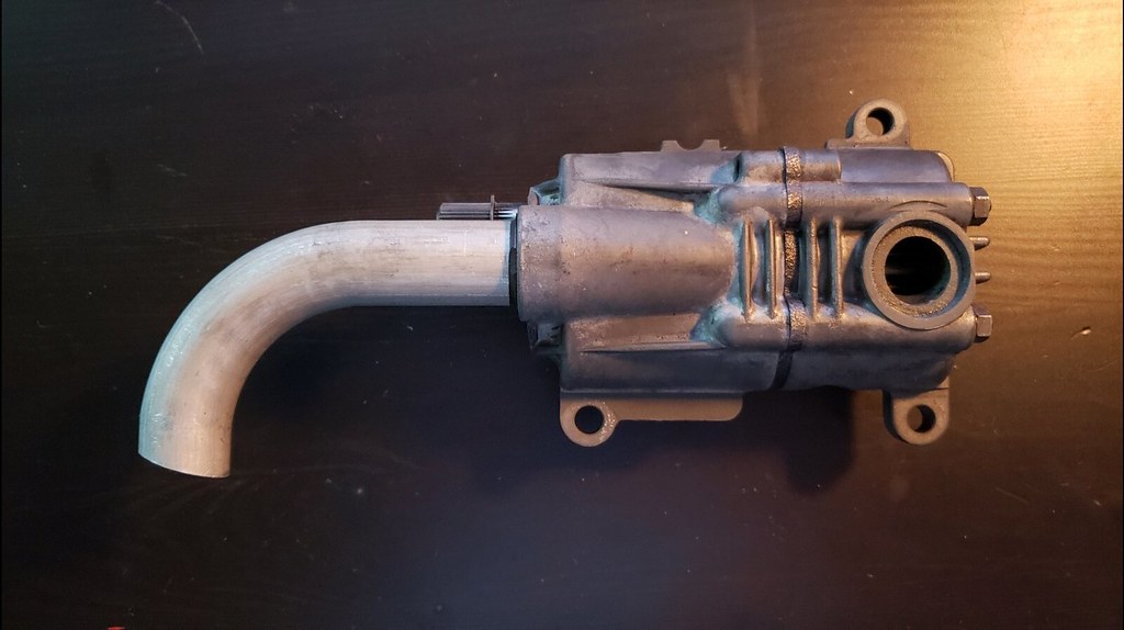

Found a local guy selling a 4 rib pump for my build. I'll be having the oil bypass mod done when it's at the machine shop. It has also been recommended to send out the pump to get rebuild/modded for flow by a good friend who has built several high end 911's.

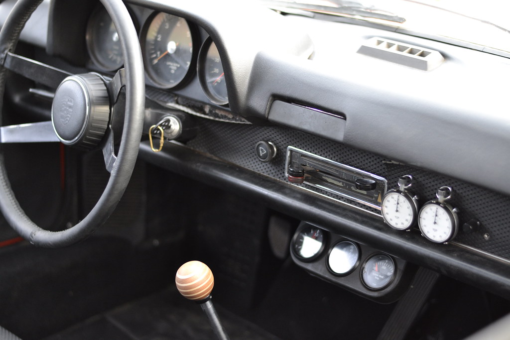

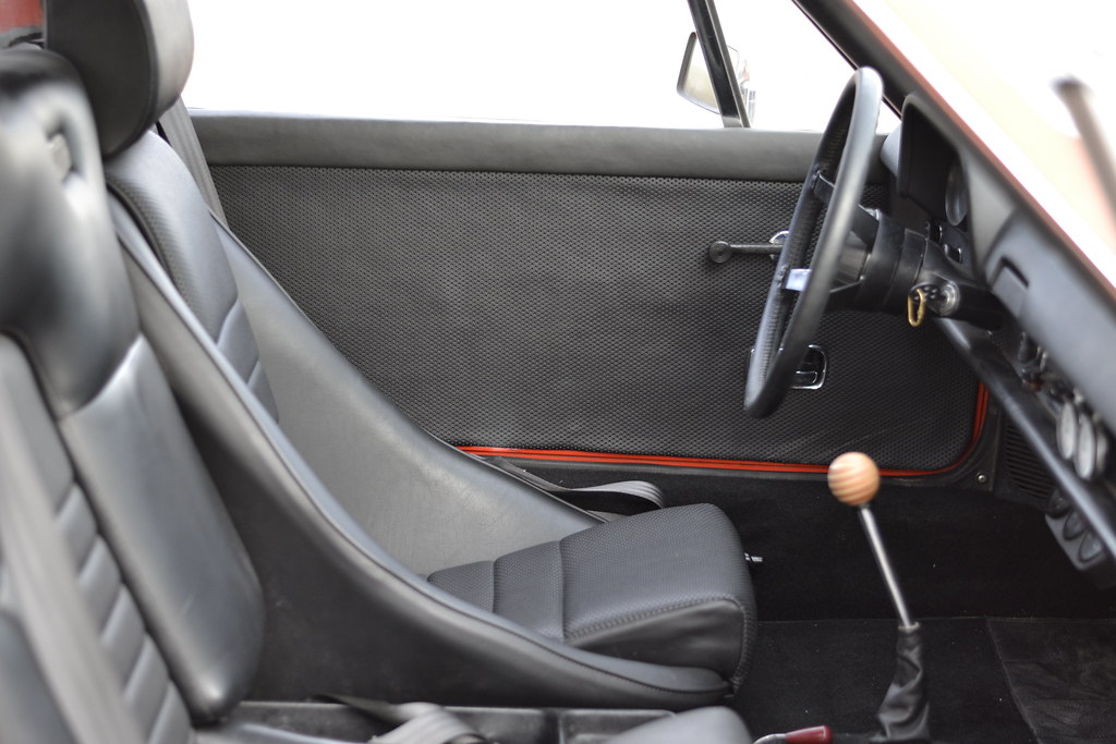

-the 911 2.2T case is at Ollie's getting the work done. It did have head stud inserts, but we're opting to have those removed and they are going to do their case savers. Price was a bit higher than I was expecting after looking at their online price list, but the timeframe is also pretty long so it is giving me time to build the fun stuff budget up a bit before completely draining it, haha. Might be able to start engine assembly later this summer, and install it in the fall or winter.
-I purchased a tuna can from 914werke, I wish I had done it sooner. Maiden voyage after the install saw no decrease in oil pressure on back-to-back cloverleafs. I'm certainly very happy with it.
-I decided to take Jules (and others) advice and get the LED headlights from 914Rubber. I had purchased a set of H4 housings last year. At least I thought they were H4 at the time, turns out they were not (used, Craigsist deal from a Jeep guy I think) Discovered that when going for the install and just put all the stock parts back in until I can get the right housings.
-Haven't had a chance to install the Porterfield brake pads yet, but I did pick up some fluid so I can bleed the system at the same time.
-Pulled my old stock lower front valance out of deep garage storage, cleaned it up a little and plan on putting it back on for now. No use making it look perfect if the rest of the car is well patina'd.
-I picked up a laminated wood shift knob from TRE Motorsports. So far I like it.
Current short term plans:
-replace the dash face material again, this time yanking out the heater controls. I'd also like to recover the top dash. And I'm going to go with 3 Heuer timers for a bit, my daughter loves to play with them while we're driving (she's 3)
-recover the steering wheel again. I learned a lot of lessons when I did this one last year and I'd like to incorporate them into a new wrap.
For now, here are a few interior shots of how it is currently.
(IMG:http://www.914world.com/bbs2/uploads_offsite/live.staticflickr.com-19709-1588035994.1.jpg)
(IMG:http://www.914world.com/bbs2/uploads_offsite/live.staticflickr.com-19709-1588035995.2.jpg)
On the down side, yesterday while driving I ran into an issue with it. As a reminder it's a 1.9 built from a 1.7 running dual Weber IDF40's. I got on it a little from a light and after that the problem arose. The car idles way high, like 3k rising to 4k, I shut it down before it went higher. The strange thing is that the throttle pedal and cable are fine, and the throttles themselves on the carbs are closed. Any thoughts or insight is appreciated. I'm going to chew on it a few days before asking officially for help but I'm guessing I'm going to have to yank the carbs and figure it out.

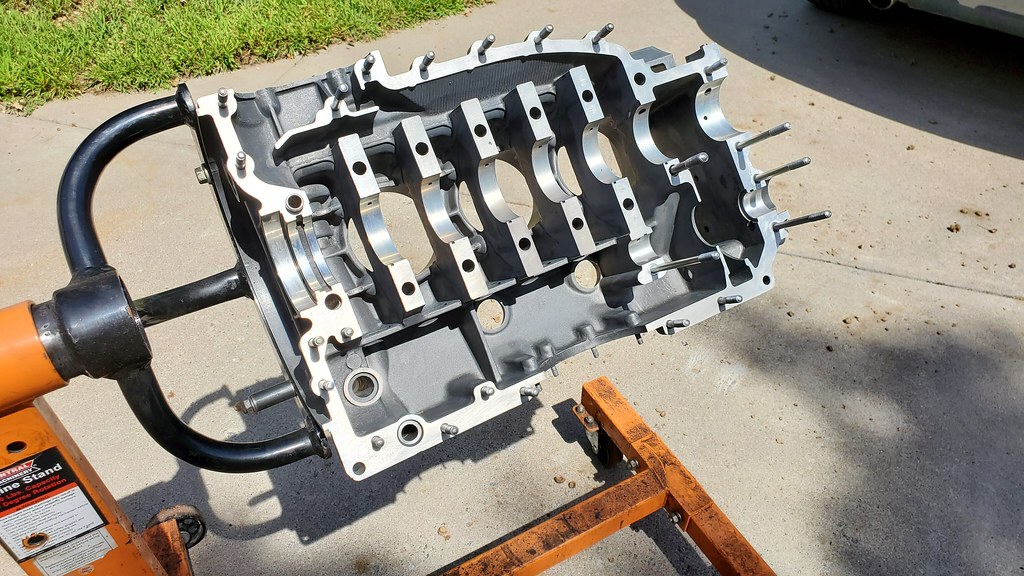

the 12 week mark has come and gone. I messaged Ollies and they said another 2-3 weeks. So we're looking at the end of July.
A friend locally (Aaron from FlatSix) is checking out my pistons and cylinders to gauge if I can reuse them with cleanup.

Make sure to measure everything you get back from Ollie’s. They’ve been having quality control issues for a while now.
Oh no, first I've heard of that. Isn't Ollie's the go-to for case work?
I don't have the tools to accurately measure bores, any suggestions on how to check it out?
And I don't have an alternator yet but I will need one at some point. I also don't know of anywhere to rebuild so I might have to take you up on that at some point if it's available in the future. Currently not enough car budget funds to go around to all the different things I need for this.

The offer is available to you as long as I have the proper core for you. There's no money in selling cores so they sit in storage. Many places have alternator and starter rebuilding services. Ours is located at a large battery seller.
I've heard it from two well respected engine builders who got parts back from Ollie's that where well out of spec. The feeling is when the kids took over from the original owner, quality control has been low. They aren't measuring after machining so things are slipping through the cracks.
I'm no engine builder but I believe many builders will assemble the short block and torque the bolts as a dry run before sealant. I guess short of measuring you want to make sure everything spins smoothly. But any good machine shop should be able to give you written post machining measurements. But you probably have to request and not just assume.
"Neil Harvey" -
Can I assume you did not check the case or crank before reassembly?
Here are few things that need to be checked.
Main housing alignment and size.
Crank straightness. They never are.
Bearing ID fitted to the case and torqued.
Crankshaft journal diameter.
From these you can calculate the clearances.
You probably have other case issues you may not be aware of as well. The case should be thoroughly cleaned, the galley plugs removed, piston oiling valves checked, by pass checked if done, all perimeter studs removed and the case parting faces lapped before measuring main housing bore, all threaded bores checked and repaired, just to name a few.
This all adds up so don't be surprised at the final cost.
We line bore cases oversize only. We do not deck and bore back to std. We are probably a little more expensive than the other main players but we typically turn cases around in 1-2 weeks, which includes all the work listed above. We do this work in house for all of our engine customers and occasionally do outside work. We deliberately keep it this way so the turnaround time is days not months.
The more you do your self the less the total will be. Clean the case well, and remove the 8.00mm studs. This saves a lot of time and $$."
I would search pelicans engine building forum and read everything Neil Harvey has written. He talks a lot about what to do before you build.

The 3 week mark has come and gone. I emailed Ollie's and it sounds like they're finishing it up soon. they say 2-3 days.
The 4-rib oil pump is freshly rebuilt and on a UPS truck right now.

Parts are arriving.
(IMG:http://live.staticflickr.com/65535/50217141931_9474de022b_b.jpg)
Ceramic coated 1.5" headers from Marty at MSDS
(IMG:http://www.914world.com/bbs2/uploads_offsite/live.staticflickr.com-19709-1597208007.1.jpg)
my 4 rib oil pump rebuilt by Henry at Supertech Performance
(IMG:http://www.914world.com/bbs2/uploads_offsite/live.staticflickr.com-19709-1597208007.2.jpg)
Case is back from Ollie's (don't worry, they sent the other half too)
Vents and jets are on their way for the Zeniths
Excited to finally start assembly!

Glen ,case looks great and those headers (IMG:style_emoticons/default/drooley.gif) .
What are your plans for the Zeniths?,cheers.

QUOTE(porschetub @ Aug 12 2020, 12:28 AM) *
30mm venturis, 55 idle jets and 130mm main jets. As a starting point. From there I'll have a bud of mine fine tune, or swap out jets as necessary. He runs a shop that specializes in these and old VWs and did my Type4 when I was getting my 914 going.
