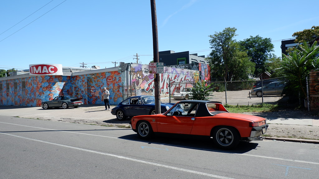

The day before last we made it through Denver where I made a pit stop to visit my sister, and then southwest on 285 all the way to Salida, CO. About 600 miles that day.
(IMG:http://www.914world.com/bbs2/uploads_offsite/live.staticflickr.com-19709-1632400938.1.jpg)

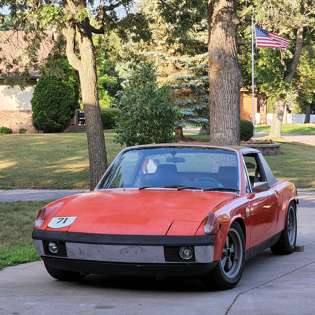

Edit: I realized I hadn't updated since mid-trip last year. Here is a run-down of the Overcrest Rally. This was about 3400 miles on a fresh engine.
http://www.914world.com/bbs2/index.php?sho...=355998&hl=

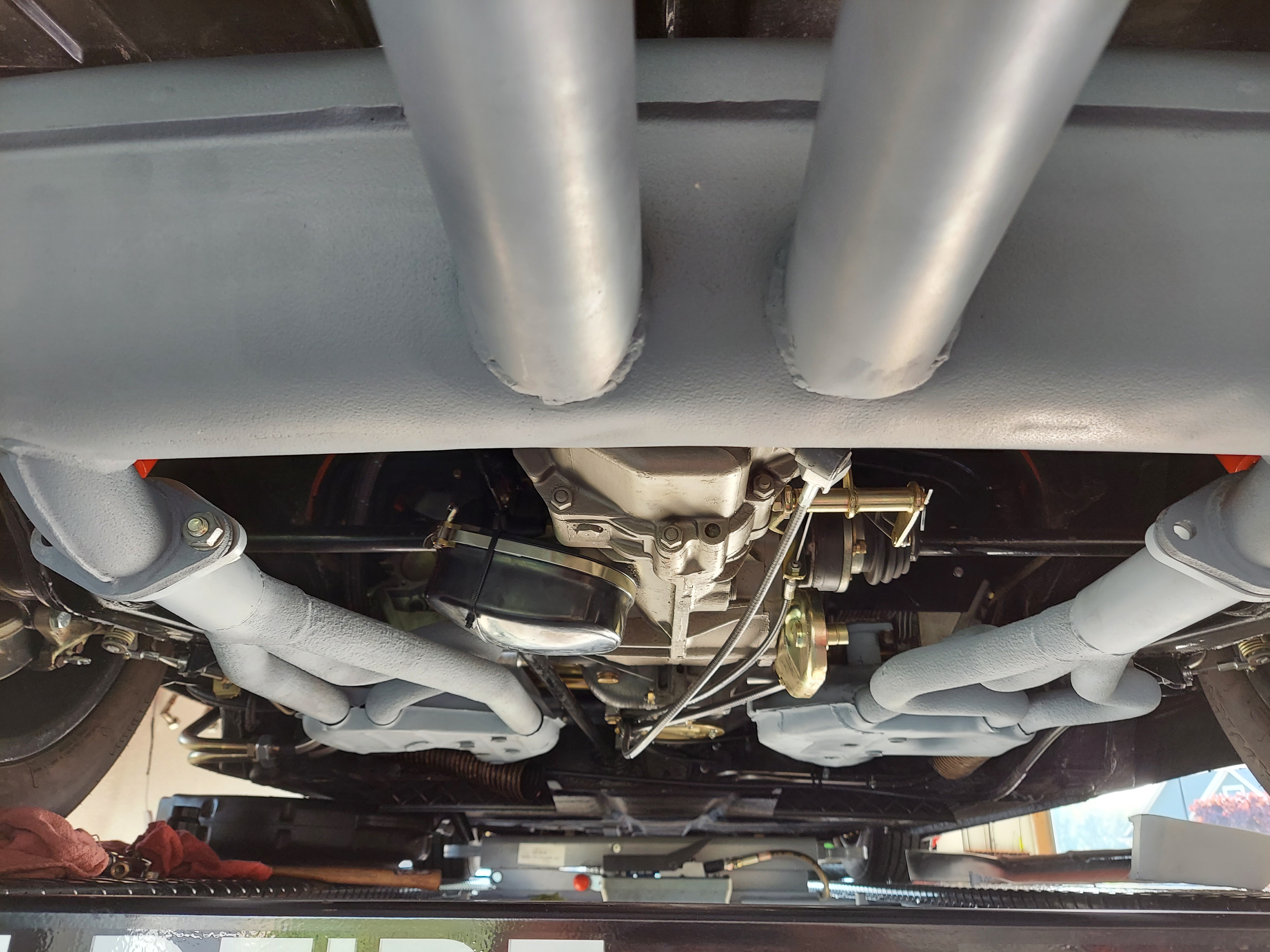

Finally, I mean FINALLY I have the car out of winter hibernation. After last season there were a handful of things I wanted to do, and a backlog of other projects prevented me from using the 914 at all during the spring and half of the summer.
The main tasks:
-drop the motor
-install safety collars on chain tensioners, after I rebuilt them and the motor there wasn't sufficient space to install them, had to break the motor in a bit.
-add a section to my oil line. The one coming out of the tank near the oil filter. I have this routed down the frame, up and over the transmission, and then forward into the case. Disconnecting the fitting on the tank every time I dropped the motor was no fun, it was the worst part of the experience. So now I added a small section from the tank to just outside the sheet metal on the underside, I can disconnect it there very easily.
-install turbo lower valve covers, and remove paint from upper valve covers and chain covers. Of course, resealing these as well. I brought the new lower valve covers in to mill out the section required. I used a photo that someone posted here as a reference. Turns out it was wrong and I milled off the wrong corner. (IMG:style_emoticons/default/headbang.gif) Will be corrected next time I drop the motor (likely for my next valve adjustment...)
-reseal the intermediate shaft cap. This was the source of my oil leak. NO MORE LEAKS!!
-install all new brake hardlines and disassemble/clean the brake pressure relief valve. At the end of last season I had another bout of brake seizing. Something keeps pressure on the rears enough to make slight contact with the rotors, the heating (I believe) swelled the pads slightly, enough to make more pressure, and more heat, etc, until the rears were just locked up. After doing the pad adjustments over and over, and replacing calipers and soft lines and checking everything else, it came down to the possibility that the hard lines were in poor shape, or gunk in the pressure relief valve.
(IMG:http://www.914world.com/bbs2/uploads_offsite/live.staticflickr.com-19709-1658332135.1.jpg)
Happy to report that I've completed all of the above and started it up for the first time this season. I still need to do another round or two of brake bleeding, and adjust the shift rods, but otherwise it's running like a champ and absolutely purring.
Did I mention, NO OIL LEAKS!!?!?!
Now that it's running, there are a few other items I'll want to get to. New door cards from 914Rubber are in, and a set of visors are due in Friday. I also want to wire in an outlet inside to charge phones etc. Likely USB.
On the back burner is audio. I'd like to do a Bluetooth amp hidden somewhere and a speaker or two, but that might be a project for another season. The audio track that came with the 6-cyl swap has been pretty riteous (IMG:style_emoticons/default/aktion035.gif)
All this in preparation for the next Overcrest Rally. This year we're heading to the Sawtooth Mountains in Idaho in early September. This will again be about 3000-4000 miles round trip. They used my car for one of the promotional art pieces this year, wooo!

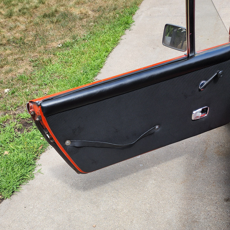

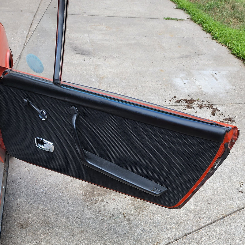

I installed the doorcards, the new clips didn't work very well in my experience.
On the drivers side I added a leather strap for a door pull. Previous to this I just grabbed the top of the door. The armrest that came with the car was trashed and I liked the bare look.
(IMG:http://www.914world.com/bbs2/uploads_offsite/live.staticflickr.com-19709-1658771955.1.jpg)
The passenger side got the armrest, but not the lower section.
(IMG:http://www.914world.com/bbs2/uploads_offsite/live.staticflickr.com-19709-1658772009.1.jpg)

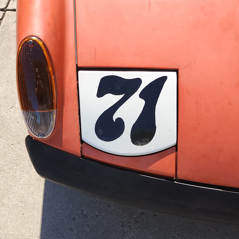

Always loved old-school painted liveries, and I liked the look of the decal "71" I had on my passenger side light cover. So I grabbed a spare light cover from my parts bin and rattle-can painted it a light cream then hand painted a 70's-ish groovy "71"
(IMG:http://www.914world.com/bbs2/uploads_offsite/live.staticflickr.com-19709-1658771957.2.jpg)
(IMG:http://www.914world.com/bbs2/uploads_offsite/live.staticflickr.com-19709-1658771957.3.jpg)
I think it fits the "beat but neat" feel of the car.

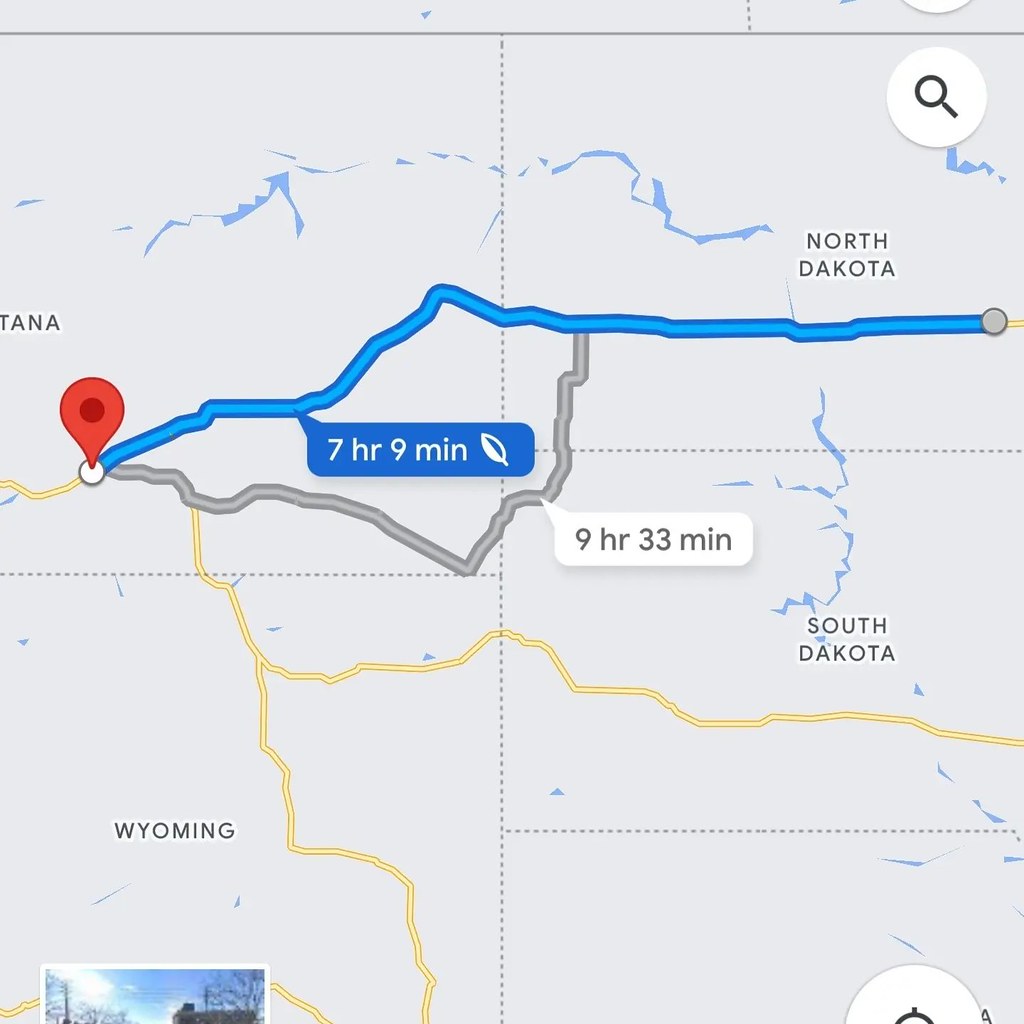

As an update to my last post, I installed a check valve for the fuel tank vent and cured that problem, wish I had done it sooner. Definitely a derp moment.
I dropped the car off with Dave Cheney, he ended up pulling the Zeniths off and going through them again, found a clogged idle circuit and generally freshened them up then retuned. They're in a good place now and running pretty well. Dave said I could advance the timing 5 degrees and then lean the mixture out slightly to further dial the tune.
I have the car all packed up and ready to roll for the Overcrest Rally. I'll be doing social media stuff in real-time through the trip, but also a trip report here, similar to last year.
The route heading out to the start will be 3 days, er... 2 and a half.
I will be leaving home today early-evening, then 4-5 hours up into North Dakota. My daughter is off to her first day of Kindegarten, and today I'll get her off the bus, hear all about her first day, and then hit the road. Leaving is always sad.
(IMG:http://www.914world.com/bbs2/uploads_offsite/live.staticflickr.com-19709-1662478294.1.jpg)

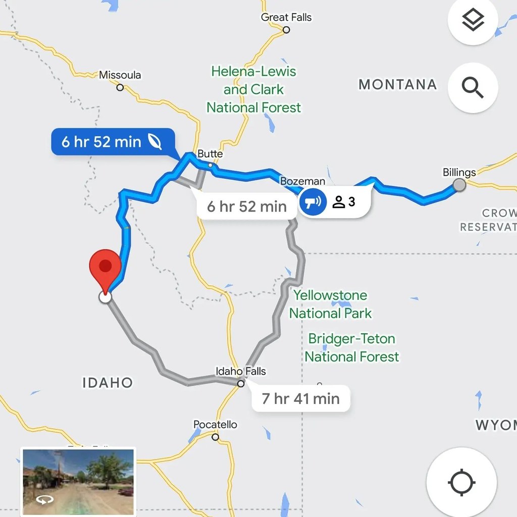

Day 2 will take me across North Dakota and into Montanna
(IMG:http://www.914world.com/bbs2/uploads_offsite/live.staticflickr.com-19709-1662478295.2.jpg)
Then Day 3 will bring me into Challis Idaho for the start of the Rally.
(IMG:http://www.914world.com/bbs2/uploads_offsite/live.staticflickr.com-19709-1662478295.3.jpg)

-new door glass was installed with new bits and bobs to keep it in place.

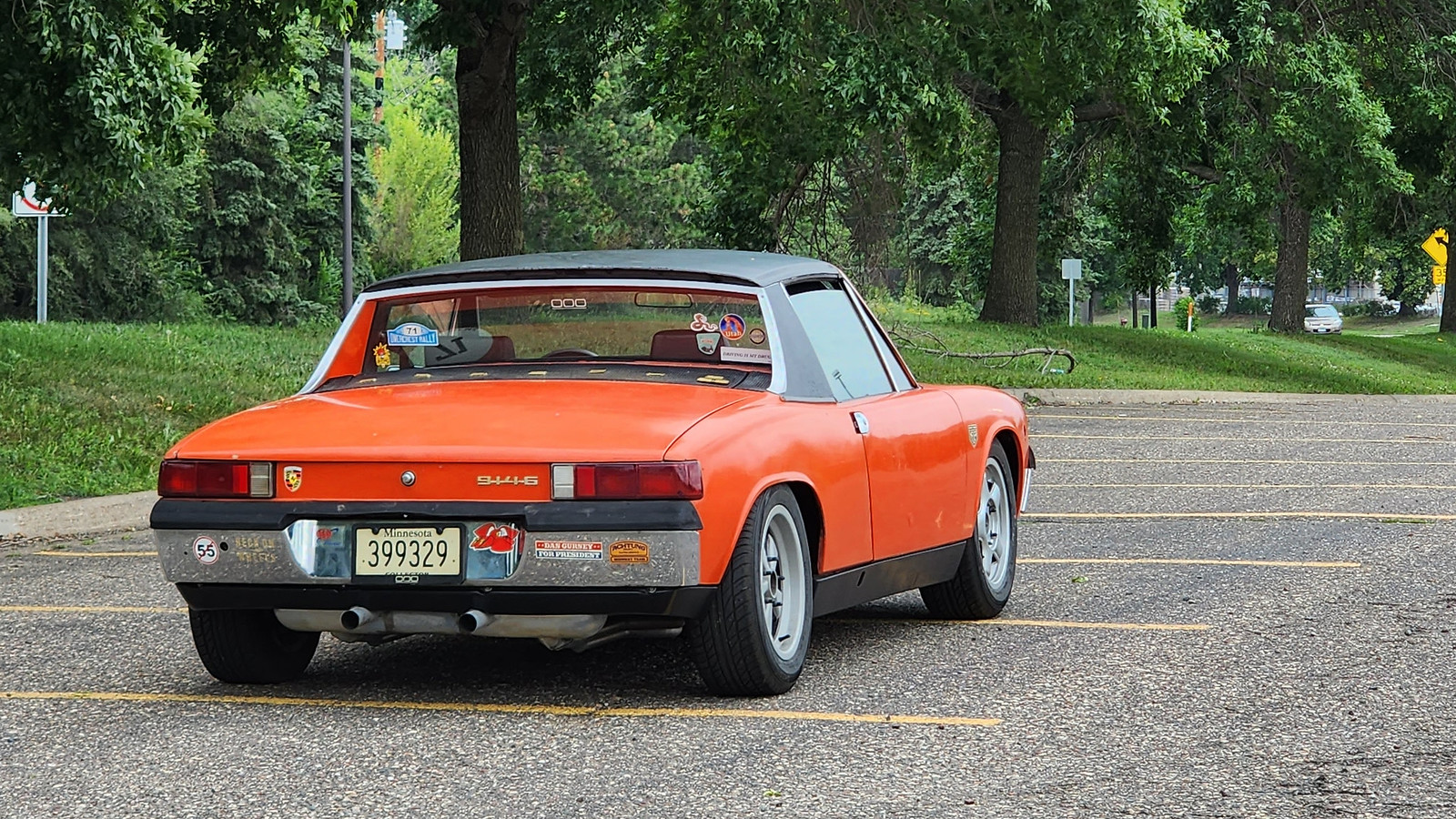

A week or two ago I decided to finally dig into fitting the fiberglass rear valance. Thankfully I just needed to do some cutting and squeezing to make it fit. It's not perfect, but on my car, it would be out of place if it was.
I must say though, once upon a time I preferred all 914s without a rear valance, especially when running a dual exhaust tip muffler. I was talking with @horizontally-opposed and he mentioned he preferred them on narrow-body cars, but without on flared GTs. Months or years later I came around, I really do like the look of a valance on mine now.
(IMG:http://www.914world.com/bbs2/uploads_offsite/live.staticflickr.com-19709-1692733776.1.jpg)

In preparation for the trips I wont take, I installed a flat-tow bracket, LE-style front valance, and while I was in there did 911SC front control arms and subframe to be able to mount an under-body sway bar. This bumped by torsion bars to 19mm from 17mm, a change I haven't really noticed.
I went down a rabbit hole of trying to mount retractable seatbelts in an early car. Purchased the AA ones, they're bad, hot garbage. Took them out and found some from an old Beetle that had an extension bracket. Those almost worked, but my car needed to be on at least a little of a decline or the belts would lock up, so I took those out and put my fixed belts back in.
I noticed that the car was flexing a bit more than it used to, and the drivers door is harder to latch. That long stretch of bumpy dirt road on last years Overcrest Rally did me dirty in more ways than one I fear. Climbing underneath it, there are some spots of increasing concern. So, next year may be a year of bodywork for this old gal. My current plan is to cut and replace any bad metal, clean up anything that can be saved, and re-evaluate once I'm in. If it isn't too terrible I'll do inner long stiffening as well as the metal patchwork. And then since I'll be doing metal work I'll get the flares made and installed, and paint...
