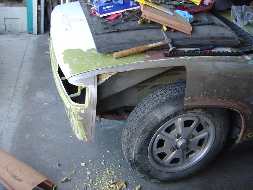

Well, despite what everyone said I cut out the badly damaged panel and welded in a new piece. I had the piece laying around and it seemed the right thing to use it for. Here are the results. Not too bad for my first time. Here is the spot cut out.

rick 918-S Looks good Scott. Now hold a piece of copper or Br... Mar 23 2005, 06:04 PM

skline I guess I did ok, I got very little warpage. The o... Mar 23 2005, 06:24 PM
spunone Scott let me know if ya need some copper or brass ... Mar 23 2005, 06:34 PM
skline Thanks for the offer, I got it handled. All the ho... Mar 23 2005, 07:41 PM

skline I had a piece about 2x8 that I clamped to the meta... Mar 23 2005, 07:56 PM
