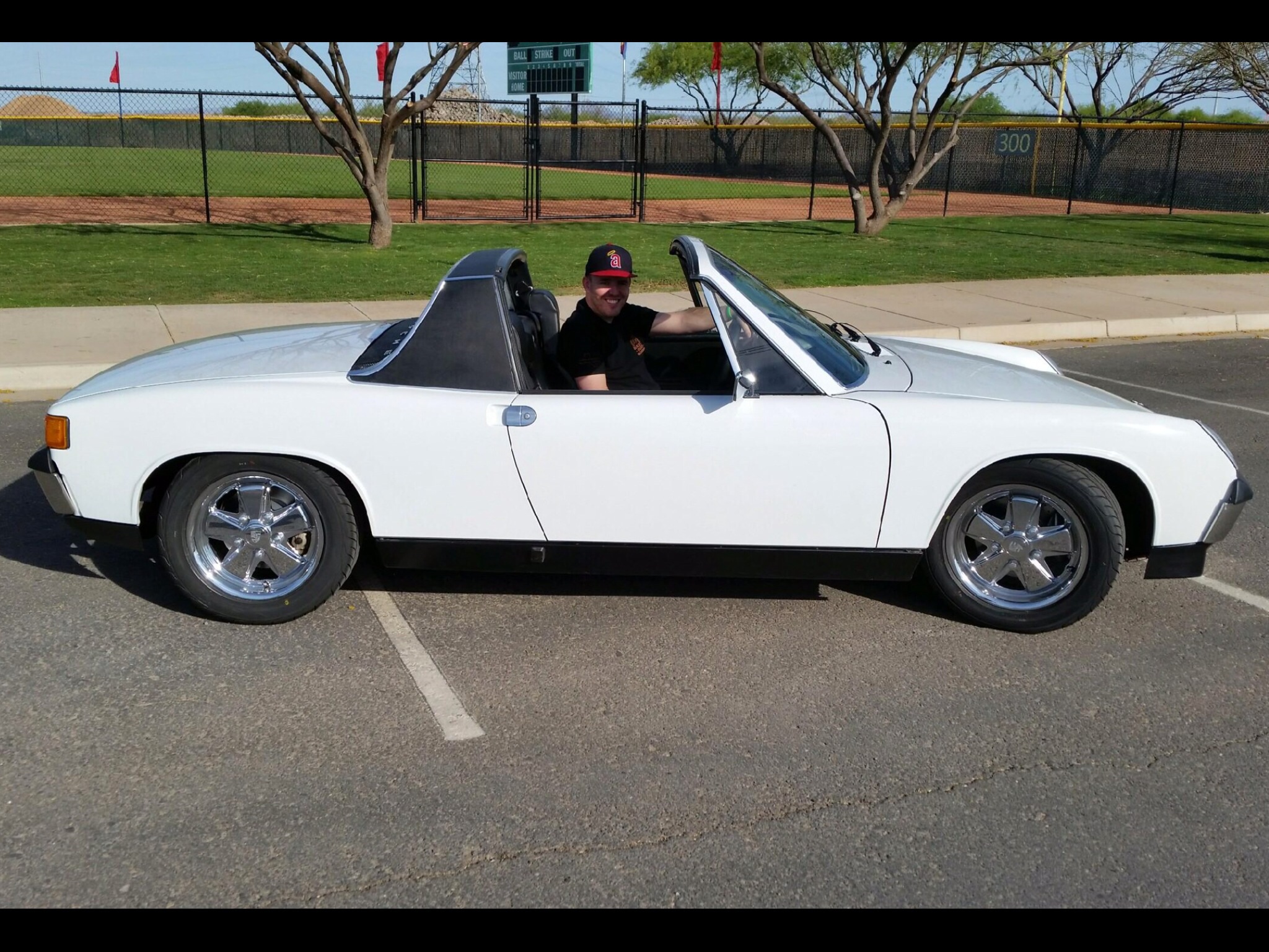

QUOTE(Coondog @ Mar 25 2016, 04:42 AM) *
205 55 15 Yokohama S Drive
I'm a little late finding this thread but are your Fuchs 6" or 7" wide? Do you have any issues with tires rubbing?
lonewolfe
post Apr 19 2017, 03:43 PM
Posts: 819
Joined: 12-September 11
From: Oakland, CA
Member No.: 13,549
Hey Coondog! I know I'm late to this conversation but are those wheels 6" or 7" wide Fuchs? Look like 7"s to me. I've been considering those same tires. I have a set of 6" and a set of 7" Cookie Cutter rims to choose from. Do you have any rubbing issues and how far off is your speedo? As for looks, your car looks great!
