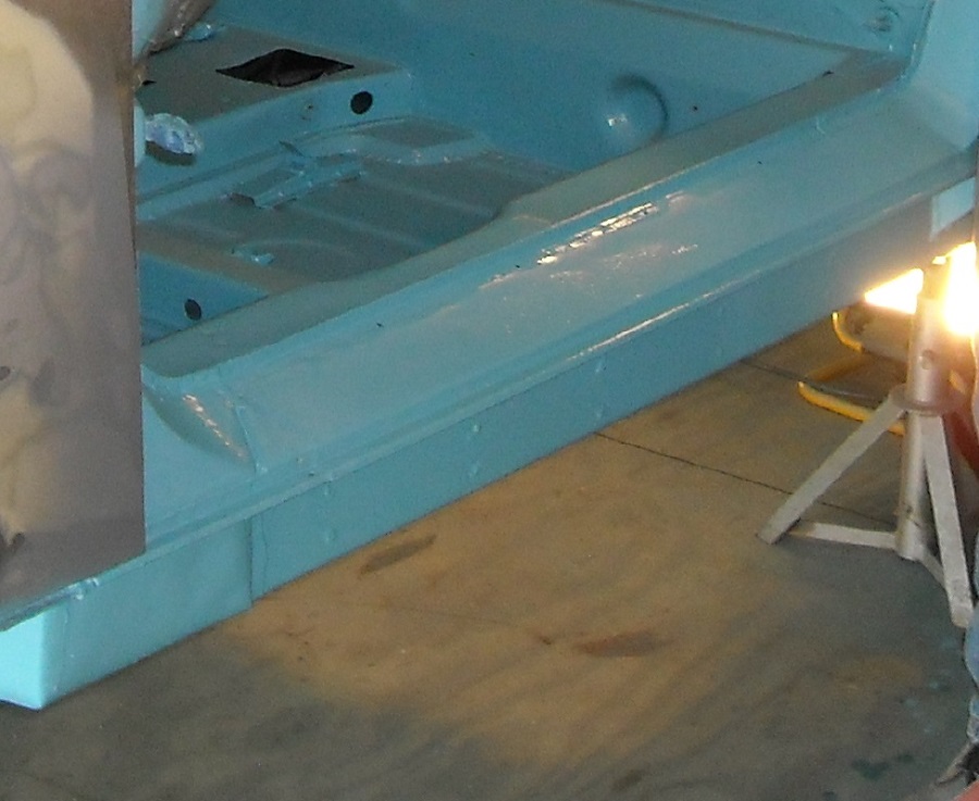

Here is where I wanted to start. The right rail and jack post. The easiest and hardest part of the chassis to repair. Here is a link to a repair I did on a factory 6 I did for Ben.
http://www.914world.com/bbs2/index.php?sho...26585&st=60
I wanted to expand a little more on why I did what I did.
Specially when it comes to the double layer. I installed a double layer in the rail on Ben's 6 when I did the rail repair. This serves two functions. One, less important but functionally as important is heat transfer. This will allow the single outer layer to transfer weld heat into the thicker two layers slowing the transfer and help reduce warping and shrinking.
The second and most important reason in a unit body car is structural. When your talking about trying to butt weld a rail section and count on your weld to carry a vertical, horizontal and angular flexion you will very likely not succeed. By adding the stiffener or backer you ensure the joint is safe.
One word of caution though. The ribs on the outer panel serve two functions. One is strength the other is weakness. Strength in the stamped design, but a designed weakness as a crush zone to allow the chassis a place to give and absorb energy in a collision. The energy transfer passes around you instead of into you. You will not want to bridge these or eliminate them. They serve a function.

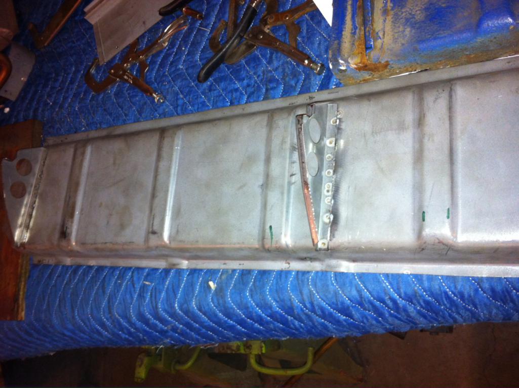

If I understand you then, the outer long pieces such as the ones from 914LTD that bridge the stamped ribs defeat the crush zone?
this is what I have and believe it is much stronger than stock.
but possibly less desirable in a collision?
I am missing the triangle sill panel supports shown in this picture.
are these something I should add? I wasn't going to, but could.

My text has to do with stock appearance and restoring the chassis to be visually as well as structurally safe. It's true Brad's kit adds strength to the stock chassis. I like Brad's kit. It makes the most sense to me of all the chassis kits out there. It's like adding a roll bar to your car. It stiffens the chassis. Not really needed in normal driving. In fact it could be dangerous if your head comes in contact with the bars during a collision. That's why you wear a helmet and a harness to keep you off the bars and the bars keep other race cars out of your cabin. As an added benefit you gain a stiffer chassis which aids in the ability to achieve predictable suspension and consistent drive-ability.
You may or may not need the triangles. They only serve to help prevent the top panel from bending if you step on it. They are stock but in your case may not fit with Brad's kit.
