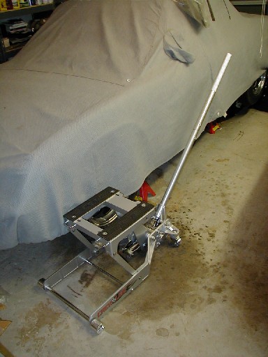

For those of us that are welder challenged, you can have this bad boy
for $78 at Sams Club. All aluminum, metal wheels, lowers to 5 inches
and raises to 17 inches.
--- Bill

QUOTE (bperry @ Mar 29 2005, 06:41 AM)
For those of us that are welder challenged, you can have this bad boy for $78 at Sams Club.
All aluminum, metal wheels, lowers to 5 inches and raises to 17 inches.
Yep, that the one I really wanted...
Sparetime Toys posted his a couple of months ago
Can't find anything like it over here (IMG:http://www.914world.com/bbs2/html/emoticons/screwy.gif)
Only thing I could find was the ATV lift
Plus this stuff is so much more expensive here
The ATV lift goes for about €120 and the alu jack I got recently was €350 (IMG:http://www.914world.com/bbs2/html/emoticons/blink.gif)
(and believe me, I did shop around quite extensively before I bought it)
It's way to heavy to ship across the pond, so I basically was out of options...
If I could have bought one off the shelf, I would
Still I had fun welding this thing together (IMG:http://www.914world.com/bbs2/html/emoticons/welder.gif)

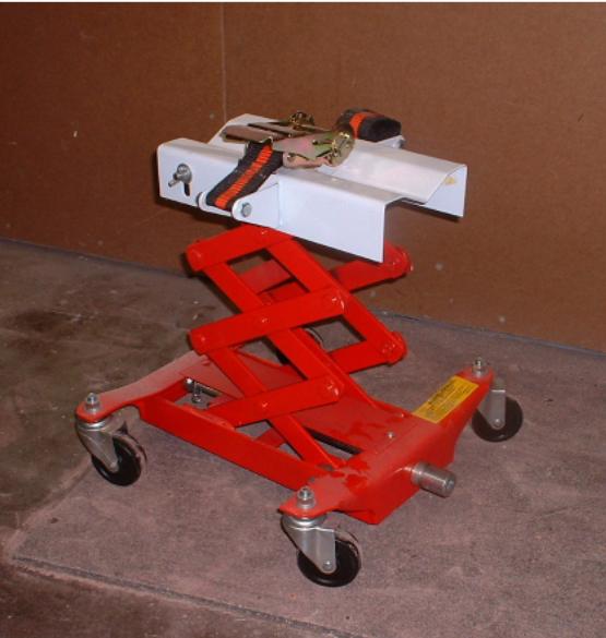

QUOTE (ChrisFix @ Mar 28 2005, 06:33 PM)
QUOTE (slivel @ Mar 28 2005, 04:41 PM)
I've used this for engines, transmissions and most recently installing a double wall oven.  It's an ATV jack and I got it on sale at Kragen for  $49.95.
Steve
Have you used that ATV jack for removing a 914 engine, and did it clear the tranny. PEP Boys has it on sale for $45 and it seems like it is a pretty nice fit for engine drops. Would love to hear any user experience.
Didn't mean to burst Jeroen's bubble, but for those near a Kragen this ATV lift is a cheap alternative. I've used it to install my six and my 901 box - they fit OK. I used a piece of MDF on the jack under the gearbox and cinched everything down with a ratcheting nylon strap to be safe. It worked just fine. But my disclaimer is that I installled the engine separately first, blocked the flywheel end with bottle jack and wood and then used the ATV jack to slide the tranny in place. Haven't tried removing or installing the engine/trans as a unit. The ATV jack is rated high enough to handle the weight but the size might be an issue.

You're design is cool. It has one distinct advantage over the ATV lifts (which I've used more times than I care to count) - it clears the tranny. The Sams Club lift shown appears to do the same.
The ATV lifts have the piston at a steep angle and it has to go in at an angle to clear the rear hub. One solution is to place a furniture dolly on top of the lift - perpendicular to it. Slide the lift & the dolly under the engine/tranny, and lift the dolly to mate with the engine. You can make positional adjustments as needed. Usually the lift will be sitting between the rear hub & the body, with the dolly perpendicular across it.
When you lower the engine the lift has to roll backwards slightly to account for the radius of the supports. Once down the engine is on the dolly, so you slide the lift clear. You can now freely navigate the engine tranny on the dolly. Just don't drive to fast down the driveway with the engine on the dolly - as its not licensed!

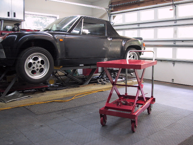

Of course, there is this one on e-bay.. allbeit a little pricey..
http://cgi.ebay.com/ebaymotors/ws/eBayISAP...4553528386&rd=1
iamchappy
post Jun 2 2005, 10:25 AM
Post #35
It all happens so fast!
Posts: 4,893
Joined: 5-November 03
From: minnetonka, mn
Member No.: 1,315
I will let you know how the lift table works I plan on using it for the install.

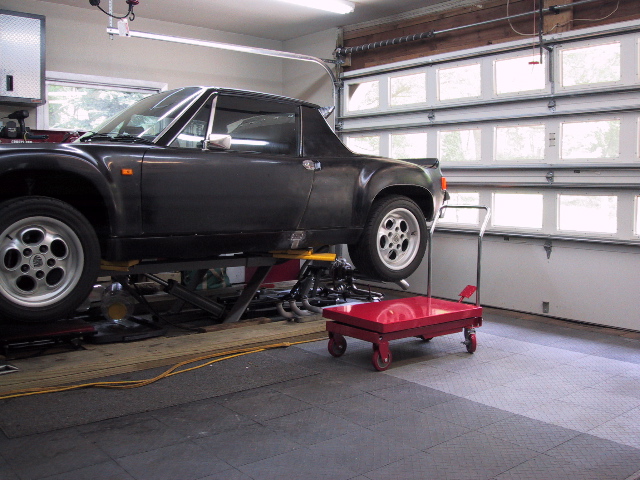

lift
sixnotfour
post Jun 2 2005, 11:51 AM
Post #37
Posts: 10,912
Joined: 12-September 04
Member No.: 2,744
Slight highjack; iamchappy, what kind of car lift is you're 914 on?
iamchappy
post Jun 2 2005, 12:06 PM
Post #38
Posts: 4,893
Member No.: 1,315
Dont know, some old service station lift I picked up for 350 bucks, degrease a little rustoleum paint and wire brush and it looks and works great. Looks like I will have to raise the ears for enough clearance for the lift table.

QUOTE (slivel @ Mar 29 2005, 11:13 AM)
Steve
Steve
Well, I bought the ATV/motorcycle jack and TRIED to use it this weekend to remove my engine/tranny... IT DOESN'T WORK The bracket that surrounds the bottle jack gets in the way underneath the tranny. Don't waste your money if you're going to use this specifically to remove/install the engine/tranny combo. But, it works great after the engine/tranny is out of the car and you're working on it later. BTW Steve, thanks for clearing up your 'successful' use of this jack, for the life of me, I couldn't figure out how you used it....

Believe it or not the best lift I have used to put the engine in is a hoist, I have used just about everything atv, jack, now the lift table. But the boom engine hoist is the easiest as it swings around the engine and you can tip and tilt it and effortlessly control the engine . I have the stock six mount and getting that little bugger mounting nub in and under to install the bolt is tough on a jack or ATV lift. The only thing bad about using the hoist for me is I have to drag it up a hill from behind the shed in the back yard.
