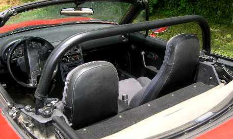

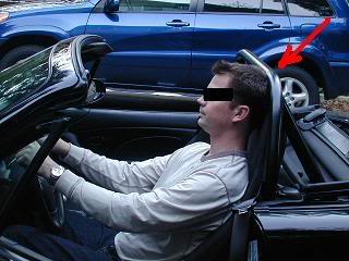

The End
They wonder the same thing Miata guys that is.....
Safety of roll-bar on the street - any hard data?
http://www.google.com/url?sa=t&rct=j&a...119745492,d.amc
