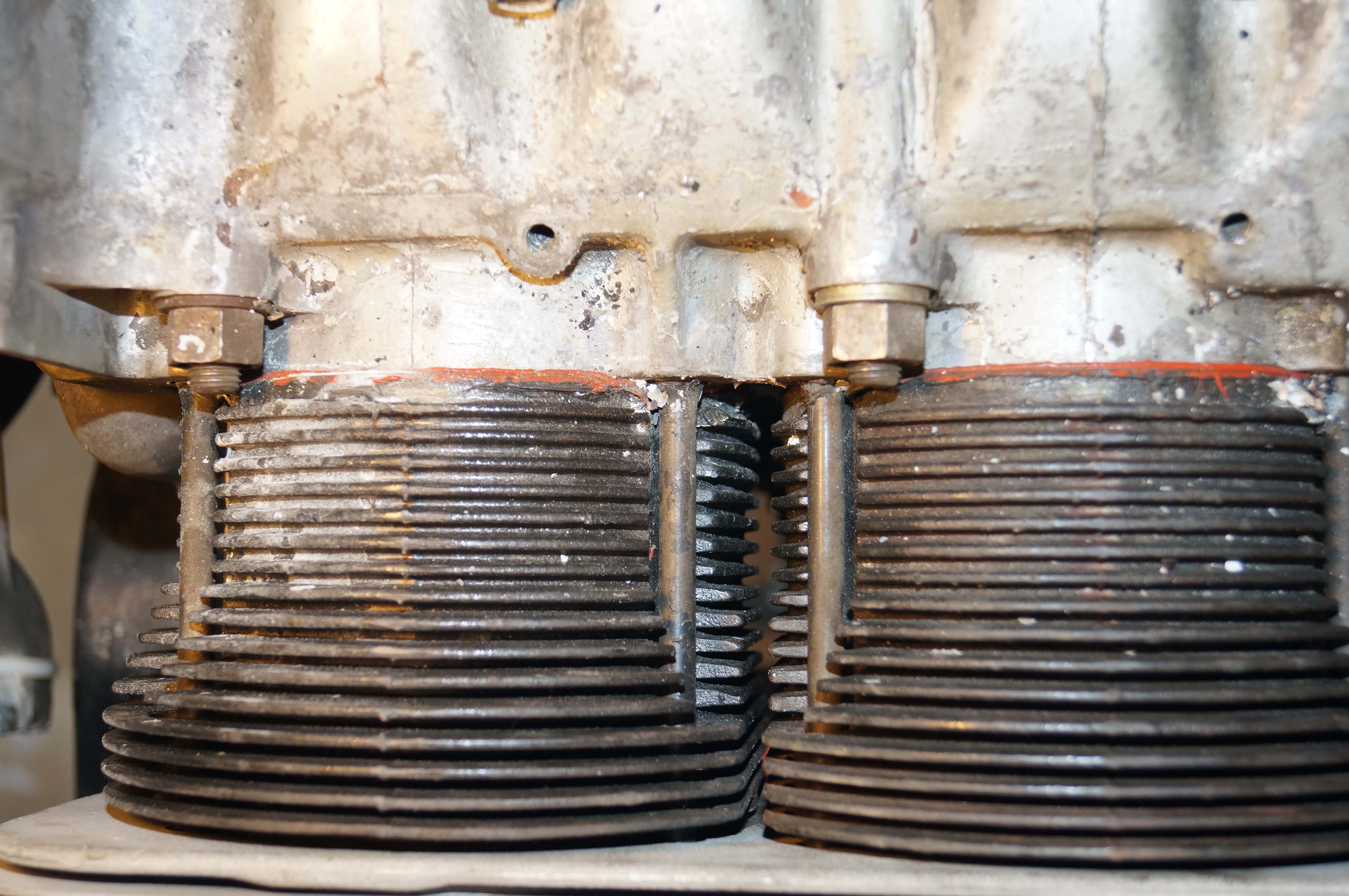

The 1972 914 I bought is supposed to have 103mm Nickies (by LN-Engineering) with JE-forged pistons.
The car caught on-fire, so I had to remove the engine. After doing so I find that the cylinders are magnetic. Nickies are made from Aluminum, so this is suspicious.

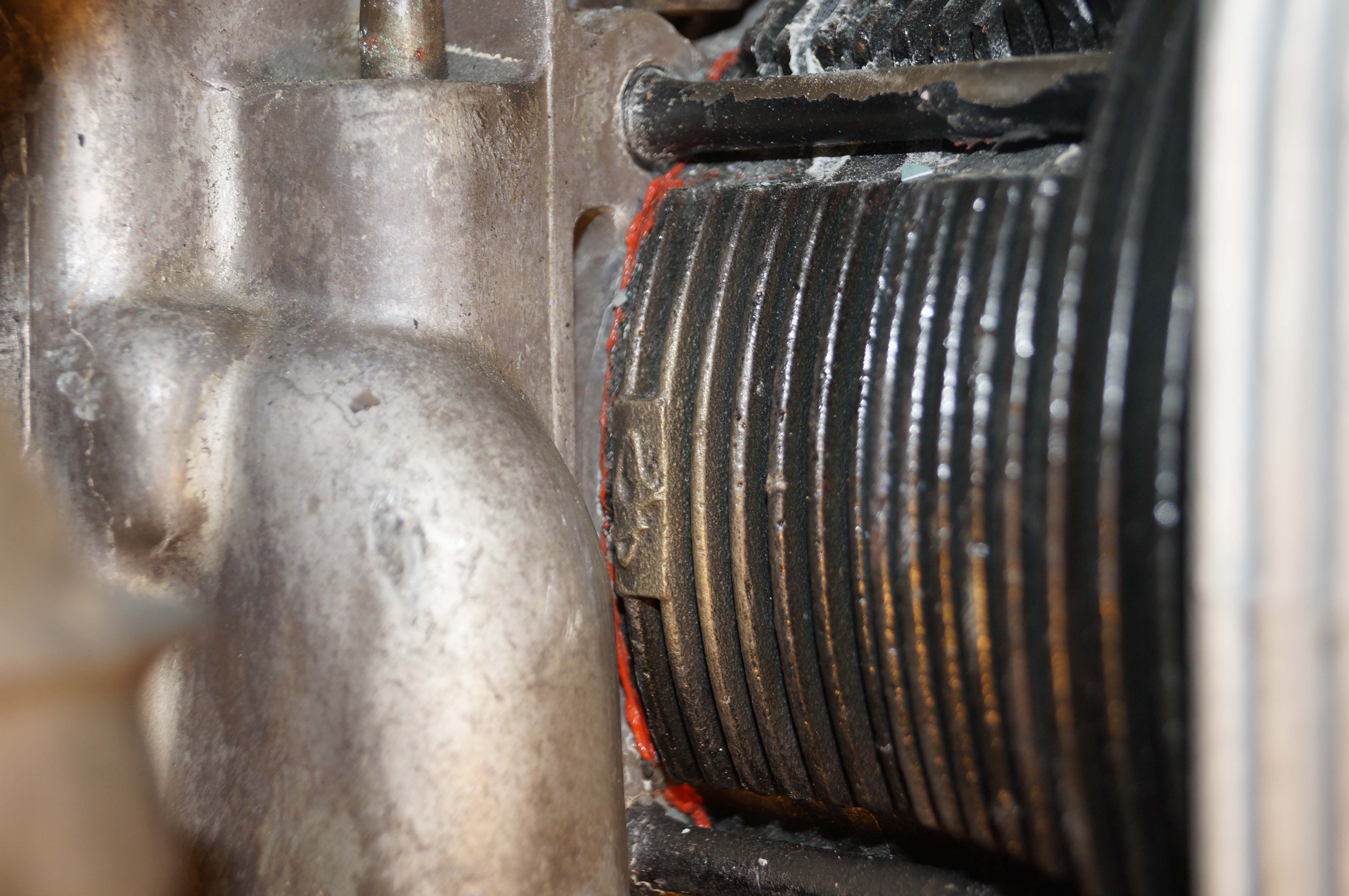

Is any of you able to recognize the make of the Cylinders in the below pictures. There is one picture with some marking on it. I do not want to disassemble the engine any further then needed.

rhcb914   Those are AA cylinders. http://aapistons.com/   Apr 28 2016, 08:11 PM
ThePaintedMan   :agree: At this point, I'd be willing to bet...   Apr 28 2016, 08:16 PM

Valy   The orange silicon tells a lot about who built thi...   Apr 28 2016, 08:35 PM

Mueller   Nickies are machined, those are cast cylinders, I ...   Apr 28 2016, 08:59 PM

Racer Chris   Those aren't 103s. The case registers are pro...   Apr 29 2016, 04:56 AM

r_towle   Well, the best way is to measure the piston diamet...   May 2 2016, 04:52 PM
r_towle   I think Chris is right, the 103's just about t...   May 2 2016, 04:55 PM
porschetub   I think Chris is right, the 103's just about ...   May 2 2016, 06:13 PM
Hans Jan   Good spotting,no machining gone on there,just plai...   May 2 2016, 09:23 PM
Mueller   Good spotting,no machining gone on there,just pla...   May 2 2016, 09:51 PM

rhodyguy   Late to the party. You can see the parting line th...   May 3 2016, 01:24 AM
Jake Raby   Those are Chinese, cast iron clunkers... Nothing N...   May 3 2016, 08:33 AM
