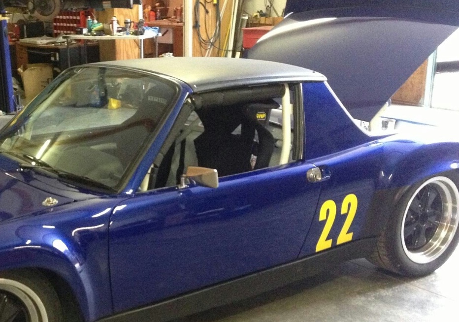

My car had a CF OMP halo seat in it when I bought it - in a stupid moment, I gave it back to my friend/seller since I had no use for it. It was way to intrusive and uncomfortable for me to use. It greatly blocks vision. My suggestion (which I've done) is to install Safecracft window and center cockpit nets. Just food for thought...I'm assuming you are using a HANS (like) device...

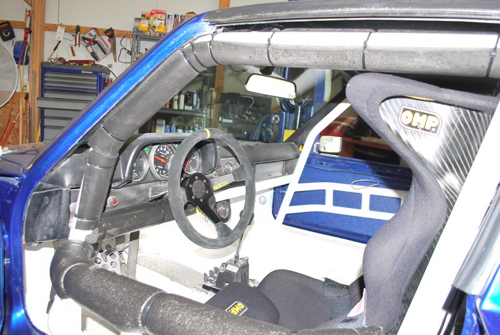

We've got an OMP HTE-XL containment seat in our chumpcar - I'll get some pics later
It's really comfortable, but fit was a somewhat tight fit for the car- right now it's mounted directly to floor with no sliders. We plan on installing sliders, but we found a fixed position that works for most.
It's a bit tighter to exit through the window than the old Sparco Evo L, but isn't a huge issue.
We run the car with no roof and for some it's a bit easier just to climb over the cage and and drop into the seat
