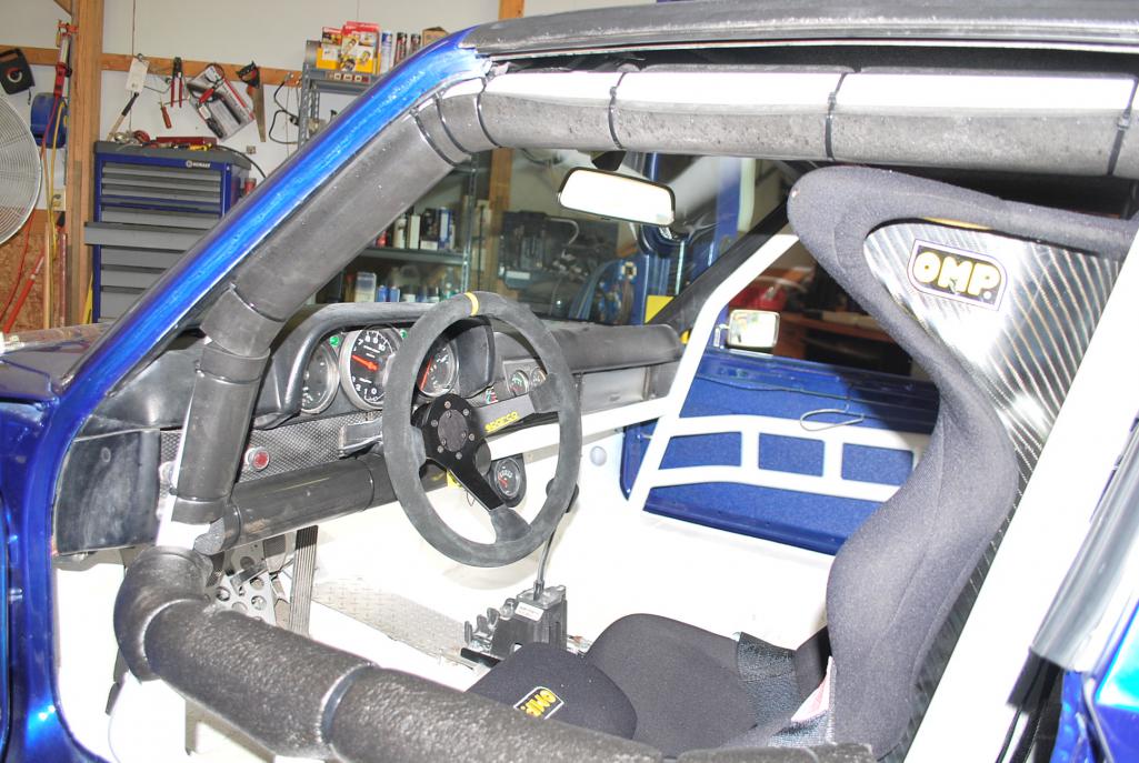

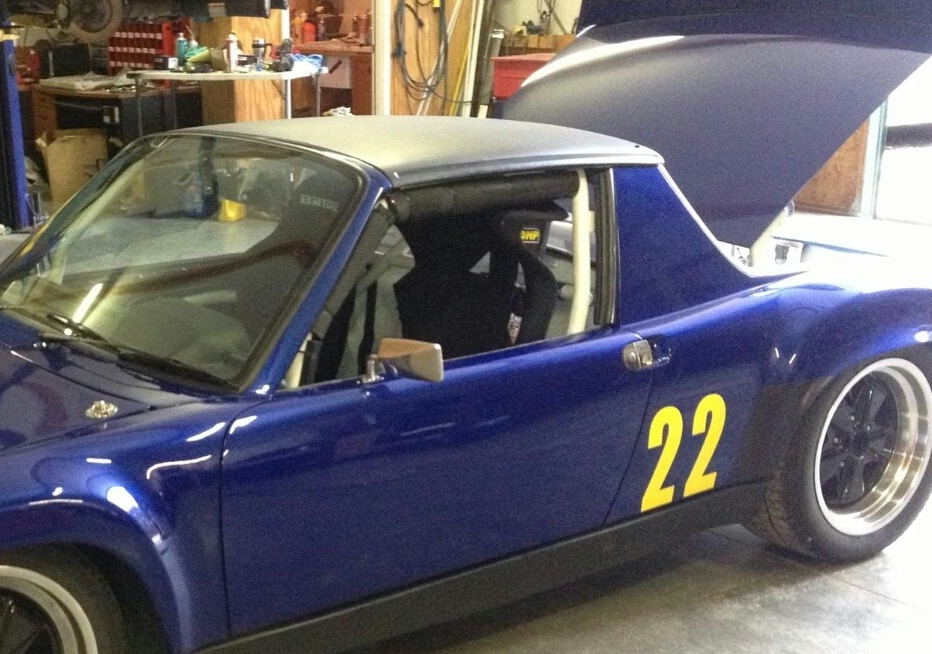

We've got an OMP HTE-XL containment seat in our chumpcar - I'll get some pics later
It's really comfortable, but fit was a somewhat tight fit for the car- right now it's mounted directly to floor with no sliders. We plan on installing sliders, but we found a fixed position that works for most.
It's a bit tighter to exit through the window than the old Sparco Evo L, but isn't a huge issue.
We run the car with no roof and for some it's a bit easier just to climb over the cage and and drop into the seat
