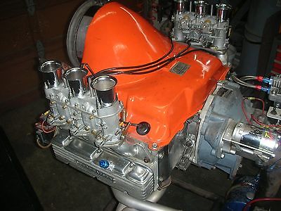

Cut the case and add VW pistons and cylinders gets you
to 3.1 liters and machine off the intake manifolds and weld
on adapters for Webers or Zeniths..
Like this one supposedly over 300 HP..

Dr. Evil built a big bore engine a few years back for his
VW Bus.
Think he was going to try some sort of F.I.
Maybe based on some CIS parts ??
You could PM him and ask
Experimental Aircraft guys were the main market for
the big bore kits I think..
The 3 barrel carb adapter plates have been around a long time..
I'd suspect none of it is cheap..
link to big bore
http://www.n56ml.com/corvair/3100.html
Pict. of carb adapters and heads machined for them..
