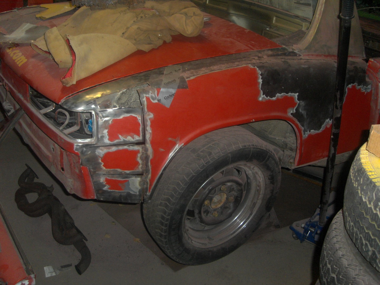

jd74914
post Jun 13 2016, 09:14 PM
Its alive
Posts: 4,852
Joined: 16-February 04
From: CT
Member No.: 1,659
QUOTE(ssuperflyoldguy @ Jun 13 2016, 09:48 PM) *
QUOTE(r_towle @ Jun 12 2016, 04:12 PM) *
If you are ambitious you can cut a slice in the top of the fender and weld in a spacer that goes from nothing, to an inch, back to nothing, with the fat part at the area mike mentions above.....if done well, it's hard to notice unless it's sitting next to another car.
Rich
Thx, if anyone has a pic of that slice being worked in, it would help a bunch. Not something I would consider but since the fender is being worked on maybe the profile can be reworked a bit

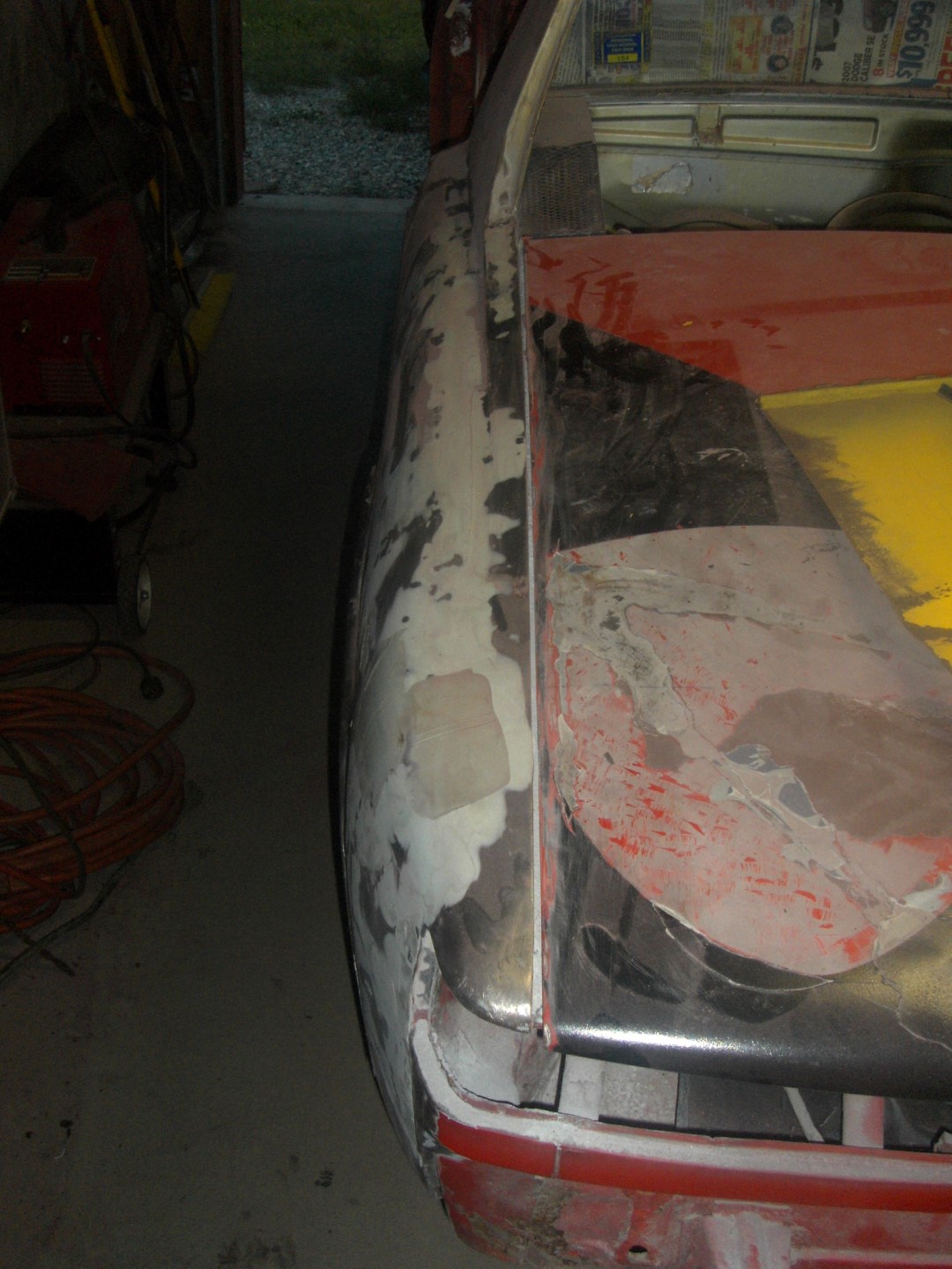

Here you go...
Mueller
post Jun 13 2016, 09:15 PM
914 Freak!
Posts: 17,155
Joined: 4-January 03
From: Antioch, CA
Member No.: 87
^better pics and info than mine...

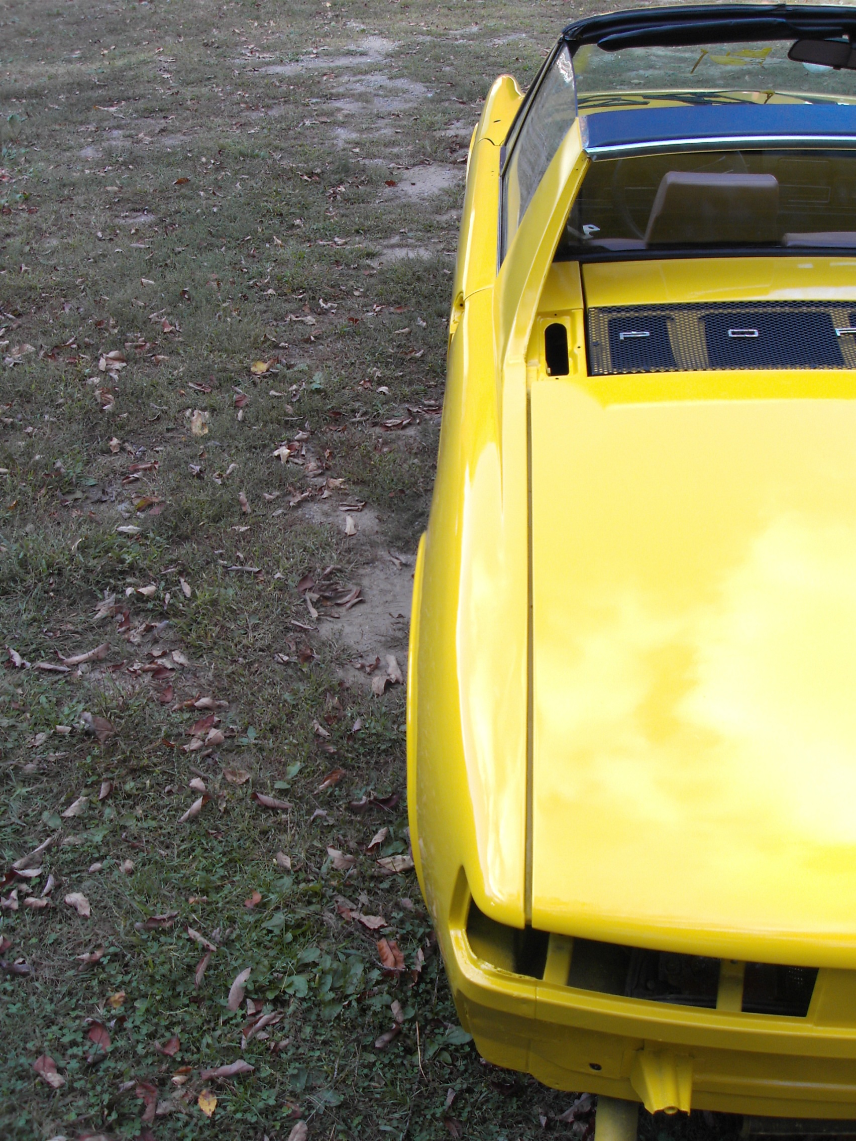

jd74914
post Jun 13 2016, 09:16 PM
Its alive
Posts: 4,852
From: CT
Member No.: 1,659
Final product. I was pretty happy with it. (IMG:style_emoticons/default/smile.gif)

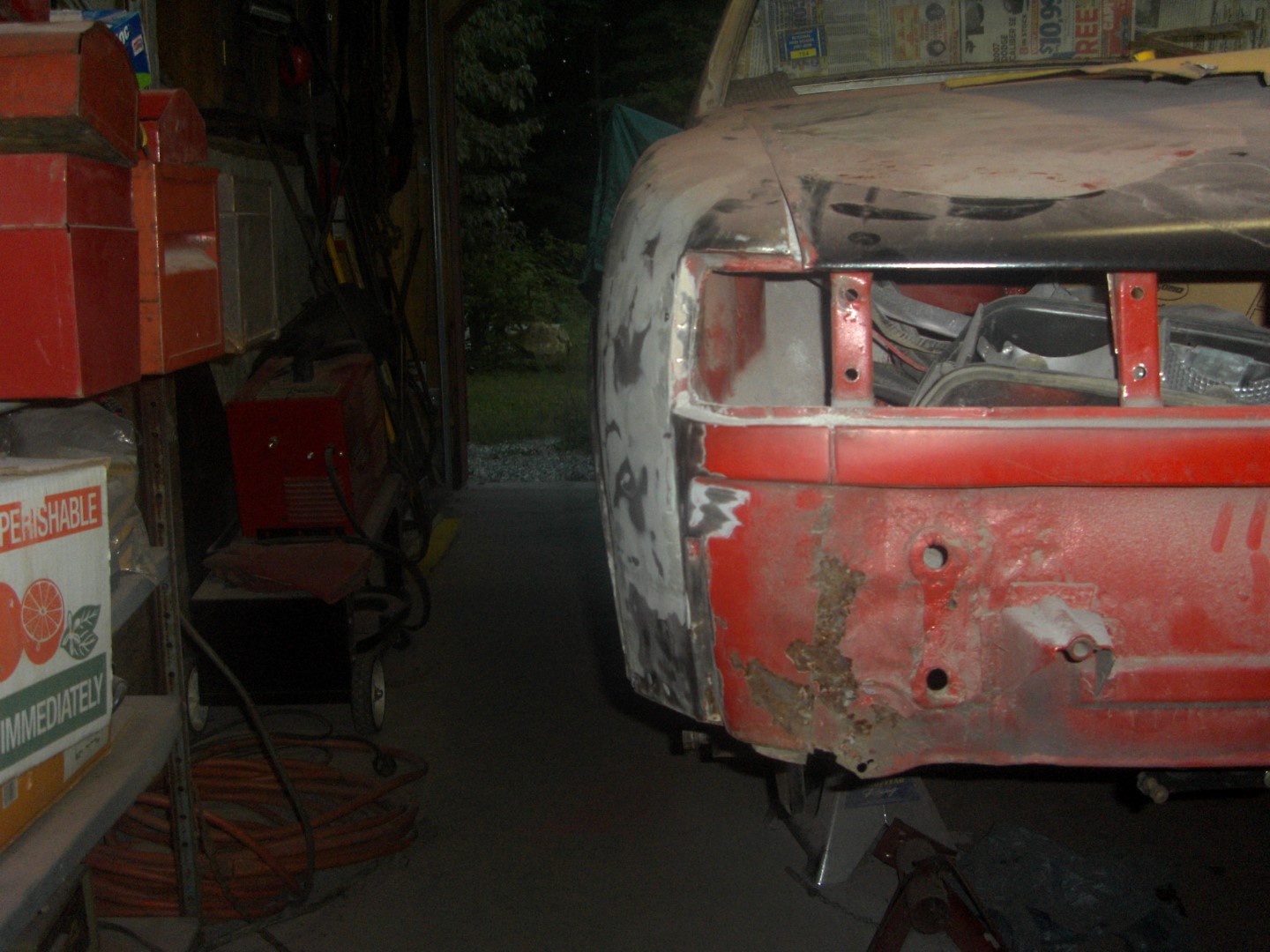

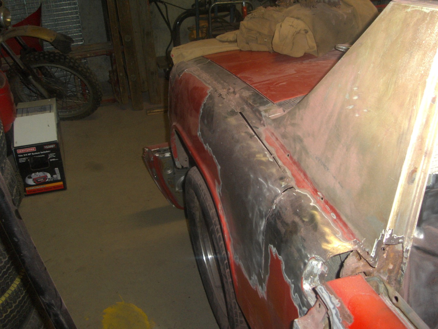

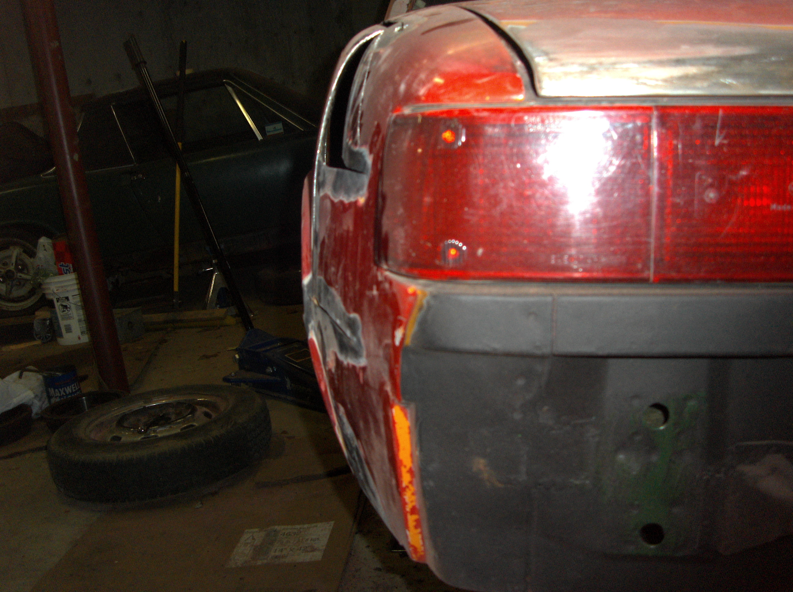

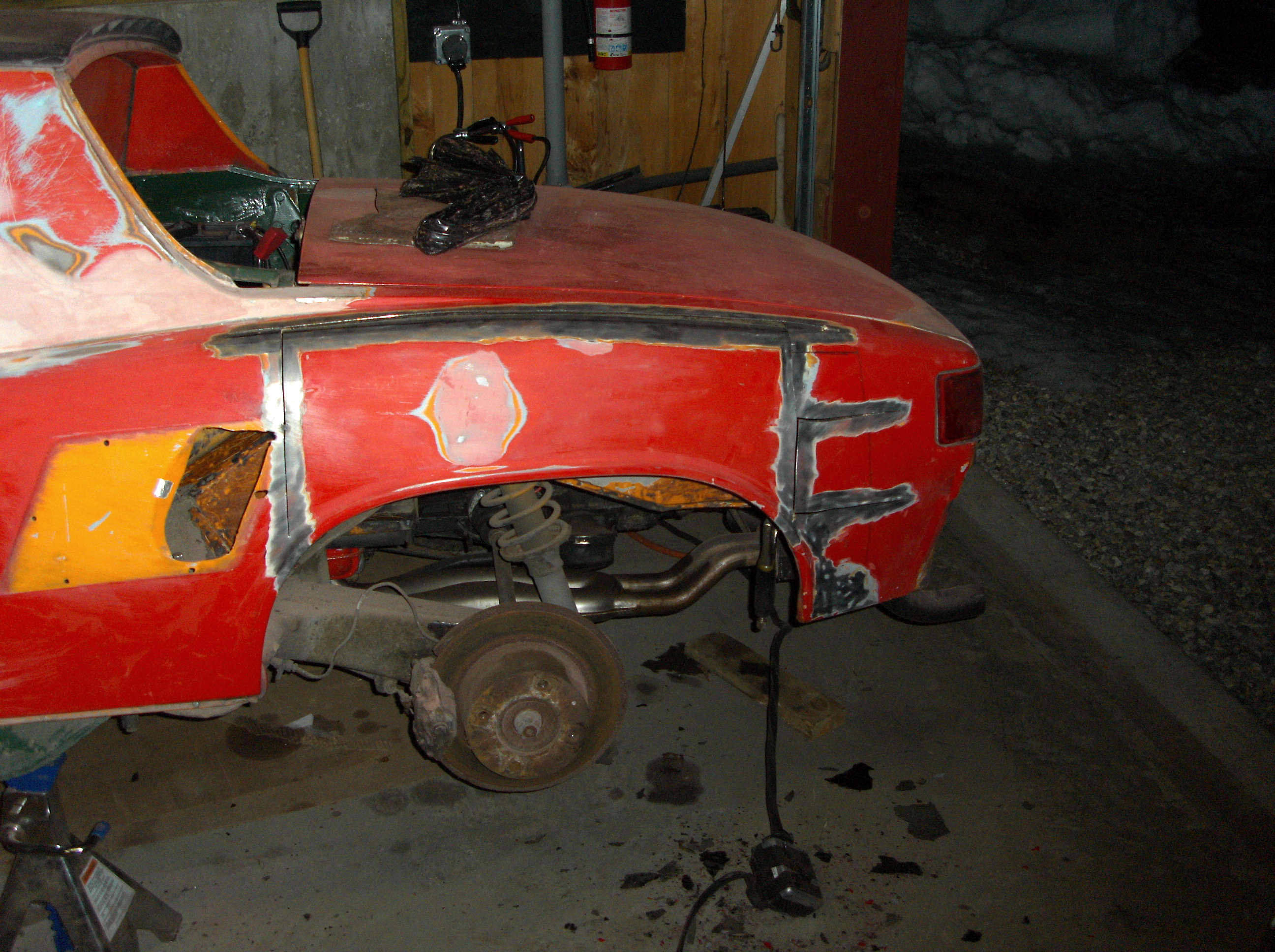

jd74914
post Jun 13 2016, 09:23 PM
Its alive
Posts: 4,852
From: CT
Member No.: 1,659
Mine were inspired by Mueller's flares. (IMG:style_emoticons/default/biggrin.gif)
Here are a few in progress pictures of some we did for my brother's car which have a better view of the cuts. Hopefully something there is helpful. These flares fit a 15x8 with no problems.
