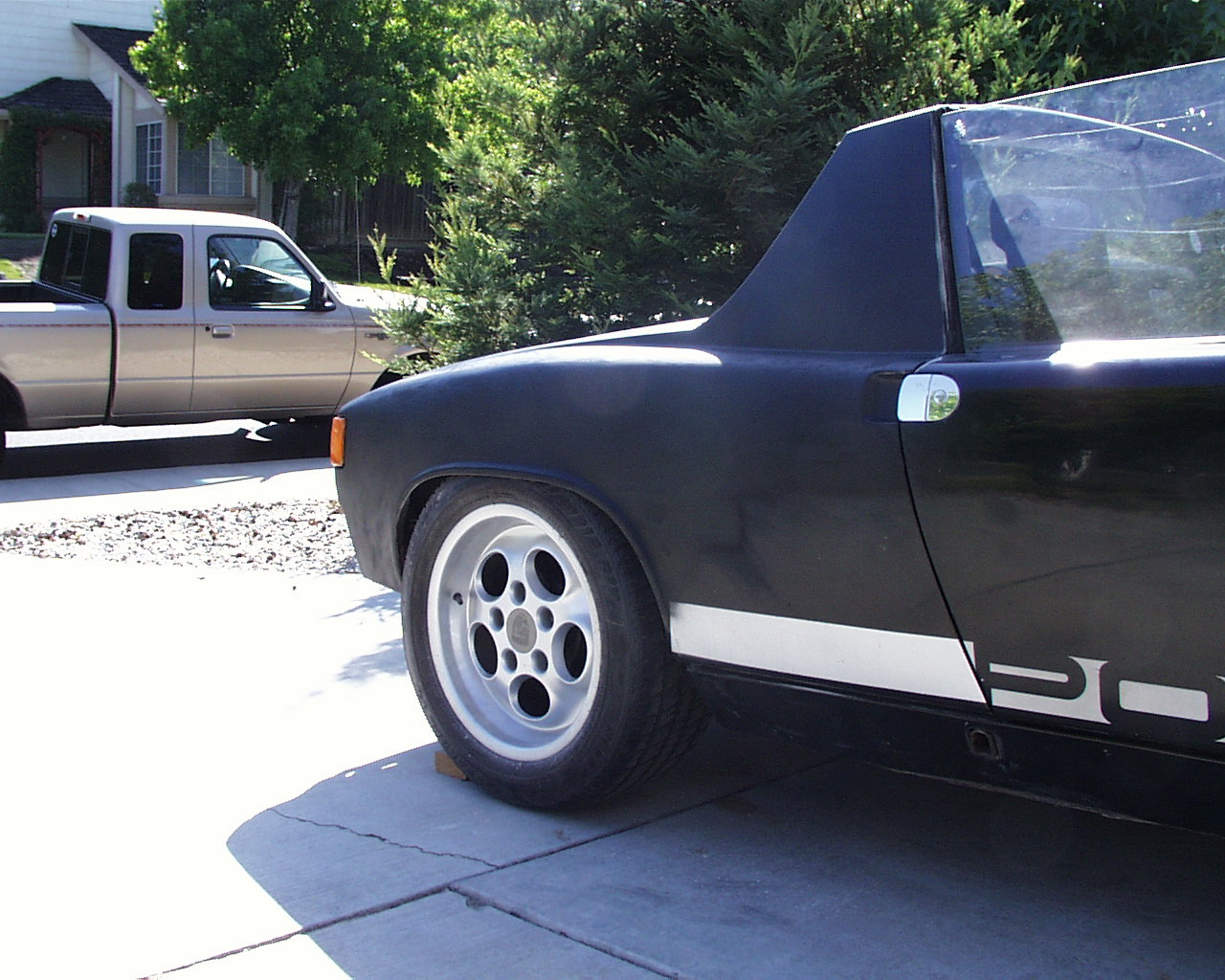

Mueller
QUOTE(r_towle @ Jun 12 2016, 04:12 PM) *
If you are ambitious you can cut a slice in the top of the fender and weld in a spacer that goes from nothing, to an inch, back to nothing, with the fat part at the area mike mentions above.....if done well, it's hard to notice unless it's sitting next to another car.
Rich
Yep.....
225s on 8's

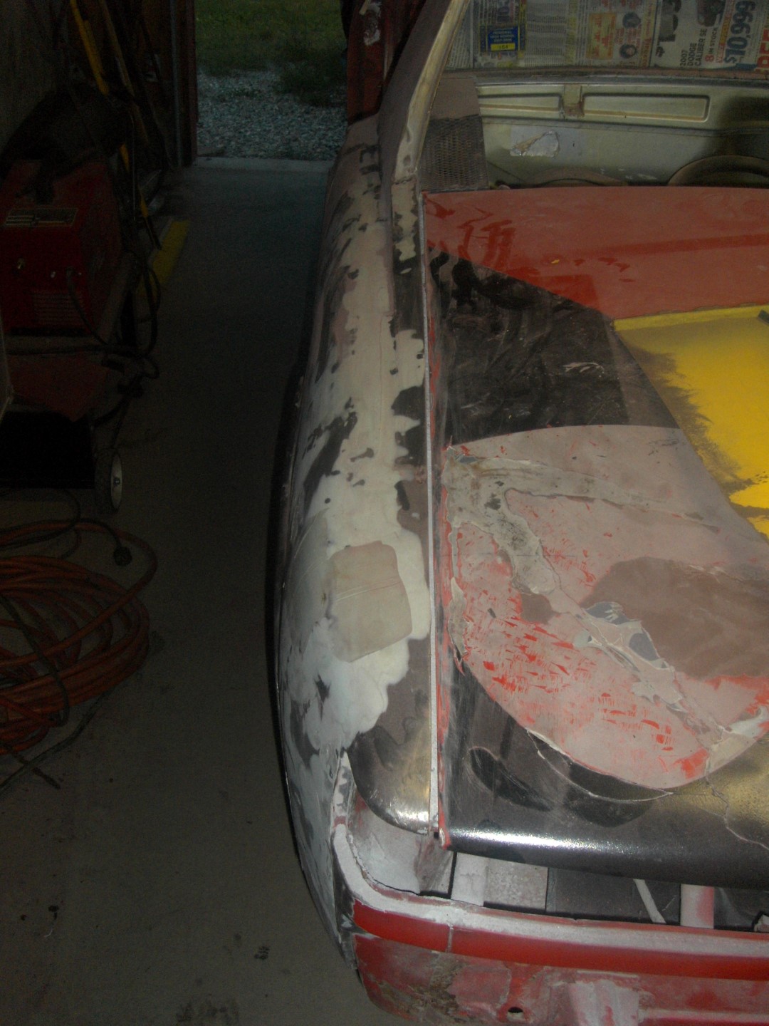

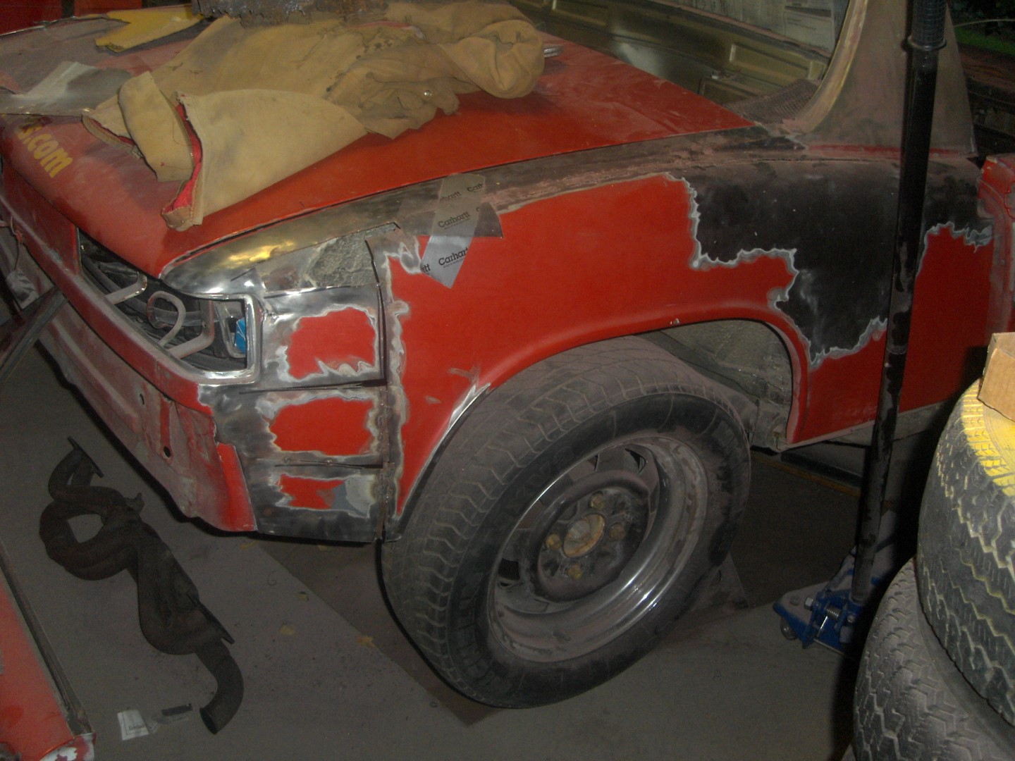

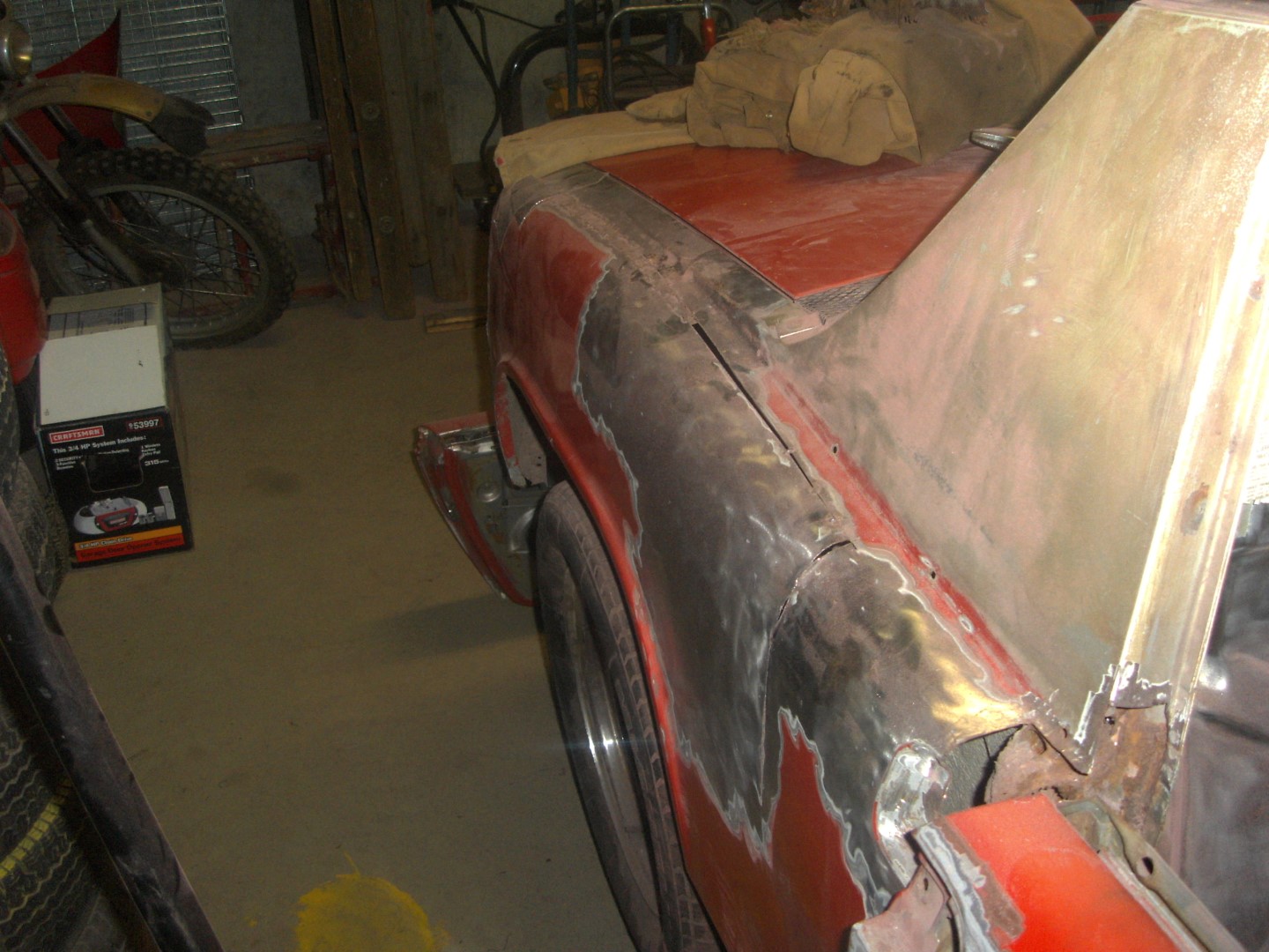

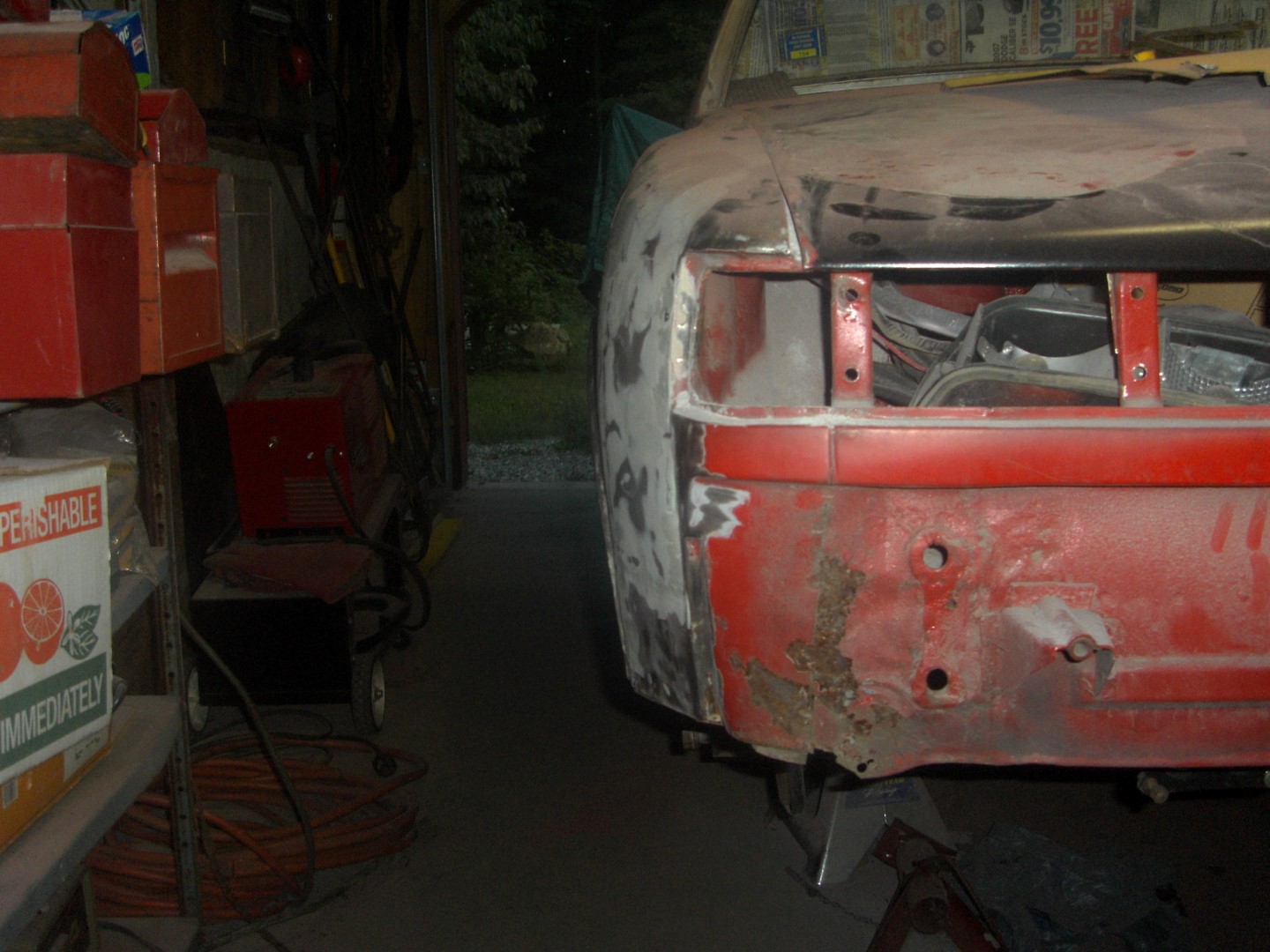

jd74914
QUOTE(ssuperflyoldguy @ Jun 13 2016, 09:48 PM) *
Rich
Thx, if anyone has a pic of that slice being worked in, it would help a bunch. Not something I would consider but since the fender is being worked on maybe the profile can be reworked a bit
Here you go...

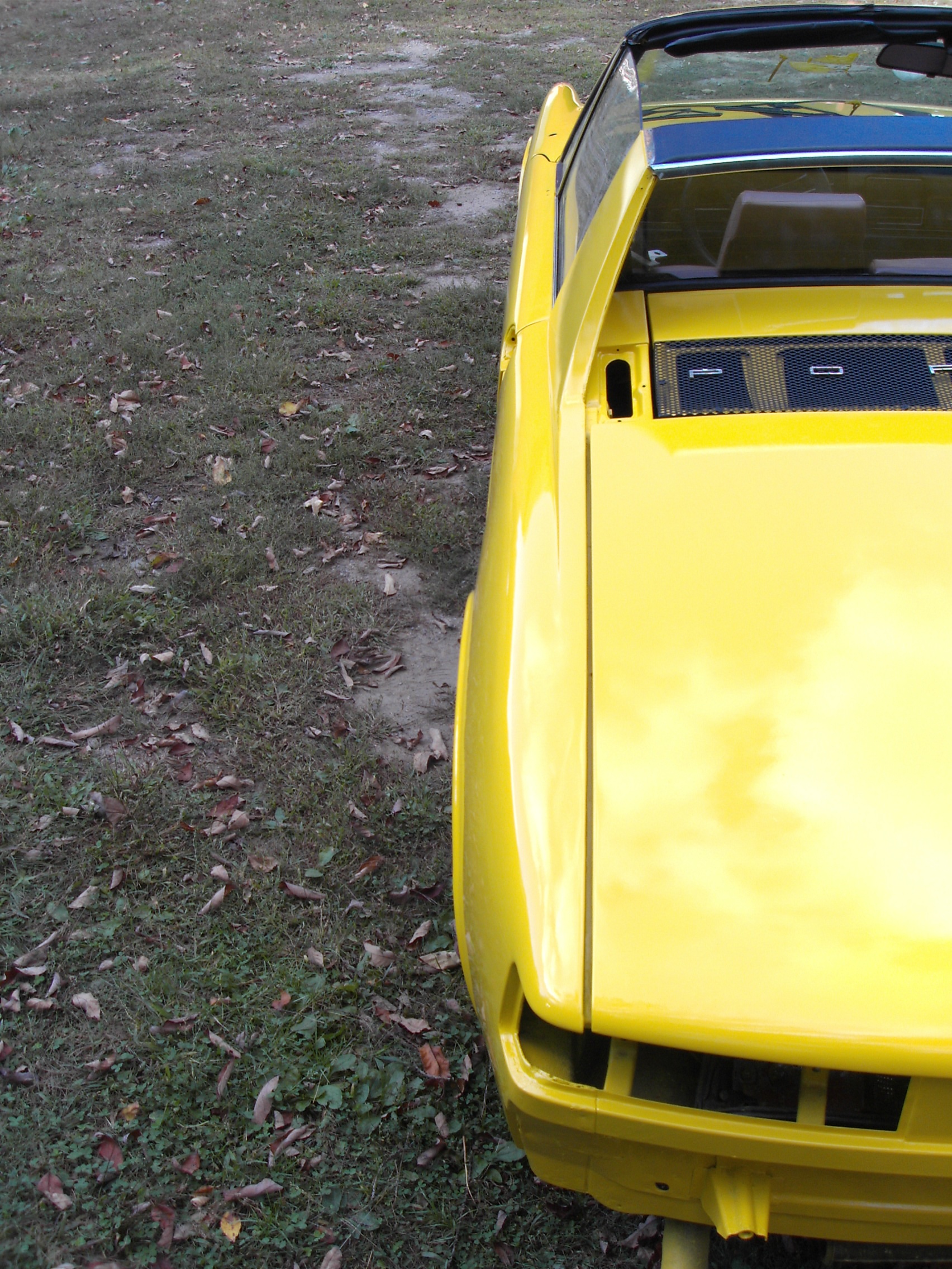

jd74914
jd74914
Here are a few in progress pictures of some we did for my brother's car which have a better view of the cuts. Hopefully something there is helpful. These flares fit a 15x8 with no problems.
