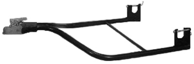

make the VW Bug tow bar pictured below work on my 914
