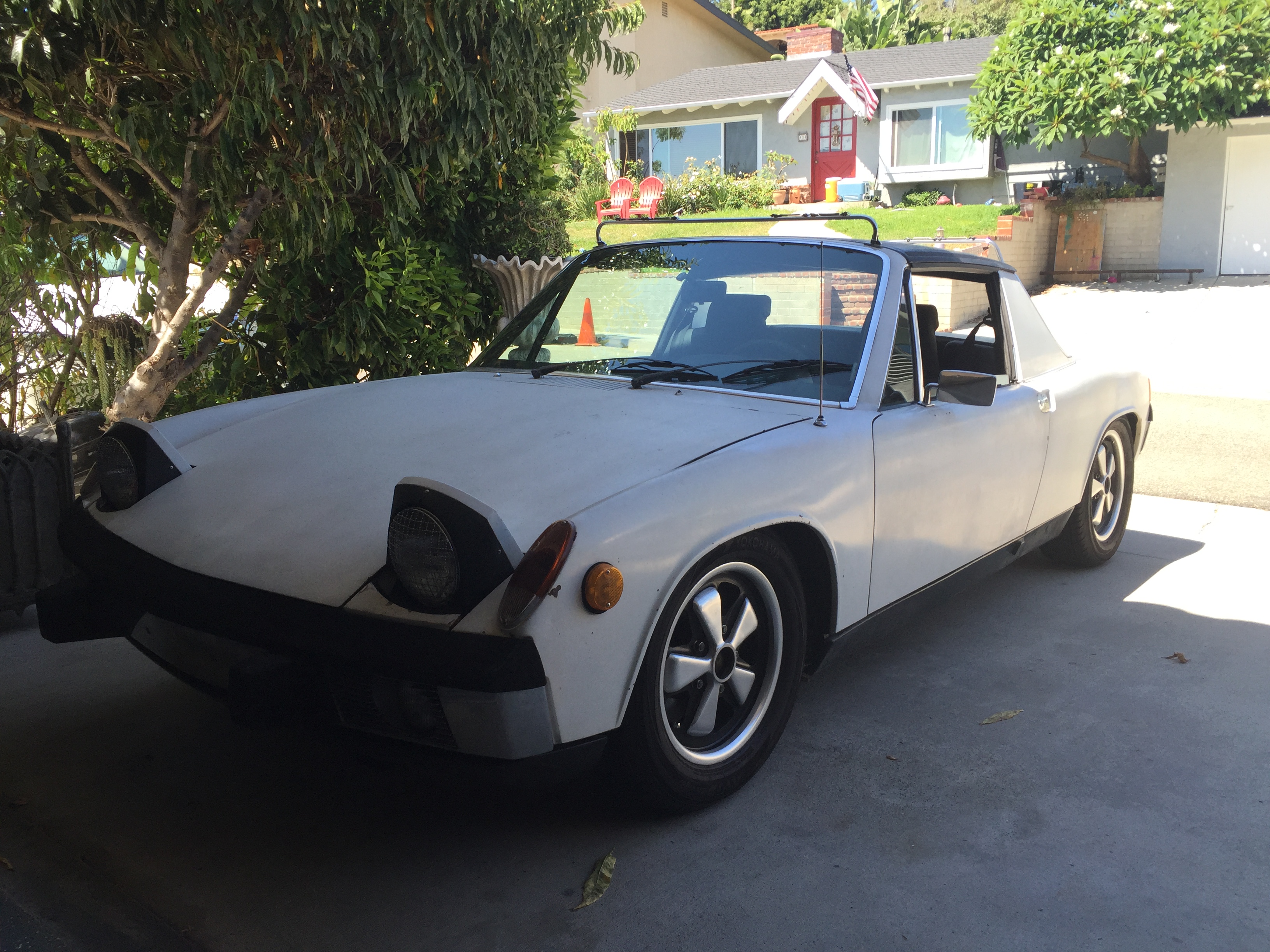

I have the car back, and after fixing a bunch of crappy mechanical work this guy did, and a bunch of $$ that I keep spending, I have the car on the road and it is fun to be driving again.
Man, I missed DRIVING.
Why did I have to get the 914 infection? Why me?

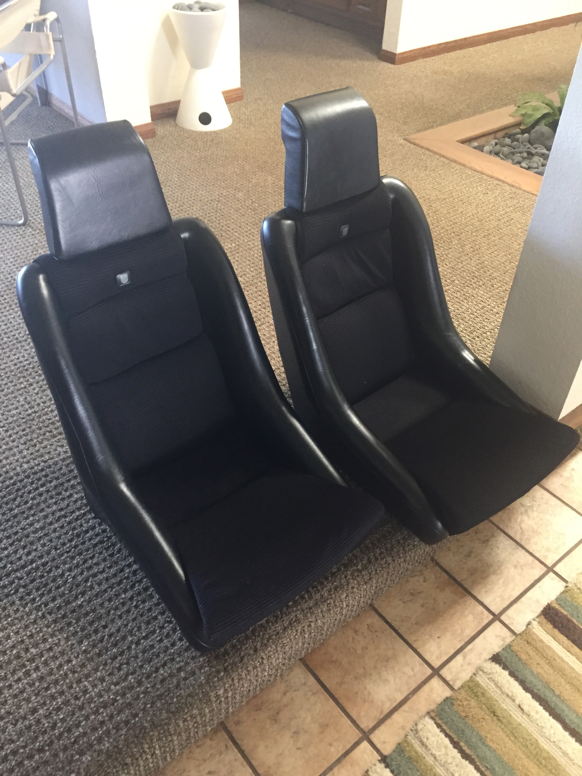

Oh, and these Scheels showed up today…..

Sorry that it's a Debbie Downer thread, but it seems I take one step forward and two steps back.
I'm just frustrated.
I'd like to know if there is some advice on how the horn wire in the column could affect the tachometer, directionals, and gas gauge not working? I was also fiddling with the fog lights and hooked them up properly. The dash light on the switch came on, but no lights. Now the emergency switch doesn't work either. No blown fuses, no hot spots anywhere, no smoking switches or burnt wiring anywhere.
I thought tomorrow might be a potential Cars and Coffee appearance. No go.

mmmmm...scheels!!!... (IMG:style_emoticons/default/drooley.gif) Those would help me feel better!!
